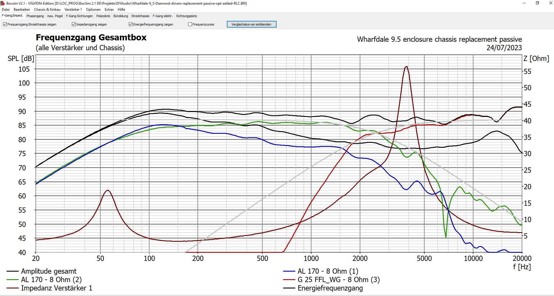

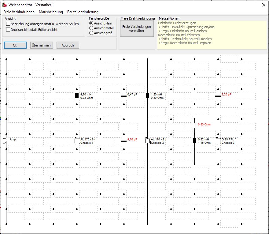

Hello friend.BoxSim has an optimizer for passive crossovers, here the outcome, but you have to play around with this on your own if you want to get a first feeling for the simulation program.

I believe BoxSim does not calculate the power response, which is probably the best simulated indication of how a speaker sounds in reality.

It does; that's the (in translation) Energy Frequency Response curve.I believe BoxSim does not calculate the power response, which is probably the best simulated indication of how a speaker sounds in reality.

Agreed on the care that Visaton has taken for Boxsim. Especially with their own measurements simulations are pretty spot on and if you like to use your own, results can be pretty reliable too.
Few things on the proposed X-over, I would also damp the cone resonance of the lower AL170. Now it’s only 10dB or so under reference level. The output of the lower one declines too slow at higher frequencies too. The tweeter high pass doesn’t match the midwoofer low pass that good. Furthermore a waveguide (Visaton WG148) would bring a real improvement. Visaton offers measurements of a few tweeters with it in Boxsim.

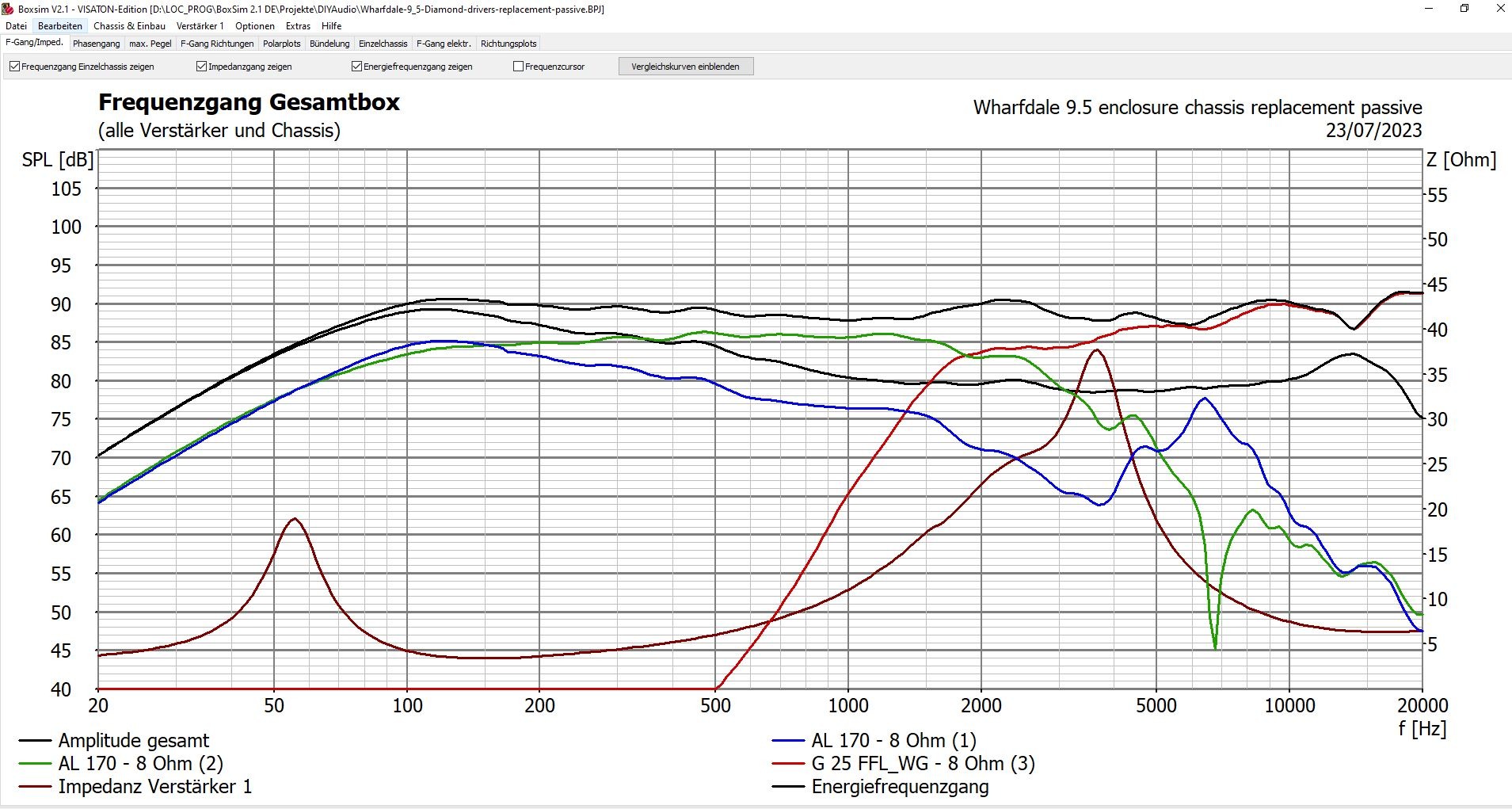

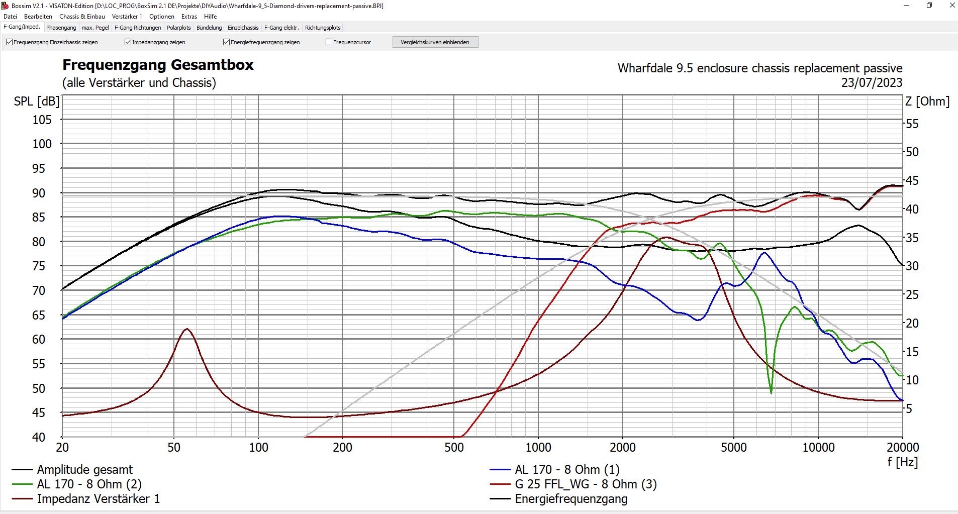

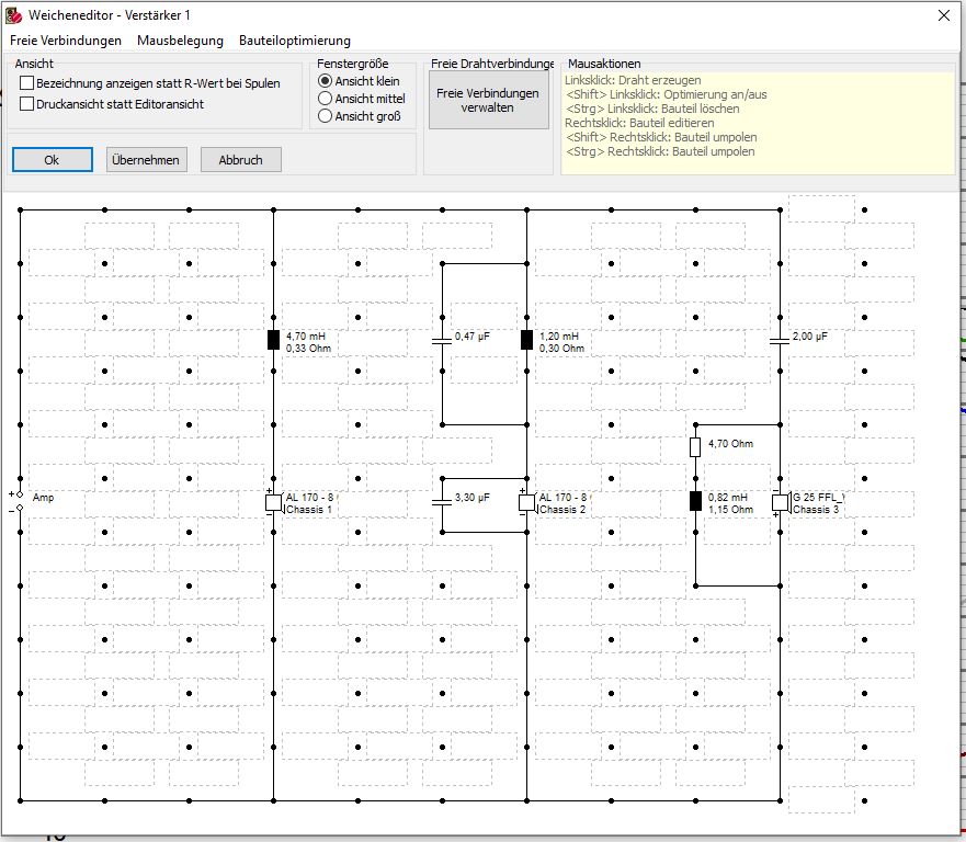

Here we go:

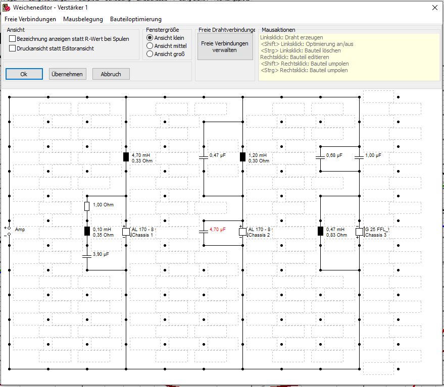

For the peak in the impedance curve at about 3.9 kHz there is a good chance to add an impedance correction RLC circuit, depends on the amp used.
I have used the G25_FFL_WG file for the tweeter, this is the one with the waveguide. With the series capacitor for the tweeter there will be probably the need to use a matched pair for the stereo setup, the value decide about the SPL of the tweeter like for a compression driver tweeter.
That’s most likely because the waveguide shows quite some peaking >20 degrees off axis above 10k. Nothing to worry about, almost any wall finish absorbs such frequencies big time so effectively you won’t see any sound power increase taking direct and indirect field together.
Hi IamJF, i also believe it is a high frequencies no more constant directivity issue of the dome tweeter with a waveguide but no phase plug.
Actually that's a behaviour which would often be beneficial to overdampened rooms but is nearly impossible to achieve - at least with a dome with no massive breakup. So I cot curious immediately ;-)
A bigger on axis chancellation could be the reason but of course that's not what we want from a monitor speaker.
