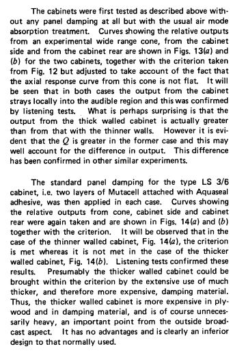

There is a BBC published paper out there somewhere on the thin wall theory. The BBC still buy loudspeakers built to this principle from Harbeth for monitoring use.
This does not mean the theory is correct.
Original BBC research paper is found at the link below. A very large history of highly regarded loudspeakers has resulted from this work... no accident I would suggest.
http://downloads.bbc.co.uk/rd/pubs/reports/1977-03.pdf
That report makes no claims consistent with what you are saying. I agree with their conclusions completely, but panel thickness is not even mentioned. What is mentioned is damping, which IMO is the most important aspect of the material, but more important is the manner of damping. Damping placed on a panel is no where near as effective as a damped cross brace or CLD. That was not studied - at least not in that paper. Cross bracing was studied in a paper by KEF or someone showing that cross bracing was the key to lower cabinet radiation. Again, I completely concur with THAT result.
And a further paper with plenty of interest contained. (Also mentions constrained layer damping)
http://downloads.bbc.co.uk/rd/pubs/reports/1988-14.pdf
Low Q thin wall damped panels? I read it as being all about that.
Below is Post 239 I made in January, 2015 in the following thread on this forum.
http://www.diyaudio.com/forums/multi-way/235908-how-brace-speaker-cabinet.html
The BBC paper "Factors in the Design of Loudspeaker Cabinet" by H.D. Harwood and R. Mathews is frequently referenced. See the link:
http://www.diy-audio.narod.ru/litr/1977-03.pdf
Harwood and Mathews performed extensive testing and wrote an excellent paper with good insightful analysis. They achieved their goal. They developed a cost effective enclosure, with wall damping, that reduced panel sound emissions to meet their criteria for non-perceptibility. They tested numerous enclosure wall materials and damping configurations. The testing and paper were not intended to develop an enclosure configuration with the lowest possible panel sound emissions.
This paper is frequently referenced by others, sometimes extrapolating its results and crediting it with more extensive implications. I have therefore included some detailed comments, encase one does not desire to spend the time deciphering the paper. Reading this will still take some dedication, sorry. Having a printed copy of the article in hand when reading the comments below would be helpful, almost required. Maybe this material can be condensed again.

8) Figures 13(a) & 13(b) and 14(a) & 14 (b) Loudspeakers size of LS 3/6, 25" x 12" x 12" (63 x 30 x 30 cm)
Figure 13 (a), loudspeaker 9 mm birch plywood panels, no panel damping, fiberglass fill
Figure 13 (b), loudspeaker 18 mm birch plywood panels, no panel damping, fiberglass fill
Figure 14 (a), loudspeaker 9 mm birch plywood panels, 2 layers Mutcell damping with Aquaseal adhesive, fiberglass fill
Figure 14 (b), loudspeaker 18 mm birch plywood panels, 2 layer Mutcell damping with Aquaseal adhesive, fiberglass fill
Harwood & Mathews comments on page 19:
".....It will be observed that in the case of the thinner wall cabinet, Fig 14(a), the criterion is met whereas it is not met in the case of the thicker walled cabinet, Fig. 14(b). Listening tests confirm these results. Presumably the thicker walled cabinet could be brought within the criterion by the extensive use of much thicker, and therefore more expensive, damping material. Thus, the thicker walled cabinet is more expensive in plywood and in damping material, and is of course unnecessarily heavy, an important point from the outside broadcast aspect. It has no advantages and is clearly an inferior design to that normally used."
I agree with Harwood and Mathews comments, with qualifications concerning the last sentence. If you accept their criteria for panel sound reduction goals, I fully agree.
Looking at Fig. 14(a) and Fig. 14(b), the 160 and 250 Hz peaks of the thinner 9 mm panel have shifted to 230 and 400 Hz for the thicker 18 mm panel, with no change in magnitude. The 18 mm panel has reduced sound emission from 1000 Hz and above. Standard guidelines for application of extensional damping call for a thicker damping layer for a 18 mm panel than for a 9 mm panel.
Comparing Fig. 13(b) to Fig 14(b) reveals the impact of adding the 2 layers of Mutacell damping material (3.85 mm thickness if the same as referenced in Table 4) to the bare panels of the 18 mm speaker. The peaks at 230 and 490 Hz decreased approximately 5 dB, the peak at 900 Hz decreased about 2 dB, the peak at 350 Hz remained unchanged, and the peak at 650 Hz increased 3 dB.
As a general comment, today's high loudspeaker drivers are lowering even order harmonic distortion with improved cones, and lowering odd order harmonic distortion with improve motor designs (shortening rings and contoured pole pieces). Midrange harmonic distortion in the -60 and sometime -70 dB territory has been achieved. Reference SB Acoustics Satori, Scanspeak, Wavecor, Accuton.

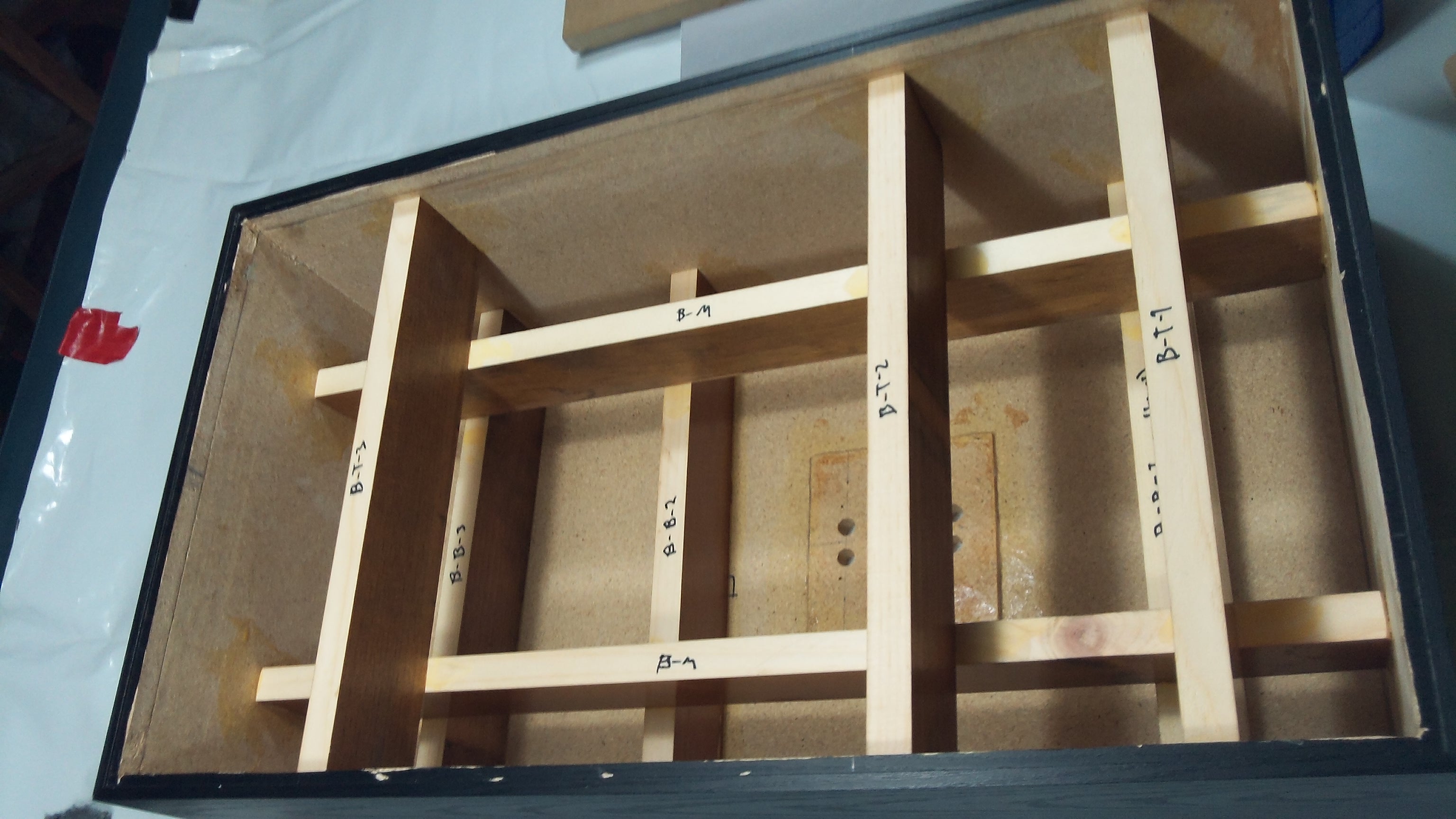

Box noise
Gedlee good to see you still posting here.
There are a lot of different issues going on here. One key is stiffness of the box which acts as an impediment to absorbing energy. We want the box to be decoupled from the energy of the driver. I get this, see attached image.
But even if this is the case then you still have a lot of energy bouncing around inside. This can form standing waves, which using prime numbers and non parallel sides can somewhat help with (I hear different things from different people).
But then even without standing waves or other additions you still have the energy itself to deal with that if not converted to heat will work its way out in some form.
Thus the energy needs to actually be converted and the usual advice is to use stuffing such as fiberglass and foam etc. I have to say that in all the builds I've done the stuffing aspect was the hardest to get right. The reason is that it always adds a dead muffled sound, I believe because it doesn't equally work on all frequencies. Additionally it can affect the motion of the driver by impeding the flow of energy off of it.
So I'm starting to think that maybe a design like the nautilus which actually draws the backwave out into a cavity so it can't reflect back is the best at least for anything handling higher frequencies.
I don't see why this couldn't be done in a normal square box by just using a brace to bisect and create triangle shape? Or why not just use a big triangle shaped foam wedge pointed at the driver magnet to divided and extinguish the back wave?

The idea that non-parallel walls removes the resonances is false. It changes them, but for a given volume there will always be the exact same number of resonances in a given bandwidth.There are a lot of different issues going on here. One key is stiffness of the box which acts as an impediment to absorbing energy. We want the box to be decoupled from the energy of the driver. I get this, see attached image.
