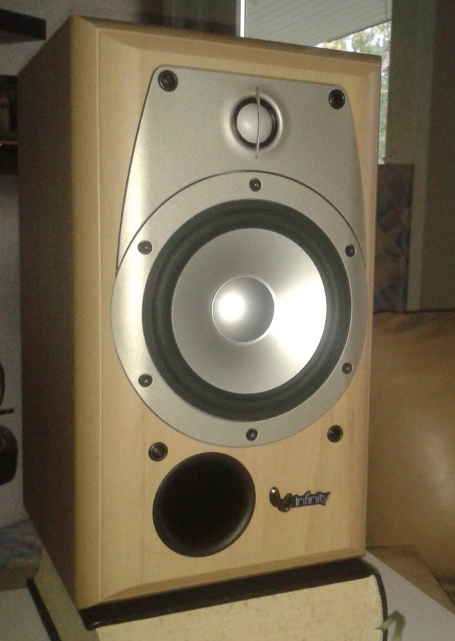

I made some measurements of a commercial low-priced Infinity Alpha 20 speaker. This is an European model made in Denmark in the beginning of third millenium. The box is approximately 12mm MDF and walls are covered with corrugated foam cell, no bracing.

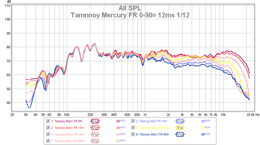

Nearfield measurements at 1cm distance from cone surface and the port. All done with same spl. We can see that port noise and resonances are in major role UMIK-1 mic with calibration, signal via usb-dac to amplifier. RoomEQWizard V5.19 beta6 software. Sorry I don't have a suitable microphone for box vibrations.

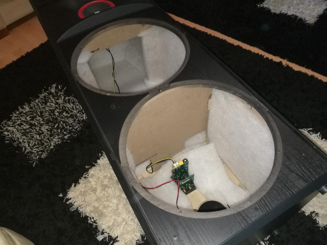

Tall boxes might have internal standing waves (multiple order) in the passband of woofer(s). One example is Cerwin-Wega CLS-215, which was measured by Soundstage. Look at response and impedance around 150Hz!
The revised version XLS-15 has a divider in bass compartment that should help. I couldn't find measurements, sorry.
