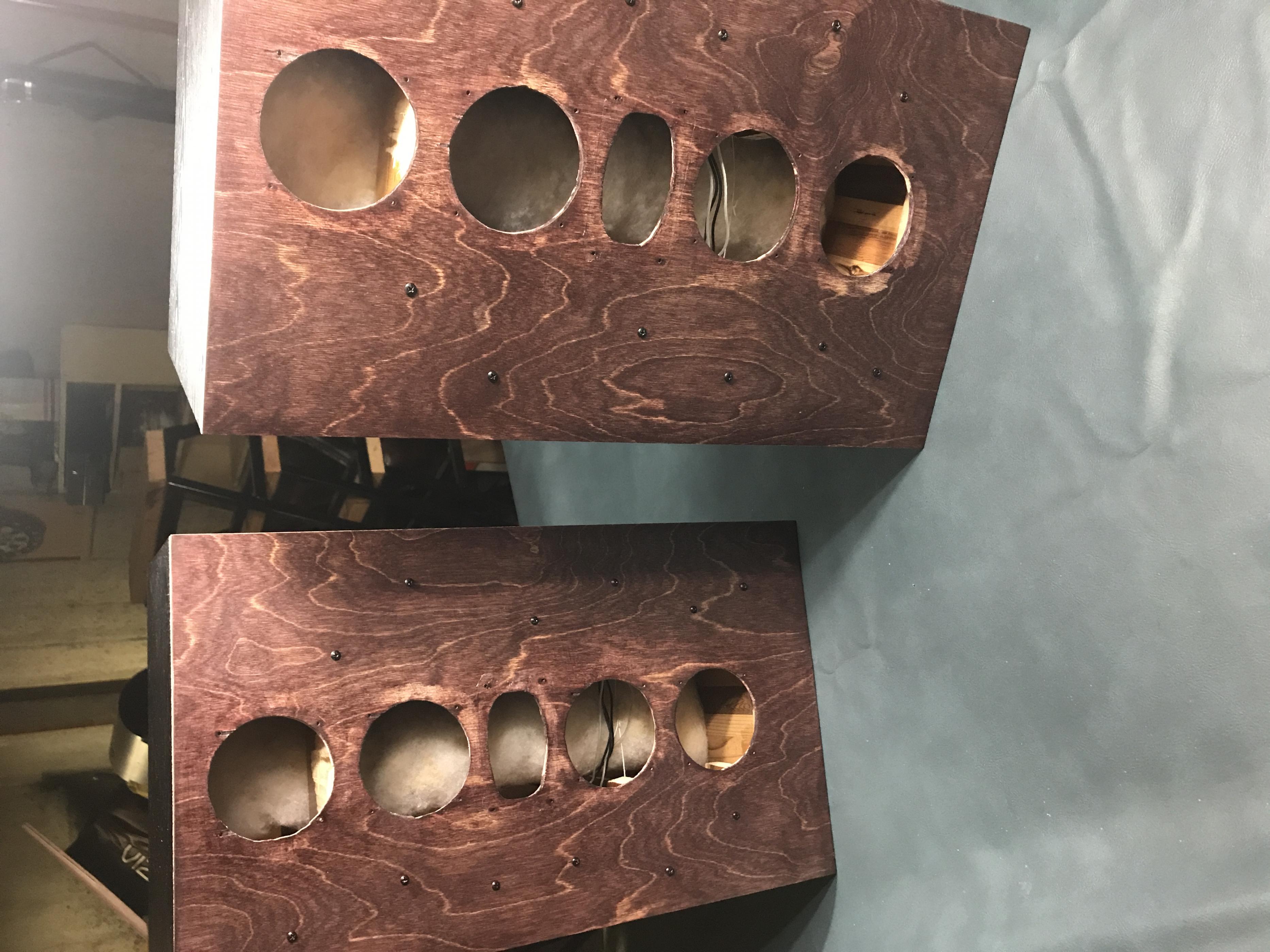

I redid some new cabinets over the winter. They have a sound absorbing "burrito" that sits in the center between the braces.
My opinion on the whole "musical cabinet" thing has changed. Ideally the cabinet should be resonance free and an acoustic black hole, meaning it gets rid of the back wave. It should also be stiff so that the only thing moving is the cone.

Hi Earl. Yes, I shouldn't have called it "harmonic". If one wants to spread out the resonances as much as possible then they aren't harmonic.
So a more "musical" cabinet (as I envision it) would not have conspicuous resonances at all. It would essentially reradiate the sound energy. Whereas a dead cabinet would absorb more of it.
My experience with the sound absorbing burrito is that properly done sound absorption can be very clean. But simply "stuffing" a cabinet will end up creating an impedance difference to the backwave and also have very uneven absorption of the sound which is bad.
As far as a musical cabinet the effect is to smear the sound. This might work better when one needs to offset some other kind of problem. For example masking some hard cone break up. Or in a small room when there is too much direct sound.
But if one has a proper room and proper source then an ideal cabinet that is dead will give the best imaging and reproduction of the sound. Again my experience.

Some conjecture. I wonder if reducing directivity is your goal, why not build an omni speaker? For that matter why have four woofers vertically in a large cabinet? They could reduce internal vertical involvement, and externally their increased directivity will likely reduce floor and ceiling interaction.As far as a musical cabinet the effect is to smear the sound. This might work better when one needs to offset some other kind of problem. For example masking some hard cone break up. Or in a small room when there is too much direct sound.
The cabinet in the picture is a redesigned cabinet for the quad 4 fusion speaker I built years ago. Quite frankly the original design had some flaws, but it also has a certain special quality. I think the narrowed vertical directivity is part of why I like it. I still haven't heard a speaker with as much emotional content. Its a horn tweeter and I definitely prefer to sit a good 5m from it. The new cabinet isn't meant to be musical.

Maybe my initial post was misleading. The cabinet in the picture is meant to be dead (though not perfect of course). Its built like a tank with a sound absorbing "burrito" in the middle. The main issue with mmtmm designs is that there is an inherent 6 db hump in the response when all 4 drivers are within a 1/4 wave distance. But I don't want to drift off topic.
But yeah the concept of a lively cabinet or using colorations to offset other issues is not ideal, but i wouldn't say its wrong either.

I would agree with you here - damping is the key, not where the resonances are. With enough damping the box becomes "musical" because it does not add to or take away from what is being reproduced. The speakers are not creating the music, they are reproducing it.
