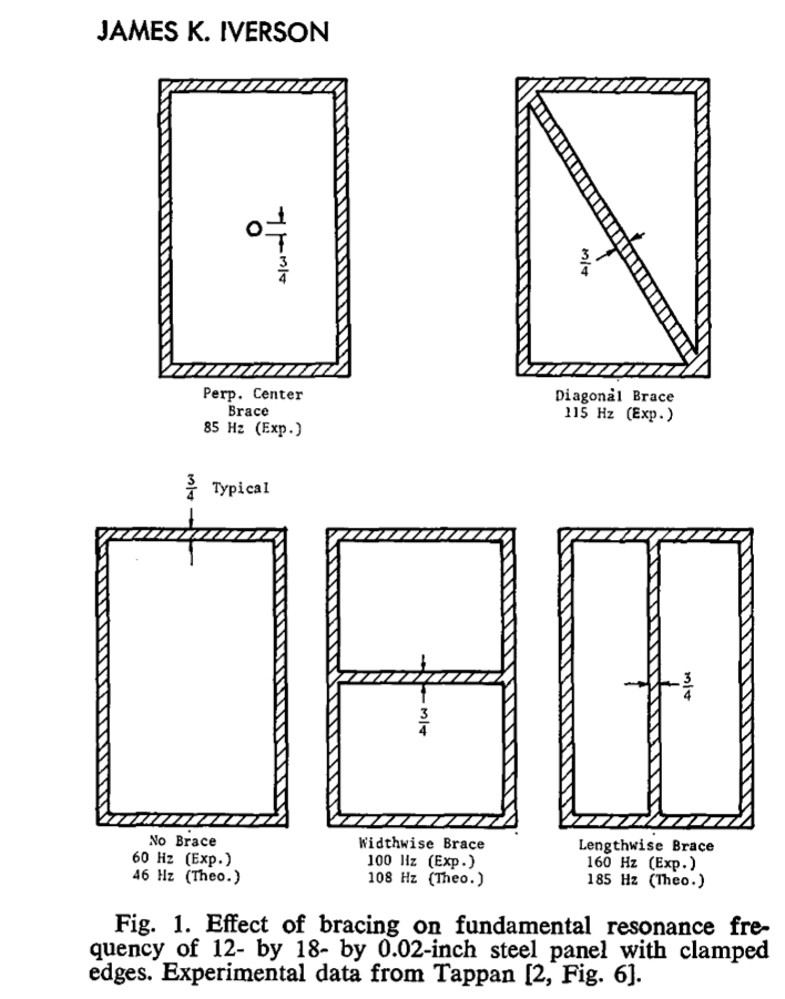

Althou a cube contains more volume with less material, that does not necessarily lead to a better panel. One of the cardinal rules of bracing a panel is that the subpanels have a higher aspect ratio than the original. A panel tends to vibrate across its smallest dimension and being smaller is at a higher frequency.
A square panel has 2 reinforcing modes, and for its area the lowest resonant frequency.
A trapezodal panel (or subpanel) is even better (assumming that the "short" dimension is the non-parallel one).

The point is that a small deviation from "cubic" yields a fairly large spread in the three coincident resonances from a cube. My thesis was on non-rectangular rooms so how resonances are spread by "shape" is something that I am very familiar with. The usual "golden rules" like the GR turned out to not be very useful - not that they were bad mind you, they just didn't yield much if any improvment. In shape it turns out there are a few shapes to avoid, mostly dimensions that are integral numbers of each other, but if you avoid those, then everything else turns out to all be about the same - including a "near cube". But the "near cube" ends up with the lowest surface area FOR A RECTANGULAR STRUCTURE (I can't believe that I have to make that qualification!).
