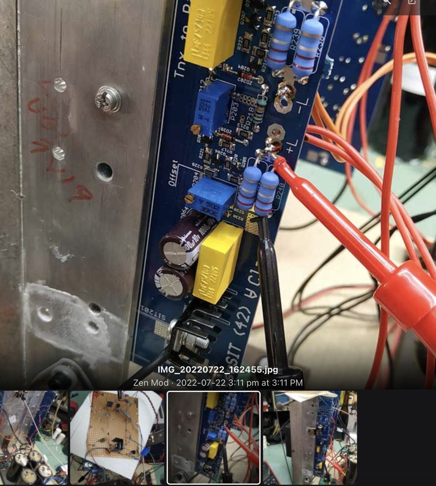

yes, 1A5 initially
when both Iq and DC Offset are in ballpark, fine tune both in temp equilibrium ( not that it matter much, but procedure yadayada)
1A6 to 1A8, whatever makes you happy
1A6*0R11=176mV

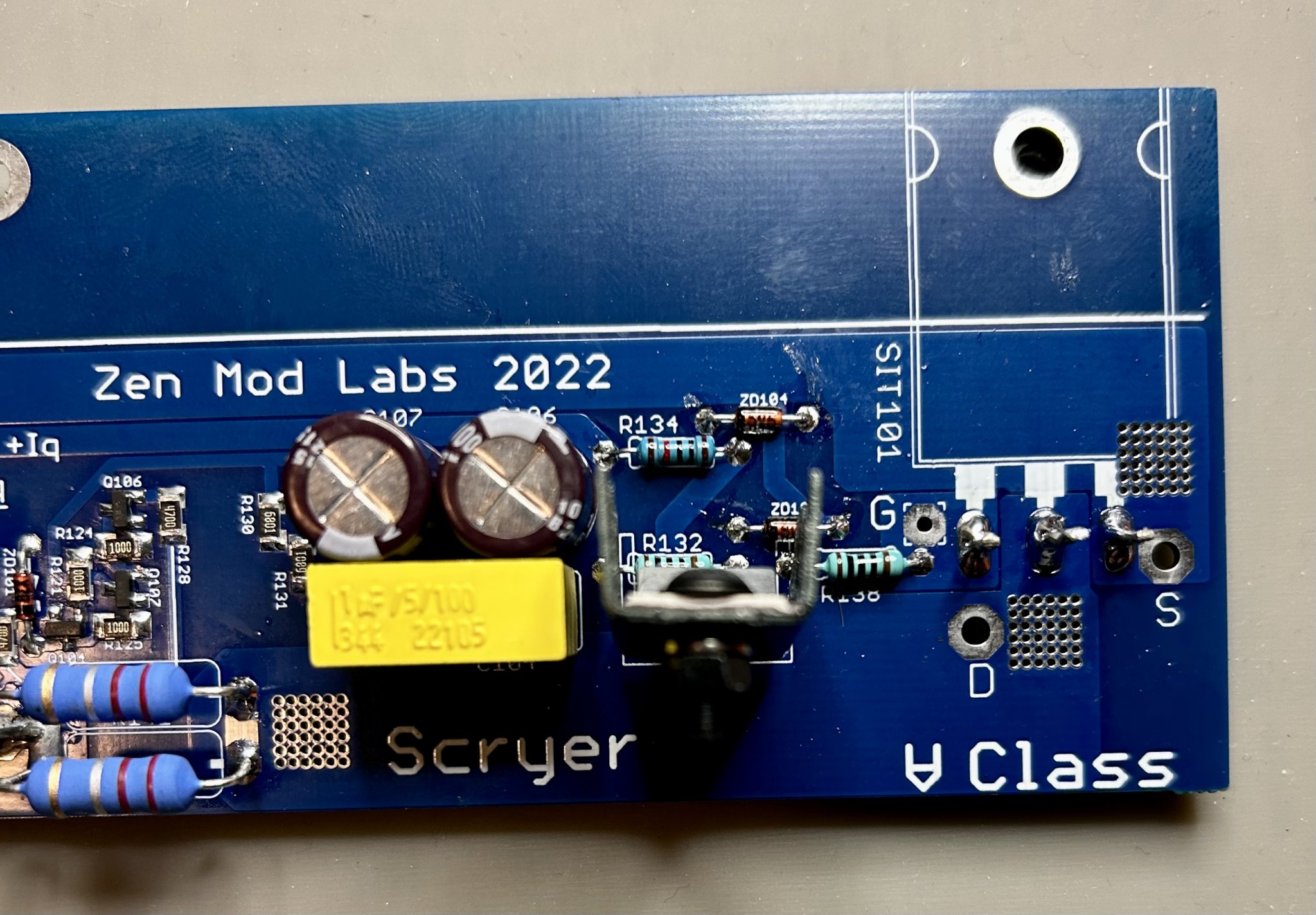

Darn. One side adjusted fine. The second channel only reads 3.5mV across the resistor for the full travel of the trim pot. Big sink is cold. Little sinks are slightly warm. All sinks on the working channel are appropriately warm. Bias trimpot works as expected.
What would cause there to be no Iq? Backward trimpot? I hope not a dead SIT…
What are some test points I can measure for context? I can get to the SIT and big mosfet pins easily.

check that you have 1V2 across R122
diodes orientation etc.

1.186V across R222. Orientation of all diodes, caps, and transistors look correct.

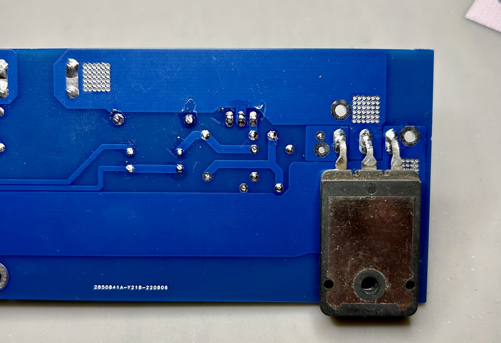

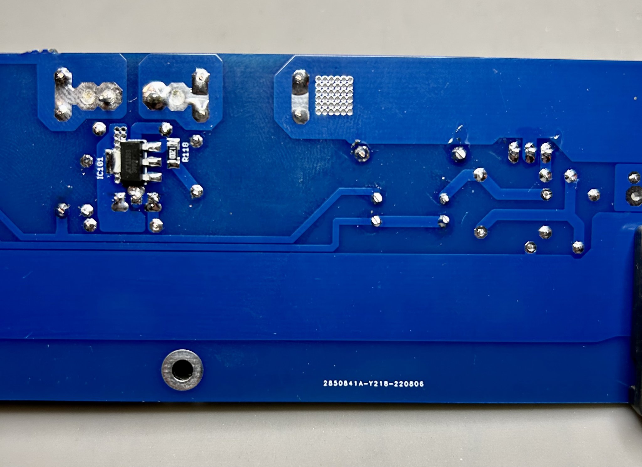

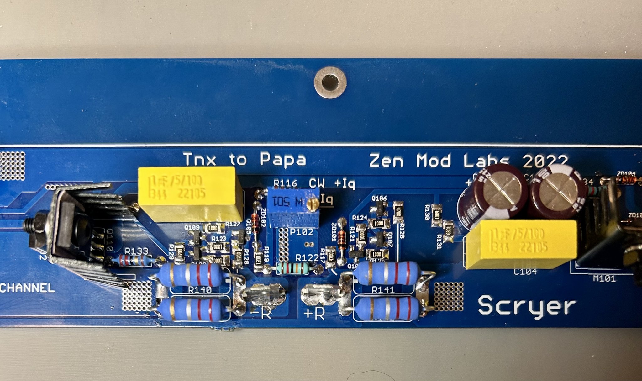

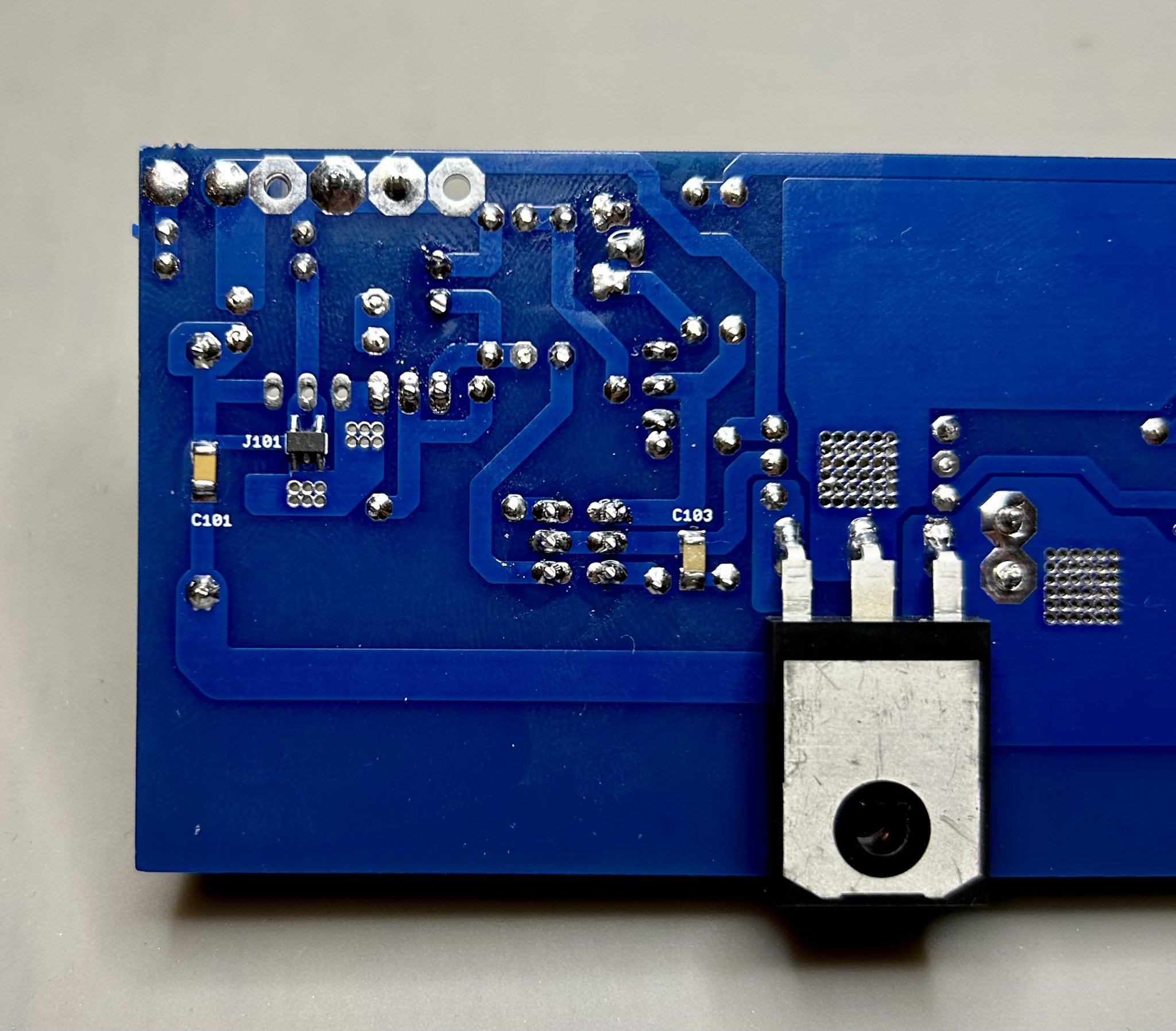

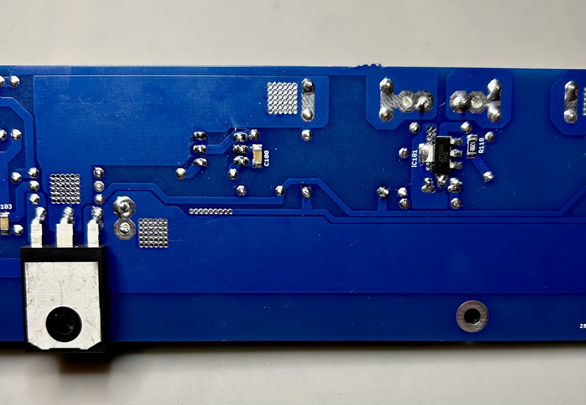

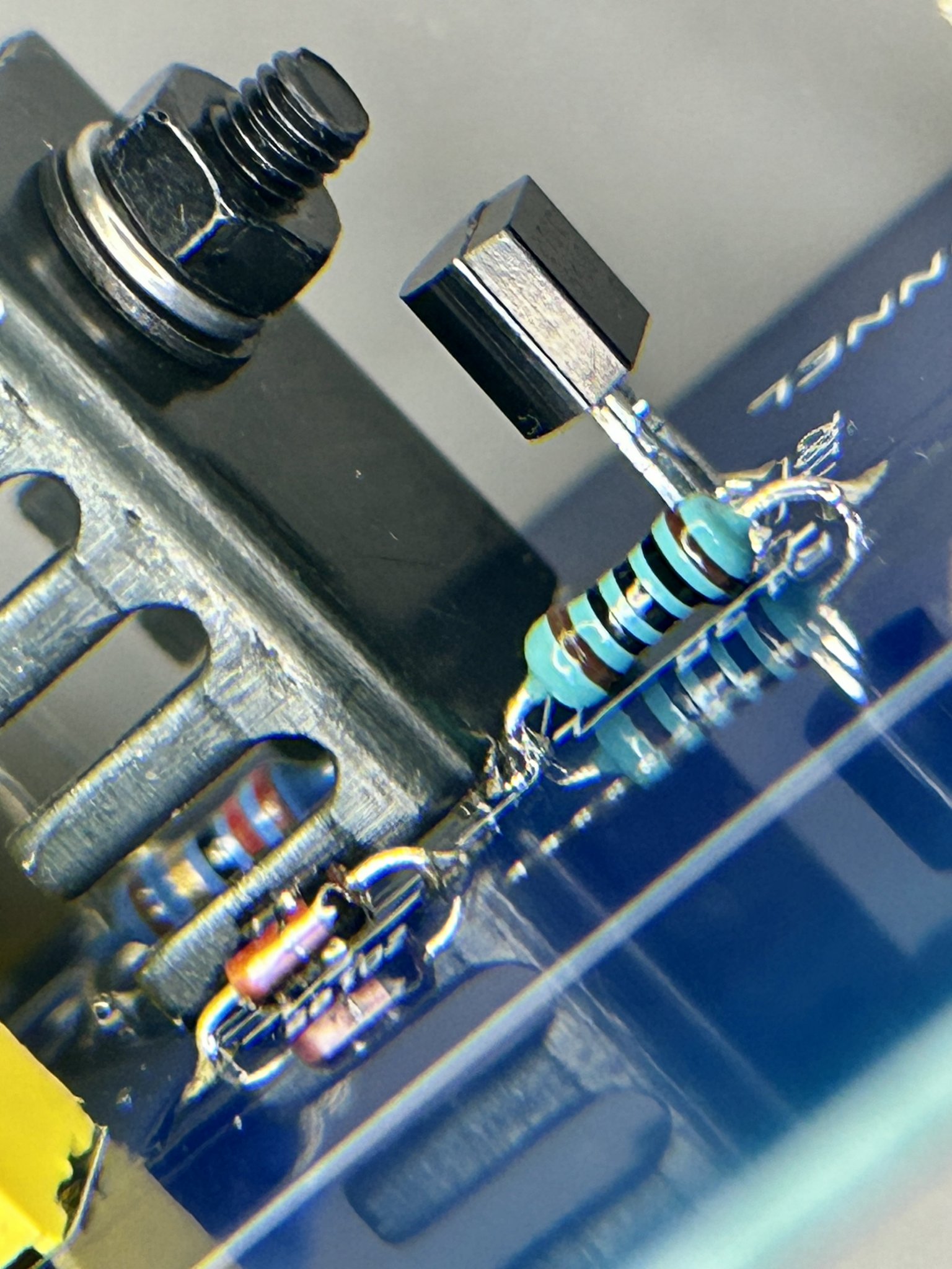

Pictures!

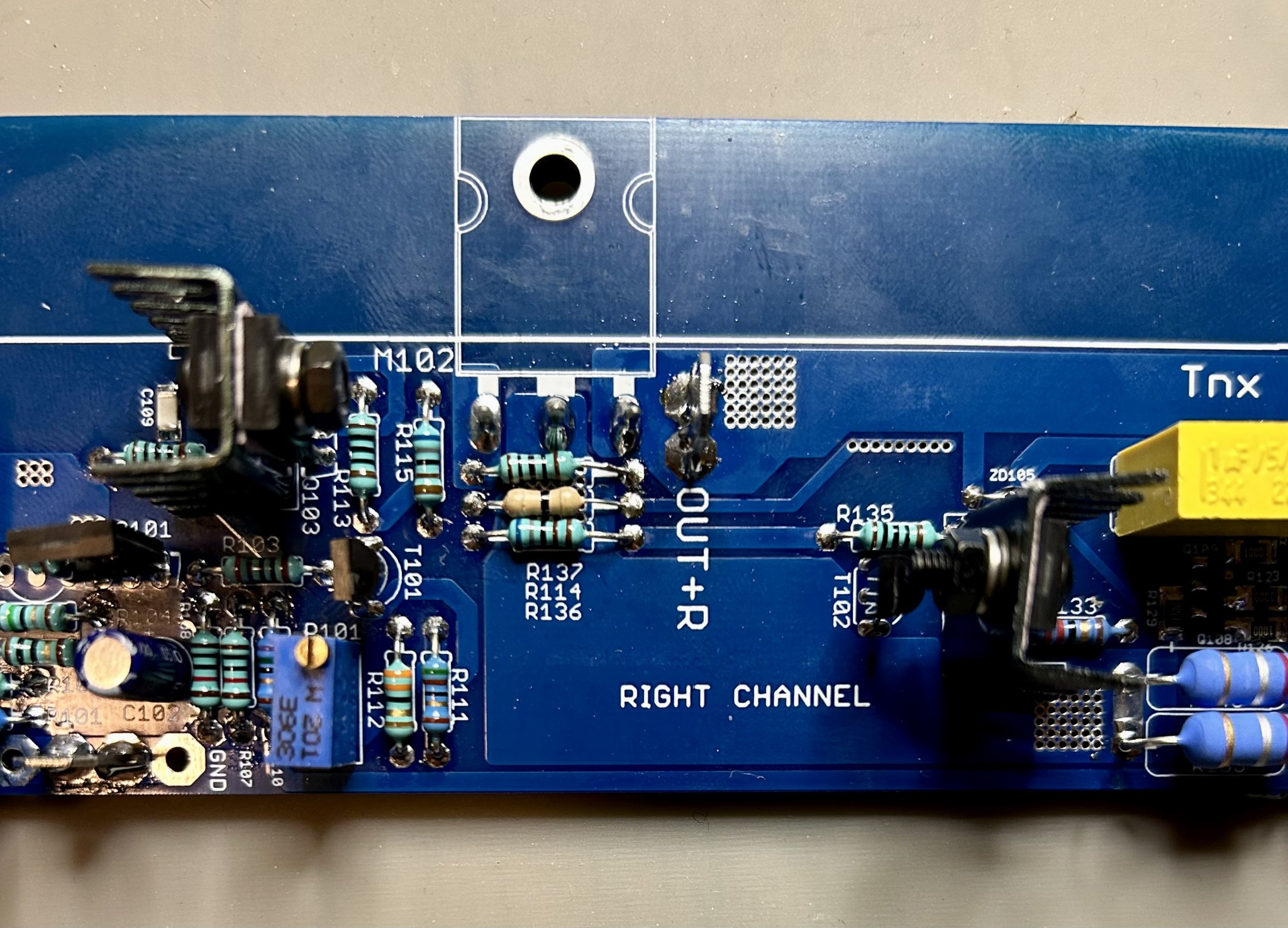

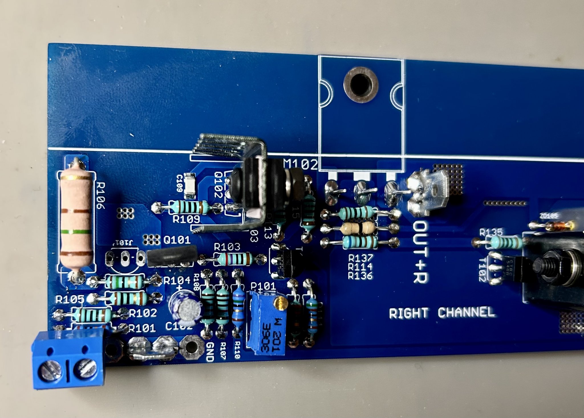

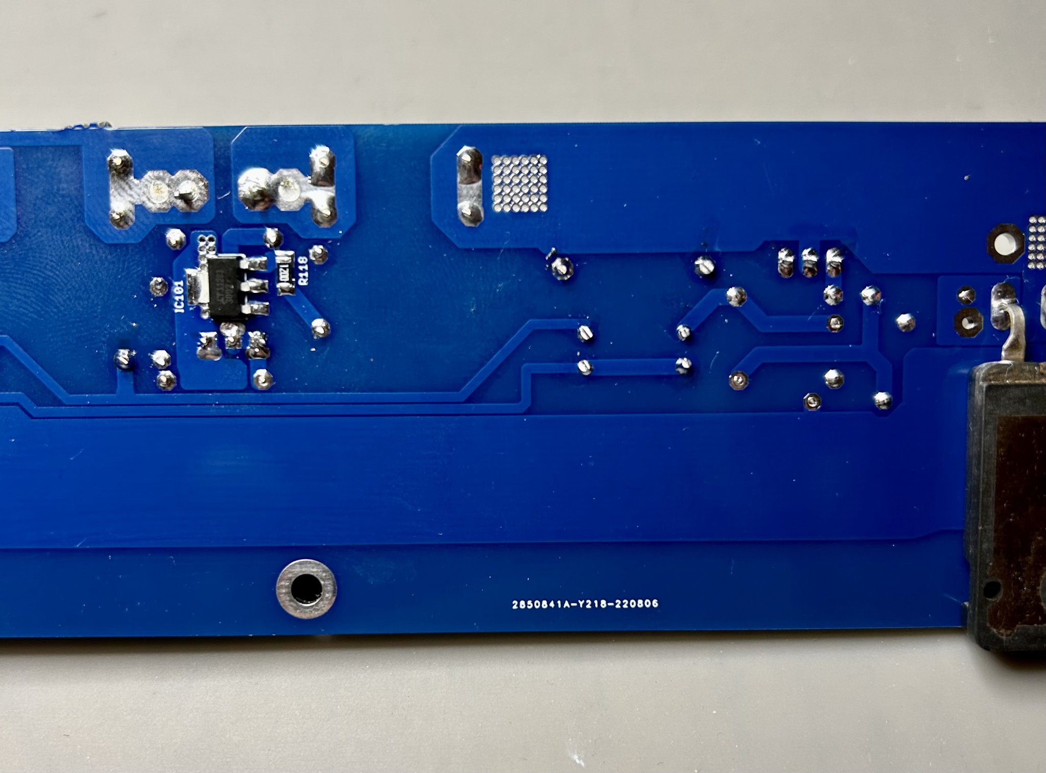

I discovered a loose strand of wire (tiny!) on the board when I got it out. That could be one possible culprit.
I touched up one suspect solder pad for the 0R resistor (it wasn’t bad, but what the heck).
What about the little heatsink touching R135? Could that be a problem?
Let me know if you see anything awry!
