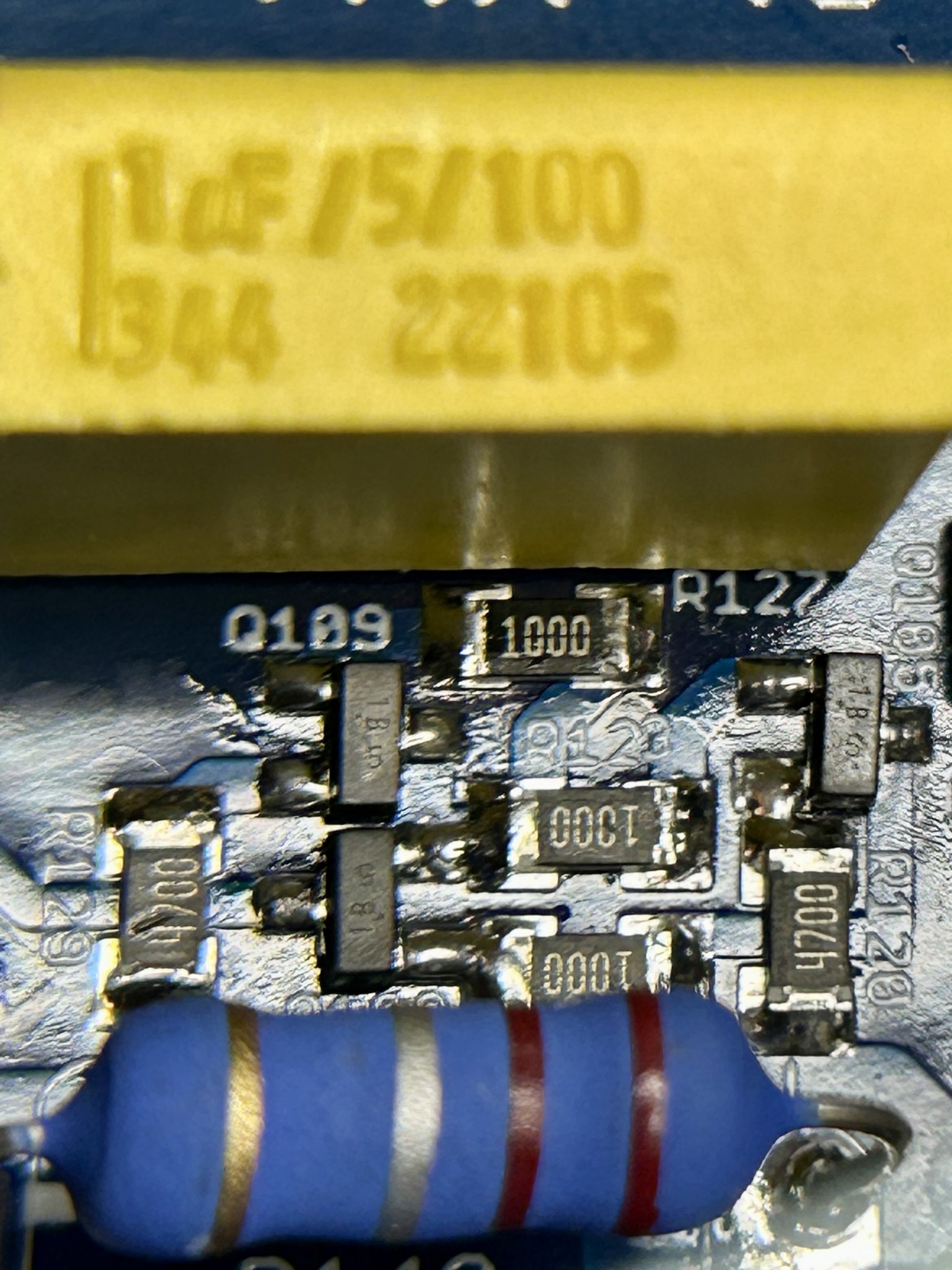

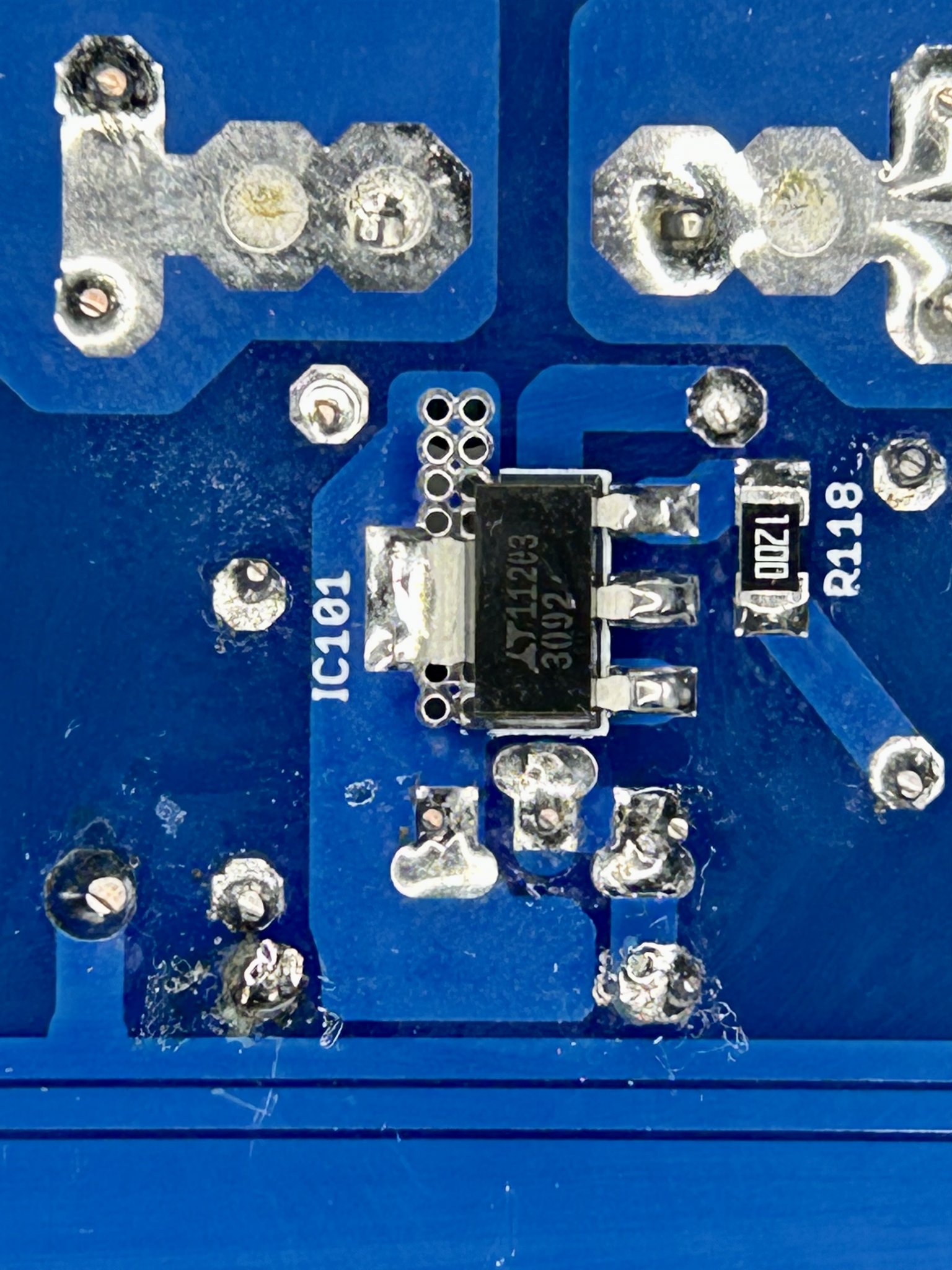

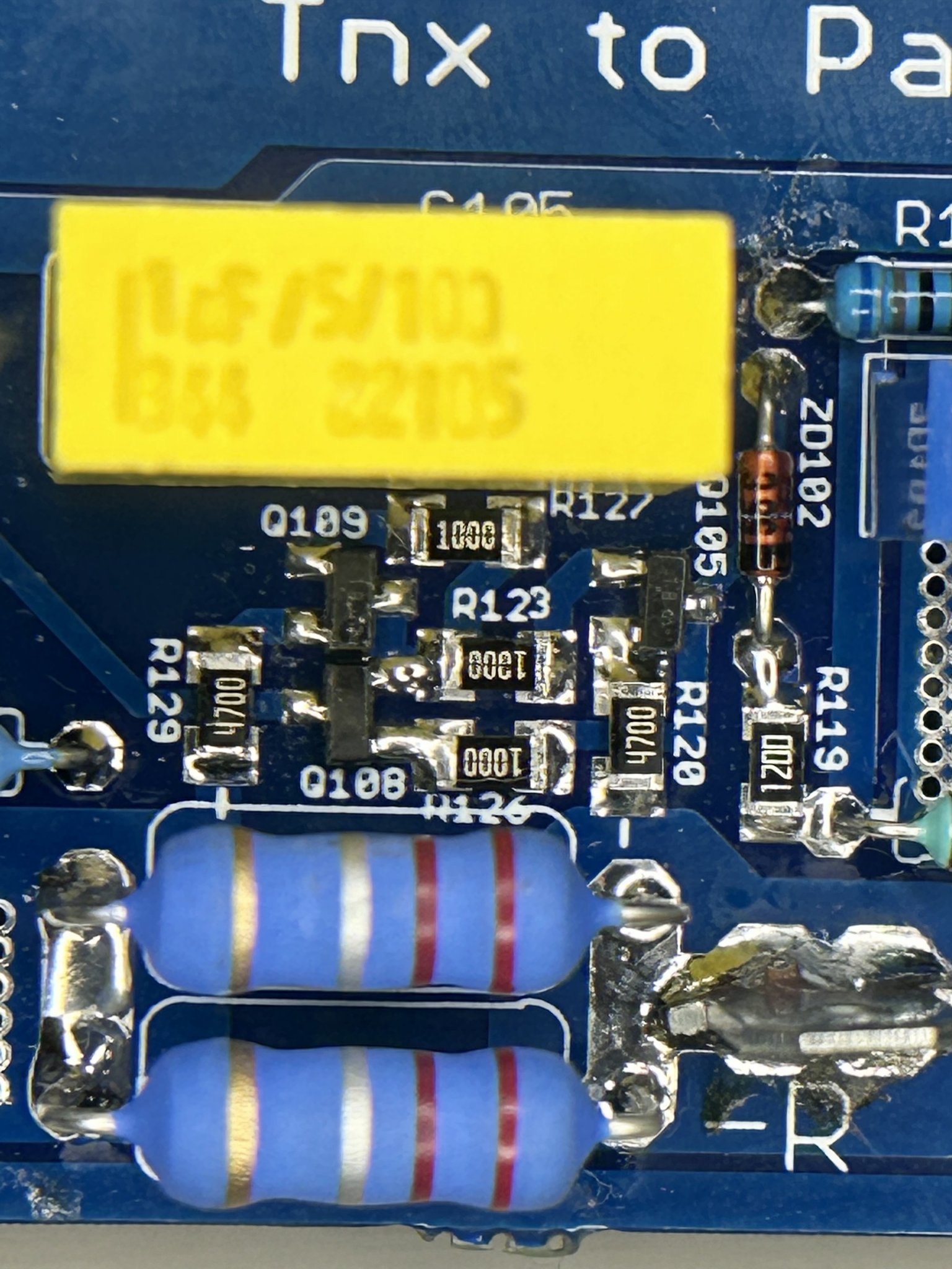

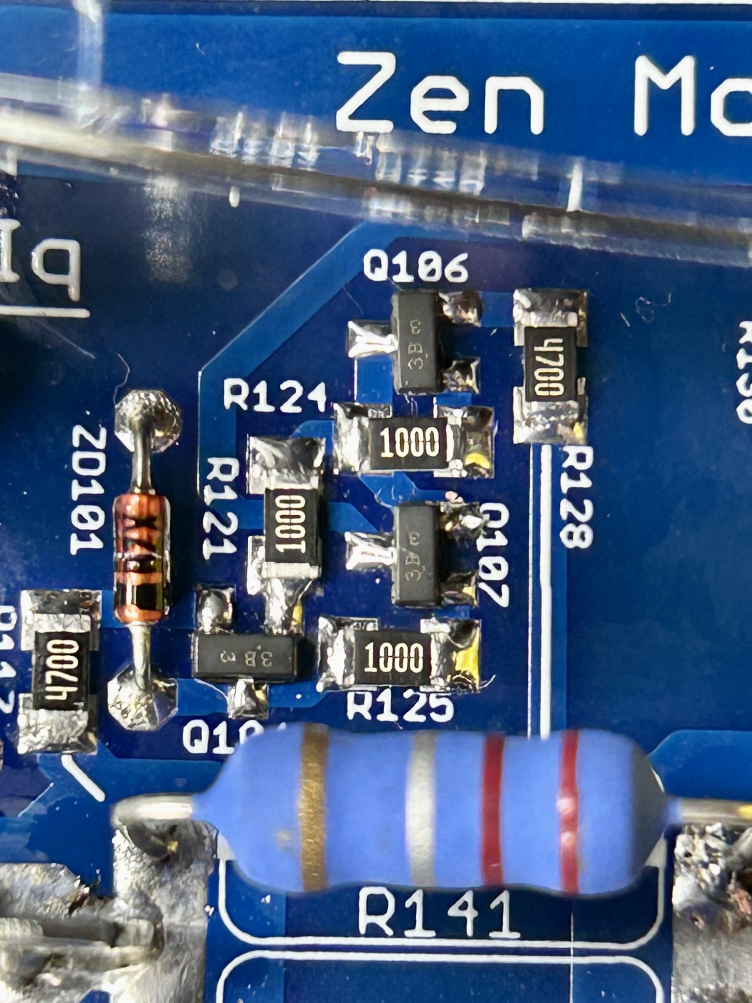

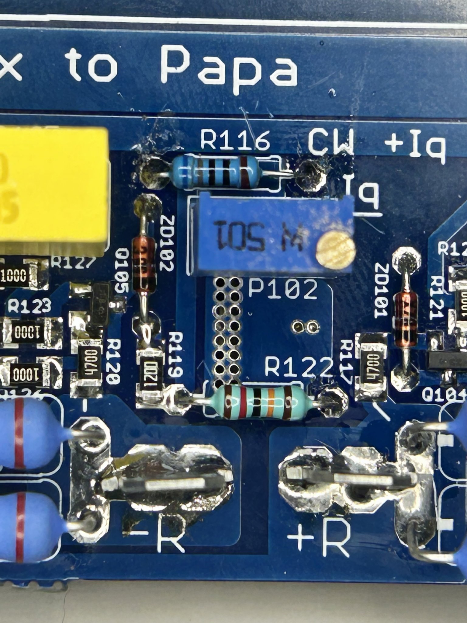

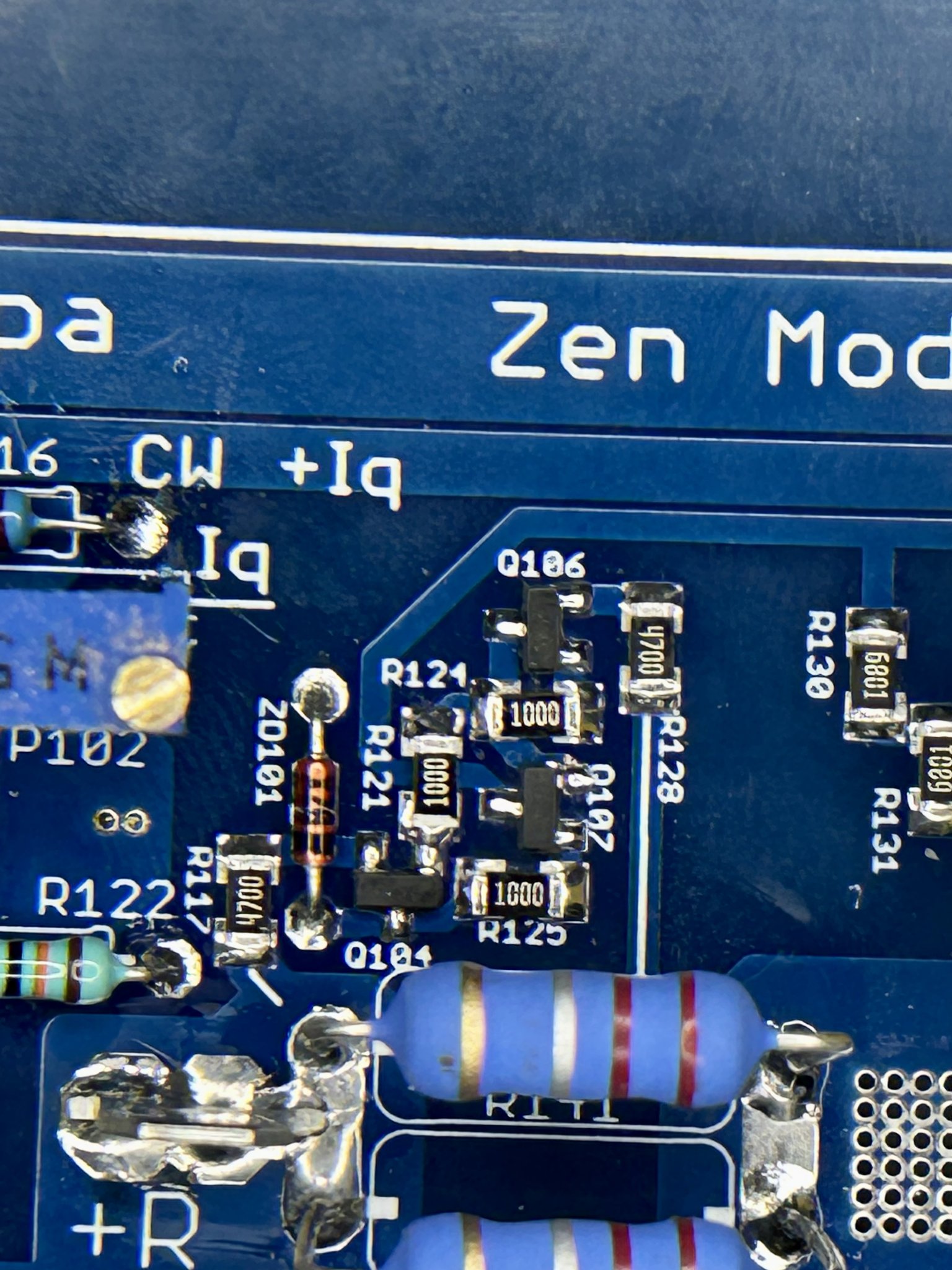

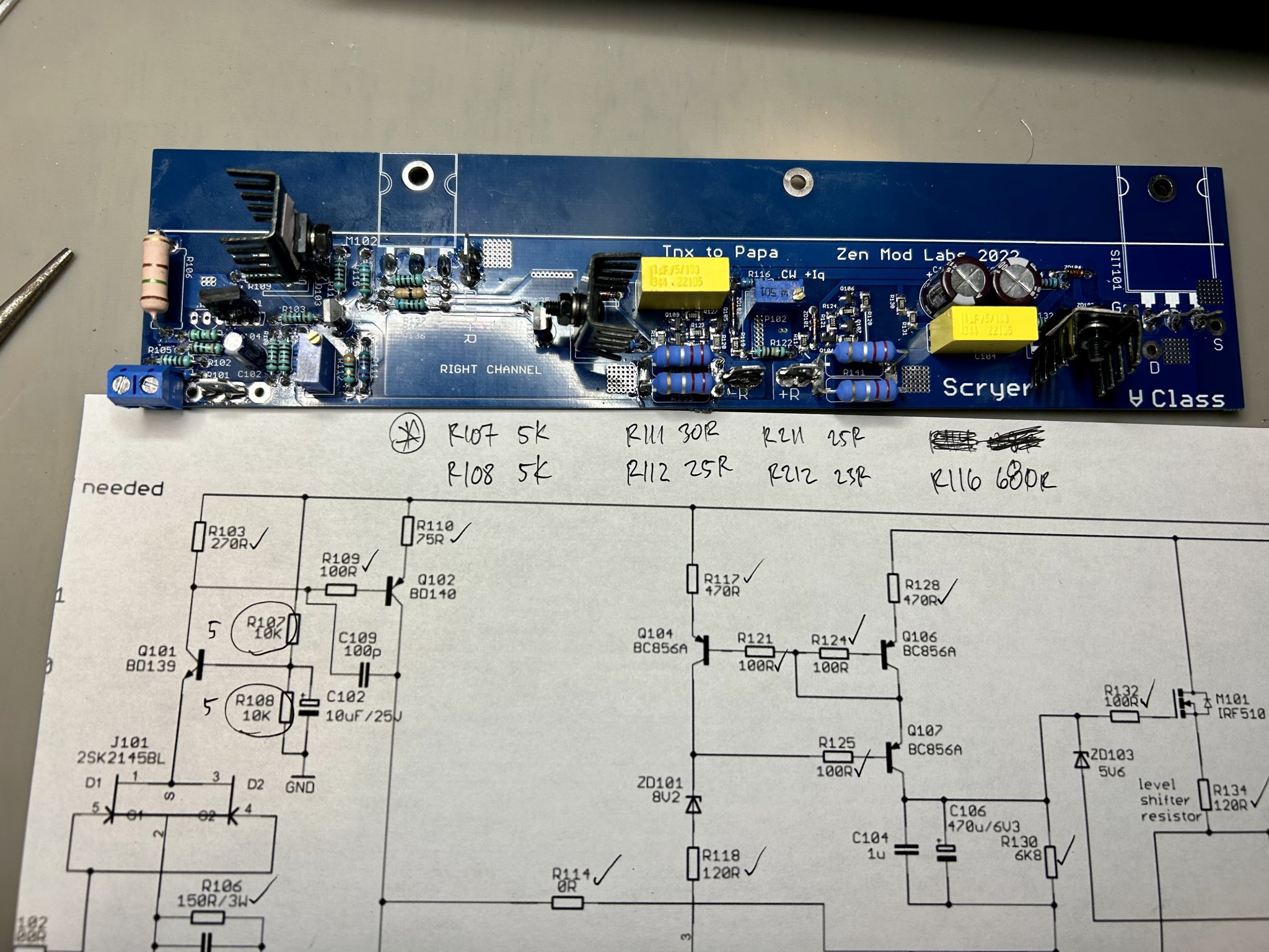

Results from measuring resistors in-circuit (power off) below.
Deviations from the schematic:
I’m working on identifying all the little bjts…
- R107 measured 5K (10K in schm)
- R207 5K (working channel)
- R108 measured 5K (10K)
- R208 5K
- R111 measured 30R (51R)
- R211 25R
- R112 measured 25R (33R)
- R212 23R
- P101 measured 60R to 0.8R (200R)

all of these resistors are pretty much irrelevant for Iq
continue with everything right from R114, looking at schm in posts #44 or #188
one pic all "1-B"
second pic all "3-B"
so, my OCD still functional
try checking all resistors in situ, primarily comparing to same measurement on proper channel pcb
be sure to have probes same oriented on both channels
even if in some cases you can't get valid measurements ( resistor being in circuit), comparison with proper channel can give us some idea

Understood. I’ll check all resistors from the good channel and compare.
To confirm, do you mean measuring resistors with power off? I hope so. It’s tight in there and getting the resistance measurements with the board out was challenging enough. 😀

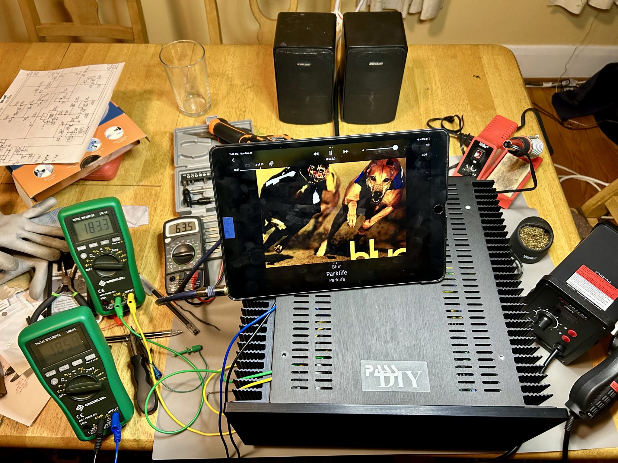

Apologies for going off script, but I changed out the SIT in the errant channel.
Biased up fine. Cooking in now with ~ 180mV across R141. DC offset drifting around less than 10mV.
Woo hoo!
Woo hoo!
Test speaker run is a go! Sounds VERY GOOD. Only the faintest of hum from the SMPS, which is to be expected with my nest of wiring.
Gonna chill with this for a bit, then migrate to the main system to see how it compares to the TDV!

Starting now! I’ll let you all know.
(Edit: the hum is gone while connected in the main system)

Great news !!Apologies for going off script, but I changed out the SIT in the errant channel.
Woo hoo!
So the issue was a defective SIT ?
Was it bought from a reliable source?
Eric
Correct, the SIT appears to have been the problem.
I luckily got 10 from a dubious source right when the original thread about the K2087C started here. They were obviously pulls from older equipment.
I didn’t spend a lot, and ended up with two pair that have worked for me. Two other lucky forum members got a pair of K2087Cs from me.
