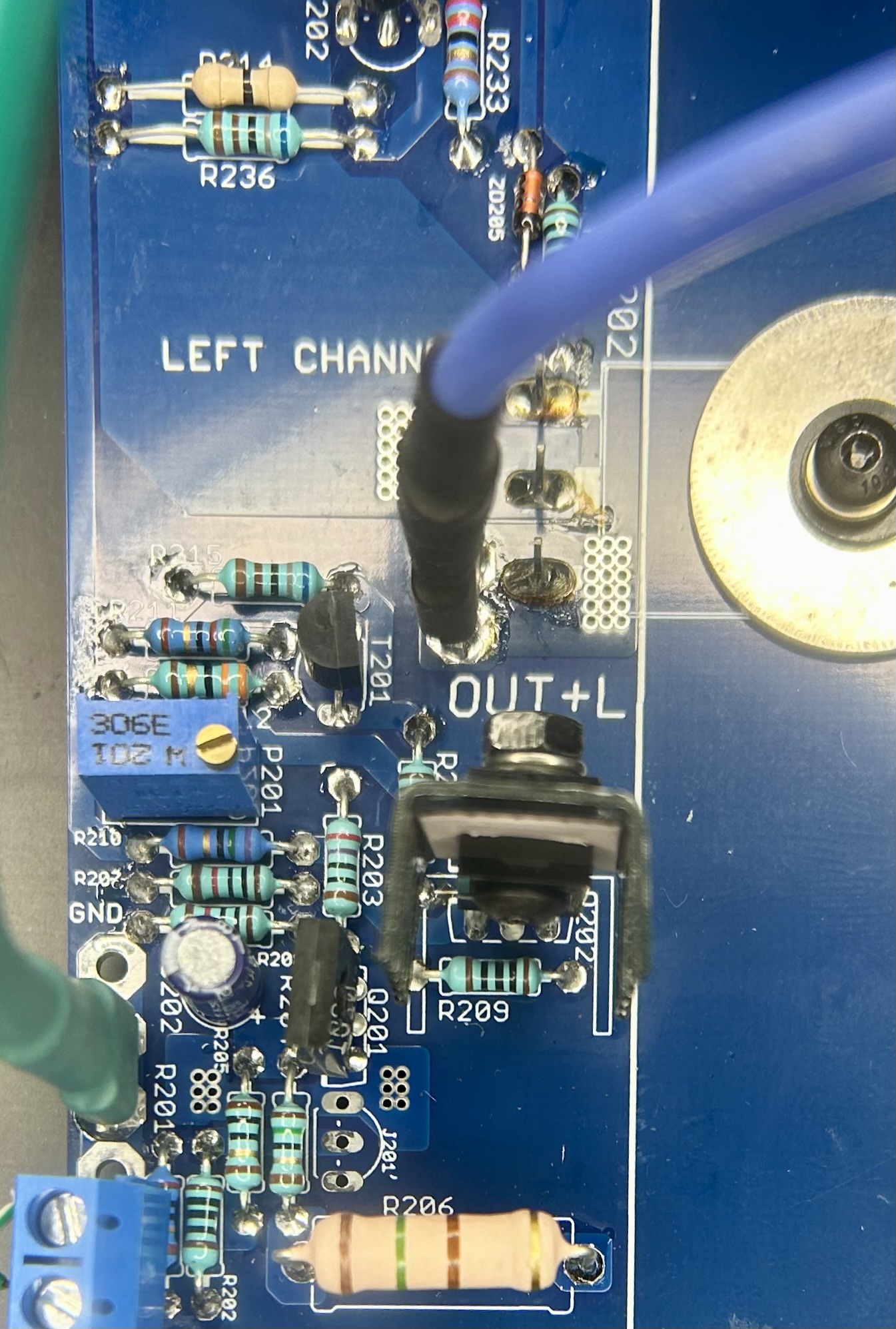

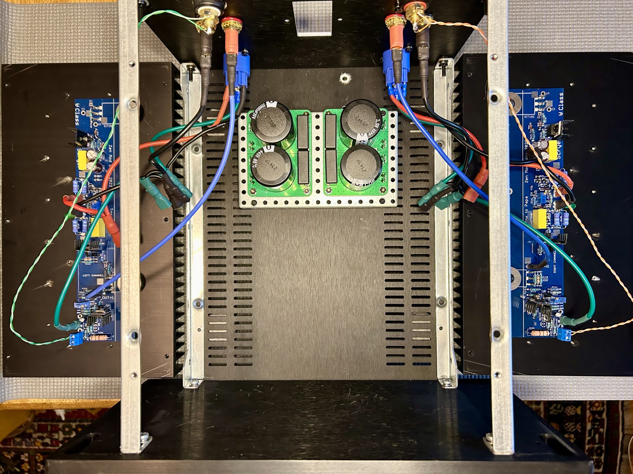

My beloved Scryer has developed a cough. He is no longer scrying.
Recently I inadvertently left the system on overnight and discovered the next morning that the Scryer had a pulsing scratchiness and 1.5 VDC offset in one channel (Left) and slight mains hum in both.
I’ve got the Scryer splayed out like a Christmas turkey on the table and am trying to reason out what to troubleshoot. I disconnected the local cap bank and powered directly from my test supply and the same symptoms are there.
Where should I start? Lots of pictures? Measuring points for DC voltage?
Humbly awaiting guidance from the OmniLangstrump.

first check/replace output mosfet - it's certainly most hard working element in chain
can't see/remember what you have as mosfet thermal arrangement (Keratherm, ALumina pad, mica), but it must be one of these
anyhow ........
measure Ugs for both SIT and mosfet ..... easy with one probe on hot speaker output, second probe to gates
check Iq
check DC Offset
and yes - you can measure voltage across level shifting resistor ( at IRF mosfet follower), write what value of resistor is used
write here

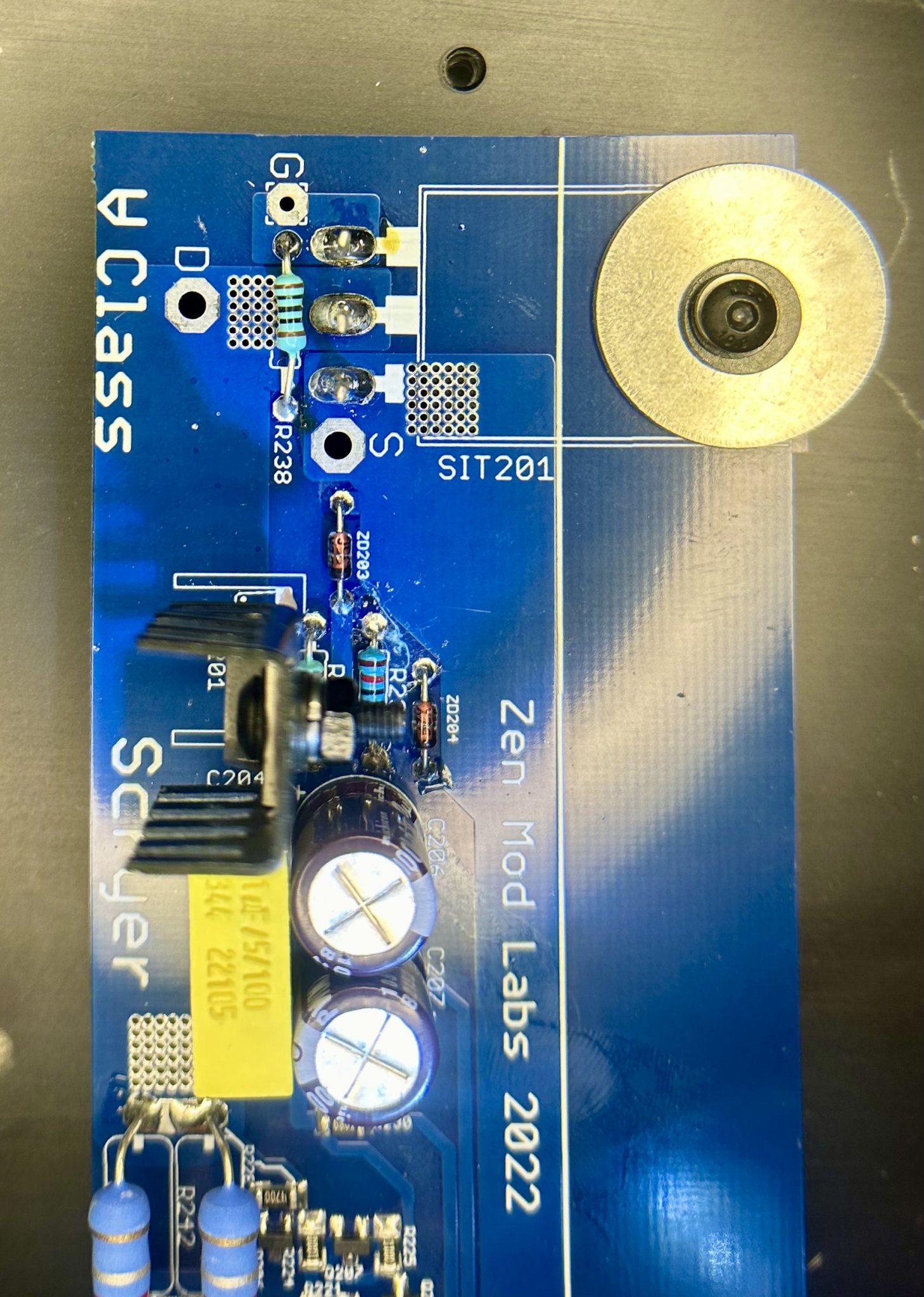

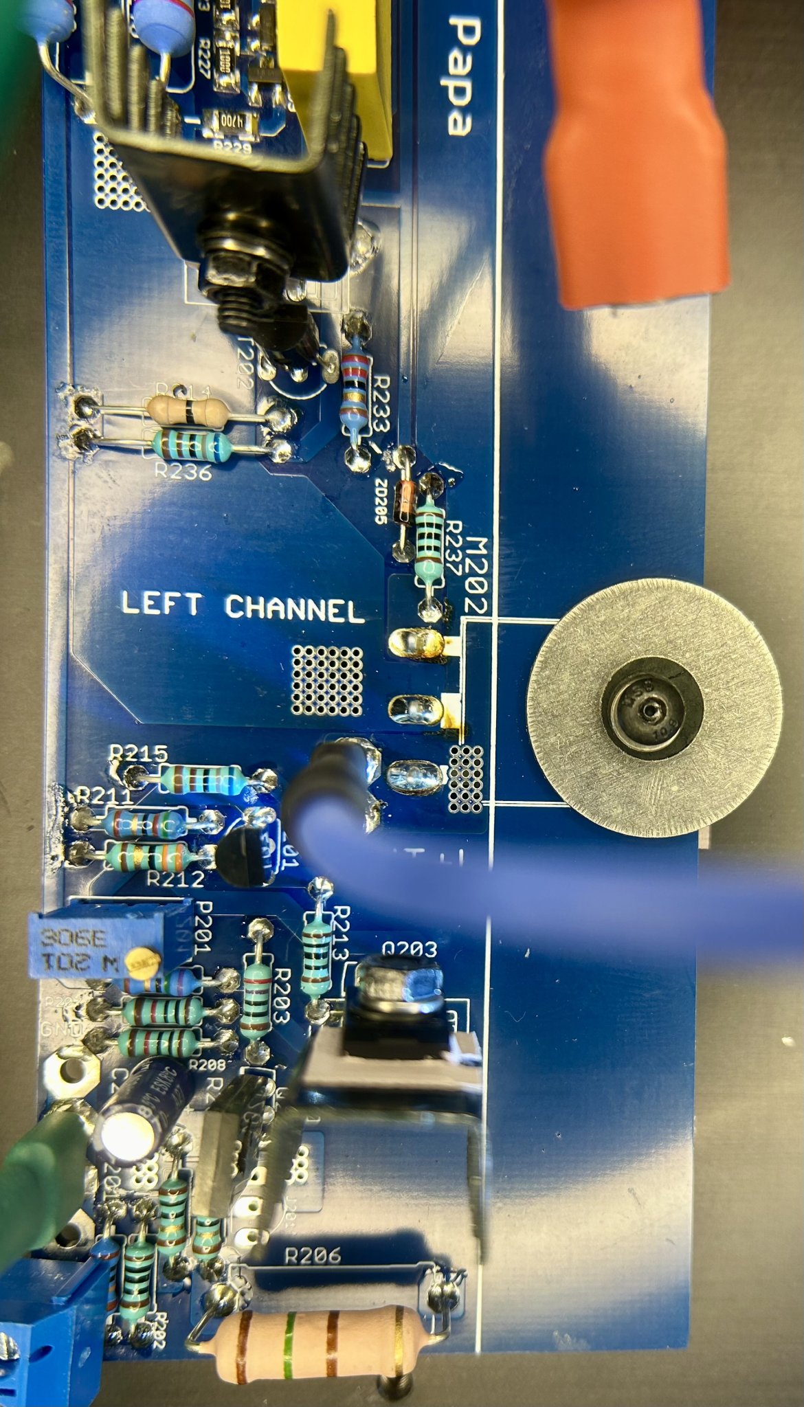

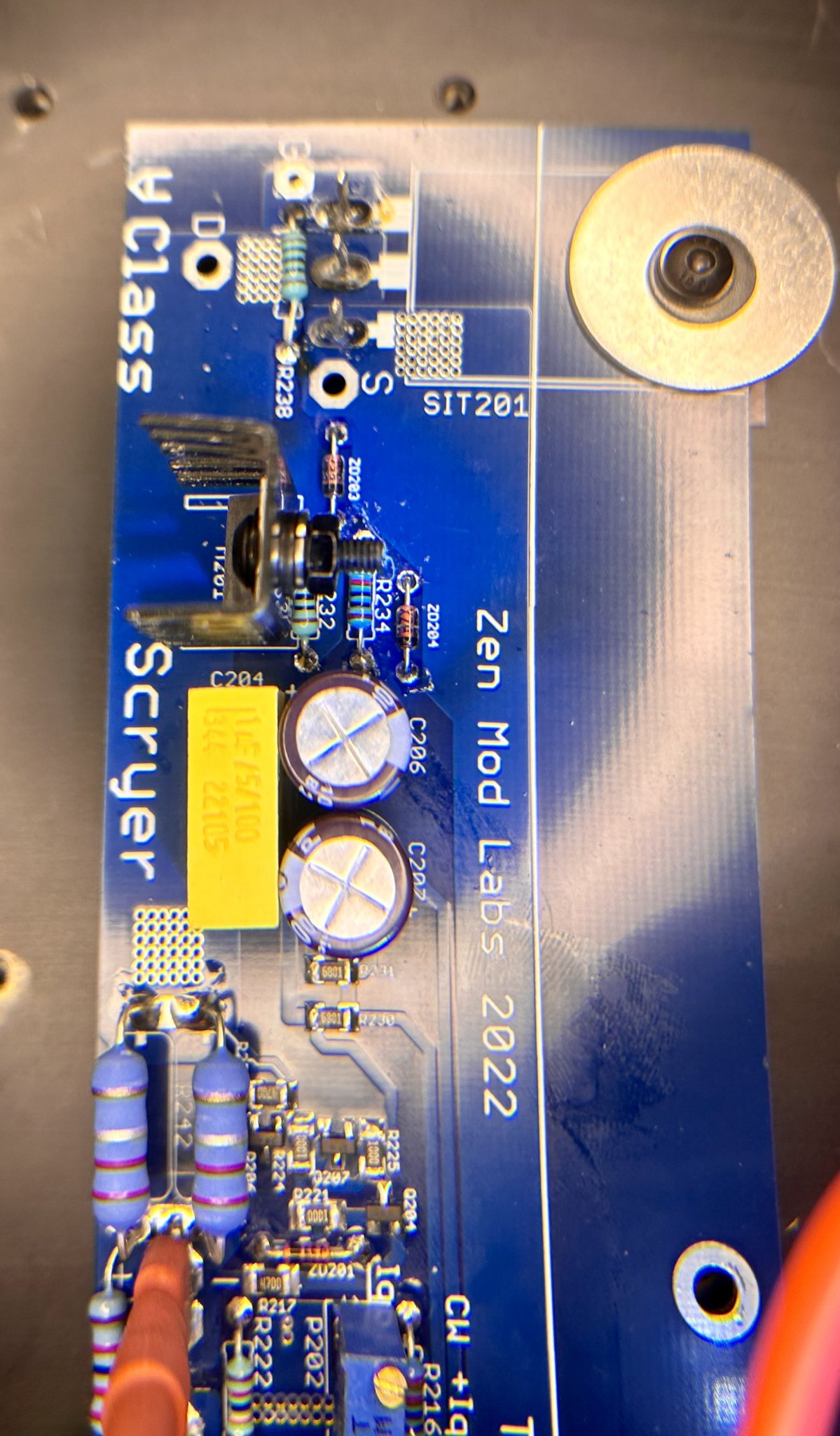

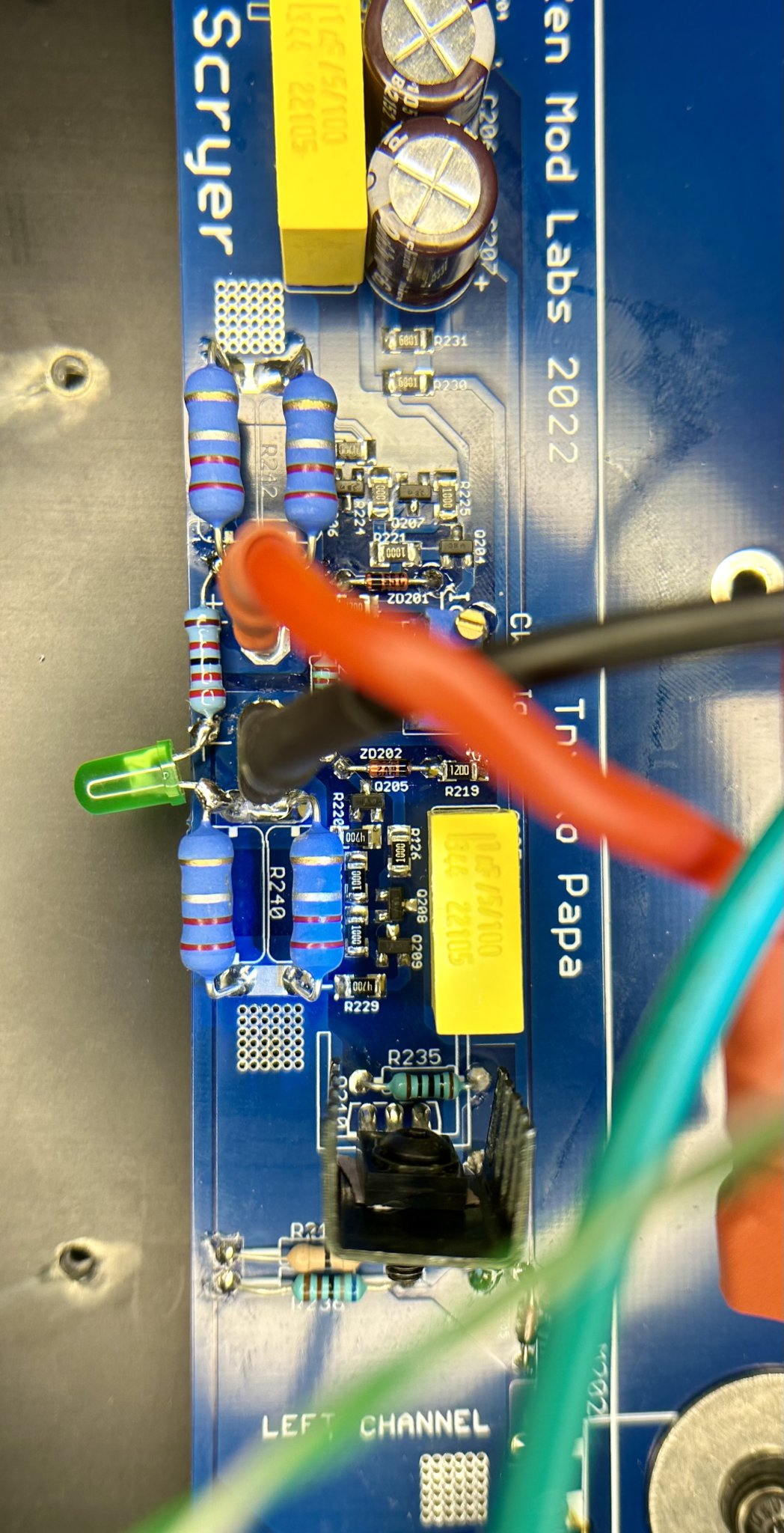

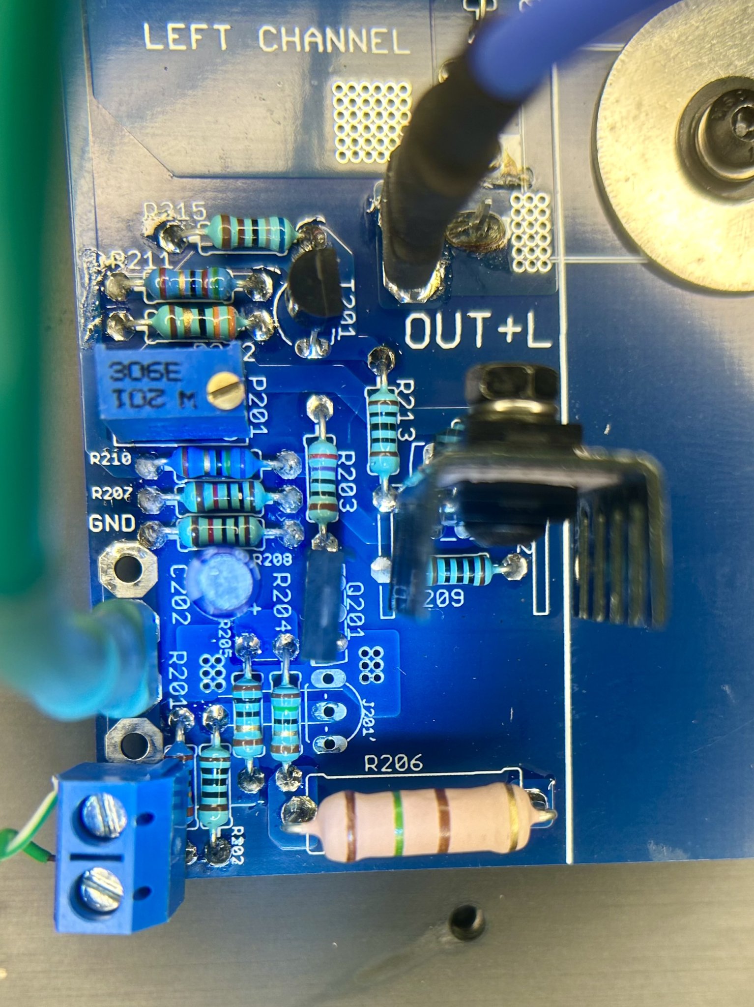

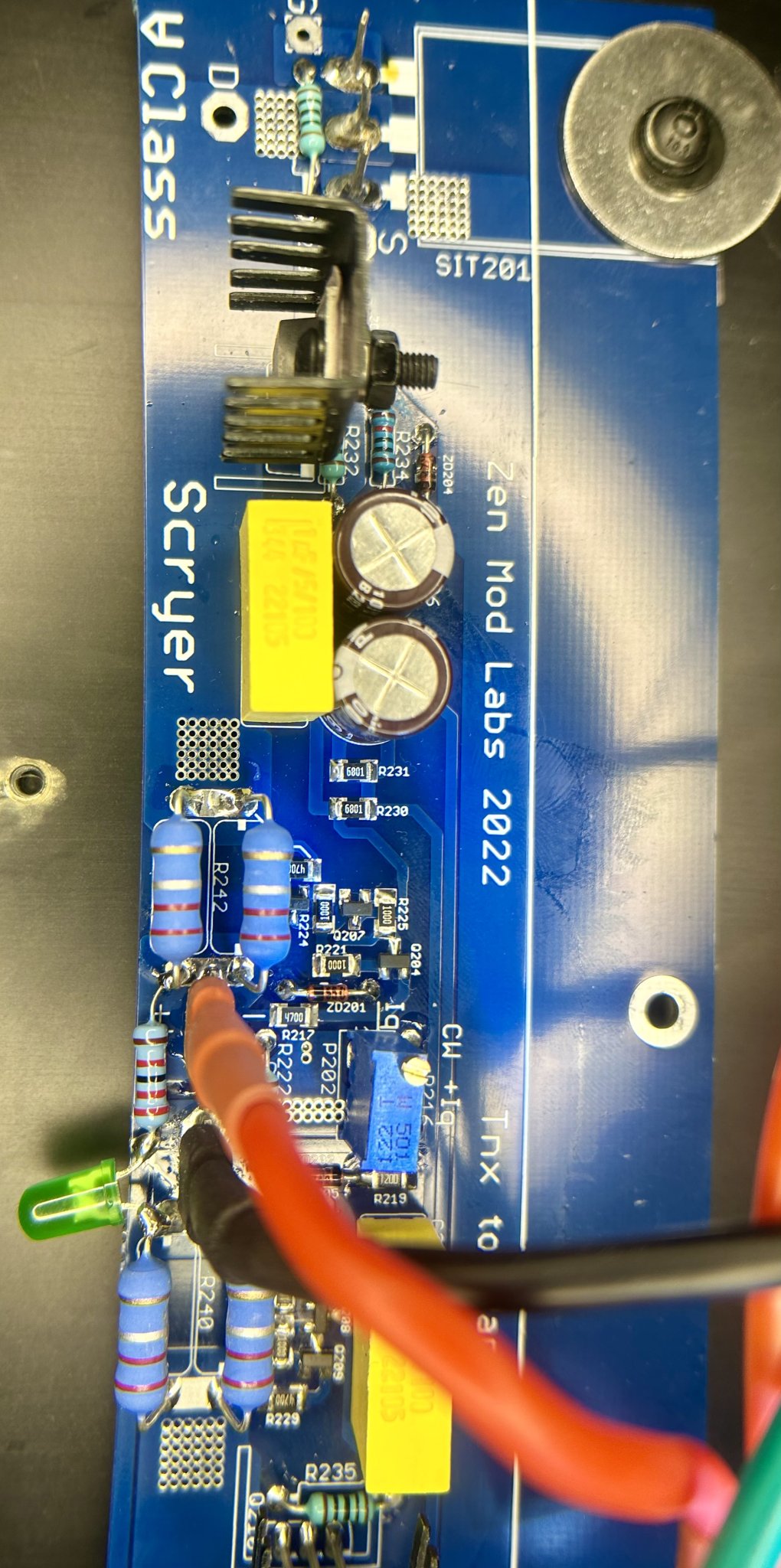

Keratherm is under the big fets.
Pictures attached for staring at goats while I get those measurements…

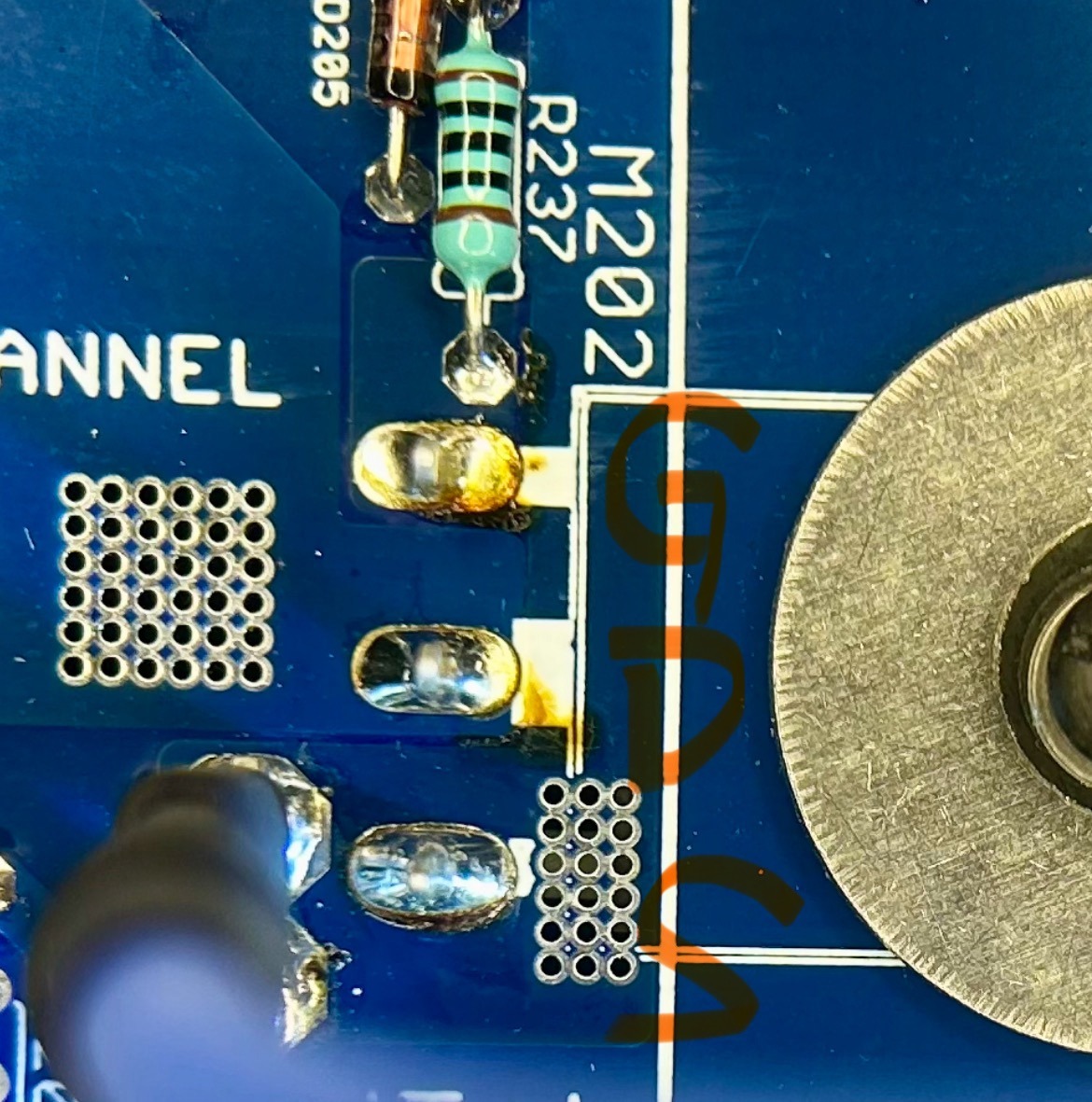

Is R237 the one you’re referring to?

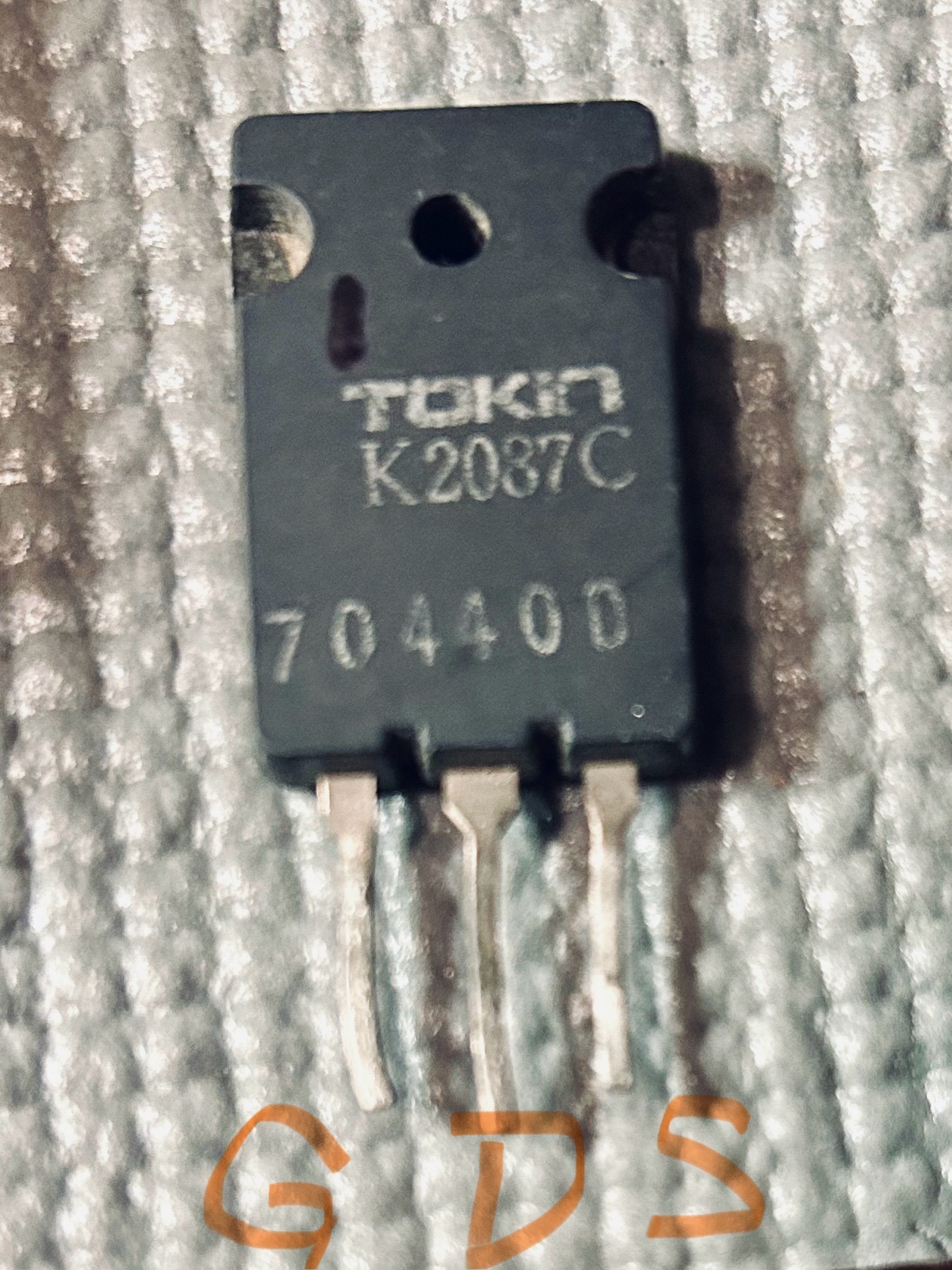

Do I have the GDS correct in the last two photos (that’s my last spare SIT)?

ref to schm in post #7, level shifting resistor is R134 (R234)
I'm saying that mosfet is working hard, not SIT; as far experience lead us to this moment, SITs are hard to kill or even damage, and I believe same applies for Baby SIT (2SK2037), not just big ones
gate resistors are R127 and R138, so that will tell you where gates of SIT and mosfets are
for both applies, G-D-S , from left to right, letters to ya, pins down
R234 is 120R
R234 3.5V and falling 1mV /sec
MOSFET ugs 4.17V stable
SIT ugs 1.67V slowly falling
Iq 165 mV across R240 slowly rising
DC offset 905 mV and climbing 1mV /sec

R134 is 120R
R134 3.47V and falling slowly
MOSFET ugs 4.29V stable
SIT ugs 1.98V slowly falling
Iq 180 mV across R140 climbing slowly
DC offset 30 mV and climbing slowly

It appears I only have 9240s available.
you can use that one - at least for test, and replace somewhere down the road
rotate it 180deg, use short wires to solder it to pcb, less work that way and no need to bend pins
