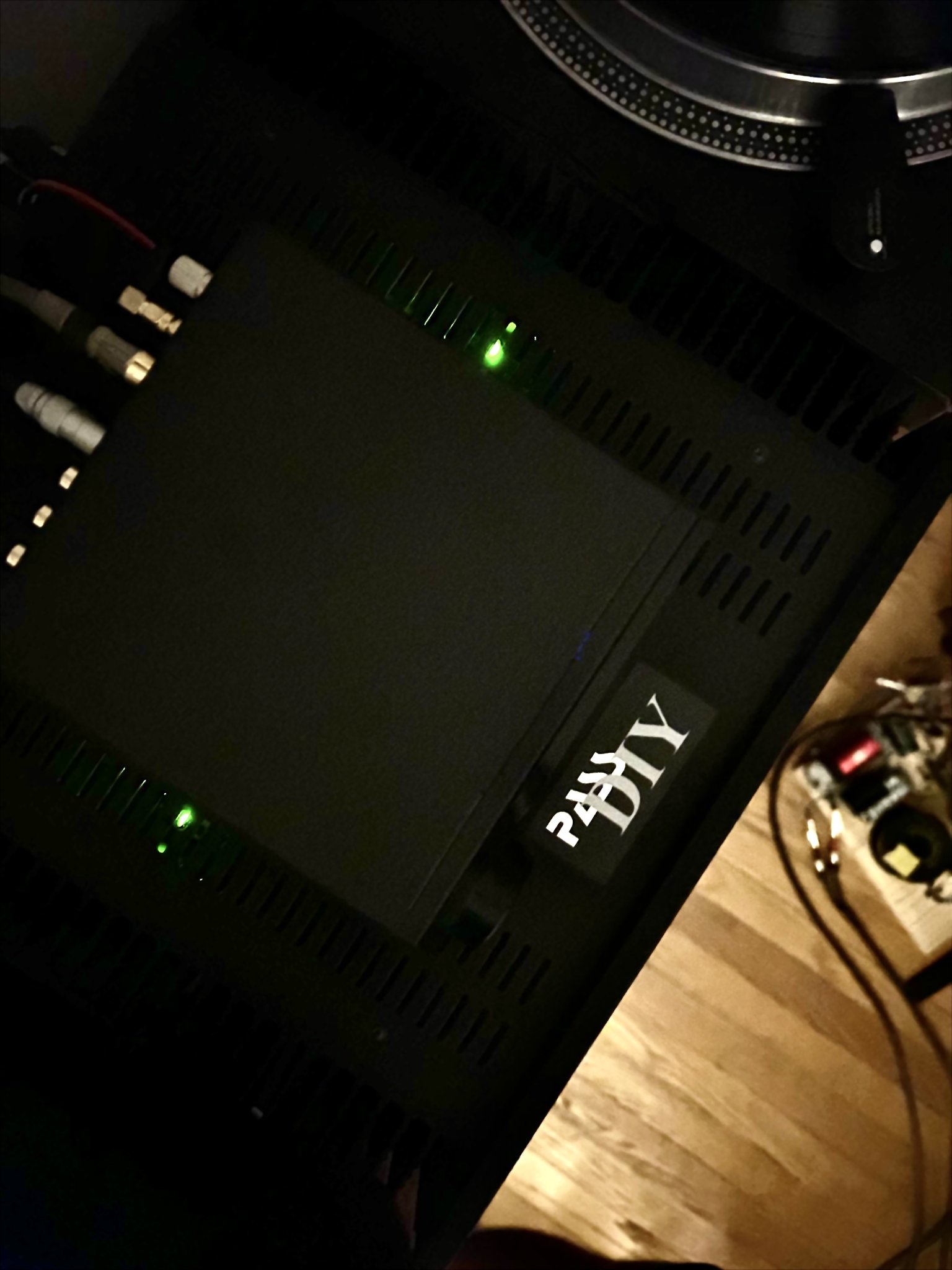

After 35+ hours of listening/burn in the amp becomes more and more fine, even more detailed, simply beautiful 😍
And it seems to fit my OB speakers perfectly👍

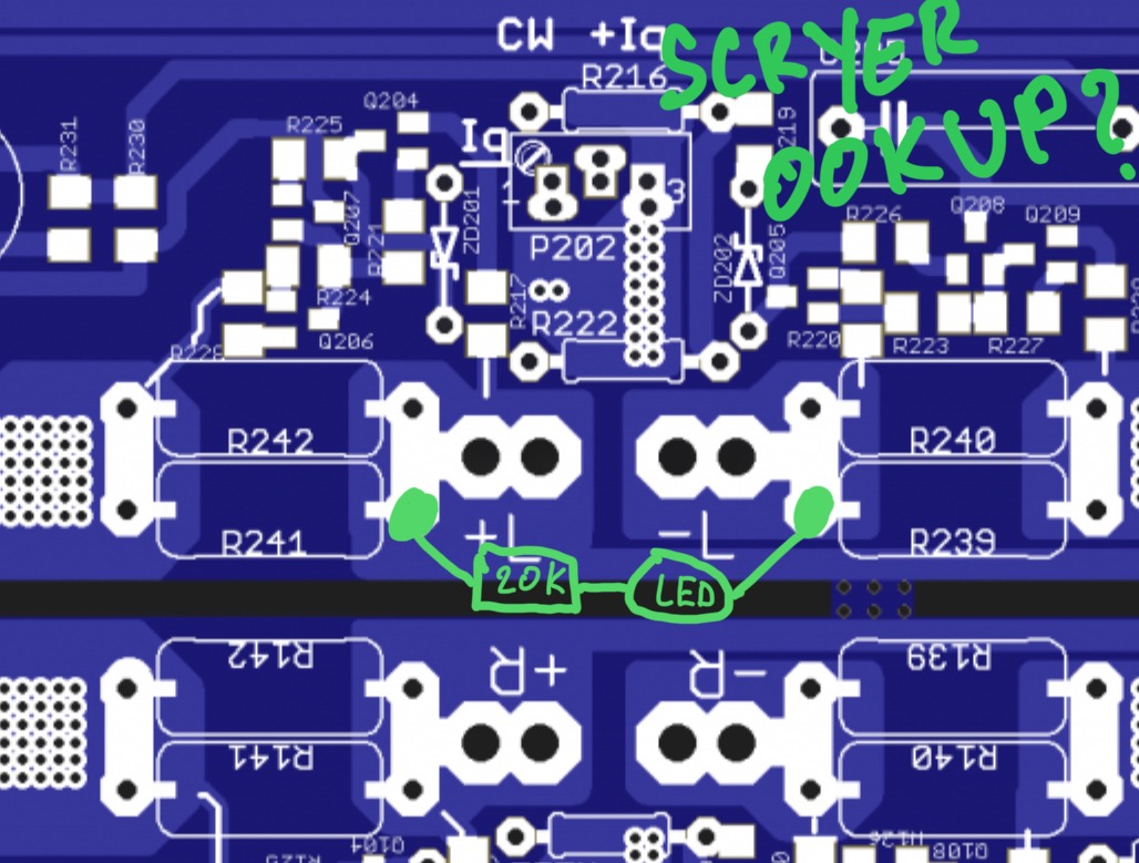

I may have made an ookup.
When I decided to add an LED to each board to show when power was on, I chose a potentially weird spot.
Is there a theoretical problem to having a resistor (20K) and LED connected from V+ to V-? It dawned on me that this may not be optimum, even though the amp has been running fine this way.
Do I need to change this so that the 20K-and-LED is connected from V+ to GND?

I'm not sure if the relative "brightness" of an LED is linear to the current through it, but...
Just 2x as bright a LED if so...
Wait for wiser minds, but... I'd say... unless you're blinded, leave it alone.
The original Aleph J was arranged that way, rail to rail. But the resistor value was much higher than yours.

all good - LED doesn't care haw you call rails given, as long polarity is proper ........ and also regarding the amp , no problem at all putting LED there
my Thumb of Rule is with nowadays LEDs - 1K per Volt, so - in this case anything from 33K to 47K will give you plenty of light
if you want more- decrease value of resistor
