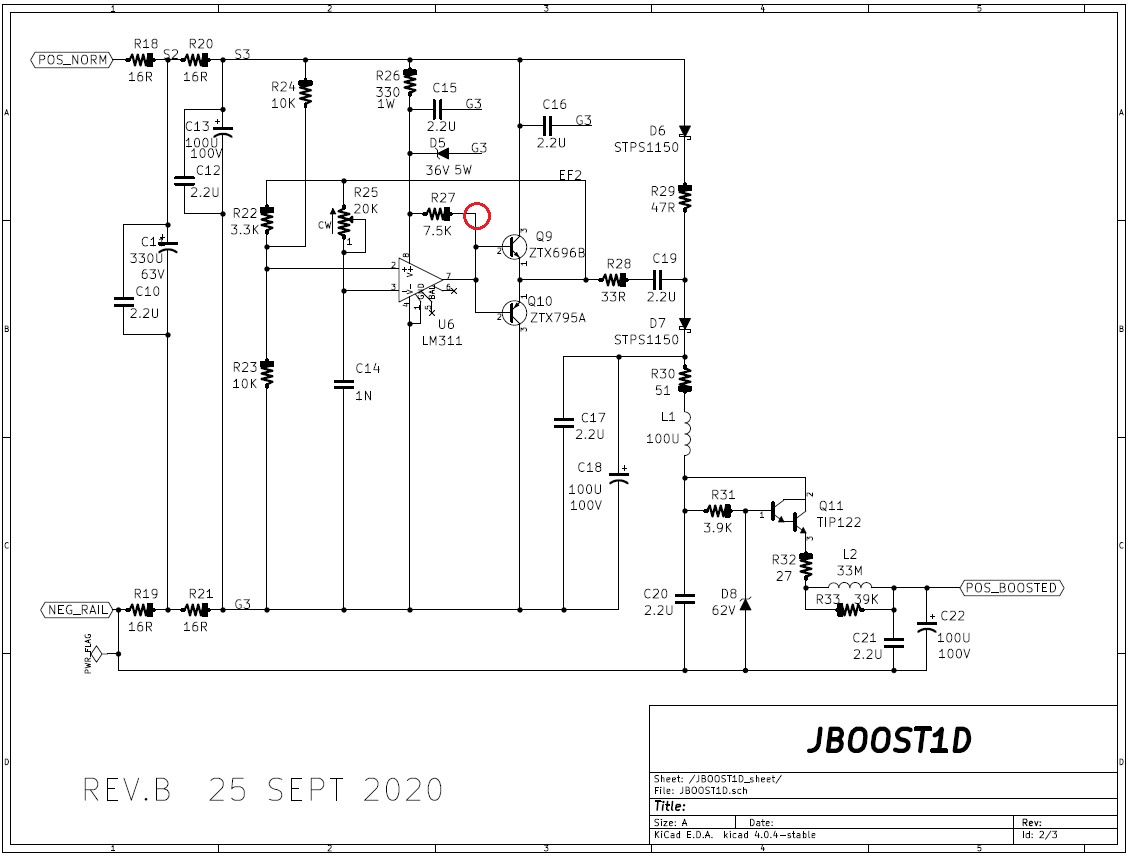

Builders of Marauder and Dreadnought: you'll need to adjust trimmer potentiometer R25 on sheet JBOOST1 / JBOOST1D. I strongly recommend you use an oscilloscope and not a multimeter to perform the setting. You'll be measuring the frequency of a very high voltage AC swing. The AC voltage is too big for lots of meters' "frequency counter" mode, and the frequency is also too high. Please get a correct result on the first try, without damaging your test gear: use a scope.
Set the scope vertical display to 10 volts per division and set the horizontal sweep rate to 20 microseconds per division. Give the trimpot three or four full ANTI CLOCKWISE rotations to start the measurement procedure at a nice low frequency.

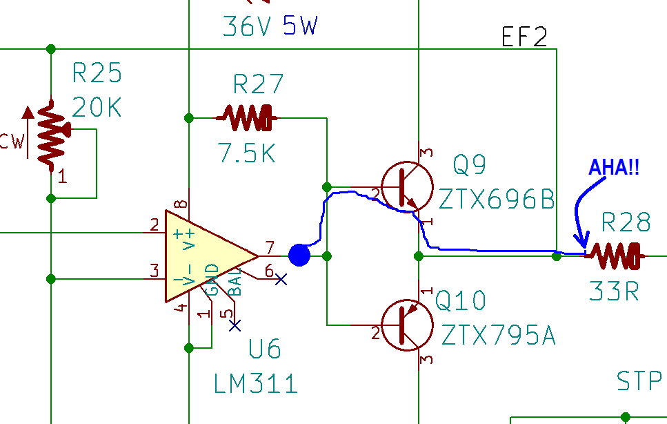

Probe the output pin (pin #7) of the LM311 chip. It will be a square wave whose amplitude is 32 to 36 volts. Dial the trimpot R25 to adjust the frequency of this square wave. Your goal is a frequency of 50 kilohertz.
When you get very close to 50 kHz, change the horizontal sweep rate to 5 microseconds per division. You want the square wave PERIOD to be exactly 4 horizontal divisions. Math: 4 x 5us = 20us = (1 / 50000). If your scope happens to be a digital model with frequency measurement capability: use that too.

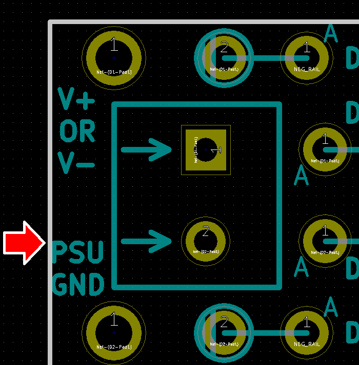

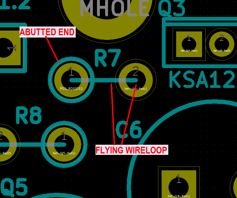

I've finished soldering one dreadnought board. My oscilloscope (Sain DS202) that's served me well for quasimodo, says max 40VDC so a bit close to the expected 36V here. I plan to use the probe on R27 (only option for me as all the other leads were cut too short). For Ground I can use R1 (jumper to ground) correct?
I just pull the witch's-hat off my scope probe, and use the sharp pointed tip to jab into pin 7 of the IC (in its socket). For ground I temporarily install an additional 8 inch long piece of insulated wire, into the PSU Ground hole of the Euroblox connector, and tighten the hold-down screw of the connector. Or if that's too crowded, Dreadnought's Output Euroblox has a ground connection too. When setting the DC-to-DC converter frequency, temporarily yank out the output wires and put your scope ground into the GND Euroblox hole of the Output connector.

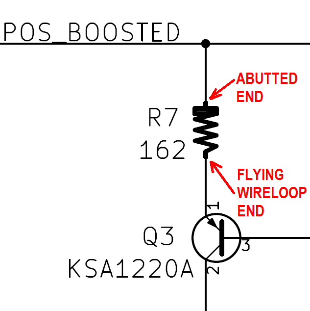

The schematic symbols tell me (and everyone else) which end of a vertically mounted resistor has the flying wirelooop on the PCB layout. Those flying wireloops are also very handy places to connect a scope probe.
