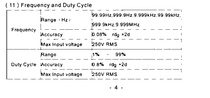

... adjust trimmer potentiometer R25 ... I strongly recommend you use an oscilloscope and not a multimeter to perform the setting. You'll be measuring the frequency of a very high voltage AC swing. The AC voltage is too big for lots of meters' "frequency counter" mode, and the frequency is also too high.
Maybe not! I just stumbled across the Aneng AN8002 multimeter which sells for USD 31.00 if you buy from Amazon or else USD 17.00 if you buy from Banggood. Its spec sheet includes the table attached below. 50 kHz and 36V pk-pk are definitely within its capabilities. I'll look to see if there are other, even cheaper DMMs that have similar specs, and buy the cheapest. Then we'll see whether an inexpensive DMM will or won't do an acceptable job on Marauder and Dreadnought.

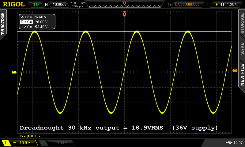

Here is Dreadnought operating juuuuuust before it clips. From a (+36V, GND) single ended supply, it's delivering 18.9V RMS at the Front End output. Which means Dreadnought has a comfortable safety margin beyond what the VFET output stage requires for full power ((3V * 5x) = 15V RMS at the VFET input). Click on the image to see it full sized and undistorted.
Or you could spin the picture data in a different direction: it means Dreadnought can drive other cards besides the VFET output stage. Cards which may not have been invented yet. Cards which may not have been announced yet. Cards whose operating principle may not be (follower + CCS load). Cards which operate from different power supplies. You get the idea.
Science types: although I believe it's correct, you can check my RMS arithmetic if you like. Start with delta-Y at top left.

... Or you could spin the picture data in a different direction: it means Dreadnought can drive other cards besides the VFET output stage. Cards which may not have been invented yet. Cards which may not have been announced yet. Cards whose operating principle may not be (follower + CCS load). Cards which operate from different power supplies. You get the idea.
But I must ask before Zen Mod does... can it drive the F4?
All joking aside, this is very pleasant news about the Dreadnought. I was considering just plain old stock, but now it may not be as simple as that with the Dreadnought.
Reactions: triode_al
If you've got a supercharged F4 with water cooled heatsinks, and if you run it from ±30V DC power supplies, then (Dreadnought) + (your goofy F4) + (8 ohm load) will give about 35 watts RMS per channel before clipping.
Standard F4s with normal heatsinks and normal power supplies, only go up to 25 watts per channel before clipping, according to the F4 documents on the First Watt website. Dreadnought easily drives those F4s to max output and beyond, without clipping at the input to F4.
On the other hand, now you've got to find a way to get (+36VDC, GND) to Dreadnought, a supply voltage which is not usually found inside an F4 chassis.

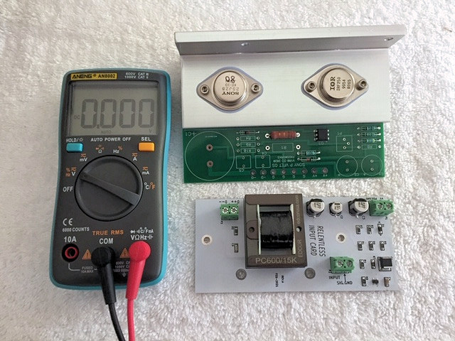

I bought the meter mentioned in post #103 above, it arrived today. Image attached, it's a small little booger.
Regrettably it did not correctly display the frequency of the Marauder card. It didn't even read a subharmonic or harmonic of the actual frequency. I tried direct coupling and AC coupling; wrong answer both times.
So it looks like you'll either need to use an oscilloscope to measure frequency, or else design and build a little buffer + attenuator on your solderless breadboard, which drops the peak-to-peak voltage swing to 9V or less, without loading down the Marauder circuit too much. Then a standard multimeter on frequency counter mode MAY be able to see it's 50 kHz. Unfortunately the best way to debug this little breadboarded circuit, is with an oscilloscope.
Sorry for the disappointing result. Glad I tried it, though.

I only tried it for measuring frequency on a weird waveform that no other meter seems to be guaranteed to read. This one is probably quite good otherwise and a screaming bargain for as many display digits as they offer. But it doesn't do the one thing I hoped it would.
