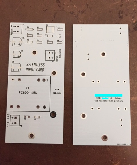

So far I'm liking the Relentless front end card (post #19) a lot. It's the first one with all-SMD components and the number of parts is small, so its signal path is reasonably minimal. However Relentless does use an Edcor transformer, so it's hard to know whether the sonic signature is dominated by the circuitry or by the transformer.
I like the other cards too, don't get me wrong, but Relentless is mighty nice and deserves to be mentioned occasionally.
Nothing mounted on bottom side of Relentless PCB. Some of the vias between TopCopper and BottomCopper are visible in the photo below, for example in a horizontal row about 1/8th of the way down from the top edge of the board. As you know if you've ever laid out or soldered an SMD board, they always have quite a few vias.
A few key words in the Principles Of Operation silkscreen text have been deleted, but there are no components or PCB footprints hiding beneath the blue boxes. Truthfully.
Most of Relentless is undisclosed.
