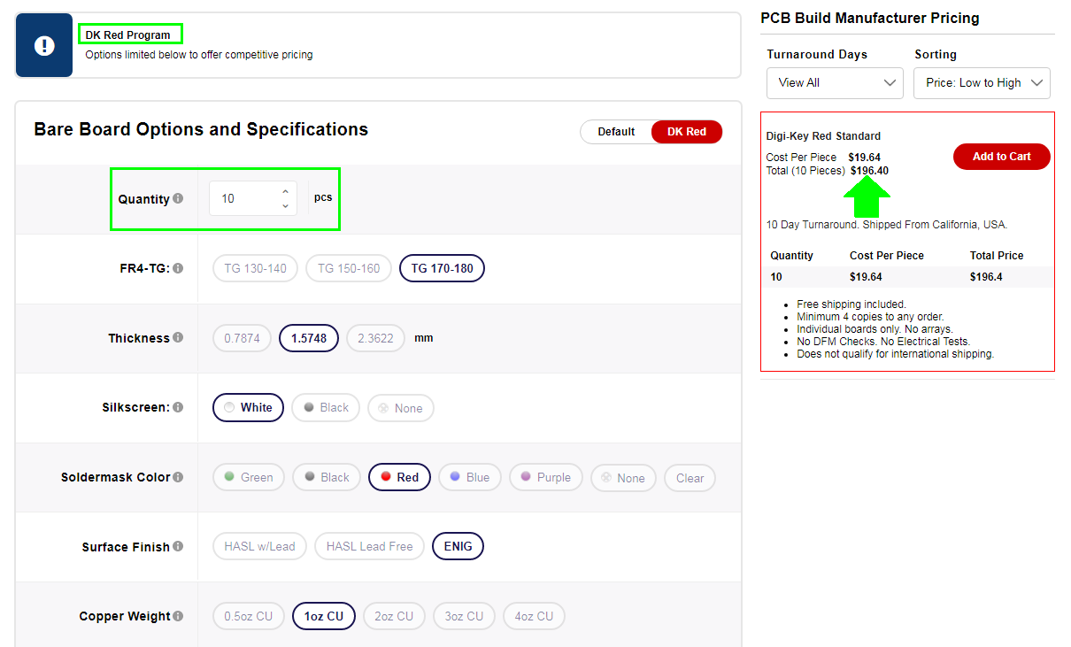

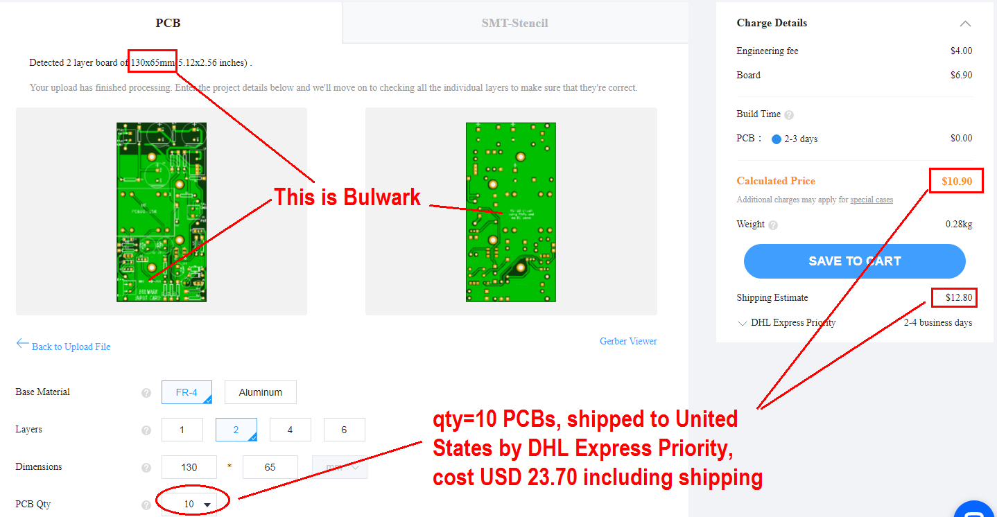

I just accessed JLCPCB.com for a price quote, to fabricate ten Bulwark PCBs and ship them to me in the United States via DHL Express Priority. In my prior experience ordering boards from JLC, this entire build+ship process takes about seven calendar days total, from ordering on the web to receiving the box of PCBs at my front door.
The quoted price was $23.70 for ten boards. Not surprisingly, more than 50% of the total cost was the international express shipping fee. Here's a screen capture image from JLCPCB's website, 15 minutes ago:
_
