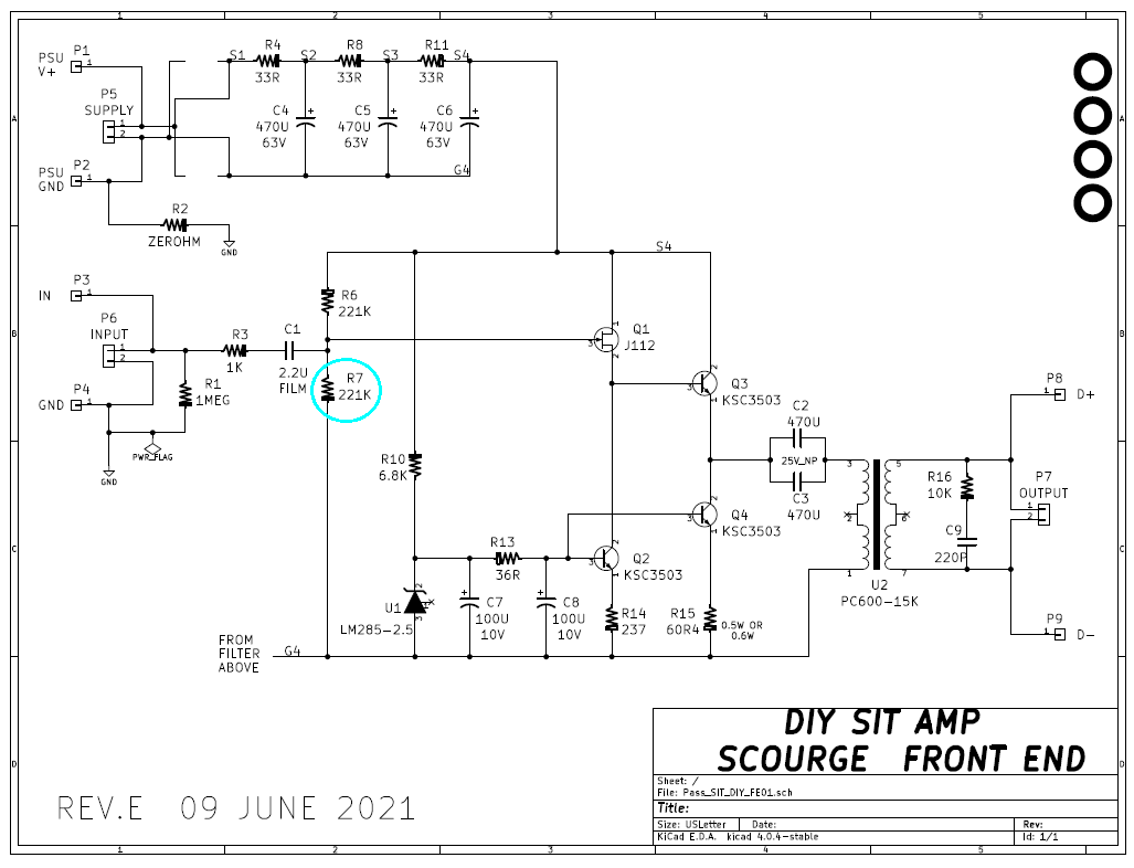

I just finished a set of Scourge boards. Nice and easy to build. Would they still work ok with only a 19v power supply? The DIYA store kits are perfect - all parts included and quality choice of components. Thanks for making these designs available Mark Johnson.

Scourge was originally designed to run from a +36V single ended power supply. With such a high supply voltage, ensuring symmetrical clipping was waaaaay down on the list of priorities. But if you cut the supply voltage in half, suddenly clipping behavior might become important.
An easy way to adjust clipping symmetry is to temporarily replace R7 with a 500K or 1 megohm trimpot, and then dial it up and down until the peaks and the troughs of a sine wave are clipped equally (on the oscilloscope). Then remove the pot, measure its resistance, and use a fixed resistor of that value (plus or minus ten percent) in the R7 position. Clean up the board and remove all flux residue; R7 is connected to a high impedance node that can't tolerate a lot of leakage current.
(Run the test using a low frequency sine wave like 200 Hertz, so the Zobel capacitor (C9) becomes a high impedance. Now you can't overheat the Zobel resistor (R16) even with a large amplitude, clipped waveform -- because C9 in series acts as a current limiter.)

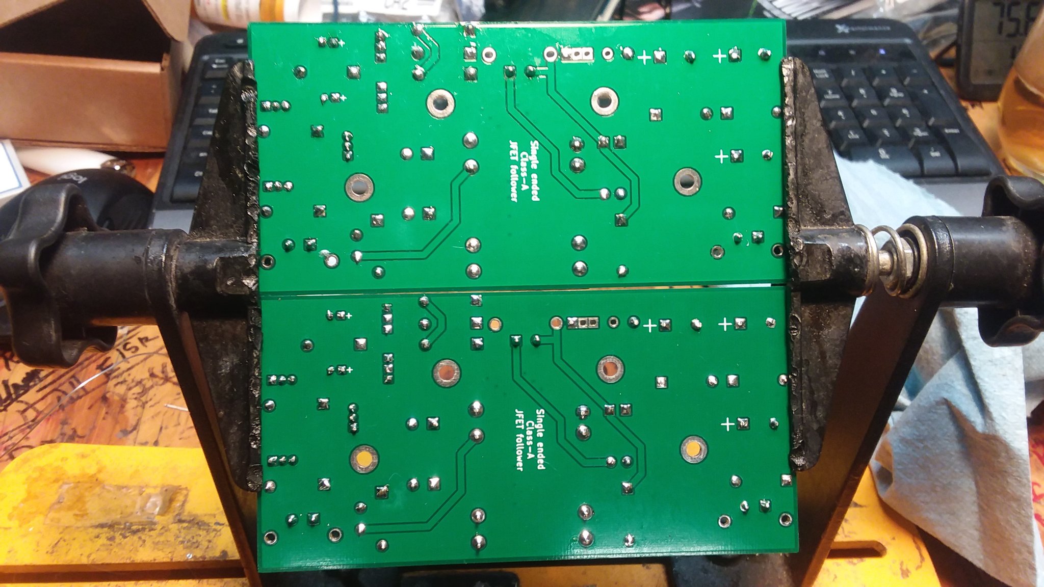

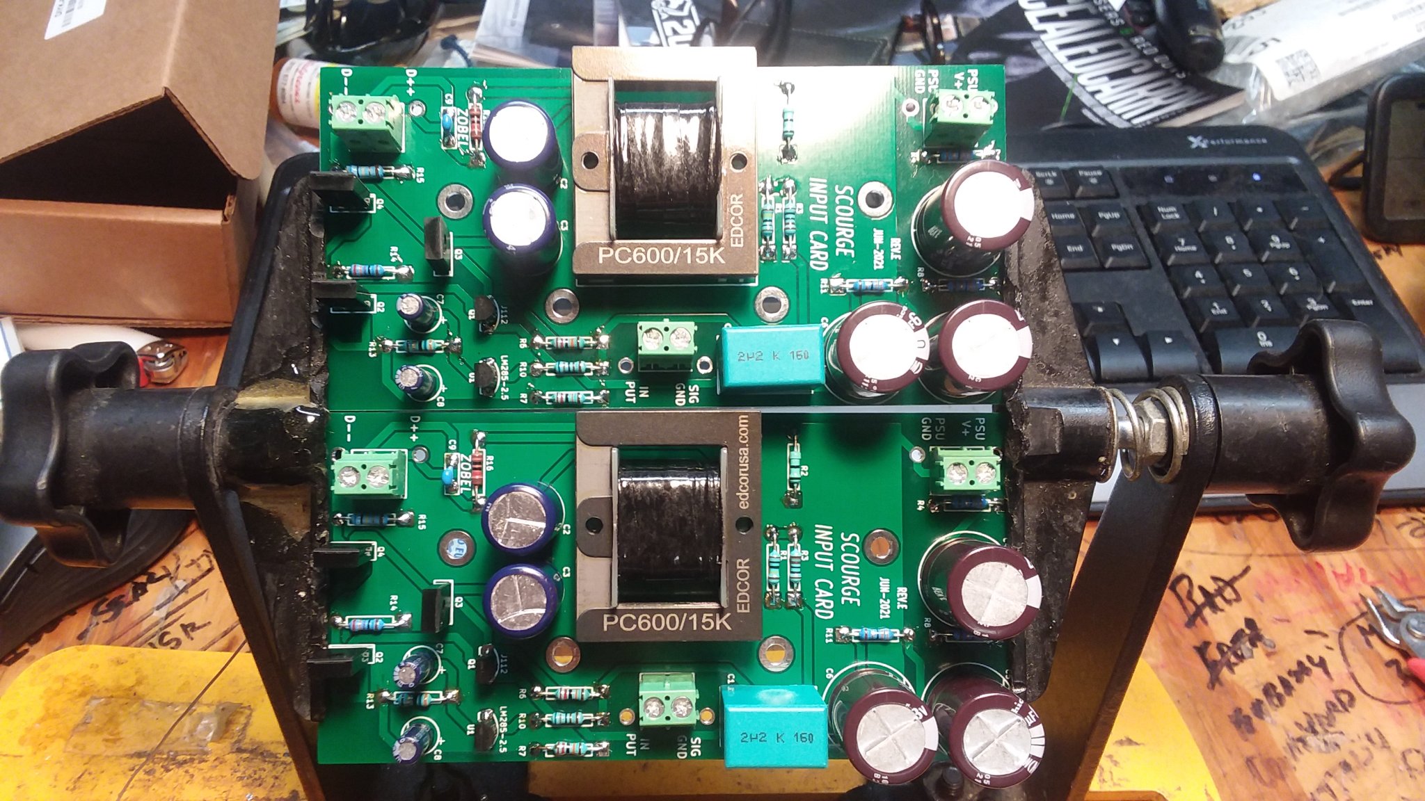

Well, I got the Scourge built, but haven't tested yet, I figure I'll build them all then test. This was an easy build and went fast.
Then I opened the Dread-naught box and started laughing. Well, this one won't be a drink while stuffing board. lol Damn, I'm glad I bought the kit version instead of hunting all that from a BOM.
A couple of the Scourge: I still need to deflux the top

Old eyes and tremors in my hands make it more difficult than it used to be. It looks like I will have the jewelers headband on for most of this one. pfarrell did some amazing work on his builds, it looked like a factory robotic job it was so good.
I work as you say, I put a number of parts on solder them trim and then stuff some more working from smallest to largest usually. I like to start with the R and small stuff that way you can remove the flux before the board gets busy. I didn't do that with Scourge, old brain too. 😛

Thanks @thompsontechs. I take my time, worked in sections as Mark does/suggests. Smallest to tallest components. I tend to use high heat and a not particularly small tip on the Hakko, kinda hot and fast theory. I find getting flux off the top of the board to never come out perfect, so I aim for a perfect top joint from the bottom. Occasionally I'll have to spot a top pad, probably not needed—but OCD, if there's some massive ground plane action that really sucks the heat. Basically I find the "work" to be pure bliss—so stress isn't really a thing for me personally, here.

As for flowing them from the backside only, that is possible because Mark used bigger holes, which allows for a number of diff parts, but also lets the solder flow through the boards better. IMO, it's critical for multi-layer boards especially to do so. When it comes to caps and large components that prevent one from flowing from the top side as well. Yes the holes have copper too, but I wonder how thick it is, and if it will hold the current as well as a trace.

I also work with a hot iron chisel type and try to get it on and off quickly, as the longer you are on the more flux burns off and stops the flow. In fact, I had a bad tip with the last board and had to use a smaller one, it was more difficult to work with by far. I have since got a new one.
