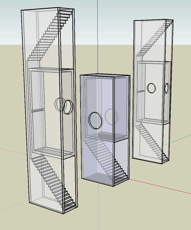

I must say you are really productive making a big Spawn family
I think I would do a MTM with 16ohm WR
Wonder what would happen with an Exstremis on the sides in each mouth opening .... nah, too exspencive and crazy, wouldnt work and probably be kicked out of the Spawn family
Dave, I guess you will try that RAW driver in some big horn some day

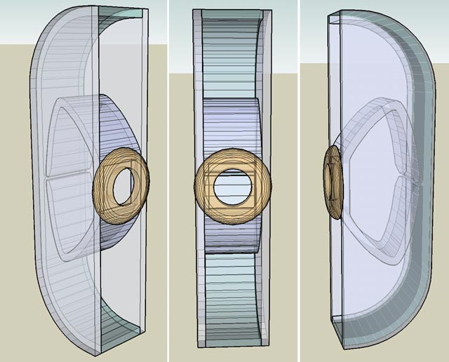

[I guess you will try that RAW driver in some big horn some day
Maybe in something like this (concept for a customers FE206eSR)
dave
planet10 said:I'm working on the companion for dual extremis as we speak.
tinitus said:I think I would do a MTM with 16ohm WR
I did not have luck with that.
I really like that I can xo the driver nice and high and enjoy the full benefits of the wr without having to deal with the MTM. The side mounted driver is a big plus. A big thanks goes to Dave on that one.
I'm glad I listen to him.
