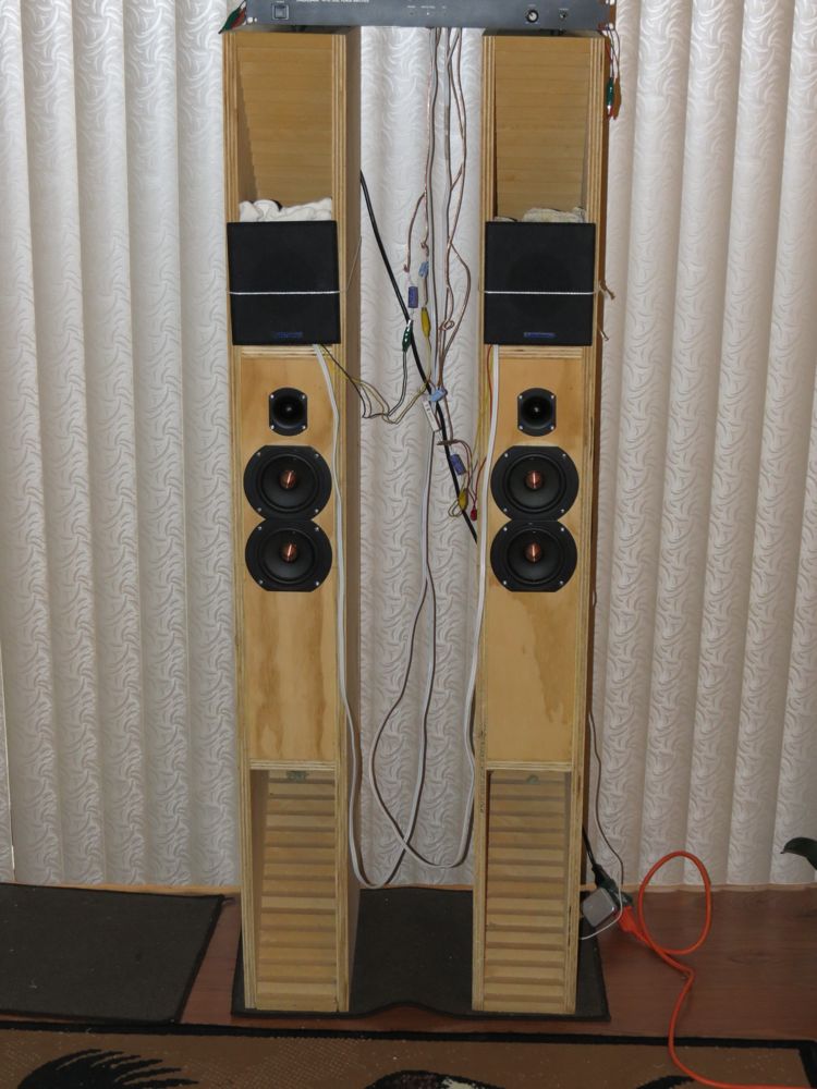

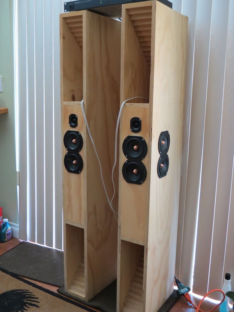

They have received a bit of a face lift. My wife is still in bed so I will have to do the testing later. I needed to do this as I thought they might be tuned a bit low and I didn't feel like filling the cabinet. It's now a 2.5 way with the top driver in each case running full range and a choke on the bottom drivers. The tweeters have a 1.0 µfd cap and an fixed L-pad.
I'll take better pics later. 🙂
Wow, I must say the extra drivers have done exactly what I wanted to happen in the bass region. Can't wipe the smile off my face. Had to actually close the ports down to aperiodic so the bass wasn't idiotic. 😀 Now I have to play around to make sure I can still hear some vocals.
Power hungry yes but all in all these are a much better speaker, to my ears anyway.
Overload indeed. I had to make up for the fact I wasn't there till Sat morn. and then left Sun morn. That's a lot of rum I had to drink in 24 hours. Did I say rum? I meant Fresca. 😉
Dave, no comb filtering or whatever you call it with the 2.5 way. Now I will increase the size of the choke and add a shunt cap as we need to tone it down a bit. They sound like a 70's speaker on a tube amp.
Will report back.
Will report back.

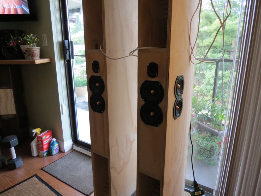

OK new chokes and cap in place, and that has cleaned up the low end really nicely. These sound really good now. 😀 Oops, there's that smile again.
Well, as you guys know I can't leave well enough alone so I decided to improve the vocals by adding a 3" mid. It's an OEM FR driver sold under the Audiosource label. It's actually glued to the baffle so it has to stay there for now but this combo has added that missing upper mid that you miss with the WR125's.
They're getting better. 🙂
