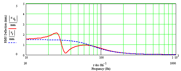

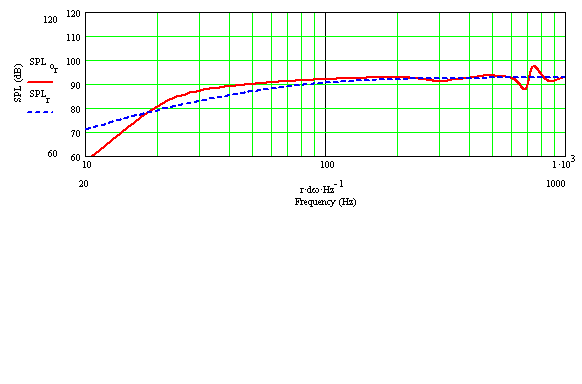

Cerberus sims now complete, though I'm not sure if this is going to be one for the site.
Double horn, of the Calhoun / Shadow persuasion, 60in tall. 4 Extremis 6.8 woofers. 1.5mm total excursion from the 4 drivers (so, thats 0.375mm each) at 17Hz. Xmax of the Extremis is 13mm, one way. If you want the FR...
Doesn't look particularly special, but remember the excursion, or lack thereof. Got a plate amp? Then these are going LOUD. Impedence is pretty mild, no nasties at all to worry about according to the software. The upper mouth will roll off earlier than the lower, so it should interact & blend with the room well.

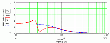

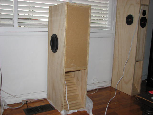

Dave, Scott, and Cal,
Cal, I see that your drivers aren't centered in what I guess can be called the CC, not sure what to call it in a BVR. And in Dave's models he has the 2 drivers on the front baffle niether of them are in the center, both seem to be mounted where Cal's front driver is. I see that the center of the cabinet may be a little low, but i'm sure with feet and a slight slant the listener can be perfectly on axis. I know with BR its not the best idea to have the port directly behind the driver, but from the other models it seems it is fine with BVRs.
I personally like the symetrical look a little more, would it be alright to put a wr/fr125 in the middle of the cc on the front and one side firing right next to it?
Josh
Josh

edjosh23 said:I personally like the symetrical look a little more, would it be alright to put a wr/fr125 in the middle of the cc on the front and one side firing right next to it?
Driver placement is fairly flexible. I like to use the golden ratio where i can.
dave

very nice speaker, guys. bit 'o polish to bring out the depth of the wood..and poof! big WAF. Depends on the specific W, tho...
- Scottmoose and planet10, this is for us - the Calhoun.
