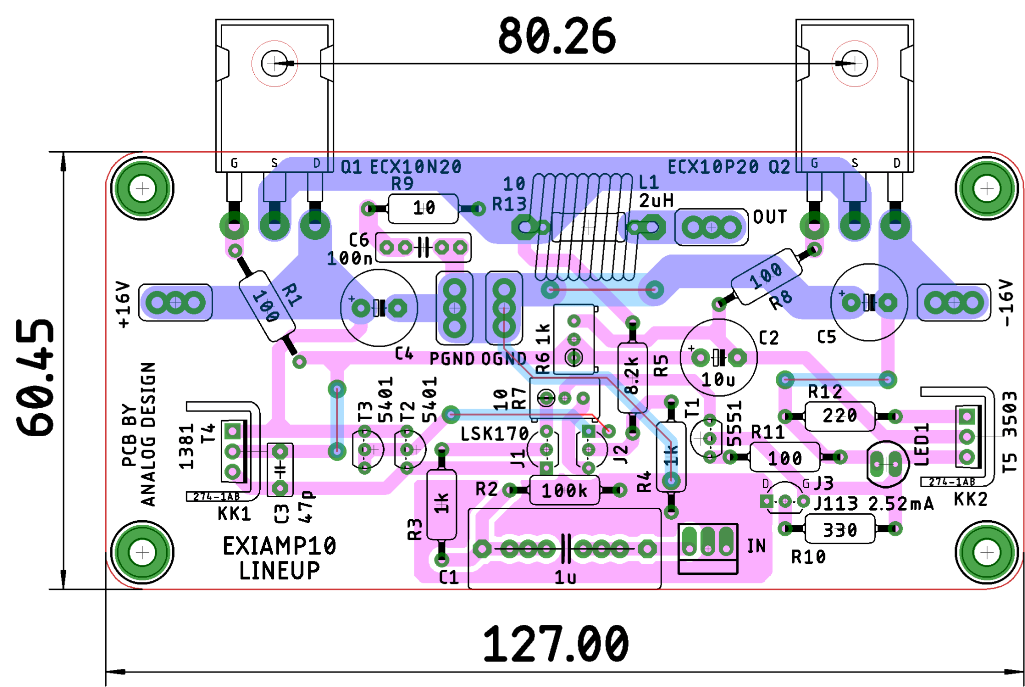

There is a chance that I will also get on the train, I have k1058 and j162 in stock.Yeh, I will order pcb's as soon as the gerbers appear here - hopefully thanks to prasi's great work.

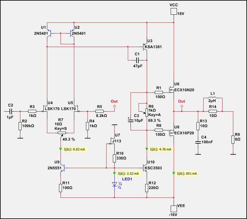

I have all the components for this simple elegant design which measures well according to simulation by lineup.
I would also say Vunce will be having a go at it.
I have changed 2 capacitors and added a Zobel in output.
C1 = 47pF, compensation tested with Scope
C3 = 10uF, not any benefit making it bigger
Thanks lineup for the latest mod, hopefully prasi can incorporate these on his great pcb design with a revised version..
Also I asked you some questions in post #15, can you have a look at that and give us builders your brief answers, thanks again.
Although the added zobel network could be wired off the pcb, the 2 cap value changes would not need any change to the pcb layout.

This is the suggested JFETs:
https://diyaudiostore.com/products/matched-jfets
Eventuell you can have to increase the balance potentiometer: R7
R10 should be chosen to give like 2.5mA across the LED
Hello Thimios,Thank you prasi!
You always support us! 🙏
PS. please, if you will find the time post the diy friendly single side pcb in pdf. 😉

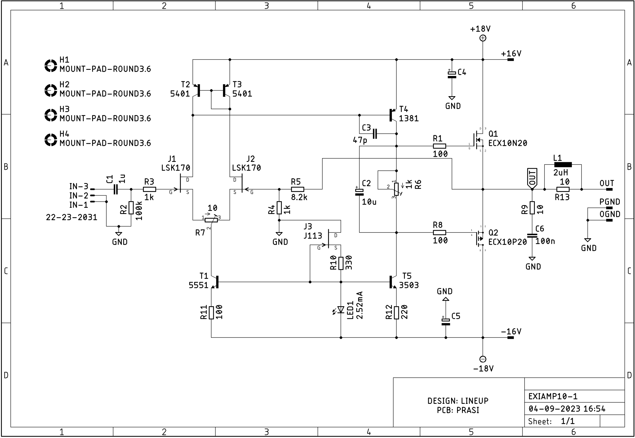

here you go. both diy pdf and gerbers with modified design as per #42.

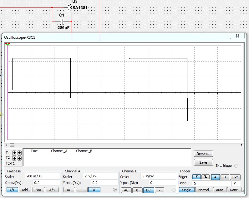

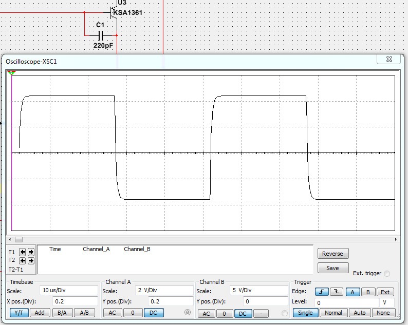

This is the 20kHz square with C1=220pF
I think this is a good value. 47pF is too small.
You're so quick! Great layout as always!here are build files and gerbers.
here is a parts size guide for info. i dont have any part numbers.Hello Thimios,
@lineupThis is the 20kHz square with C1=220pF

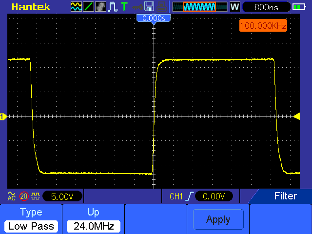

Forget that virtual oscilloscope. Square wave response of 2 MHz bandwidth amplifier is much better. Here is 100 kHz response from my amplifier with EXICON laterals:
Your amplifier should have the same. 🙂

Hi again prasi, is it worth changing the silk screen on your pcb for the value of C3 back to 220pF (was 47pF) as lineup has shown in post #49?
I will wait on your reply before I order my pcb's, thanks.
I still have a few K170s from my old Plantefeve assembly, but no J113, I must have some J200s somewhere.This is the suggested JFETs:
I repeat.
Buy these JFETs: https://diyaudiostore.com/products/matched-jfets
The balance potentiometer R7 can be necessary to increase the value.
From 10 Ohm to 20 or 50 Ohm.
It all depends on how well matched the JFETs are.
