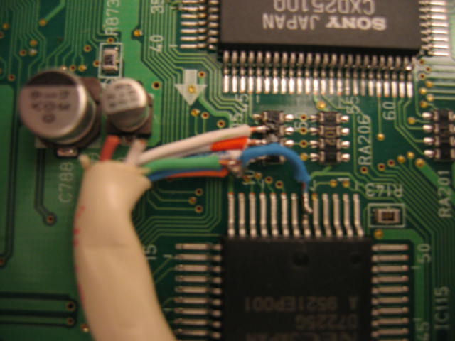

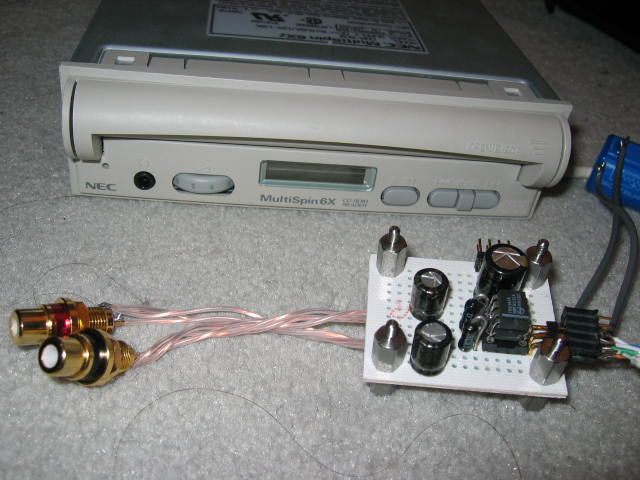

Finally, an internal view of where the dig lines were intercepted for the sony format to the TDA1543A. The two clock and data lines were taken from a resistor pack near the CXD2510. The "twisted pair" mates for the CAT5 wire were taken to ground found on the adjacent chip.
Power right now is provided by a small switching power supply, soon to be batteries when I find the time.
Works well so far!

Jon, the dig out portion of the schematic is on this page.
http://www.audioworkshop.com.hk/photo/5 Audio.jpg
It's pretty simple, and I'm sure you can easily intercept the signal at the CXD2510.

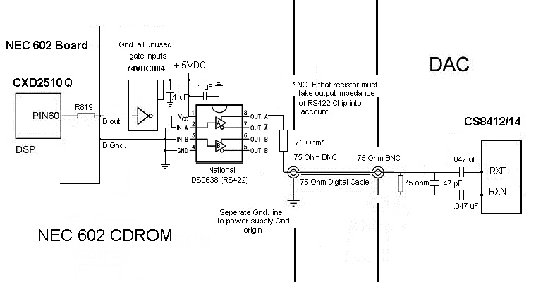

Jon:
With regards to the better sound provided
when a higher Peak to Peak digital signal is
sent to the CS8412; assuming this is true,
would the following be possible:
1. Take output of NEC 602 and route it
through an RS422 line driver chip to
get a buffer and output drive capability.
2. On the non inverting output of the RS422
driver chip, add a series 75 ohm resistor
to make the SPDIF impedance specification.
3. Route the signal to a 75 ohm BNC jack at
the back of the 602 unit.
4. Connect the SPDIF (higher level signal) with
75 ohm coax/ BNC connectors to DAC with
CS8412 reciever.
Now the CS8412 would have a higher level input
digital signal, and still meet the SPDIF impedance
specification.
Any comments on this approach?

Fastcat,
Yes, pin 60 of the sony chip is Dout. I sketched out the schematic more or less on page 2 of this thread. I checked it with the actual schematic and its correct.
You mentioned a "dirty" signal. If the signal coming from the chip directly is dirty, and I'm using the sony format clock and data lines from the same chip, wonder if cleaning those up will help there as well. I'm interested in the schematic you'll be using to square up and clean up the ttl signal 😀
Norman

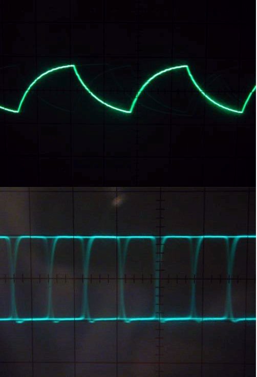

The digital signal out of the NEC (Sony chip) is
"dirty" in the sense that it is not a clean data
stream with a sharp, clearly formed digital pattern.
It could be that the output resistors, and / or
inductors play a role here. I have seen scope
photos that show a much improved data stream
appearance after a buffer circuit is substituted for
the origonal scheme on the output. As to the idea
that the sould will improve with the data stream
cleanup, I am not totally sure about that. The other
data lines from the Sony chip might be cleaner,
depending on how they are connected or loaded,
etc. It is also impossible to be sure how much
loading the pin 60 D out of the Sony chip can tolerate.
This is one reason why people put a buffer between
the chip and the output jack. It would be nice to just
add a series 75 ohm resistor and run straight to the jack
if performance did not suffer. Anyone have an O'scope
that will allow them to check this out?
I will post a few drawings here shortly with several
circuits that I think will work well for an output buffer.Fastcat

Using the RS422 standard chip is the best way to reform the signal.

I am using SN75176 and you can go to the below link and chk the standard configuration. It is easy and only one resistor and one good powersupply.
http://focus.ti.com/lit/an/slla070c/slla070c.pdf
The signal from 602 will go to 74uhc04 and then to 75176.
RS422 is a balanced signal transfer method and the noise immuse ability is very high. What I was doing is to make sure the signal-out from the cd rom is equal to the signal-in in DAC.
Easy to build..
Leo
Easy to build..
Leo
Is there a reason you aren't using the balanced output of the RS422 chip? I know the CS8412 has a differential input...
Doug
Doug
As dcole said, CS8412/4 has the standard rs422 receiver. So, it is better using balanced out from the chips.
