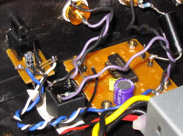

sorry, i work it hard yesterday night!
i trying to put some e.cap inside, but.... limited space.
and after i added, the cd-rom refuse to work!! so i desolder all i did.... and it refused to work too!!
you know what is the problem?!
since i put the oscillator outside, the sharp case cut the choth of the wire and touch it ...... so the clk wire is GNDed.....
oh~~~ i spend the whole night, give out a lot of work done, but displacement equal to zero!!

oscillator which i used
http://www.audioworkshop.com.hk/order/33M_s.jpg
mum....... i can hear the bass is better... but not enhance too much!
i just use this cd-rom as a transport, and DAC is dir1703+ad1955+opa627(iv stage) + opa111am
amp is tube headphone amp~~
