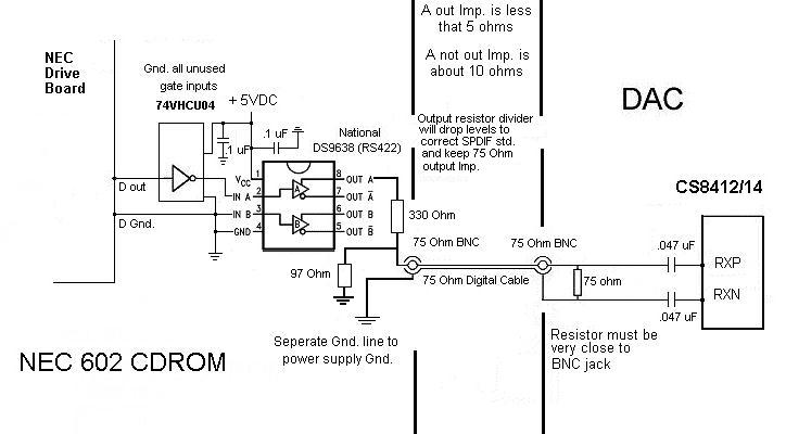

To All:
I am posting a modified version of my SPDIF output
circuit that reduces the output level to the SPDIF
standard 0.5 volt, and also keeps the proper 75 ohm
output impedance.
As always, if anyone is doing NEC mods, please post your
results and pics if possible!
Thanks to all contributors!
Fastcat
output impedance.
Fastcat

Audionewb:
On the resistors, I would suggest at
least 1% accuracy metal film types
with a 1/4 watt rating. Mouser has
some very nice Vishay units in their
catalog.
Also, if you will be feeding a DAC that
does not have a series capacitor in
the SPDIF signal line to the reciever chip,
I would suggest having a 0.1 or 0.047 uF
HQ Wima polypropolyne capacitor before
the 330 ohm resistor. Also at Mouser.
Fastcat
catalog.
Fastcat
<< Also, if you will be feeding a DAC that
the 330 ohm resistor. >>
Sounds good. Is there any harm in having a cap before the 330 ohm resistor if the DAC does have a series capacitor in the spdif signal line?
>ohm resistor if the DAC does have a series capacitor in the spdif >signal line?
This should not be a problem. One of the things that I like
about the schematic I posted is the fact that the CS8412/14
chip has caps on both the RXP and RXN pins, which should
provide a form of blocking to lower frequency AC or DC that
might otherwise couple between the transport and the DAC,
particularly through the ground connection between the 2
units. This is where a pair of excellent, and properly
implimented, digital pulse transformers would be best if
you knew where to get them and how to design them
into the circuit. An elimination of "hardwire" connection
between transport and DAC.
Fastcat

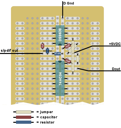

Fastcat circuit on protoboard
I've attached a mockup of the Fastcat circuit on Radio Shack protoboard (#276-150). I've never done anything like this before, so I'm just trying to get as much feedback as possible before firing up my soldering iron.
Do you see any mistakes or obvious inefficiencies? Anyway I could lay this out without requiring so many jumpers?
Thanks for your help!

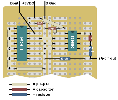

Another one...
This is fun! Kind of like solving a little puzzle. This one is much easier, as long as there's no problem running the ground trace beneath the ICs. You'd still need to ground the ICs, but I left the jumpers/blobs of solder off the diagram to keep it simple.
Let me know what you think!

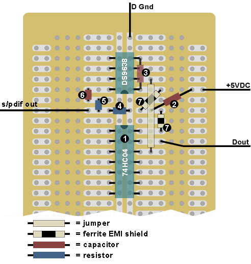

Hello!
Your second circuit layout looks a bit
more streamlined...
A few thoughts:
The 0.1 uf bypass capacitors for the chips
should (ideally) go directly between the
+5 pins and the GND pins. Axial multi layer
ceramic types are very good for this due to
their very low high frequency impedance.
Some people go further and use leaded
ferrite beads from the +5 source to the
+5 pins of each chip for more filtering of
very high frequencies. It is also possible
that adding a very low impedance 47 to
100 uF electrolytic to the board where
the +5 first enters would also help with
power supply noise. Be sure that ALL
unused logic gate inputs in the 74' chip
are grounded (outputs can be left open),
as well as the input to the unused DS9638
amplifier circuit.
Keep us posted on your progress!
Fastcat
more streamlined...
A few thoughts:
amplifier circuit.
Fastcat
I don't understand this. Do you mean one end of the cap sticks in the same hole as the +5 pin on the chip, and the other end sticks in one of the holes shared by a grounded pin? Or do you mean they should just mount as closely as possible to the +5 pins? Double stuffing PCB holes is a pain.fastcat95 said:The 0.1 uf bypass capacitors for the chips
I don't actually know what ferrite beads are, but I've heard this before. I figured they could just replace the jumpers on my diagram where appropriate. Again, looks like there's lots of different kinds, with different ohm & MHz values. What kind am I looking for?Some people go further and use leaded
No problem, that's easy.It is also possible
power supply noise.
Yup. They are on my first diagram (pins 1, 3, 5, 7, 9, 11, 13 on the 70xx04, and pins 3 & 4 on the DS9638). It would have made my 2nd version diagram too messy, but since the ground plane is so close to the ICs, they can be connected easily with a little blob of solder.Be sure that ALL
amplifier circuit.
You bet!Keep us posted on your progress!
As to the 0.1 uf caps and the chip pins...
you could solder the caps between the +5
pin and the GND pin on the back of the board
where the chip pins stick through. There are

Okay, here's the final layout and parts list. I've got questions about a couple of parts, where they were out of exactly what I was looking for. I assume the substitutions will be fine, but better safe than sorry.
1. 74HC04 mounted on:
Mill-Max Capacitor Sockets
14P GLD PIN GLD CONT
#575-413314
2. Any thoughts on which of these would work better, 100uF or 47uF? I wasn't sure if the 25v rating would matter, but it was the only Nichicon Electrolytic in 47uF. If it doesn't matter, I'll pick the cheaper one and save $0.16:
Nichicon Low Impedance Aluminum Electrolytic Capacitors - 105 Degree
10V 100uF
#647-UHE1A101MDD
Nichicon UPW Low Impedance Radial Aluminum Electrolytic Capacitors - 105Degree
25V 47uF 5x11
#647-UPW1E470MDH
3. Kemet Conformally Coated Axial Ceramic Capacitors
50V X7R .1uF 5%
#80-C412C104J5R
4. Is 1/2 watt okay for this?
Vishay/Dale 1/2WATT Metal Film Resistors
1/2WATT 97.6KOHMS 1%
#71-RN65D-F-97.6K
5. Is 1/2 watt okay for this? How about .1% rating? I figured that made this a seriously robust resistor...it certainly has a seriously robust price ($1.38 ea.!)
1/4WATT 330OHMS 0.1% 25PPM
#71-RN65E-B-330
6. Wima Polypropylene Film Capacitors
100V .1uF 5%
#505-MKP20.1/100/5
7. Fair-Rite EMI Shield Beads on Leads
LF Z=68 OHM @ 100MHz
#623-2743001112LF
If these all look okay, I'll go ahead and drop the order this weekend!

Hello!
1. OK
2. Nichicon 56uf / 50 volt UHE 647-UHE1H560MED
3. OK
4. ¼ watt 1% is fine
5. ¼ watt 1% is fine
6. OK
7. OK
On your board diagram, 2 things-
Capacitor # 2 (56uf electro) is shown in series leading to the chips.
It should actually be between the +5 VDC entry point and the GND
with the + capacitor terminal on the +5VDC. Assuming that the D
GND wire in your picture is the one going back to the 2 wire jack
at the back of the CDROM drive, I would leave that wire as it is,
and run a separate GND wire from the power supply output to the
pads just below the +5 VDC entry point. Then put the electro cap.
across the +5VDC entry point and the new GND wire just below
it. That way any power drawn by the chips will travel through the
new ground wire, rather than taking the path through the D out
signal jack GND wire from the drive. After the 56uf cap., run this
new GND wire onward to the GND buss that the D GND is
connected to. The ground for the power supply output is
common to both the +5 and +12 VDC, and you will notice
that the p.s. output wire harness has (2) black GND wires in
addition to the red and yellow.
Try posting a revised picture. You are almost there.
Fastcat

Great, thanks! On the resistors, Mouser doesn't stock ¼ watt 1% Vishay/Dales in 330 and 97 ohm right now. If 1/2 watt .1% is okay (an unneccesary upgrade?) I can stick with Vishays, or I'll have to switch to a different brand.
Here's the updated circuit. Getting a little crowded in the 'power section', hopefully its clear enough. Is this what you had in mind? Also, does polarity matter for the other two caps?
AudioNewb:
Use what resistors you want if the 1/4 watts are not available.
The circuit looks good ( I assume that the jumper between the
2 chips will be on the underside, or routed such that there is
not a very close passing of the jumper to other components),
and only the polarity of the 56uf electro cap is important. The
output cap and the ceramic bypasses have no polarity.
Fastcat
Fastcat
