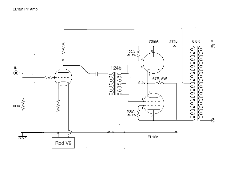

Andy, you're better off with a purely PP (not differential) design with input transformer for phase splitting. You can retain your preferred filament bias approach by paralleling the cathodes for the input tubes. If you insist on using 124B and if you can afford to lose a touch of gain, you can reverse the input transformer and using half of the winding for 22.5K:10K or 1.5:1 step-down and the bandwidth can be improved. 3:1 step-down might lose too much gain. Of course you can always use a different transformer with 1:1 ratio. There's no free lunch in transformer, the lower the impedance the wider the bandwidth and depending on the source impedance (or driving impedance). Example below:
You can also add a phase switch as an extra feature at the input by choosing whichever primary wire with center tap grounded. Of course if you want to be purist about it you can always use two RCA input, one in phase and one inverted phase. Just a suggestion.

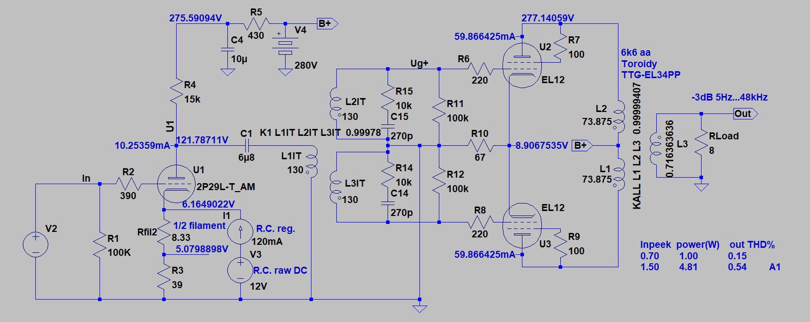

IMHO it's not "better", than -moderately good- DHT SE amp, and more complicated.You don't like it, Bela? What would you prefer?
This configuration is "textbook example", the cost of components and the final presentation -IMHO- may not be proportional to each other.
If you want good performance, better IT need, than LL1660 (the "normal" version -for me- mediocre product, I used -and hate- it).
Good PP OPT also need, but it's cheaper than its SE equivalent.
In this operating point of EL12n, the limiting factor is the low bias voltage, thus the output power (of simulation) is lower than expected.
I don't like common cathode resistor of power tubes, mainly if not AC blocked. Instead of it I would use independent, blocked cathode resistors.
In this site https://www.diyaudio.com/community/threads/el12n-in-hifi.346273/page-2 #30 post you attached two pictures of EL12 (EL12 and EL12n) trioded curves.
If you have "n" version, higher bias (about -15V, 350V, 50mA) is more appropriate.
It can result higher output power.

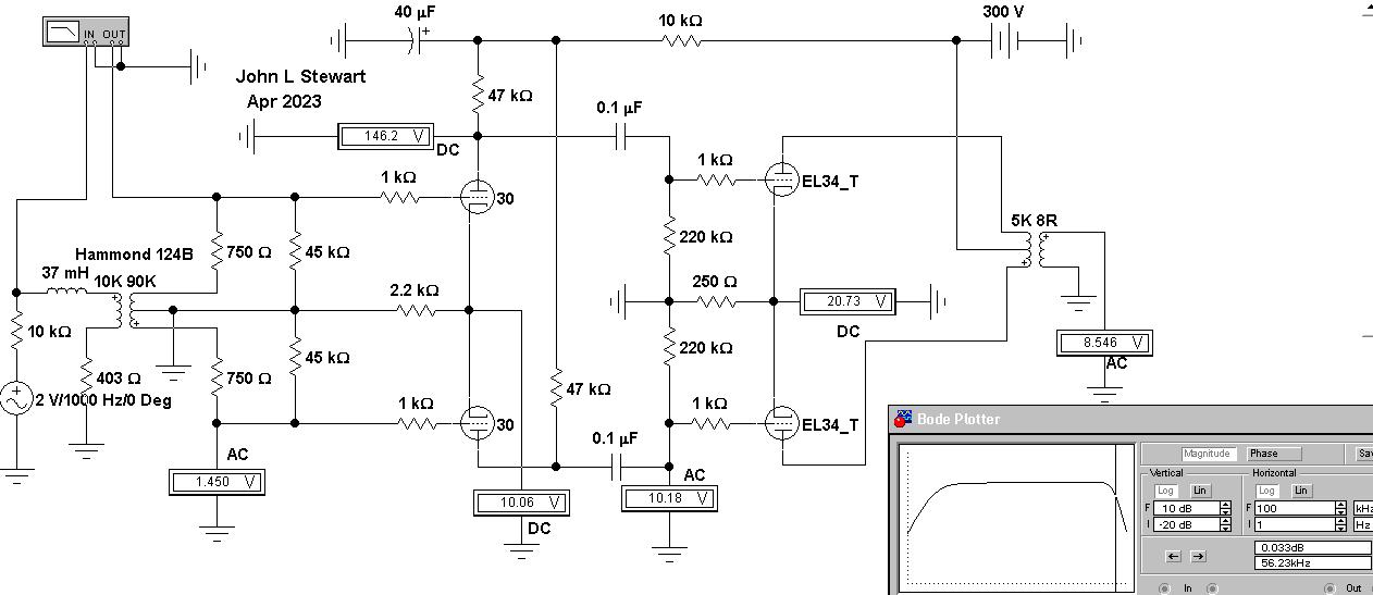

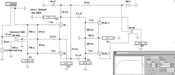

Here are PP EL34s, this time driven by PP 30s, same as the cct driven by PP 27s.
Still get ~10 watts of audio with 2V signal in. The performance of the two versions is essentially identical.
Both have some complication with providing power to the filament / heater.
But the 27 doesn't have the microphonic misery of the 30.

The main problem of interstage SE to PP transformers is balance/symmetry. It can easily result in higher distortion than desired already from few KHz and up. The same transformer wired for SE to SE will have much better distortion figures in the higher frequency range. This is not necessarily reflected in frequency response. The higher the signal level the worse. Pretending all the main jobs from the interstage is going to compromise something and that is normally distortion. On the other side, at low frequency, a lower inductance will also be less critical at lower signal level. Again, frequency response is the last of the problems as it's not difficult to get a good one. For example, 40H for 10K input transformer is a good figure. Instead, it's a modest figure for a 10K interstage and is poor for a 10K output transformer.
So, input phase splitting transformer plus differential driver is generally a better solution than SE driver + SE-to-PP interstage transformer. Very likely if low cost transformers are involved.

45: Splitting at the could work for me as I have a pair of Jensen JT-11P-1 on hand. I’ll need to get the gain up somewhere else with another stage or another transformer.The main problem of interstage SE to PP transformers is balance/symmetry. It can easily result in higher distortion than desired already from few KHz and up. The same transformer wired for SE to SE will have much better distortion figures in the higher frequency range. This is not necessarily reflected in frequency response. The higher the signal level the worse. Pretending all the main jobs from the interstage is going to compromise something and that is normally distortion. On the other side, at low frequency, a lower inductance will also be less critical at lower signal level. Again, frequency response is the last of the problems as it's not difficult to get a good one. For example, 40H for 10K input transformer is a good figure. Instead, it's a modest figure for a 10K interstage and is poor for a 10K output transformer.

I imagine this would also work with a 26 in place of the 27? I do have many, many 27s. Many more 24A too…Here are PP EL34s, this time driven by PP 30s, same as the cct driven by PP 27s.
The Amp would perform about the same as with 27 or 30.I imagine this would also work with a 26 in place of the 27
But the 1,05A filament requirement could be a problem for the heater supply.
