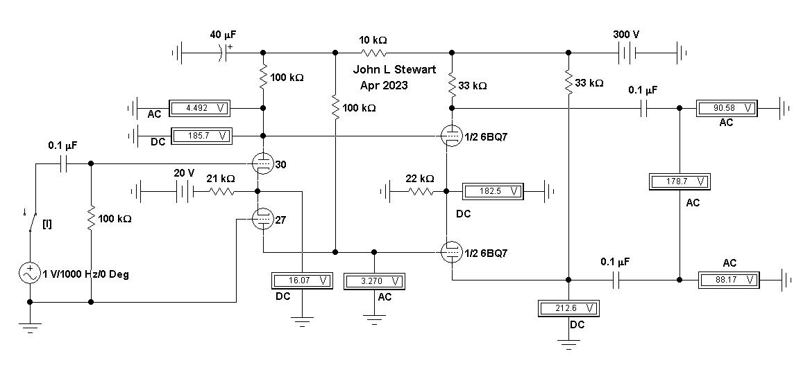

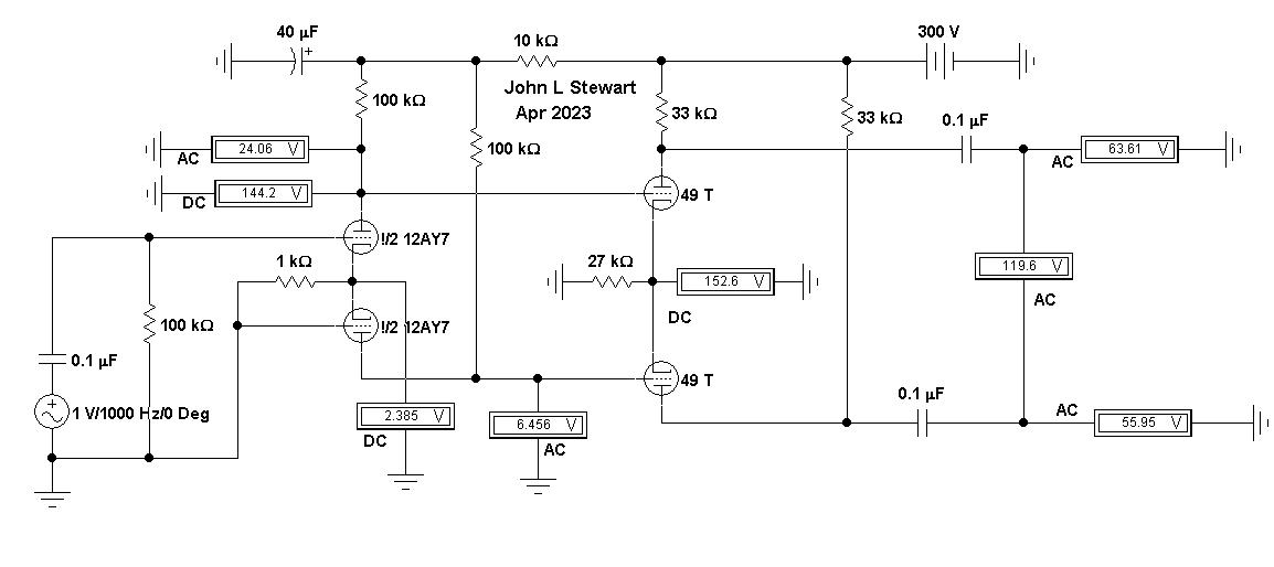

For the subject of this thread there is an infinity less one possible circuits. Here are two for the pleasure & curiosity of the faithful, the lurkers & the newbies.
The first is based on 45’s rant in post #127 of this thread. Its not clear whether the 12AY7 is on the front end. But since it is mentioned first in his spec, that is where it appears in the Sim. Not sure if he still intends for there to be a transformer on the front end, so not in the spec, not in the Sim. For many the question of what mystical property the 49 brings to the party. It is simply another of a group of tubes that were developed in the 1930s for a way to significant audio with moderate B+ requirements. Normally three of these would be found in a Class B amplifier. Complete with much cross over distortion, in particular at low levels.
So letting my mind run freely here is one of several solutions that could easily drive PP 6CA7 / EL34s in triode mode. There seems no data on Miller capacity for the EL34 in triode. For the driver than this is dimensioned to satisfy PP 2A3s. And this cct does not need a transformer on the front end to achieve good balance. No transformer, no expense, no freq response worry.
What about the PS for this hookup? Many will have different solutions to cover this. If there is some interest beyond this post I’ll cover a way that does that in a slick way. 👍

@jhstewart9, your second solution with that odd input stage and the 6BQ7, I would never consider it. Not even under torture.
The circuit with 12AY7+49 should have the input transformer. Without input transformer I would do an LTP with CCS in the tail. The 49 doesn't have any mystical properties, it's just a very linear triode and is very usable for output swing up to 50+ Vrms. The trade-off is its low amplification factor.
And it's dual use: class A "standard triode" or Class B.
The dissimilar diffamp is nothing new at all. I & many others often used such a hookup in regulated power supplies,
The triode is connected to the reference, say a 5651 & the pentode used as the error amplifier. So no tortures & no pain, 👍
