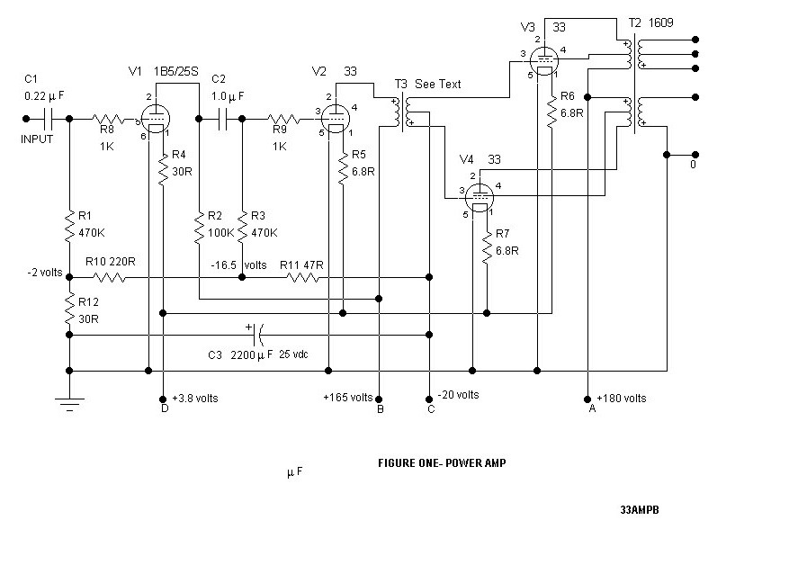

Schematic wanted for push-pull triode connected pentode amp with DHT front end

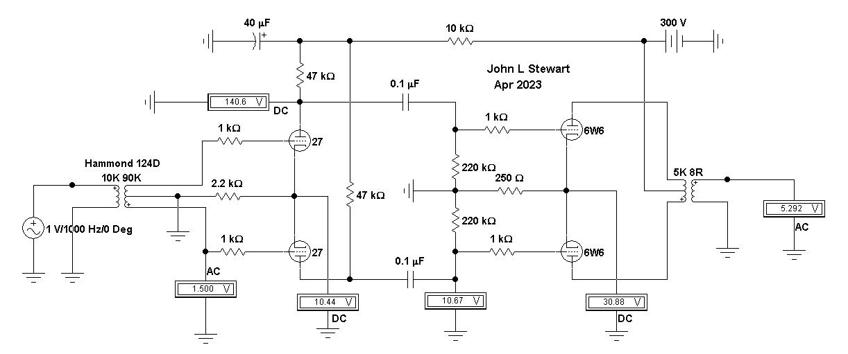

The amplifier sensitivity is significantly better with a Hammond 124D on the front end.
A One Volt signal at the input results in 3.5 watts audio. 👍

OTOH, the H124D specs tell us 10K : 90K impedance ratio, in voltage that is 3X in the forward direction.
Depending on the source signal available, either transformer will work. But as usual, no prediction of sound

The 124 range is indeed listed as 150hz-15K and though there's more bass than that, the treble is indeed a little down compared to the 1140 range based on listening to both in the same setup.
Anyway, the 124B is 10K-to-90K CT with 49% nickel laminations. It has much better ratio between primary inductance and leakage inductance. The latter being a fraction of the 124D's anyway. It's 37 mH vs 125 mH.
The 1B5 is a DHT with a mu of 20. It’s a wimpy tube but it‘s curves a very linear. Assume 1VRMS input sensitivity, you could get a gain of approximately x15 resistively loaded, followed by a concertina you should have at least 12VRMS which is enough to drive a pair of EL84s. With the 1B5s biased at -3V you could possibly get up to or maybe more than, 25VRMS which would drive EL34s. I wouldn’t be scared of concertina’s, they operate with 100% local feedback so they’re rather transparent and with a gain of slightly less than 1 their input capacitance is low enough to mitigate the high output impedance of the lil’ 1B5.

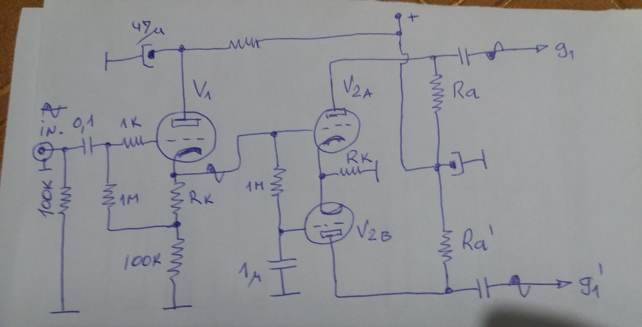

this simple front end never disappointed me when is used for GNFB-free PP power amps , it sounds just OK for me , it consist from one triode (v1) at input connected as cathode follower , which is actually one active impedance transformer with no voltage gain but with almost no distortion , further DC connected to differential phase inverter stage grids (V2a&V2b) , which further drives PP-OPS .

V2 with a CCS replacing Rk works better for me. The Mullard style driver is one of my favourites in general.
However make no mistake, good input transformers have lower distortion than any standard cathode follower. They generally use mu-metal or other high permeability cores. Maybe the cathode follower distortion becomes the same or a bit better below 30Hz which honestly is a very modest benefit.
Their phase splitting performance will never change.
For a colleague 45 ,
-Honestly I like more when V2- Rk is supplied from good regulated high voltage negative rail , without to use of any type of CCS ,
-Mullard style front end stage is mine favorite also , mine schematic from #74 is just mine old variation of that old Mullard concept ,
-Personally I try to avoid any transformer which transforms audio signals , even output transformers , (OTL) .
