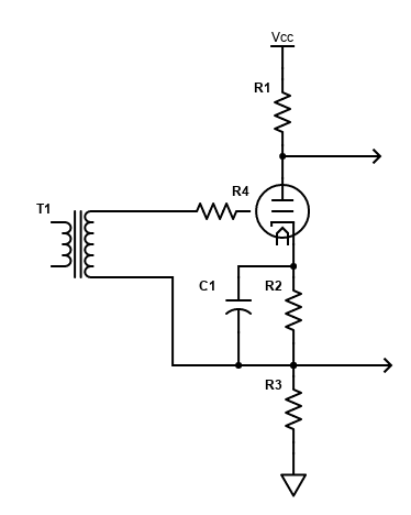

As once suggested by Rayma in a post that in this instance a split-load circuit can have gain like below.
concertina-png.953973
Explained by Merlin:

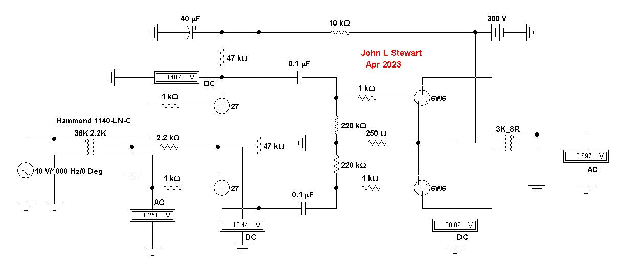

First Pass for Simple PP Amplifier
Since this may be the first time for some working with a PP amplifier the primary objective should be to keep it simple. That is what this one is, pared down to a minimum. That means substituting in tubes that are easy to work with in place of tubes of similar specs but without the warts. The amp in this case is fronted with 27s, their plate families are very similar to the 30. But there is no microphonic filament to create problems.

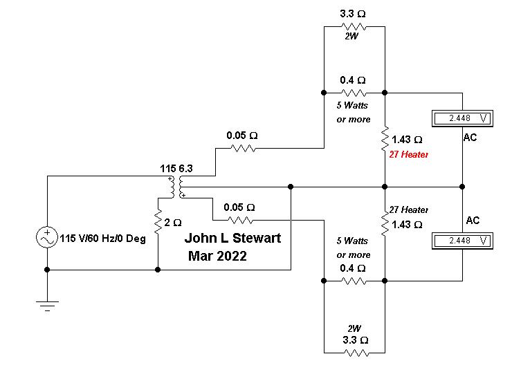

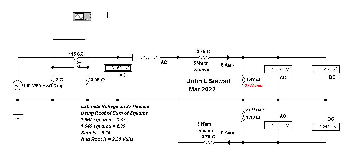

The 27s need 2.5 VAC of the heaters. This can be got from an unused 5VCT winding on the PT. If that is already used by a rectifier, then the 6.3VCT wdg will do. There are two ways to get the correct voltage. Refer to the attachments. The 27s are good for 90 VAC from heater to cathode.
The simulation uses the 6W6 triode connexion. This is close enough to triode connecting a number of TV sweep tubes to get an estimate of the amp performance. The Hammond 1140-LN-C is a step down transformer. The signal is reduced to ¼ of what it is at the input terminals. A 10V input results in 4 Watts of audio not including OPT losses.
The cathode bias is provided by common cathode resistors, not bypassed by an electrolytic. This allows for tube aging. And helps to assure the upper & lower halves of the cct have equal gain. For the keeners among you the connexion reduces even order harmonics. How it will sound is impossible to predict, just as with any other collection of parts. 😀

If you like that modified concertina that has gain . . .
Just remember that the gain balance of the cathode circuit is not intrinsically the same as the gain at the plate circuit.
That is because the cathode circuit has to slew the capacitance of the floating interstage secondary.
That capacitance is effectively in parallel with the cathode resistor (the cathode signal resistor, not the self bias resistor and bypass cap).
With signal applied, the cathode has to move the whole secondary winding up and down.
At high frequencies, if you make the plate resistor and signal cathode resistor equal, there will be more gain in the plate signal, than there is in the cathode signal resistor.
The gain balance is dependent on frequency.
The beauty of the Original and True concertina is that the gains are intrinsically just as equal as the matched 0.1% resistors you might choose to use.
0.05% resistors, anybody?

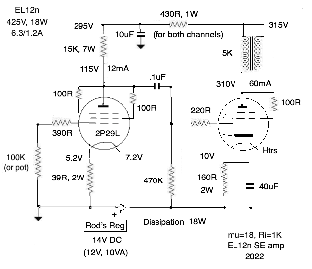

I'm contemplating a PP build myself to use up a pair of PP OPTs. What I have in mind is double this SE design. I already built this in SE and it had plenty of gain and sounded very nice because of the DHT front end. The EL12n has a mu of 15 to 18 in triode. Available new and cheap from the big German electronics sites. No step-up needed. Very economical!

andyjevans,
Push Pull by doubling a single ended amplifier/
Needs a phase inverter to drive the two single ended inputs.
Then, one of the single ended amplifiers needs the primary winding's plate and B+ connections reversed.
Next, connect the Commons of the two secondaries together, and connect the two 8 Ohm taps together.
I did this once, and presented it a VSAC.
But you have to use 2 air gapped single ended output transformers.
You can only use the PP output transformers in push pull, not in single ended operation.
Using PP output transformers is for real push pull, or for Parafeed outputs.
Reactions: tizman
I was using the term "double" loosely. I did mean a regular PP design with regular PP OPT. I was just too lazy to draw it all out. It would be balanced in with 2x 2P29L in filament bias. I'm just figuring out how to balance the input tubes. I can do this with the trimmer adjustment on the Rod Coleman regs if I use separate cathode resistors. I'd prefer to use one filament reg and cathode resistor if the 2P29Ls were already balanced. I do have quite a few of them. Trying to figure this out.
Alternative is a single 2P29L and a concertina.
