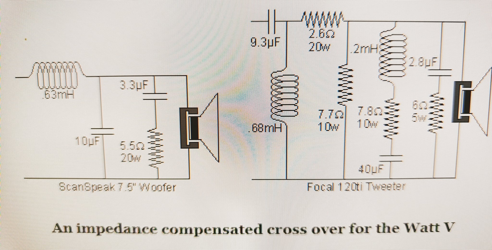

Schematic of potted crossover network for Wilson's Watt V/Puppy V.1 wanted

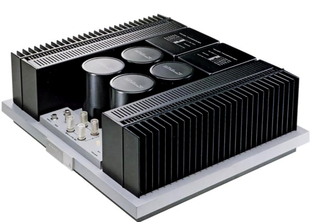

I use beautiful looking and heavy Pioneer M-22 Class A amp with my W/P 5.1. Female vocals and bass is very nice reproduced
