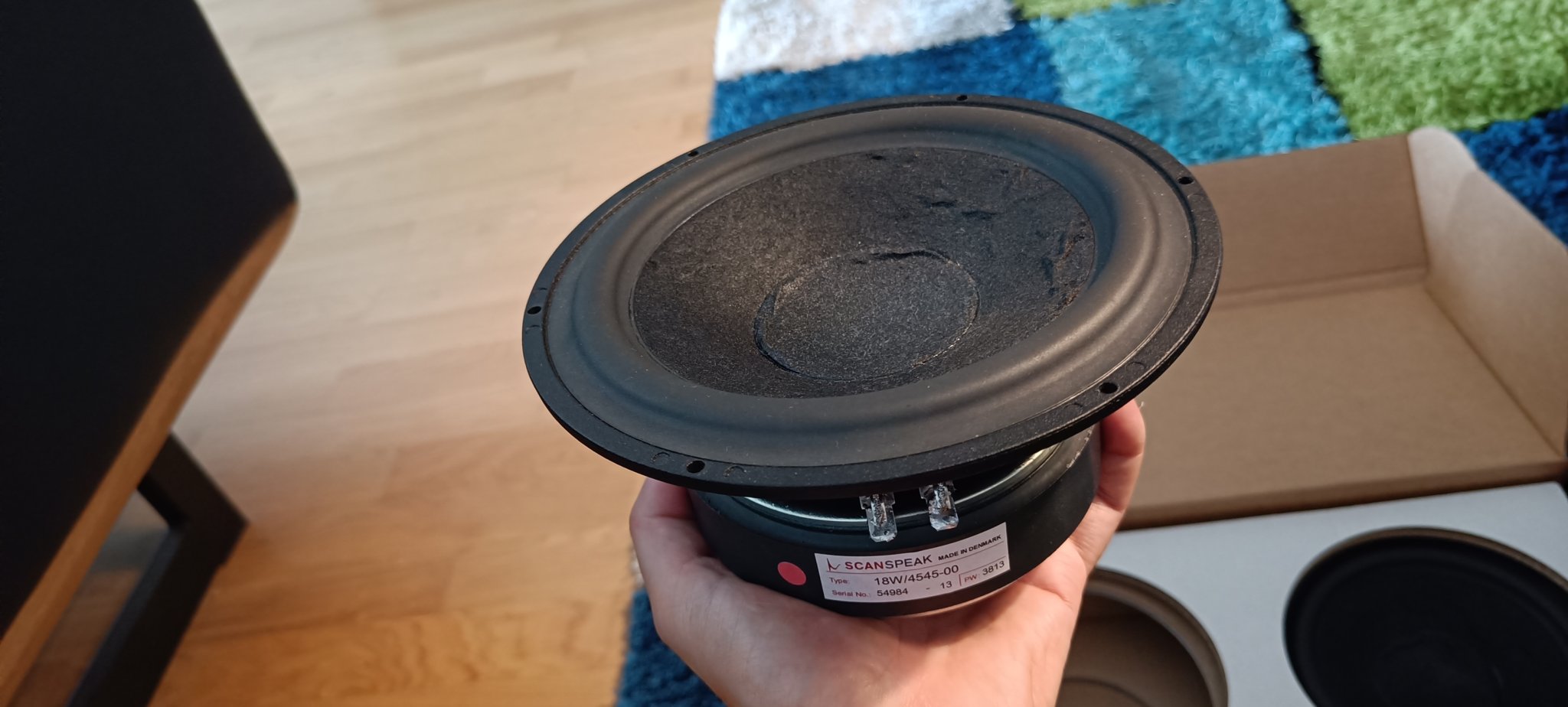

Here's the picture of the 18W/4545-00, carbone fibre paper cone.
Here's the NOS 18W/4545-00.

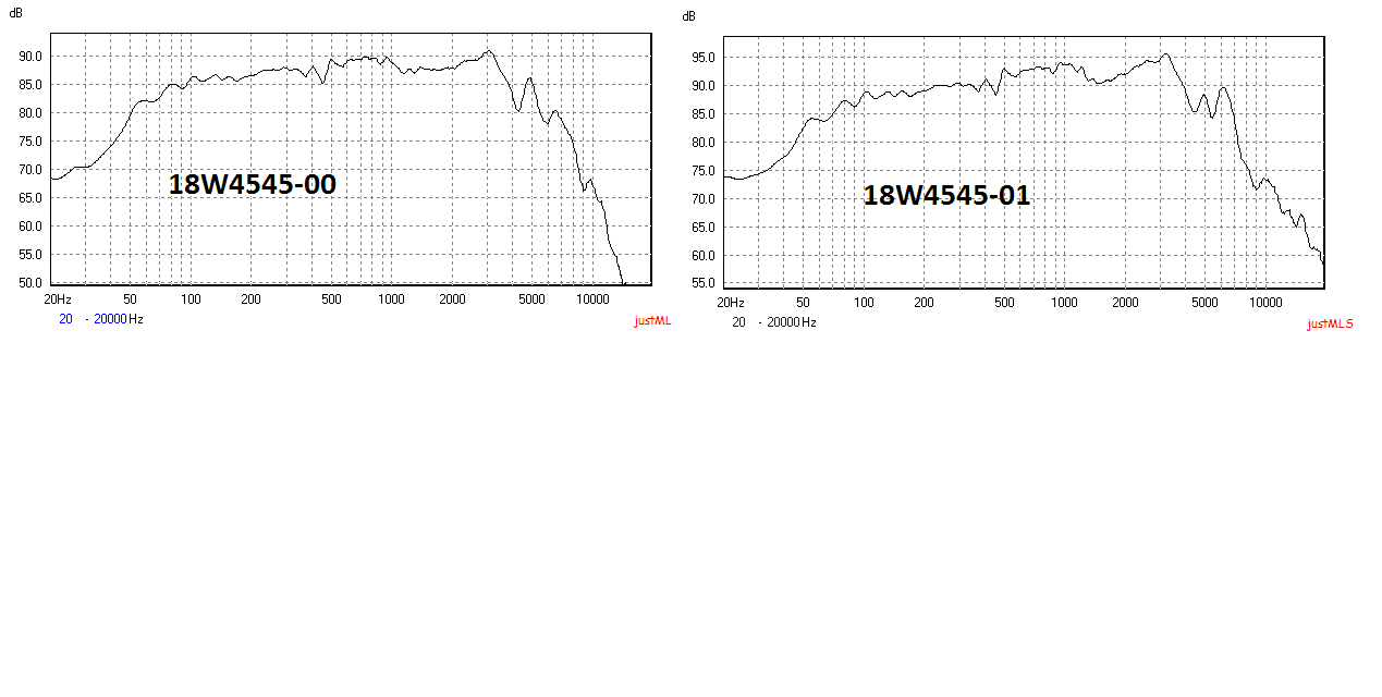

do you compared those two drivers by yourself or just speculating? I have both drivers on hand (4545-00 and 4545-01) from the outside its clearly visible that monting holes are bigger on 4545-01, also cone stifness is diferent. 4545-00 is very soft flexible and 4545-01 is stiffer. from inside (when disasembled) diferences is even more obviuos) here is open air measurements of both drivers.

You clearly do not know what you talking about .. 18w4545-01 code is same , drivers are diferent for WP7 and WP8. I have no info on WP5 thought, but I am pretty sure its completely diferent driver than wp7/8 ,I have both WP7 and WP8 midrange drivers, they are 1.8db-3db more sensitivity than 18w4545-00. mms is 4.2g lighter. both wp7 and wp8 measurens diferently .even is code is same . Measurement dont lie.

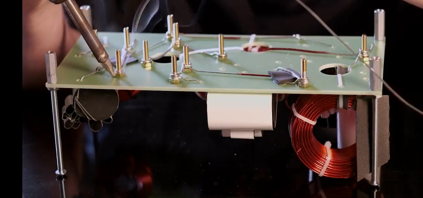

Watching Wilson Audio's Youtube video regarding their capacitors I noticed a rather strangely looking stack of caps in the x-over. What would be the purpose of doing something like this? Instead of using single finely tuned homemade cap? No wonder they need to pot xovers to make this construction stable🙂
Many possible reasons for the multiple bypasses.
1. A non standard value which is impossible to get in their preferred capacitor type. Since they are now supposed to manufacture caps, this may no longer be a valid reason.
2. Many consider multiple bypasses with progressively smaller values to sound better than a single cap.
3. Others believe that using a cheaper capacitor for the bulk of the desired value and higher quality bypasses is a sensible way to save money.

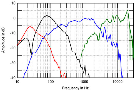

Thanks for sharing some of your measurements. I have notice, that you have studied WATT-Puppies and their drivers in depth using original Wilson speakers.
Your measurements on the WATT6 are in line with John Atkinsons findings on the later Sasha W/P, which shared similar crossover point and steepness of slopes for both midwoofer and tweeter (and later the newest Sasha DAW but with totally different drivers).
As I remember the WATT6 was Wilson’s first move towards a more musical approach compared to the former versions more analytical tendency.
Did you ever analyse the WATT3?
It’s correct, that Wilson factory design axis for the WATT was lower than tweeter axis. However, Atkinson made the measurement at tweeter axis to comply with his measurement protocol and thus make comparisons to other speakers possible (on that given axis and distance).

But after looking at the diagrams for the frequency response here (from Stereophile), I no longer have any motivation at all about knowing the circuit topology and inductor/capacitor values of the potted crossover units, because there is a serious deficiency in this design of the crossover network:
Insufficient filter slope - only first-order, i. e. 6db/oct. and including the driver approximately 12db/oct. with bessel character.
Although 6db filters have the best properties in terms of phase and group delay behavior, but companies like Dynaudio and Wilson Audio don't take into account the fact that one never listen to the crossover network alone.
Therefore I favor third order, i. e. 18db/oct. (Butterworth, BU-III) or fourth order, i. e. 24db/oct Linkwitz Riley (LR-IV), but - very important - including the filter character of the used drivers (measured on the microphone in nearfield above 200-300Hz).

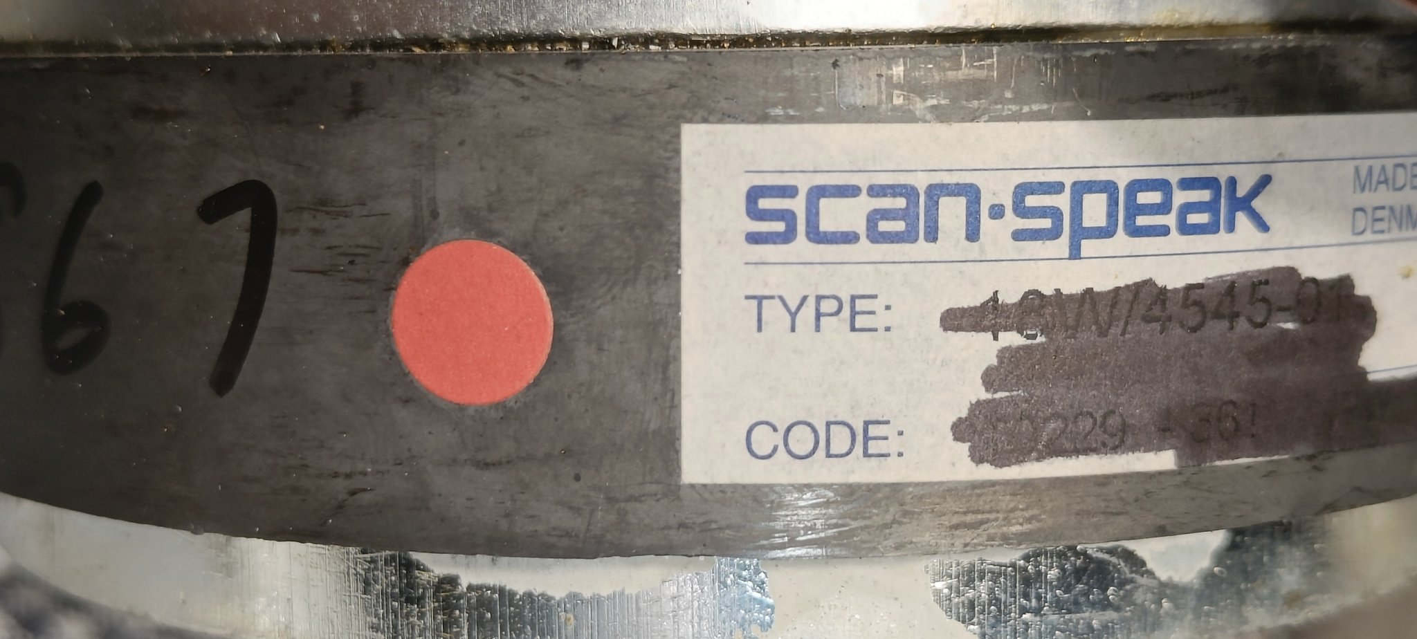

why do you want broken 4545-01? I have some, but not broken. i could them broke( at reasonable fee) and sell if you want.
@elviukai, would you able to help me if you still have these drivers available? The mid-woofer on one of my Watt/Puppy 7 suddenly stopped working. Checked the resistors accessible from the bottom of the enclosure, but unfortunately, the culprit seems to be an open coil. There were never driven hard, there are no burning marks or any other visible sign of stress. If anyone else could suggest an alternative solution, I would greatly appreciate! Many thanks in advance.
