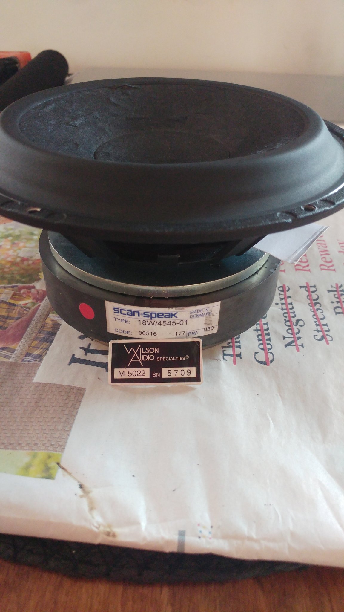

That 01 perhaps indicates a special order by Wilson, it is not a likely to be a commonly available Scan speak part.
I have disasembled wp7/8 midrange drivers many times.. They arfe MIDRANGE drivers, NOTmidwoofers like scan speak. If anyone need them I still have a bunch of those for repairs.

That's very interesting, there is virtually nothing online about 4545-01 and if there is then it is related to Wilson audio, or this thread!.
