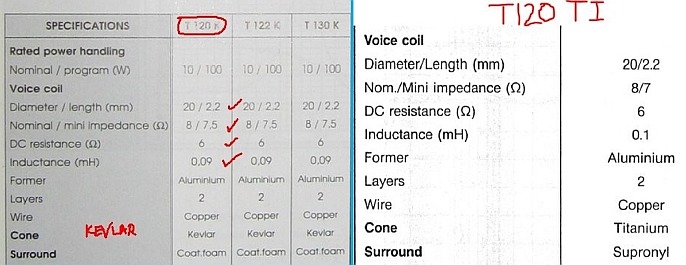

I'm still researching tweeter replacement ideas for the Watt/Puppy 5's. Any ideas on how well dropping Focal T120 kevlar diaphragms would work - measurements seem extremely similar, other than the suspension/dome material (see pic).
Finding a pair of titanium diaphragms seems possible, eventually... but might be a long wait for a pair to appear. (Seems they show up most often in singles - probably because the 2nd one burned to short!)
Focal voice coil specs:

As for the secret souce it must be the difficulty to drive as impedance dips very low, and tweeters foam which falls apart with time and exposure to UV. First requires expensive Hi-End to drive them. As for the T120Ti, sure they were special in the '80s when titanium was the magic material for tweeter domes. The wide dispersion inverted dome with 19mm voice coil and no FF was something special back then, but not today. There were a few versions of this tweeter. I think TB makes tweeter similar to Focal, but with 25mm voice coil - who knows maybe it's better than the french thing. I heard a few of the Focals kits, still have some of their parts.

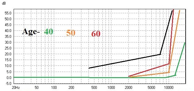

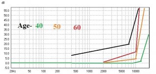

By saying more hights and airy sound I mean last octave after 13khz or so. anything below 11khz is perceved as bright sound.
there is very litle music information here over 12khz , but that small amount of resonably SPL makes souund more realistics.
everything in the world is against those frequencies and tries to "steal" them-
1) live event absorbtion
2)recording/mastering loss
3) replay at home absorbtion loss
4) replay directivity of listening axis loss
5) replay cancelation of highest notes when speakers placed slight of phase.
6) tube amps (most)
7) dac filtering techniques ( not much)
8) Age degenaritve processeses
9) acoustical traumas
10) even long hairs covering ears!
here is average Joe on most ages what they would perceive in speakers as "being airy, without being bright"
black line is most average joe with damaged heraing due improper life style or accidents.

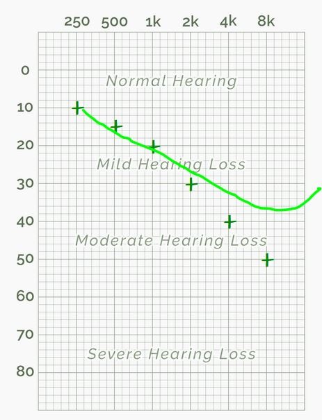

I have used this online test at: https://hearingtest.online/ and found it pretty accurate when comparing to what I had done in the Dr. office. The Dr. version was not quite as bad - probably because the volume sweeps are more continuous rather than large discrete jumps. But overall it was very close - I drew in the approx. Dr. version, which for some reason showed some bounce-back above 8k. For the music that is important to me, I often EQ it to correct my "curve", and despite purists who believe EQ...Bad! I think it is the lesser of the two evils. Better to hear some very slightly degraded signal, than no signal at all!

Back to Wilson tweeters - with the strong similarities in all the voice coil specs (and the associated tweeters) of the Focal TC series above, do you think there would be a serious quality change in replacing the titanium diaphragms with the kevlar or fibreglass (both of which are currently much more easily obtained than the titanium)?
