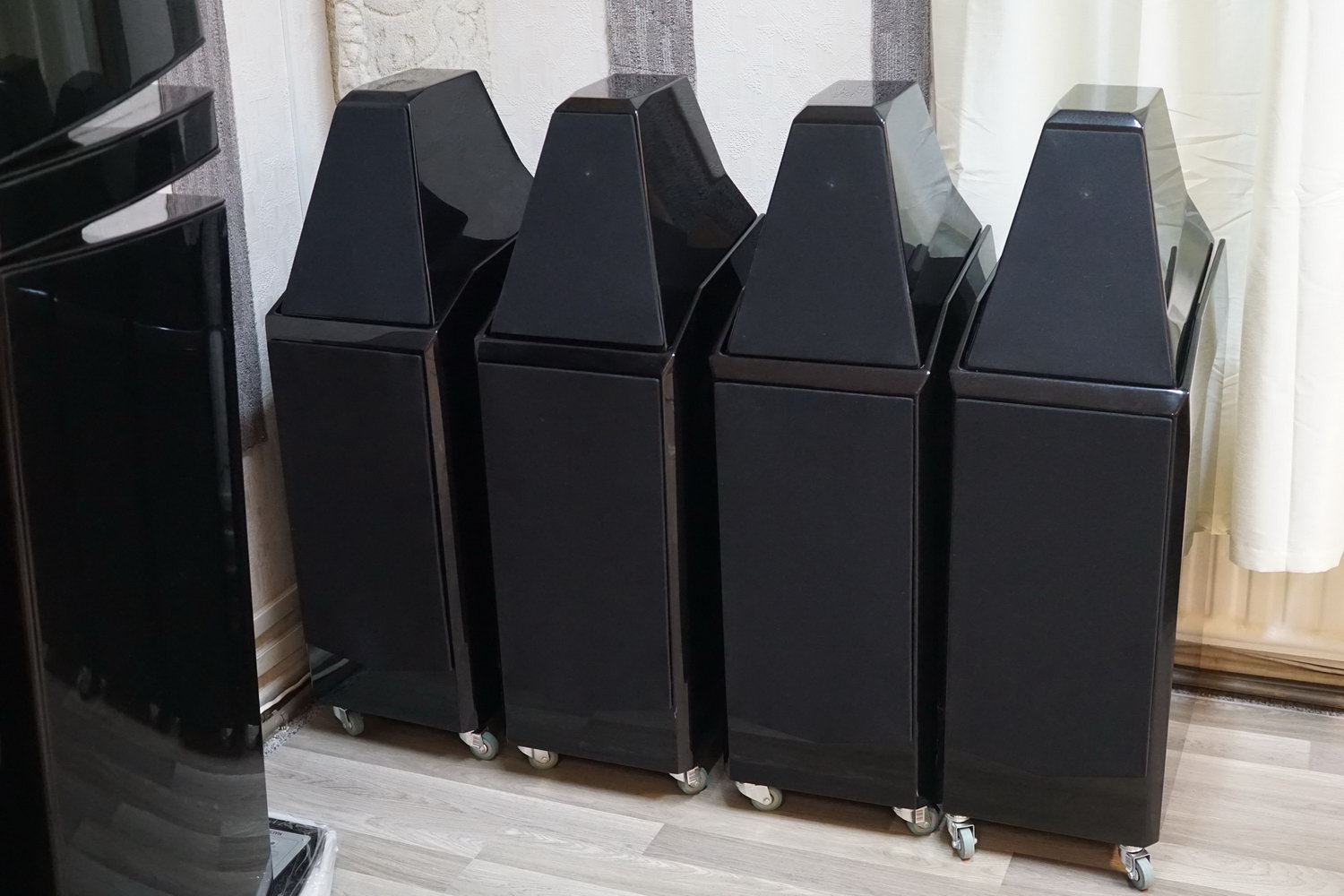

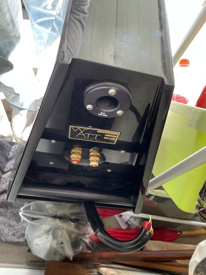

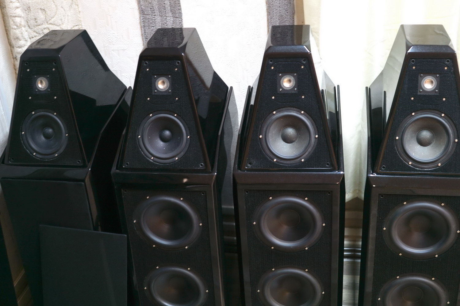

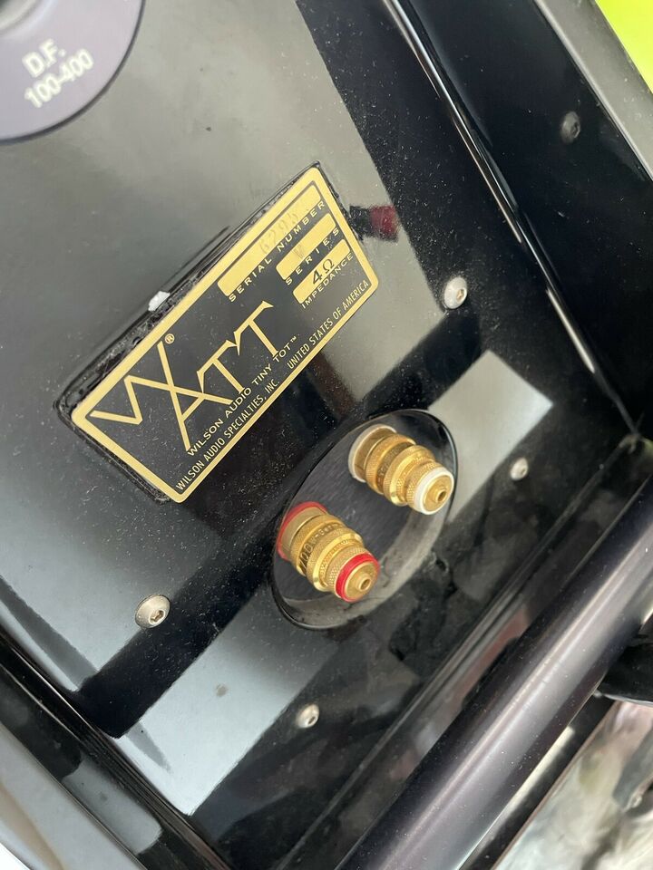

Schematic of potted crossover network for Wilson's Watt V/Puppy V.1 wanted

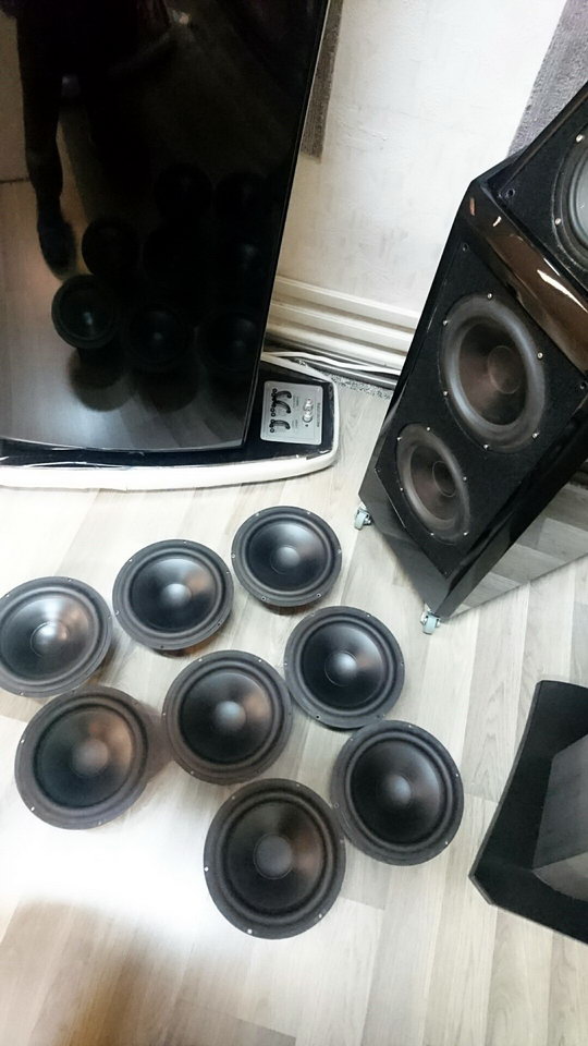

A bit unrelated but does anyone know how different is the 18W4545-01 (M-5022) from the 4545-03 which seems easily available? Datasheet? It seems the 01 version is available under the 8545, should i assume similar T/S?
These questions are just to ascertain whether the 03 may work as a reasonable approximation for a 01, or is an authentic M-5022 the only option. Obviously both channels will need to be replaced.
Any advice will be appreciated.

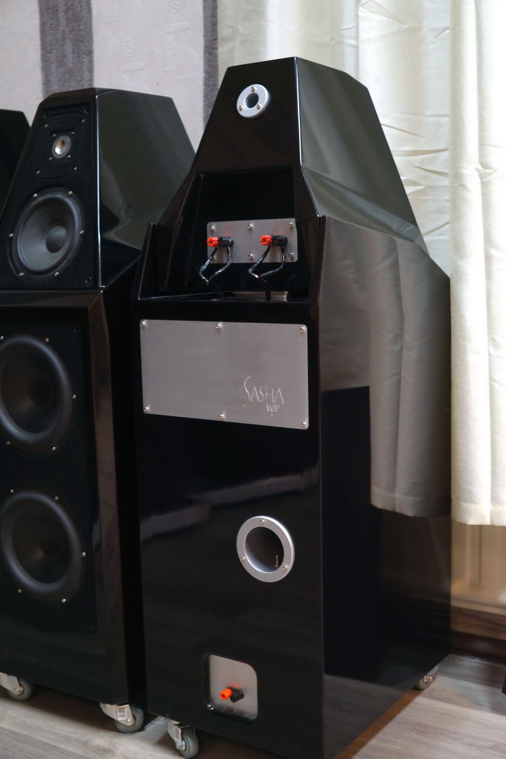

here is sasha mid driver disasembled(on the left) quite diferent SD from usual implementations.
bass drivers have 4 layers VC and are much heavier than its older siblings from dynaudio. bass is cleaner, more punchy and handlle nearly double the power before going to compression or overexcursion comapring to "1000W'' 21w45 version.

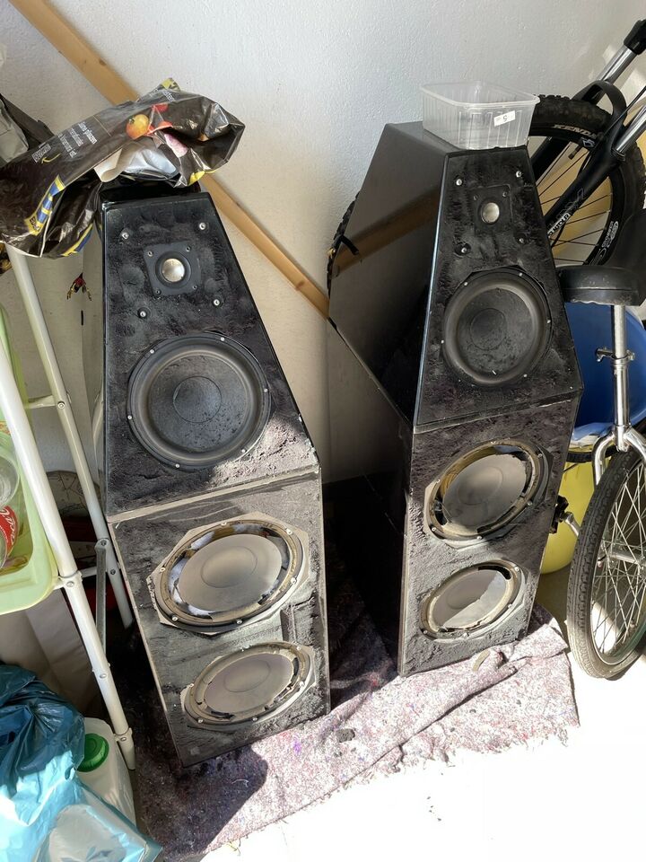

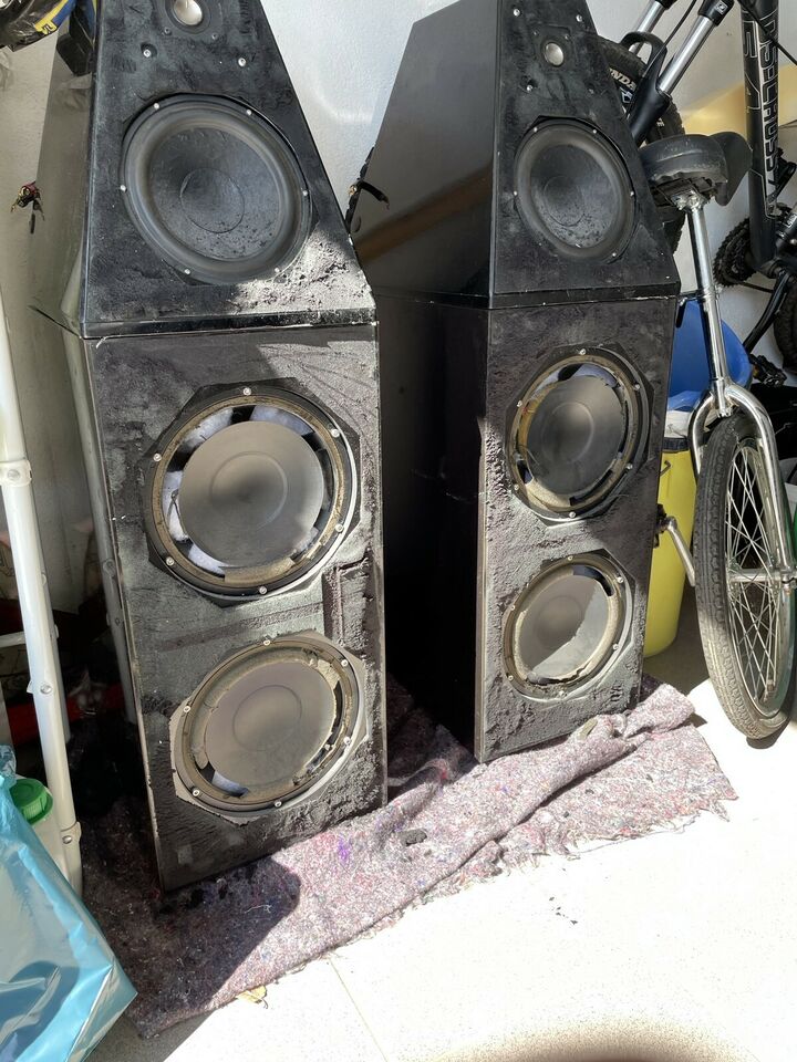

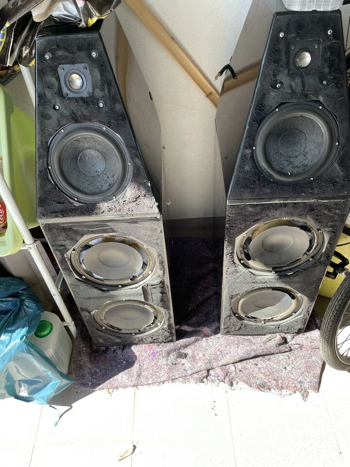

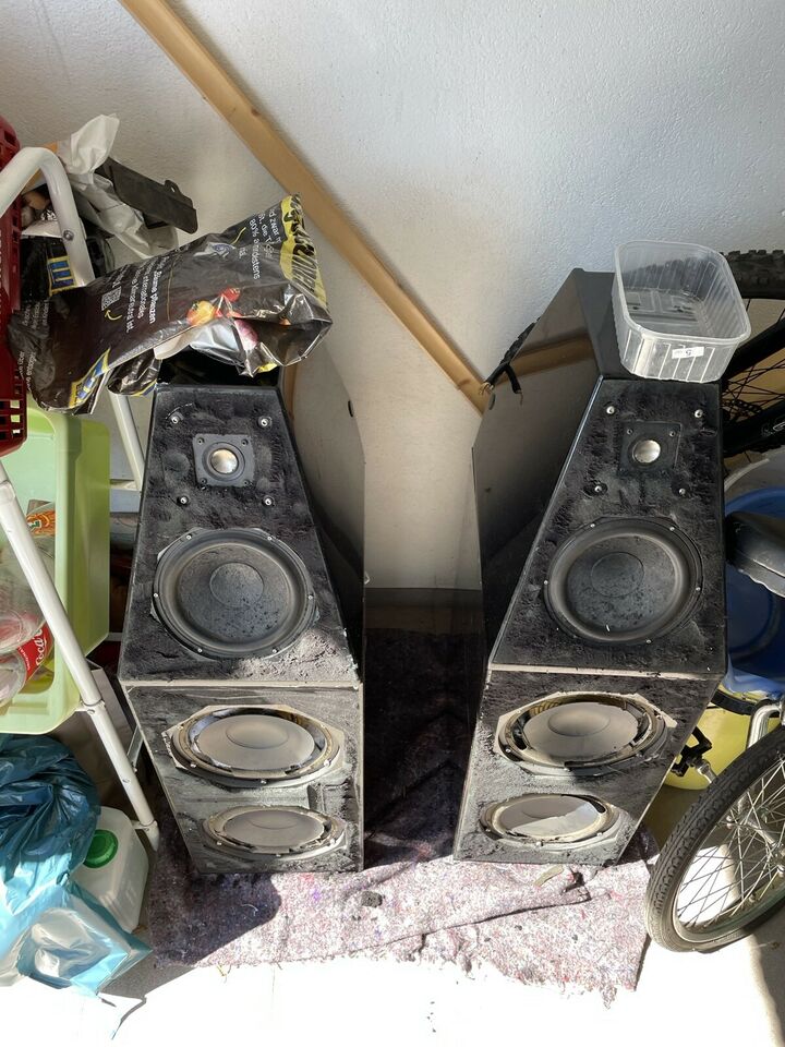

Hi all - so re: older Watt/Puppies, given their age and assuming capacitor degradation + potted xovers, are these all heading way out of spec & impossible to repair over the near future? Wondering because I just picked up a pair that need all 4 puppy surrounds + tweeters.
Surrounds replacement no problem.
Tweeters will take some patience to find repairable ones, I assume.. (or... these fabric domes, btw, look to measure very similar to the TC120ti's, on paper: https://sbacoustics.com/product/satori-tw29dn-b/ - maybe just live with whatever differences there may be).
But the main question - if xovers can't be updated, is it worth the hassle? Or maybe it would make more sense to just use the cabinets as a starting point for a DIY 3-way design? Thanks for any input, Chip
