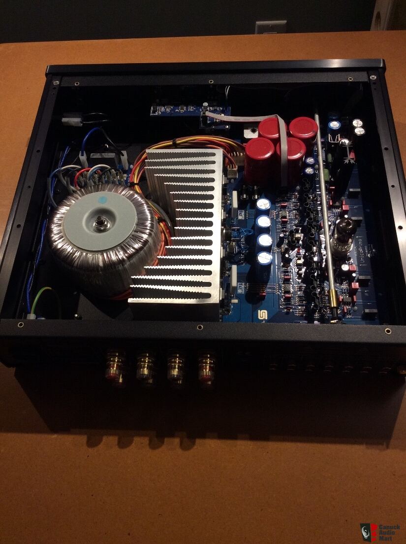

I am a long time reader first time contributor hoping to rekindle this thread with an issue I am facing.
I own a Unison Research Unico Primo integrated amplifier. I have been running an upgraded Siemens 1960's ECC83 (12AX7) tube with great success [contemplating some of the Underwood Hifi mods but haven't ventured very far down the road yet]. I recently came by some Mullard ECC82 (12AU7) 60's tubes and after *inadequate* research thought that these could be experimented with....
I started the amp and it goes through a 30 second warm up cycle. Near the end of the cycle I heard a 'pop' at about 75 db. Now my sound is very jumbled (unintelligible) and intermittent. I am hoping it is just a blown fuse.
I am hoping to hear back from this group on advice as I work through this. My next step is to compare the tube specifications (will post here) and try to find the potential circuit. From the tube pinout I will try and trace back to the fuses and inspect those. I am somewhat worried that I will not be able to visibly observe the blown fuse.

12AU7 is NOT a direct replacement for 12AX7 !!
Yes, in "classic" circuits like guitar amps the 'U' can replace the 'X' with a distinct loss of gain.
This Unico Primo is NOT a "classic" tube amplifier. It has transistors to do the heavy work. I do not know how the tubes and transistors interconnect; if a "wrong" tube could damage transistors.
The tubes probably do not "trace back to fuses". Fuses protect against fire; even very sick tubes do not directly start fires.
"Do not open the amplifier !
There are no user serviceable parts inside.
Valve replacement should be carried out using only valves of the same type and matched in pairs.
The Unico Primo uses one valve type ECC83 (12AX7)."

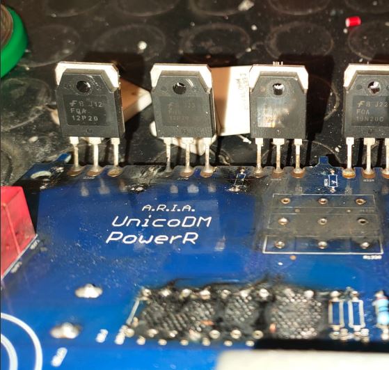

The fault is as follows: The amplifier went into protection. -UP fuse blown. The output transistors are not broken. After installing the fuse, there is no negative half-wave in the left channel, there is practically no signal in the right channel, and when the volume level changes, the DC voltage level changes. After the repair is completed, I will let you know what the problem was.
Now, did you survive this repair ?The fault is as follows: The amplifier went into protection. -UP fuse blown. The output transistors are not broken. After installing the fuse, there is no negative half-wave in the left channel, there is practically no signal in the right channel, and when the volume level changes, the DC voltage level changes. After the repair is completed, I will let you know what the problem was.
