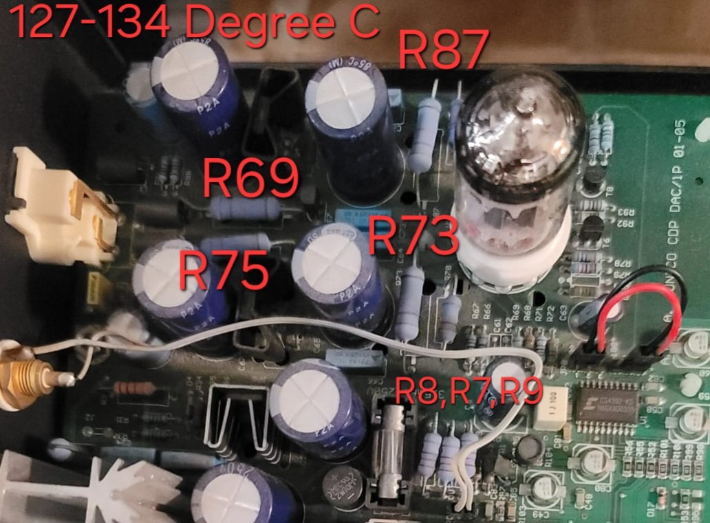

There seems to be a lot of dust in the player. If you have access to an air compressor try to remove the dust. Check solder joints of these resistors. Which designation do they have ?

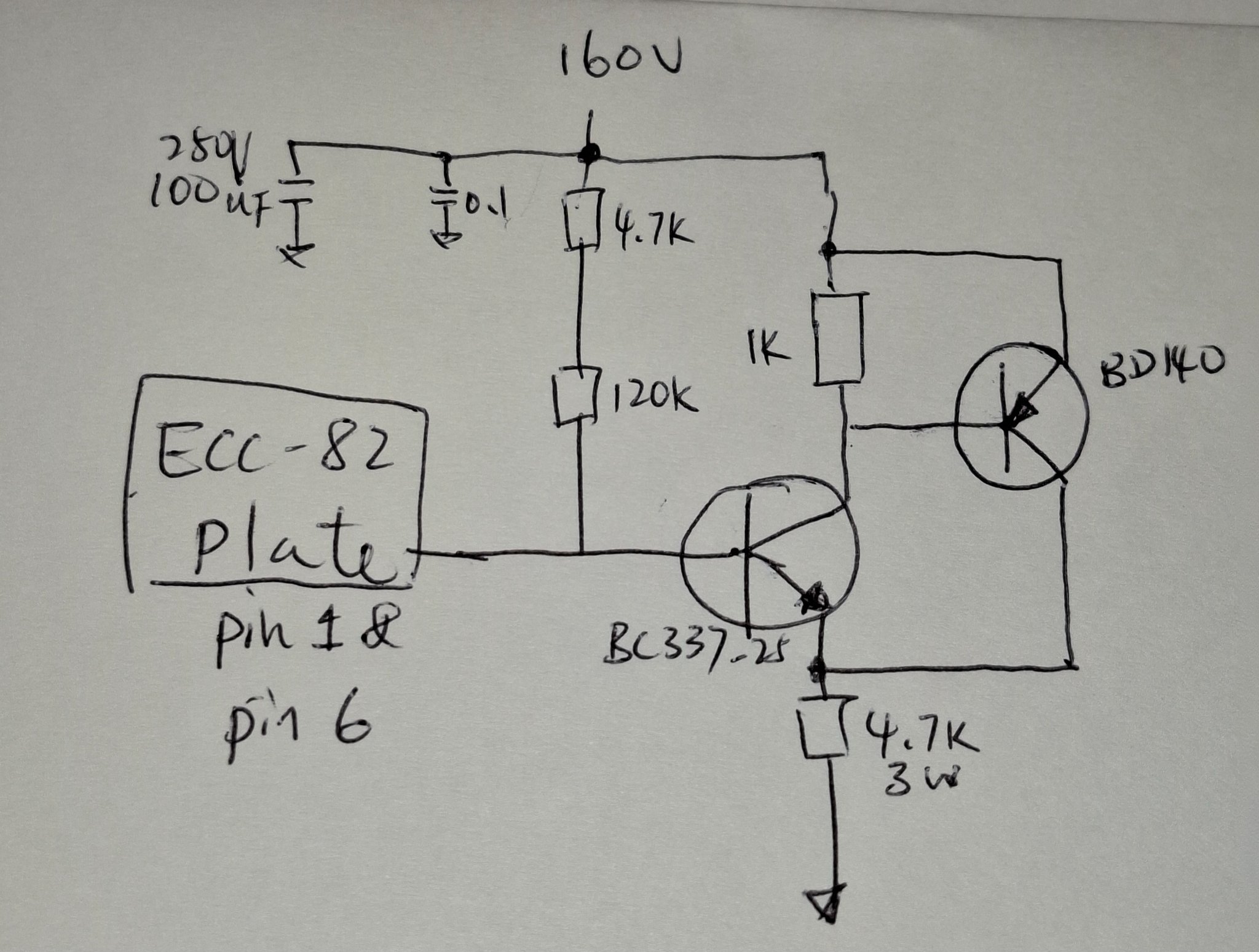

Plate voltage at regulator output is nominal 150V.

1. Identified Overheating Components:
Resistors R6, R7, R8, R69, R73, R75, and R87 are operating at 127-134°C(designation photo attached. )

R6, R7, R8 are 120 Ohm 1W resistors feeding 5V DAC from the filament supply (12,6V, not 6,3V as suggested in post 138).
You can expect some heat here. Check 12,6V on one side and 5V on the other.
R73 and R87 4k7 3W are voltage droppers in the hv supply line. Check 150V plate supply on one side.
R69 and R75 4k7 3W are load resistors for output emitter followers. Some heat is to be expected on all four.
Re the muting circuit it would be good to know these voltages are correlated to the drop out or not.

2. HV Supply Status (R73/R87):
- Input: ~159V
- Output: ~88V
3. Output Emitter Follower Load Resistors (R75/R69 - 4k7 3W):
- Follower side: 71.1V / 70.4V
- Assumed ground side: 0V
4. **Critical Discovery:
- R8 (120Ω 1W) was found with an entirely unsoldered pin—only touching the pad somehow !
- Could this be the cause of intermittent dropouts?

These are useful measurements. Voltages seem to be fine. Check R6, R7, R8 in parallel are 40 Ohm.
If you are sure muting voltage remains low all the time (except during warm up I suppose) the reason for drop out must be a different one.
Using a scope check all regulator outputs for oscillation, avoiding shorts.
I do not advise to change caps at random, also to avoid the risk of damaging through hole connections.
