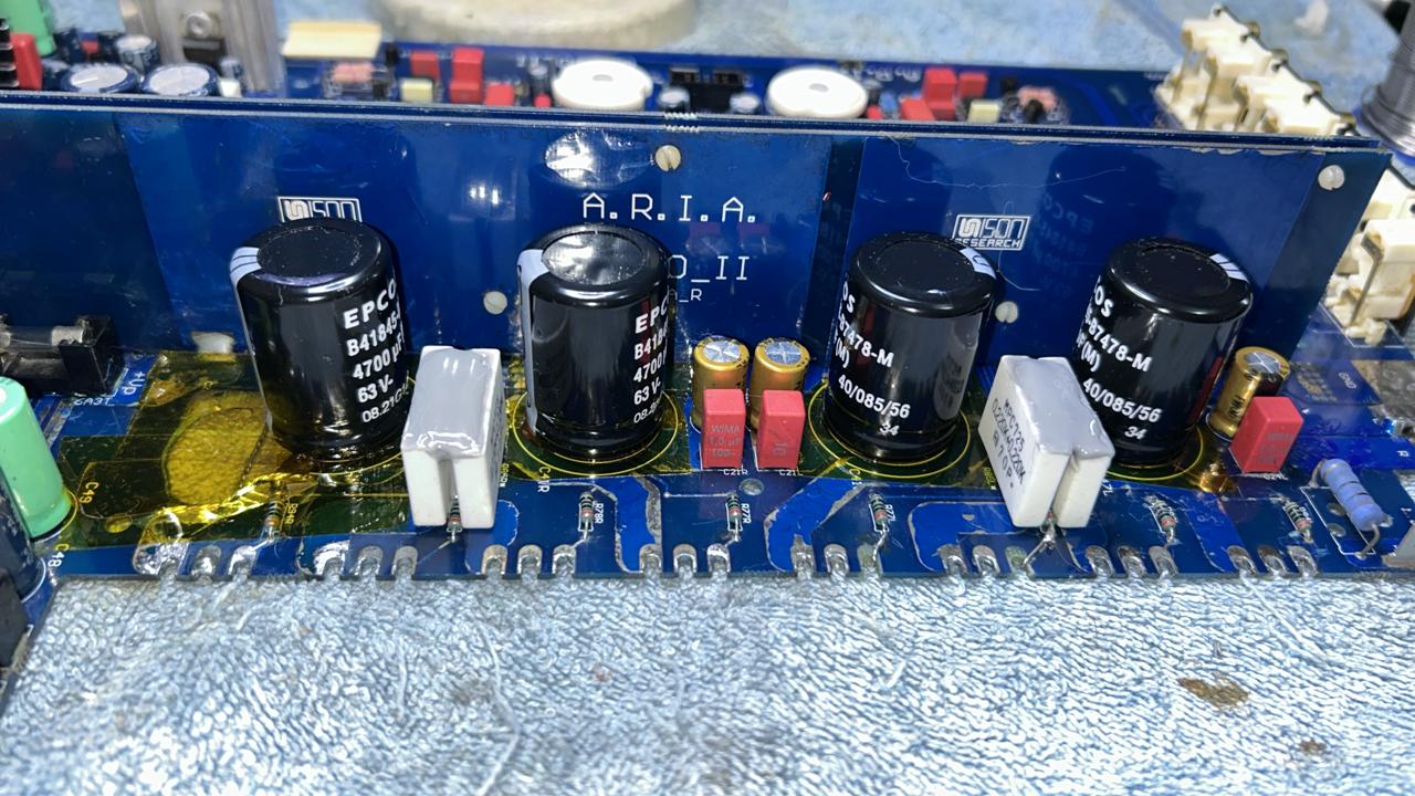

Problem found:
I checked and compared each resistor on the board between channels and found that R35 and R39 (soldered on the board) have about 0.5-0.8Meg instead of 1Meg like in a good channel. I have seen this problem before, unsoldered R35 and R39 have 1Meg, that's why I replaced the OP AMP. Since the board had no suspicious areas, I did not see any problem and looked for leaks in the components.
There is a leakage of about 1-3 Meg on the board between pins 5-6-7-8 of the OP AMP and R35/39, at least.
I removed OP AMP, film capacitor, cleaned the top of the PCB with ethanol, the cotton swab turned dark brown, like after pine resin.
I cleaned and installed all the native parts back, and everything works fine, let's hope.
I noticed that many resistors on the PCB are placed above the board tracks without gaps, so they can short them.

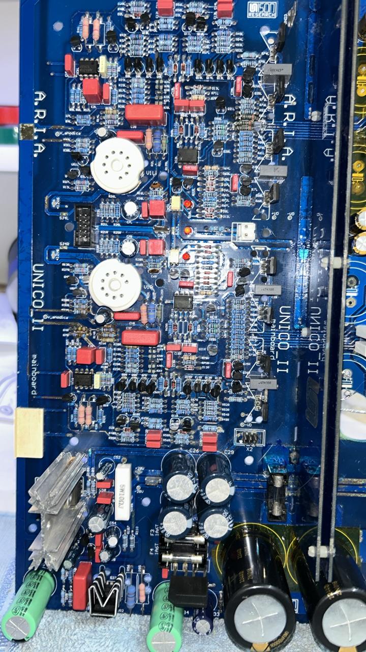

Measurements:
Driver boards with 7 transistors in parallel: 0.64-0.65V at 150 ohms, 4.2mA 67.5Vce 0.28W per transistor - they are quite hot, 2W per board.
MOSFET 0.003V at 0.1R, 30mA per transistor (measured in "Volts" range)
Power consumption at 230VAC:
Start up: 38W (BIAS LEDs on)
Operating mode: 57-58W (BIAS LEDs off, AMP LED on) - in this mode the feedback works and the BIAS control depends on the mains voltage. I use a 150W light bulb for protection, and it flashed very brightly periodically.
If you remove the BIAS boards and the tubes, the driver transistors will generate square pulses at about 1Hz, so you cannot test the amp without the tubes. You need to install BIAS boards, and then you can check without tubes.
Difference in the circuit (Unico SE):
R38a/R80a are shorted instead of 4.7R.
Questions:
1) When amp turned on, a faint "pum" sound is heard from the speakers. Is this normal?
2) 5 seconds after switching on, very quiet music is heard in the speakers. In the operating mode, the sound becomes normal. Does the amplifier really not have 100% mute at startup?

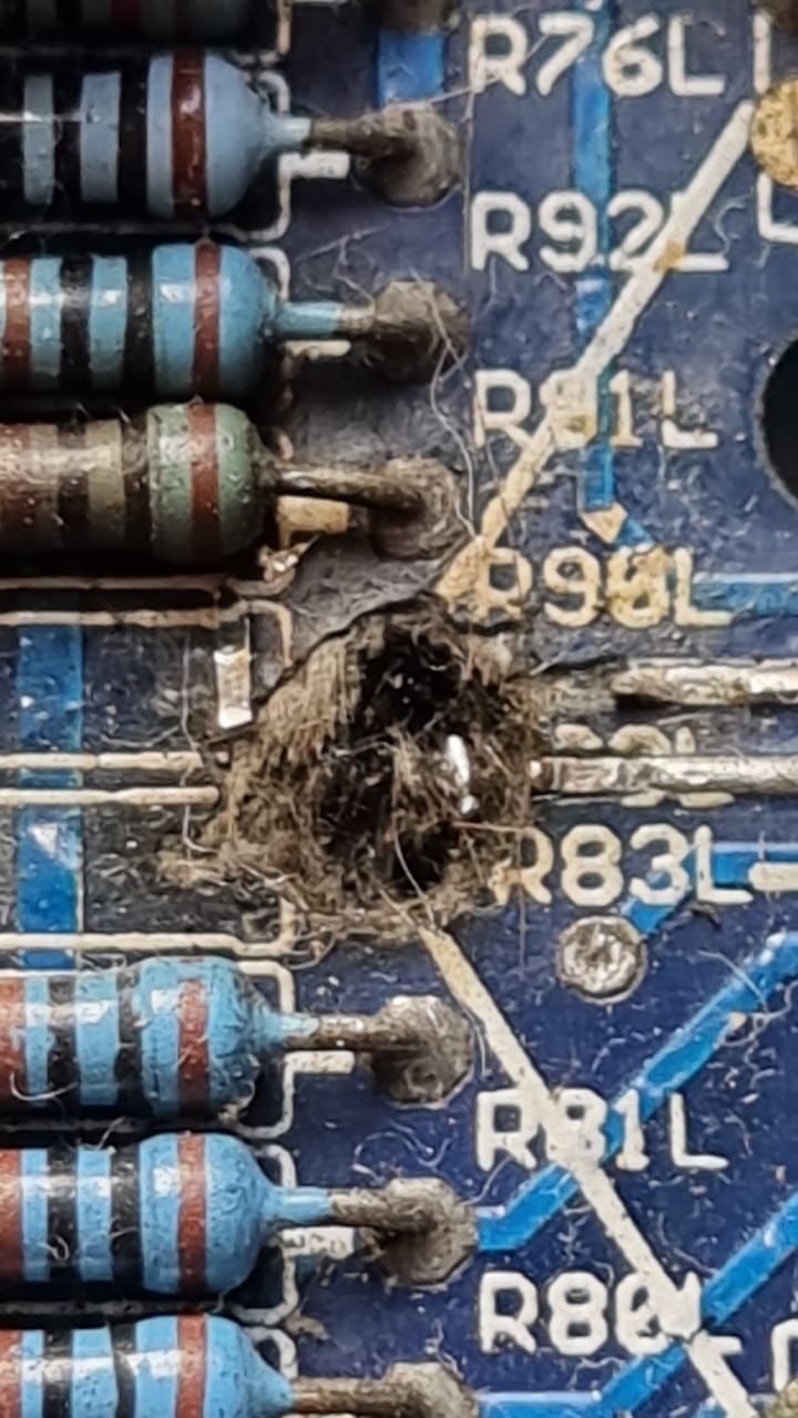

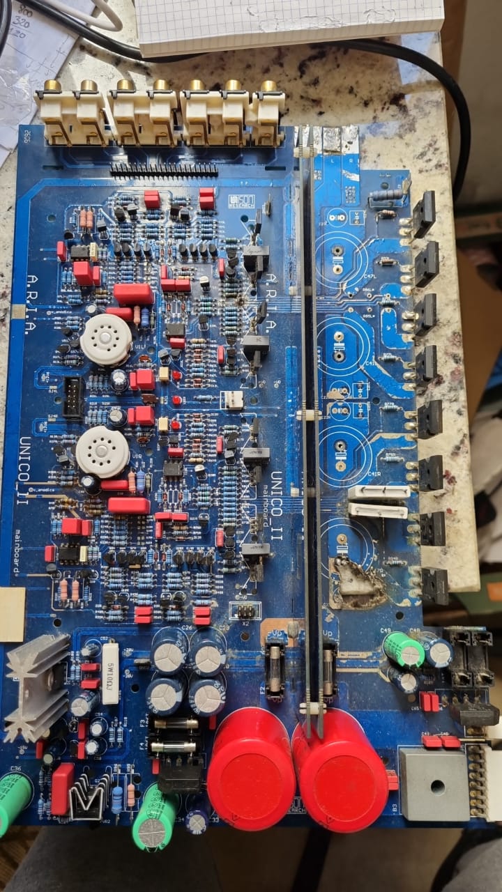

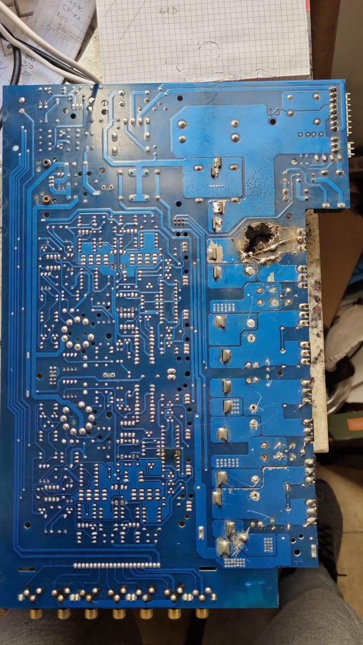

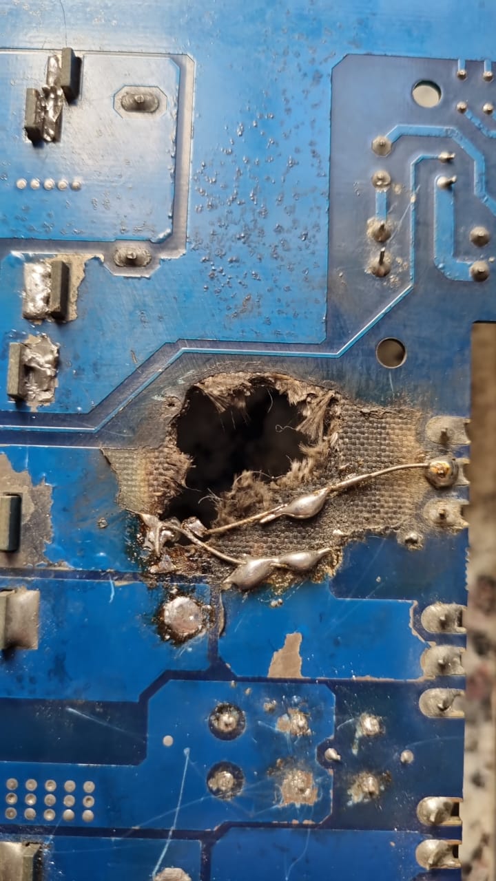

Hi all!
I bought a UR Secondo in dire conditions, one of it´s output capacitors got literally burned, leaving a huge hole on the main board. Most of the damage has already been fixed but there are 2 small resistors on the pre amp section whose trails got burned as well. Unfortunately, I wasn´t able to track the resistor path down and the diagram provided on this topic doesn´t present enough information for me to do so.
Does anybody here could please help me out providing a high res picture of the board or a in depth schematics so I can try to bring this beauty back to life?
Thanks in advance!
Here are some beofre/after pics:

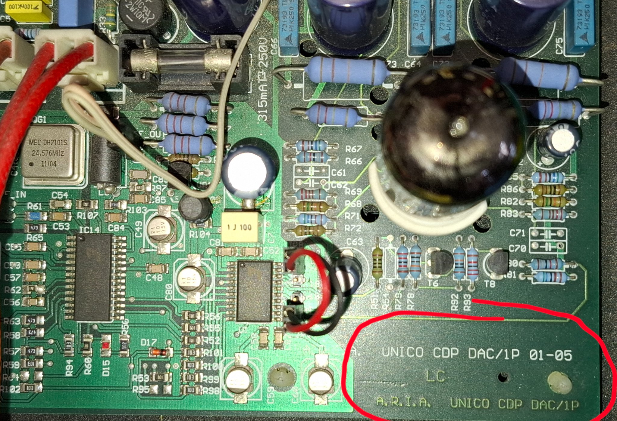

Check the various supplies, 6,3V for filaments, 5V, 12V, and 150V for tube.
All are made with LM317 or the like (not stated which one for 150V).
Muting transistors are T6 and T8, they receive a common signal at their bases via R79 and R93 which are common to the mute line. You may want to check the voltage at this point when the signal drops out.

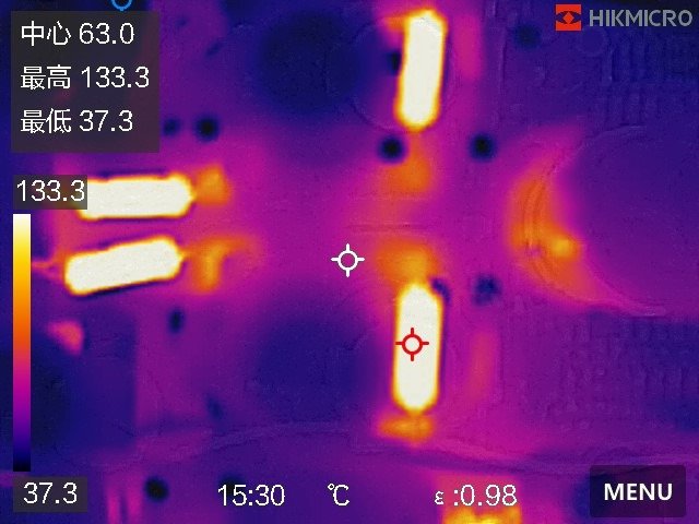

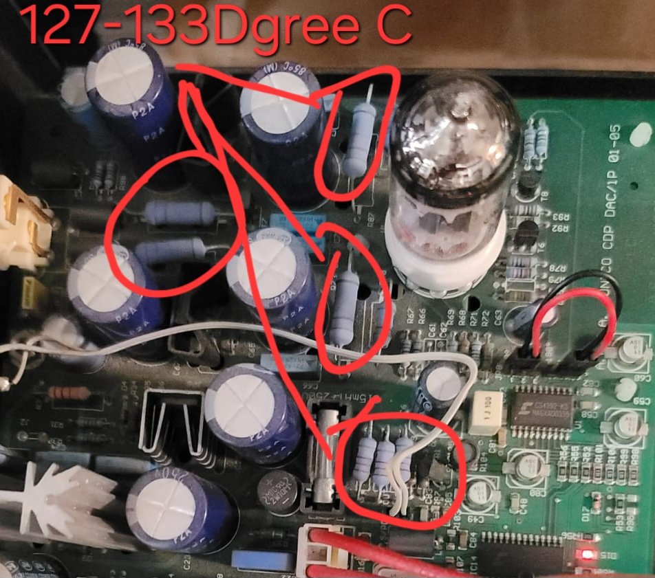

Hi as_audio,
Following your guidance, I measured the following voltages:
-at Transport power points: Stable +5V and +12V
- at ECC82 plate voltages:
~71V (with valve),
~82V (without valve)
***No voltage changes observed during audio dropout events
However, thermal imaging revealed several blue resistors operating at 127–134°C (see attached photo). Even with the chassis open, these temperatures seem excessive.
Key questions:
1. Are these temperatures exceeding safe operating limits? (If assuming rated 155°C, they're near maximum and may degrade prematurely)
2. Could this overheating be the root cause of the issues?
3. What specific voltage/current measurements should I check next? (Particularly at these hot components)
Your expert advice would be invaluable. Many thanks for your continued help!
