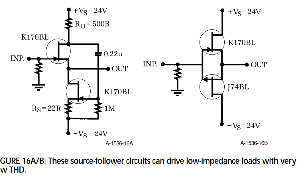

The JFET Frontiers Part II article provides a better and more pertinent example. The left circuit is a single ended follower (While cathode follower with feedback) and the right one is a push-pull follower. I have tested similar buffer circuits both in simulation and in a fully built real version. In practice with today's cheap JFETs, I found the left one had too much distortion compared to the right one. We are operating the current design at about 5V above this level, i.e., with 60V supplies (same as a 30V each positive and negative supply) to accommodate the output FET dissipation limits. If you wish, you can reduce that to 50V to give peace of mind. In the article I linked above, Nelson also mentions that the J113 can sustain up to 70V. I have observed the same in practice. We are well below 70V peak to peak swing.

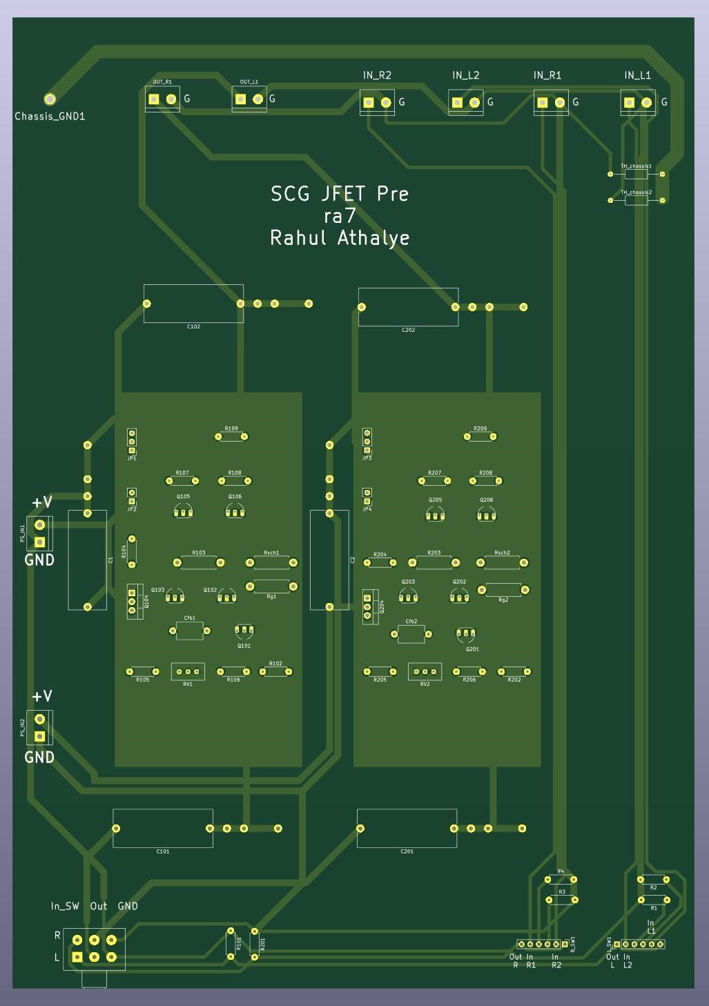

Rahul's circuit is simple to build but does require some care and thinking in its implementation. Not that I am an expert builder on the level of Rahul but the circuit has served me well for over a year in various configurations Rahul has given me to try. I have learned LOTS from this interaction with a generous man with two fine ears who builds his gear to enjoy listening to music; circuits that have allowed him to hear more of the music.

I wish to build this beautiful circuit someday! I patiently await the gerbers....then...lots of noob questions headed this way 😉

By the way, the two followers you show above are both push-pull. Self has a BJT version in his Small Signal book.

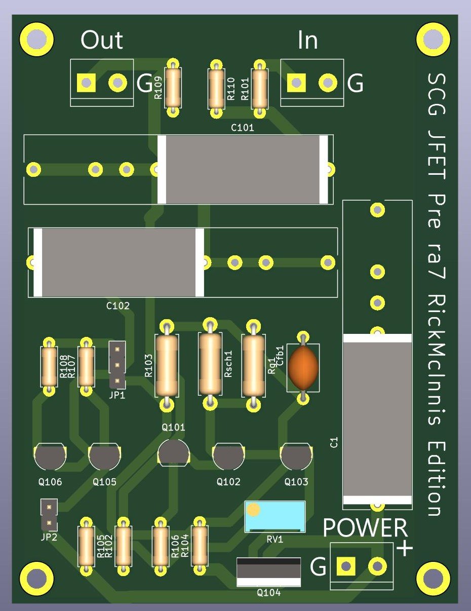

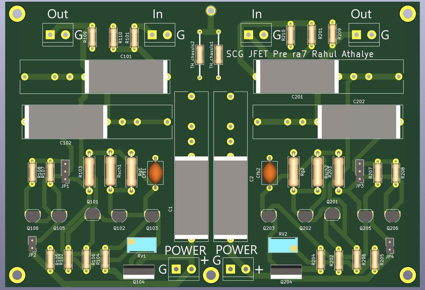

Yeah, @CWelsh52 , interesting things are coming. I am finished with the PCB. Working to check it and then place the order.

The circuit has been optimized for what I want it to do: swing 40V comfortably and sound good. It could serve in many different ways. I have a few iterations myself, some using LND150. For now, the focus from me is on doing the PCBs for this version.
Three boards, ready to go.
1. The large one is intended to fit into a standard diyaudio chassis and it has onboard provisions for switching two inputs and the volume control.
2. The middle one is sized to go over the original board, so you can borrow power from the original board and then use the new circuit.
3. The last one is for Rick, who has provided me with tremendous support and encouragement throughout the development of this new version. I'm calling it the 'RickMcInnis Edition.' It is actually a really neat idea because this smaller card can be put into the chassis of power amps, such as various follower and other amps, such as the VFET, SIT, F4, and others. Thank you Rick!
- Schade Common Gate (SCG) Preamp
