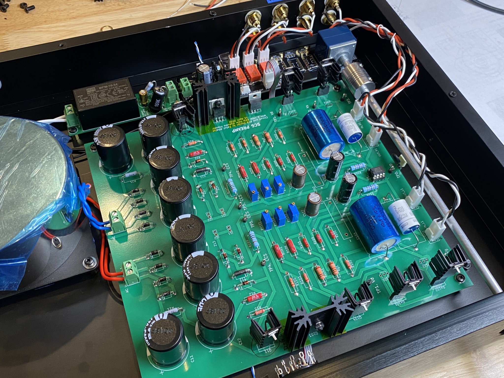

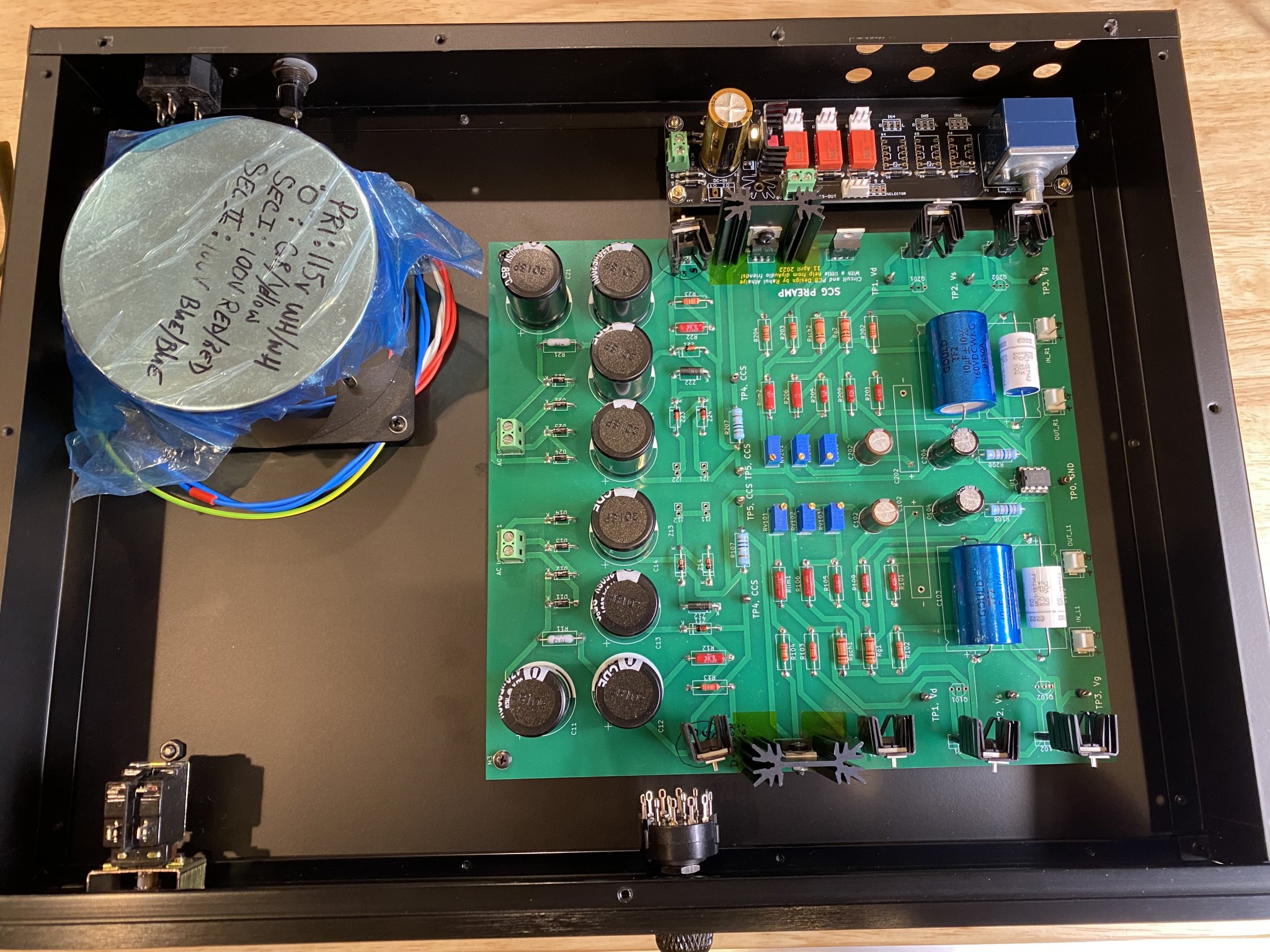

I just got my board a couple days back. Shopping for parts now. Have you tried different gain devices?SCG is getting close to a real home.

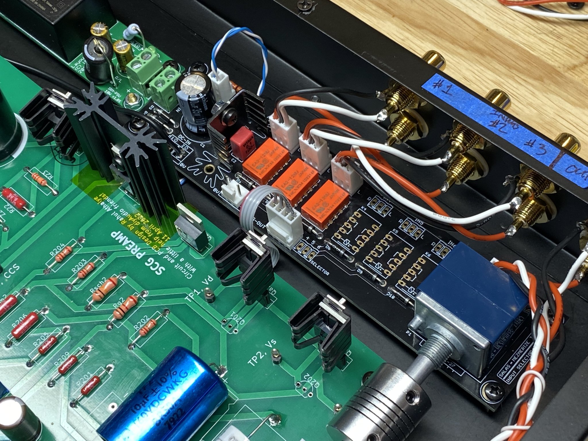

The lid will need a circle cutout so the Toroidy can peek through approximately 10mm. An additional small 10va trafo will supply power for the I-Select board.

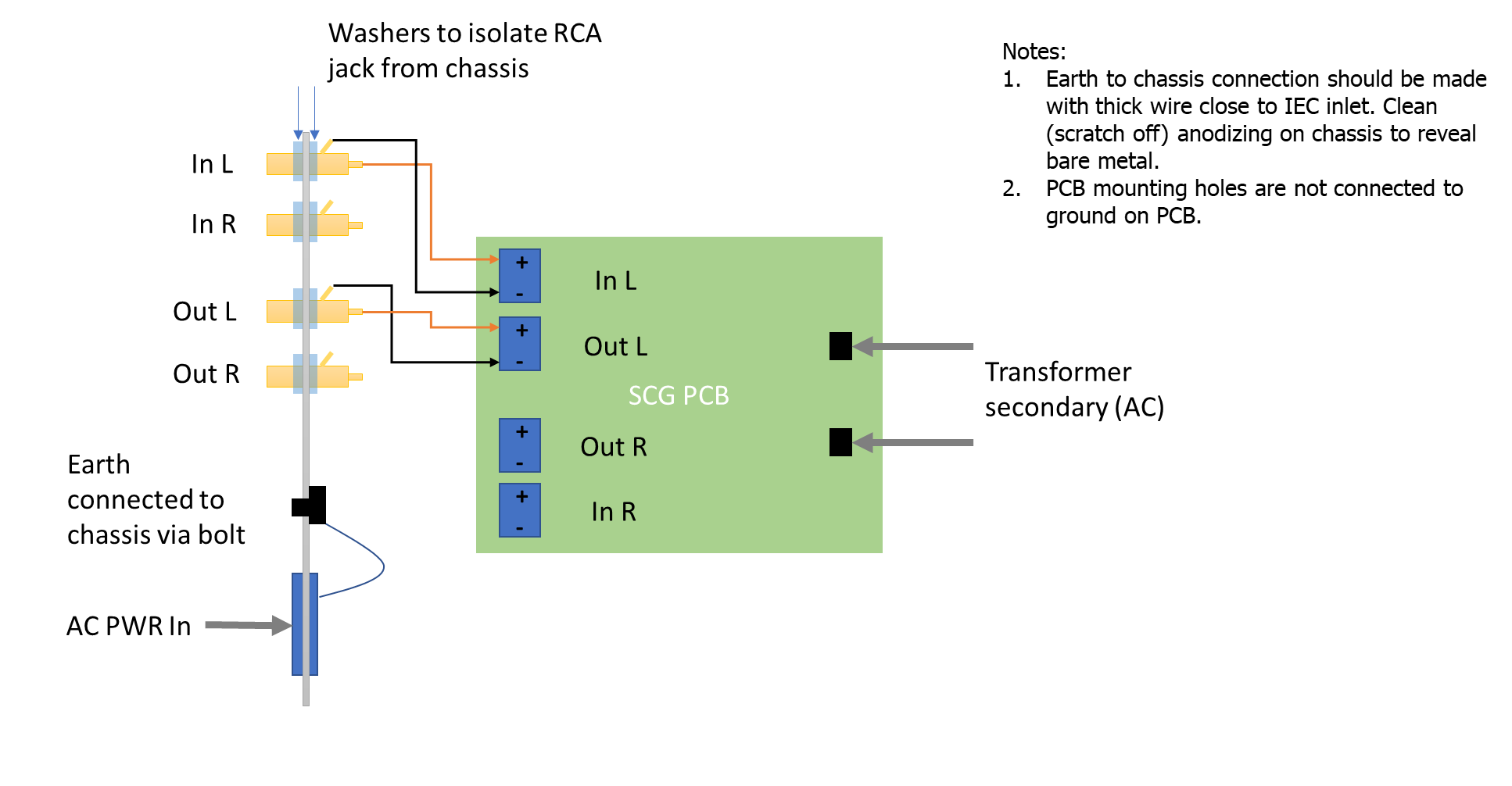

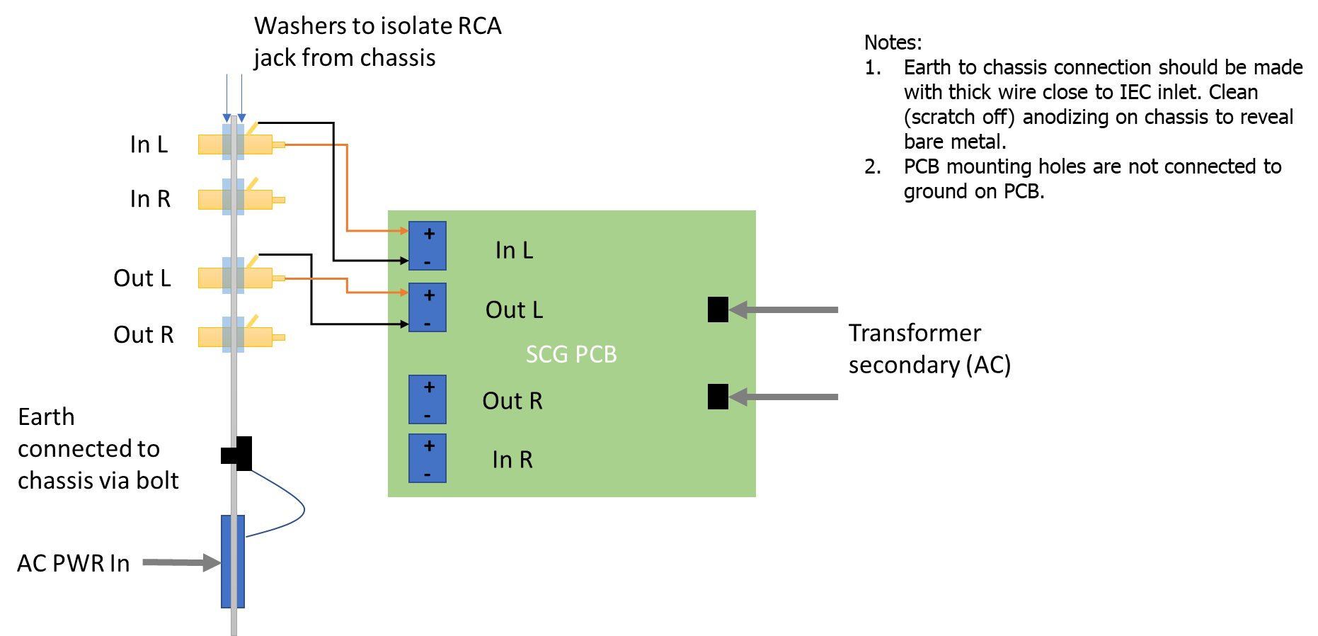

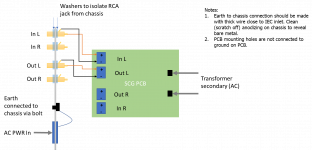

Here's a wiring diagram. The way I have wired it, the signal ground (or reference, as I like to think about it) is not connected to chassis ground. Signal reference and power ground are tied together on the PCB, but you don't have to think about that.
After the RCA jacks are on the chassis, check if there is any continuity between the jack and the chassis. Check each jack. They should be completely isolated from the chassis, otherwise you might get ground loops.
Best practice is not to leave the active circuit floating. Suggest you tie the common signal/PS ground to chassis ground with a 10 ohm resistor. A CL-60 thermistor would do as a link too.
Steve, yes that works too and there are various ways to do that. Simple resistor or CL-60 works.
SCG is singing beautifully in her new home driving Big MoFo amps. Just a few minor details to button up like the front panel indicator leds for source selection. Now I can easily experiment “rolling” transistors.

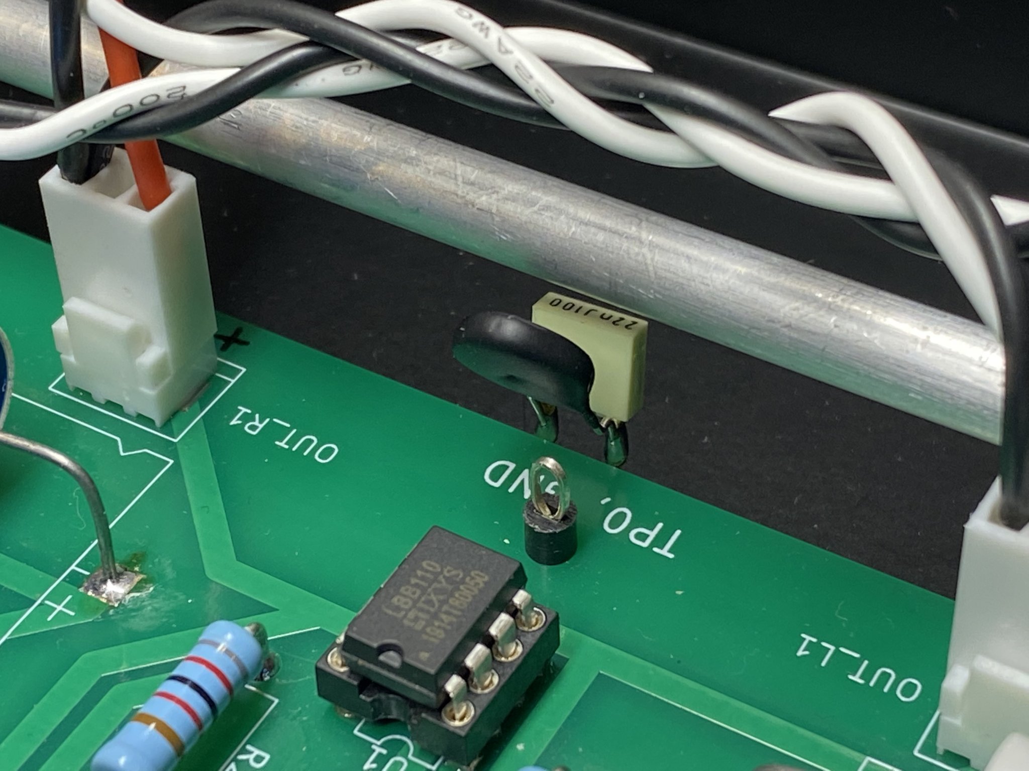

Interesting. I have populated the bypass caps position using vishay mkp 0.1uf while waiting for the 50uf electrolytic caps to arrive. Not sure how this small value bypass will affect the outcome though.I plan to use a 10 uF film cap (Wima DC Link in C102/202 only.
