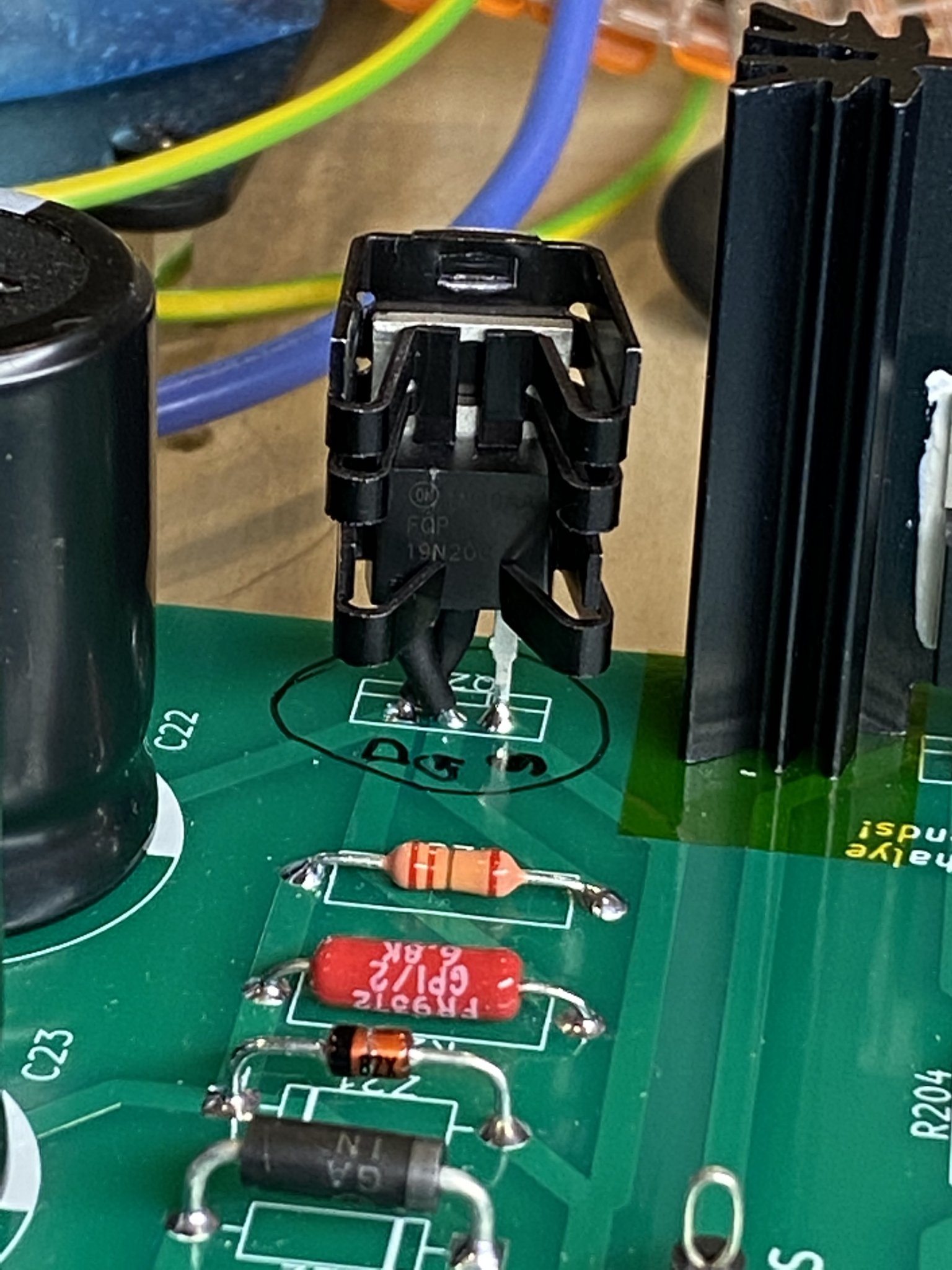

A. Test that the regulator is working. Remember that the FQP part has the gate and drain pins reversed on this first set of four boards that went out.

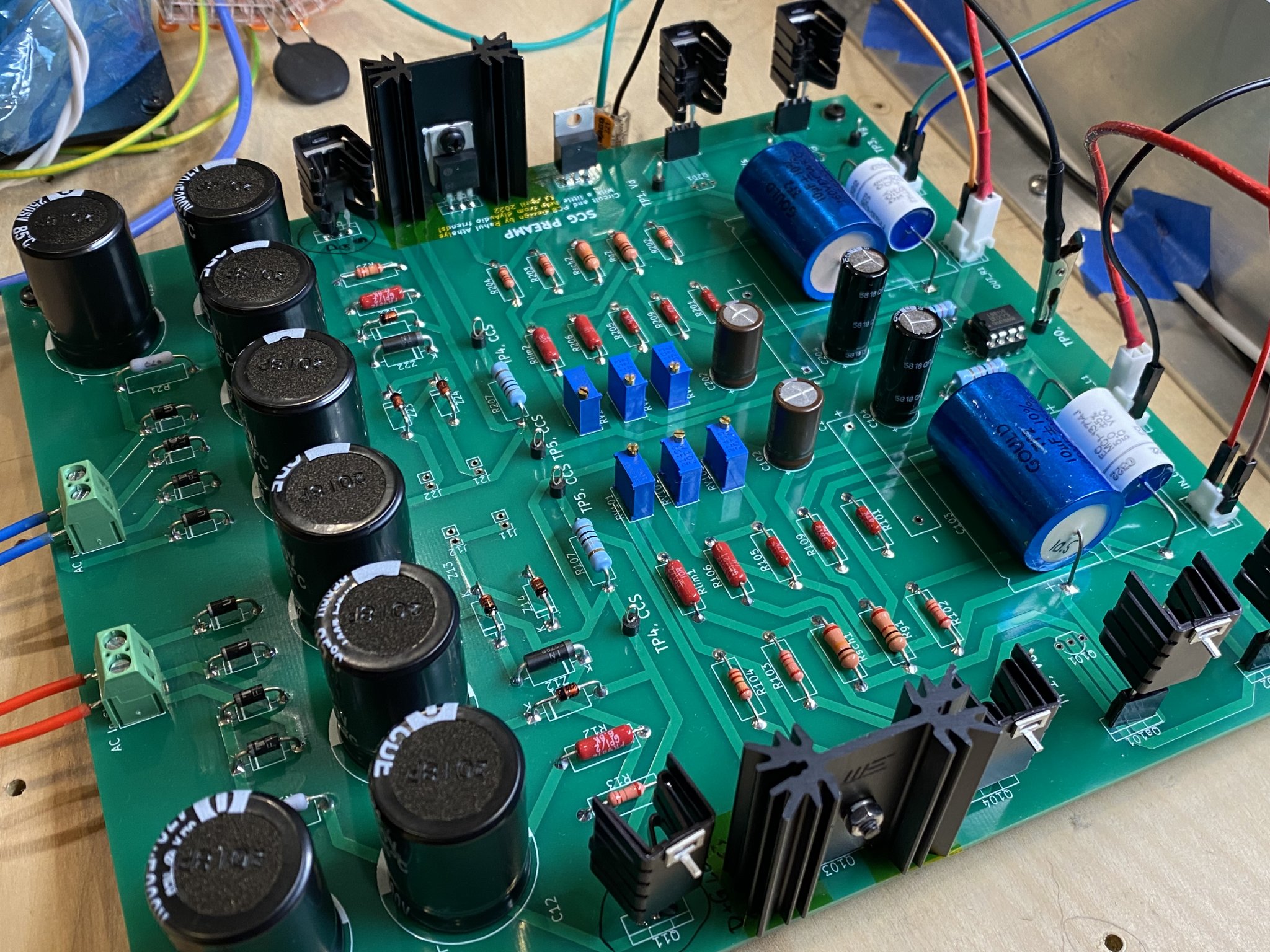

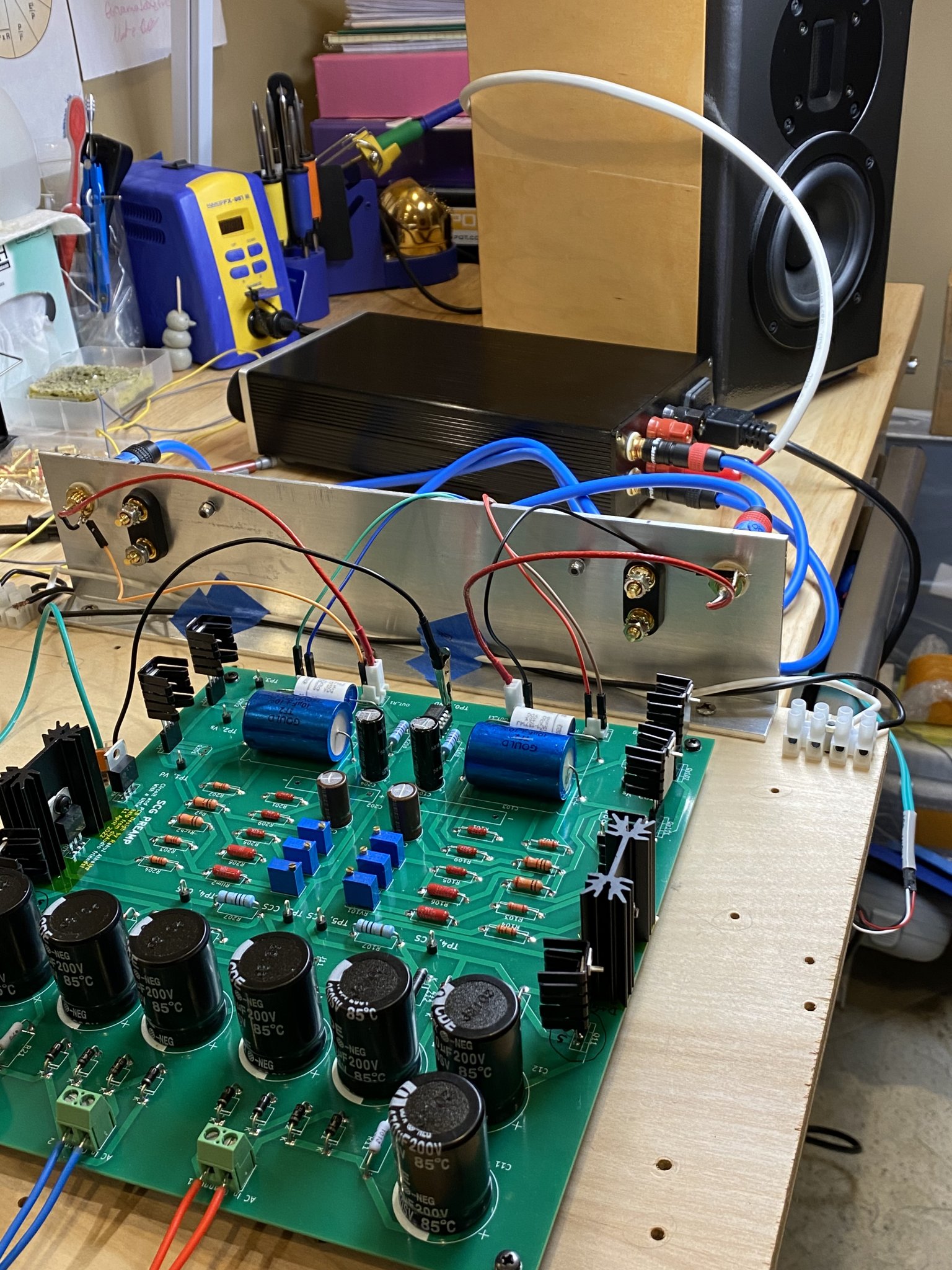

Good News!
SCG preamp is singing away on the work bench 🙂.
Initial build is setup with STP30N10F7 as gain FET and FQP12P20 as lower FET.
Vital Stats:
Regulated- 126V
CCS- 23mA
TP1- 63V
TP2- 22V
TP3- 16V5
Q103/203- Get very hot so I installed TO-220 extruded 37mm tall heatsinks.
The other FET’s use clip on heatsinks.
Additional build notes, Q11/21 drain/gate legs are crossed with heatshrink tubing to prevent shorting. All diodes and higher wattage resistors are lifted a few mm’s off the pcb.
TP0 is connected to earth gnd via a 10R NTC.
Music sounds very good on the bench and the background is silent between tracks. Next step will be to setup SCG in the main system for better impressions.

Just awesome, Vunce! Thanks for sharing! Really love the attention to detail and how you did the twisted leg with the shrink wrap. Let us know how it sounds.

Q103/203 is the hottest followed by the gain FET. The clip-on heatsink is boarderline on this FET. If a TO-220 choice becomes permanent, I’d remove the socket and solder it to the pcb with a larger heatsink.

No reason, to get started the bypass caps are not necessary. Silmic II caps are installed at C102/202, I will tweak with the bypass caps later 😉.
Also, be very careful desoldering on this board. A couple of pads lifted when removing Q103. If anyone is planning to experiment with FETs, sockets are highly recommended.
