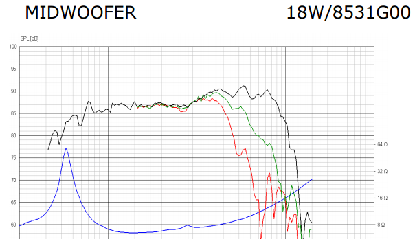

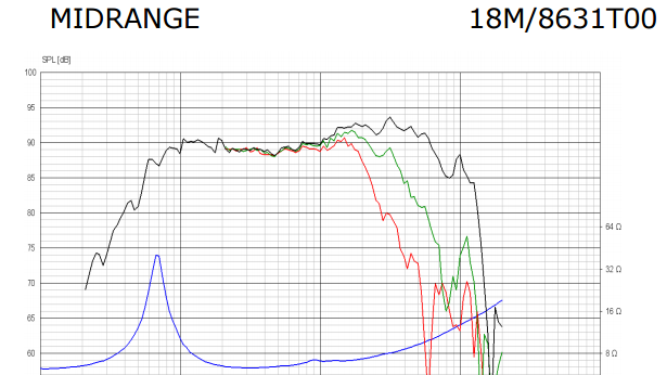

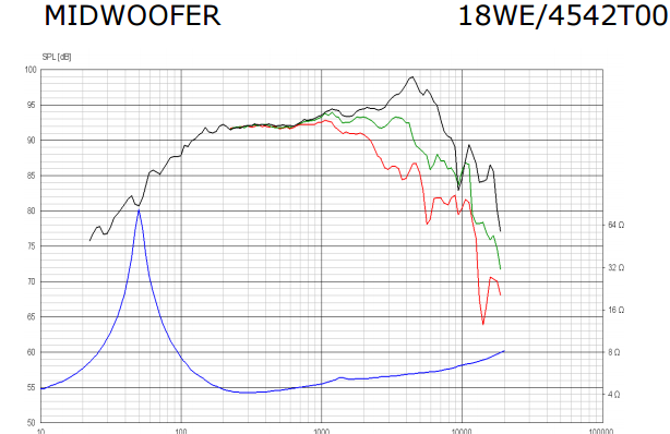

As i alvays pay more attention to the response of a driver at 30º than the classical 0º on axis one, i must say that the more i see the curves of the new alienoid esoteric creature given birth by SS, the more i like them...
Compared to the 18W revelator midwoofer, and even to the recent 18M midranger, i see a clear improvement in the new 18WE 30º response...😱

You do? I can't see there anything improved. Ofcourse the angle response is important. But you forgot a. you can't just take one curve and say "that's it, how wonderful", that's exactly the same mistake as just only taking the 0° response. And b. the response above the used range can't be ignored because it's not magically disappearing, you have to deal with it in the crossover. And if you take that into account, you'll realize the revelators are much more linear, they don't introduce any peaks above the used range, they just fall of nicely and uneventful. That makes them so much easier to handle.
