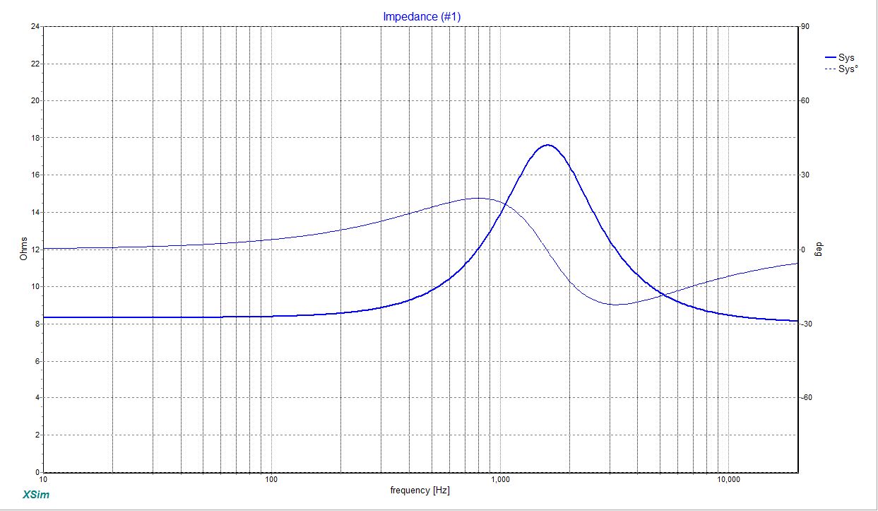

Isn't it converted to heat?
Part of it yes -on the resistive element- but the rest is not. It is like a spring: push it, becomes shorter, stores energy, but when you stop pushing it kicks back, releasing the stored energy where it can.
Rough analogy, but expressive I think. Both coils and capacitors store and release energy in a similar manner.
Can you give an example of how this energy is released and what relative frequency band does it affect? Is it measurable? Does active equalisation give better results in this case ?
Haha, no. Great imagination but maybe a bit too much ignorance.
A spring stores energy, that's correct. But it keeps the energy as long as it's confined from expanding again to the resting shape, so it's constantly trying to return to the former shape and keeping up the force, not only 'kicking back' if you stop pushing.
That would be the analogy of a capacitor. But only at DC. The music signal isn't DC though. It's constantly changing (AC) and that introduces the element of time. Time and change of voltage go hand-in-hand and the crossover elements do not 'release' it 'when they want'. And they aren't suddenly disconnected and reconnected to chose the worst timing to 'release' the energy. No, they change constantly the phase, depending on the frequency, that's why a crossover works. And that's how a speaker works, too. Look at this diagram from the ScanSpeak datasheet:

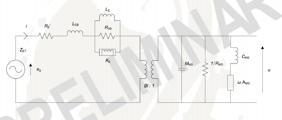

That's a diagram of a speaker, divided into the separate equivalent electric acting elements. (Well, to be exact, the voltage source isn't really part of the speaker, blame SS for it.)
Uhm, no. They work completely different. While you can compare a capacitor on DC with the spring, a coil is always only storing energy over a very limited time, after that it's gone. The equivalent of a coil would be, you press the 'spring' together, wait a moment and release it then it stays the way how you pressed it together. So to DC, a coil is just a resistance. It only works on change of voltage respective current.
This is meant in the most possible positive way: If you want to know what's happening and understand what's advertising crap and what's actually important, please try shed the half knowledge and learn the founding physics. There are loads of learning material out there, pages, videos, measurements, experiments.

Well then,-being totally ignorant- I will start to study the related topics, maybe finally I can learn how a speaker works. However your approach is rather academic and based on -otherwise well established- strongly simplified theory, but the minor problem is, that the operation, and the interactions between real world (i.e. less than perfect) loudspeakes, crossover elements and sources (amplifiers) creates a much more difficult situation than your cited example. Even the theoretical model of a real world speaker -including ALL os its mechanical elements and their resonant interactions- would be a few times more complex than the drawing you showed. During the reproduction of actual musical signals the real time energy relations between electrical and mechanical parts of a speaker -not to mention the crossover elements feeding them- change rapidly, and cannot be described with such simple models. If that would be case we could listen only to very good and excellent speakers.
The energy stored in any type of (mechanical or electrical) resonant circuit will be dissipated -over a certain time- on the path that shows the least resistance. I know this is also an oversimplified statemnt, but true.
Believe me when I started this as a hobby I did my (plenty of) readings, just to get confused over the time finding out that those models are great for educational purposes, but worth very little in practical work. If everything worked according to those models, then we wouldn't actually chat about rising responses, out of band resonances, and shitty speakers made by respected manufacturers
Life is a bit more than easy application of collected studies and theories.
As Frangus asked before - can that energy storage be measured or observed in any way with xover in place ?

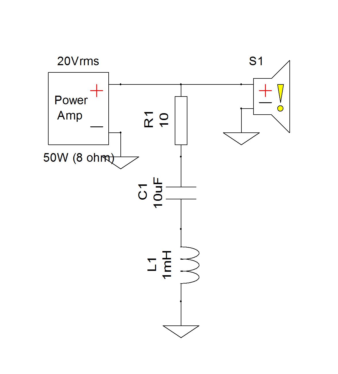

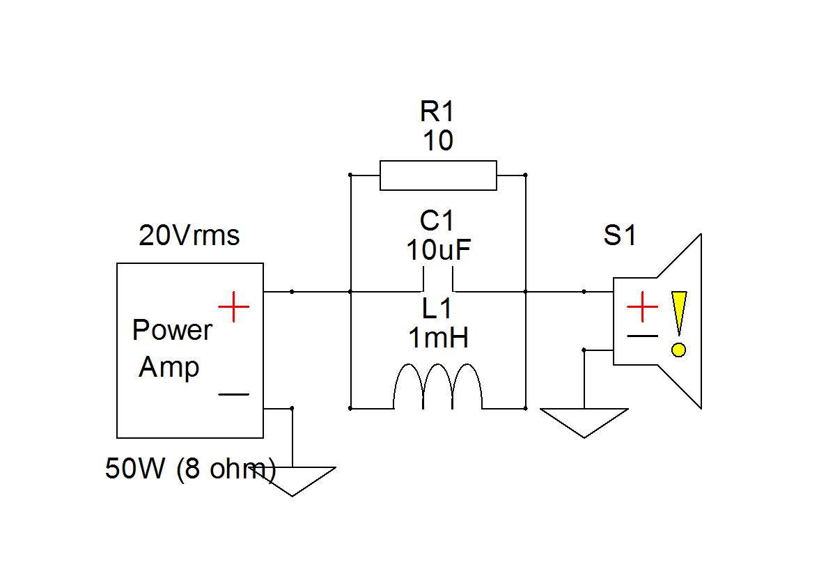

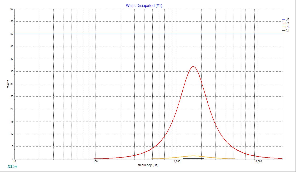

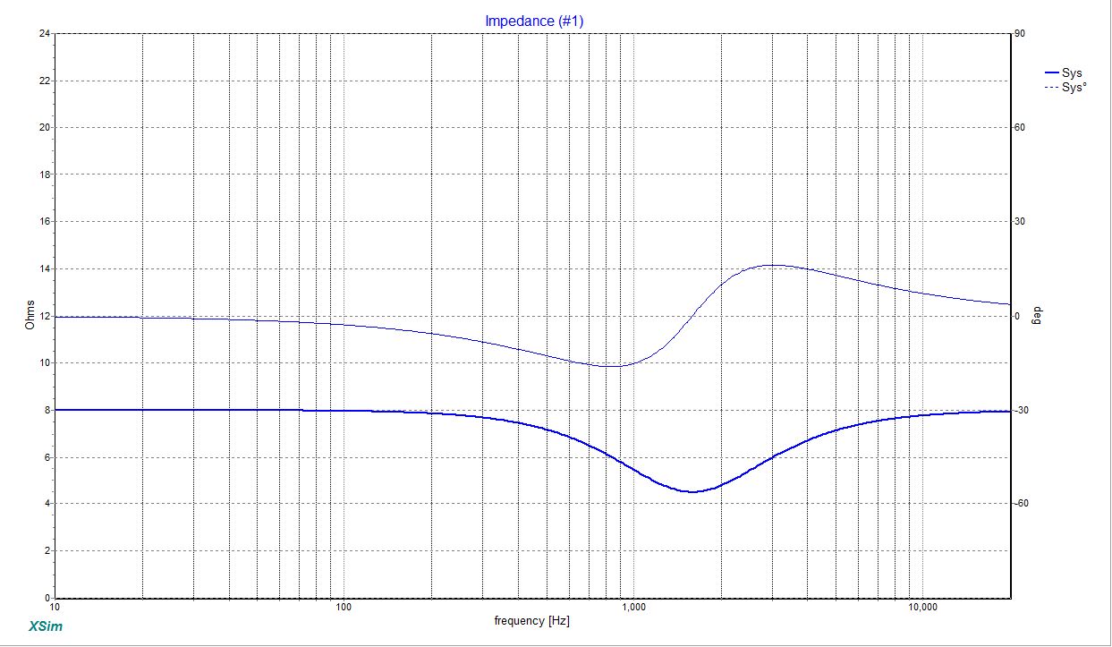

There is a reason why simulation tools exist so we don't guess and oversimplify things and make us look uneducated at the same time.

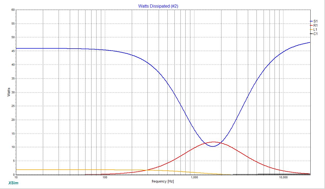

S1 line would be an 8 ohm resistive speaker, other curves are self explanatory.
Well, I haven't tried to do such measurements yet, but I guess it can be done by feeding the X-over-speaker complex with the resonant frequeny of the RLC circuit, and observe (record) the waveform at the speaker terminals with a suitable device (storage scope for example). But then again this will show you (if it will show anything at all) only the static behaviour of the circuit at that frequency, with complex signals -such as music- I have no idea how it could be done.
One thing I know for certain -based on countless listening tests- that the inclusion of such a circuit in te XO somehow robs the life, the essence of the music, my finding was the lack of attack and fine detail. It is likely that the sudden sharp changes in phase and impedance response what are responsible for this, but I cannot really explain it any further.
