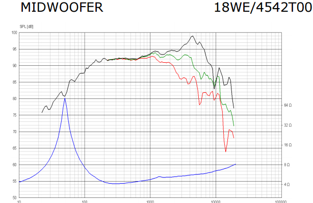

I can relate to this. But then again, if you have to use high Q deep notches, then the drivers or the design might be bad. It should be done that way only out of passband - killing the resonances of cone break up.
That doesn't sound right - passive or DSP.
cheers
When break up modes show mostly on the axial response, putting a notch is simply a big shot to the power response.:grumpy:
Better chose a design axis with less trouble, or a different driver...

If you cross that LR4 at say 1600-1800Hz and add a notch or a tank filter at cone breakup (4.2KHz), i don't see the problem or how could that affect power response in a negative manner.
Yes i agree with your "out of the passband" comment...🙂
I insist that i find a terribly conventionnal and bad idea to choose the axial response as the design axis, because with wide band drivers it is always the worst possible design axis. Only good for the reverse-all-that-junk fir junkiards...😀
Problem exist because people are listening sweeps for distortion less than 1% (-38dB), but then leave cone resonance at say -25dB or even -20dB and that's "good enough". If you simply go off axis, the problem is simply hidden - not solved. You can not make that amount of energy magically disappear.
Cone resonance must be treated properly for a loudspeaker to sound right - either by steep xover or by notch filter or by a combination of both.
As for irregularities in the passband that require notch filters... Geddes had 2 notch filters on Summa 15 (predecessor of NS15). JBL 1400Array also. You can buy ruler flat drivers, or you can do it by implementing a good xover.

Well this is exactly what my problem is... most of the newly developed 5-8 inch rigid cone drivers suffer from serious breakup modes somewhere between 4-10 kHz. (besides their usually rising response, as all of us know). I've seen examples with 20 dB on axis peak, but 10-15 dB is typical.
I admire their bass attack and precision, but if you don't filter out those -sometimes enormous - peaks, they ruin the overall sonics of a design, regardless of what type and slope XO being used. When I put in the necessary notch(es) to get rid of them, then most of the slap, the "speed" in the bass range suffers, and no, NOT because of the missing harmonic content in their upper range...
I am not trying to state that I am an enlightened or omniscient audio guru, but I've listened many-many hundred speakers in my experience, so this a real problem, not the "newbie is hearing things" category.
Also this does not mean necessarily that a given driver , or design "bad", just this is the way they were designed (you must sacrifice something to get something you want), se we have to live, work with them accepting these facts. After all you cannot always use 15-20 years old drivers in new designs....
...Well this is exactly what my problem is... most of the newly developed 5-8 inch rigid cone drivers suffer from serious breakup modes somewhere between 4-10 kHz. (besides their usually rising response, as all of us know). I've seen examples with 20 dB on axis peak, but 10-15 dB is typical...
Are we talking series or parallel notch filters (or both) that you hear differently - less vivid ?
Every Accuton, Seas Excel Mg, Seas Prestige AL, Wavecor AL or Illuminator AL suffers from resonance peak at cone break up. That's normal for hard cone drivers because of their pistonic behaviour.
I've had quite bad experience with soft cone speakers (plastic) - lack of detail and intelligibility, less vivid sound.

I usually find series notches more harmful, than parallel ones. I use parallel type (only when really necessary) to reduce edge reflection "bumps" at 1-2 kHz, but they seem to hurt less than the other type.
Agreed, cone breakup mode is (almost) unavoidable with pistonic mode drivers -at least with the recently used materials- but with smart combination it can be reduced to minimal. Good example is the not so new SB 17 CRC midwoofer with its Rohacell-Carbon fibre sandwich cone, where the peak is a "mere" 10dB, and can be tamed wery well, while maintaning the advantages of a rigid cone driver. This is one case where I was able to get away without using any kind of extra filtering (crossed at 1.8k to an SB26ADC)
