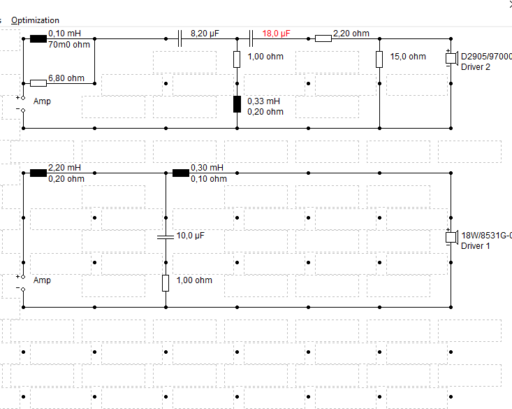

Thanks for your expertise Alan!
Just to be certain, I've attched a jpg of what I think you've suggested -- let me know if I'm in error.

Hi Robert
You have got it half correct - the resistors are drawn in the correct positions in the circuit for the L-pad,
But, the values are not.
Swap the two values around - put the 3.9 in parallel with your 9900, and put the 3.6 in the series position.
With the 4.7 ohm and 18 ohm his filter will have a slightly steeper slope at its start at the x-over frequency and will be not quite as much attenuation there, and not as much over-all shelf attenuation of tweeter output.
This is probably because he is using a different woofer to yours -{8546 instead of 8545}- thus I'm guessing 8546 may be slightly higher in sensitivity, and as he has a different lo-pass filter on it, a slight change of hi-pass filter shape may be required for the two drivers outputs to add to flat reponse at cross-over freq.

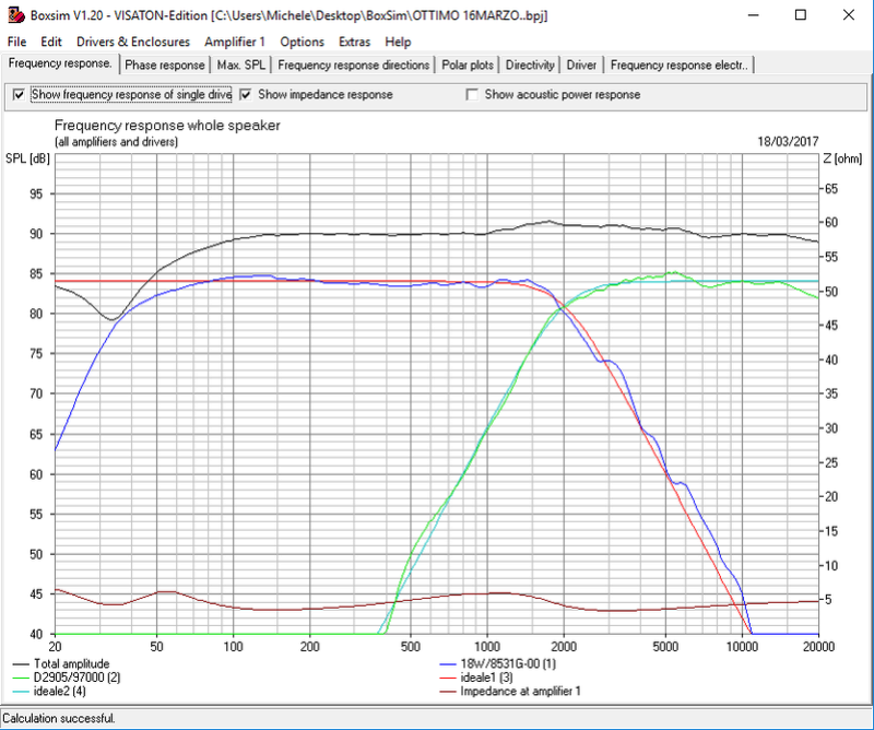

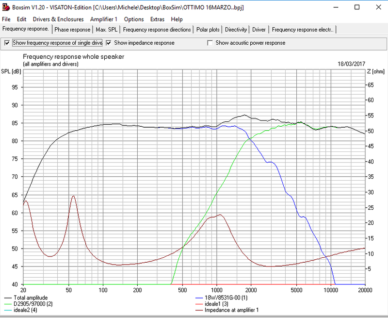

Hi, i bought 18w 8531g00 and d2905 9700 but cant find any crossover on the web.
Does anybody help me? It is a 2 way 32ltrs
Regards
Regards
