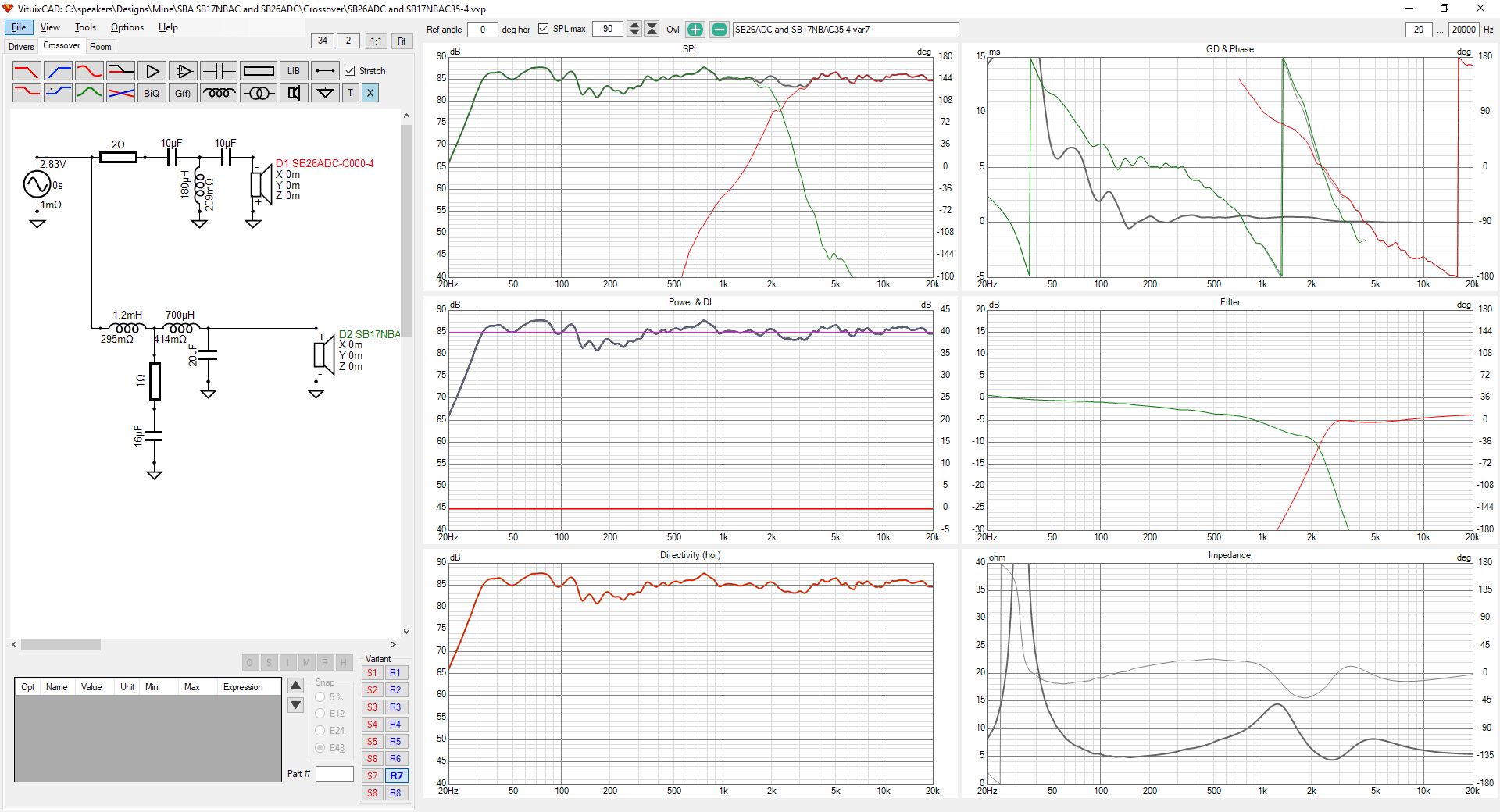

The reason the tweeter polarity is reversed is:
a) you have a flat baffle
b) I have used a steeper slope on the SBNAC to damp the breakup and to get phase alignment with a flat baffle.
Now - 2 caveats with my crossover:
1. I have based this on simulation and not measurements. there's always a chance I've got something wrong
2. There is no off axis data to show you how the speaker will behave in the room / power response. that is - it may look good on-axis but may have more peaks and dips due to the slopes chosen as you move off axis. Without measurements, there is no certainty here

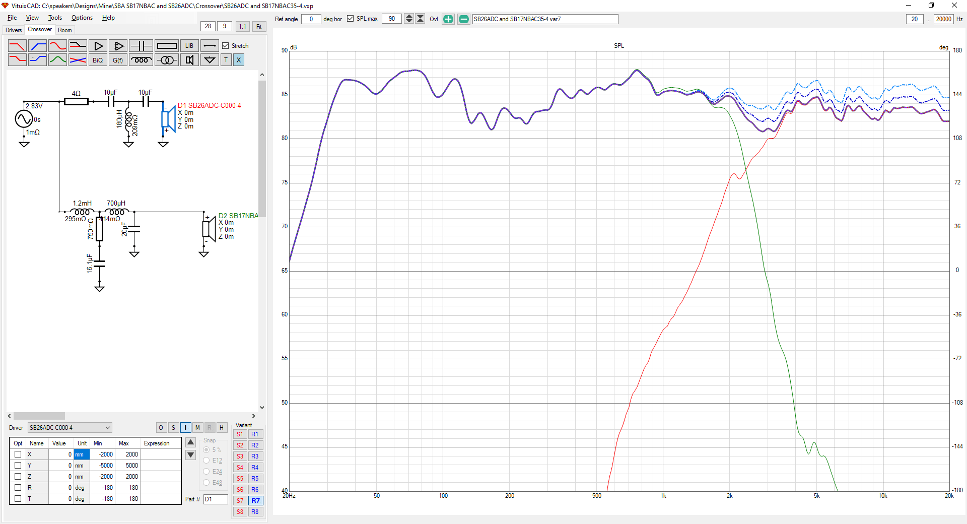

The last crossover I posted had a 2 ohm tweeter resistor. This provides a "flat" on axis response, but you may find the tweeter too hot in your room. By using 3 ohms, then 4 ohms, here is how it pads down the tweeter
Light blue line = 2 ohm tweeter resistor
Medium blue = 3 ohm resistor
Dark blue = 4 ohm resistor
These changes do not require any other crossover changes.

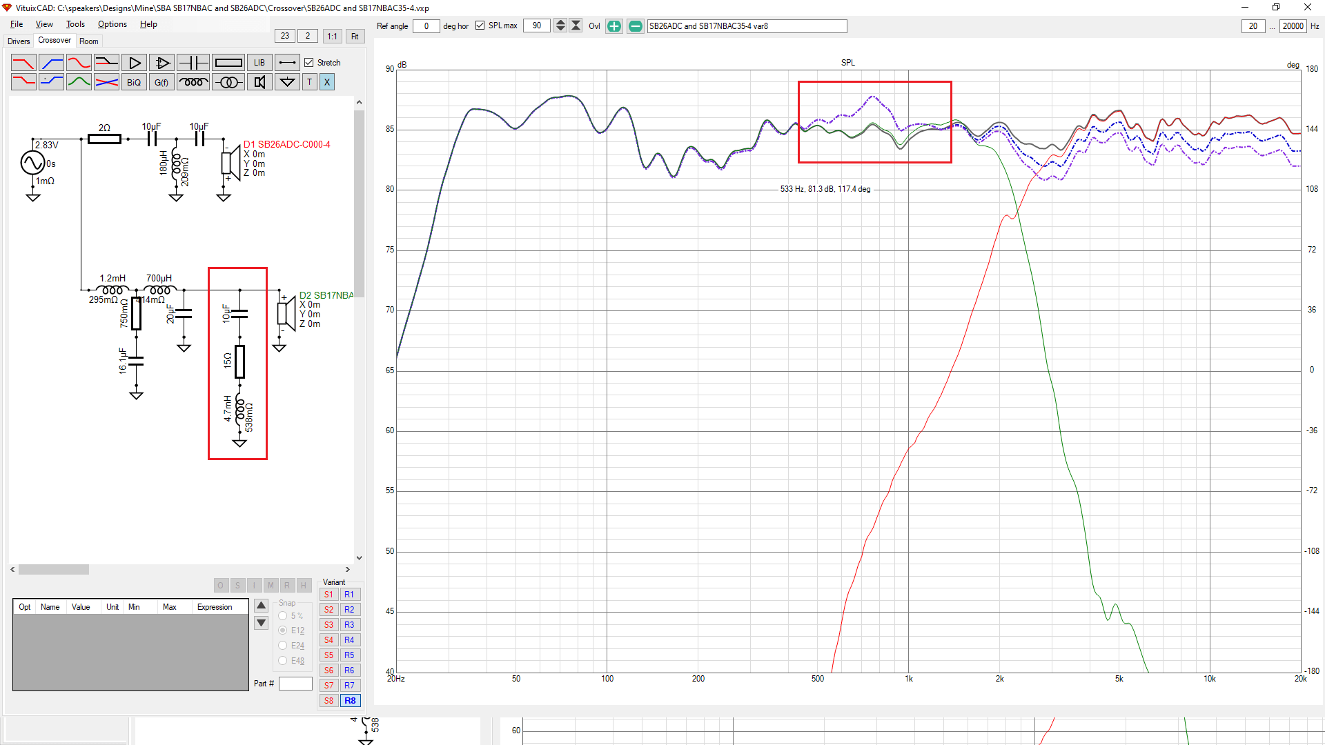

The SB17NBAC may have a peak as shown ~ 760Hz. I say may, as this is all simulated data, no off-axis measurements, so whether this peak is real or not I can't guarantee.
However, if you find vocals a bit "shouty" on the speaker. it could be this peak. I have added a notch filter highlighted below. you can see how it flattens the region. It does require quite a large inductor (4.7mH)
Impedance is not impacted (i.e. minimum is still 4.5 Ohms ~ 2700Hz

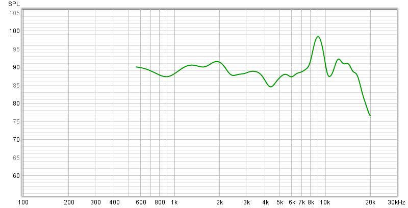

I found this measurement I took of the SB17NBAC35-4 (I have 2 waiting to go into a project). Although this gate is extremely short, there is no 760Hz hump. Unfortunately I can't recall the baffle size and measurement conditions. In otherwords, I don't think that notch filter will be needed:
Then notch filter is omit. I keep your original crossover schematic. If there is any adjustment and it is not much bother you. Please tell me about your revised crossover to prevent 760Hz peak. Thank you in advance.
I am so gratitude for you help so much. I think in case of 760hz peak can not correct by crossover. Maybe I use EQ in Jriver Media player software to adjust about 2db around that problem. However if crossover can be redesign to cope with it, I will be so glad to adjust.
I forgot you were using JRiver and if you do sense a peak, then EQ will be a good solution. I don't think it will be a problem though. so the crossover in post #37 still stands
Thank you so much mr. dave. I will add 1R resistor next to 2R resister to pad down the tweeter.
