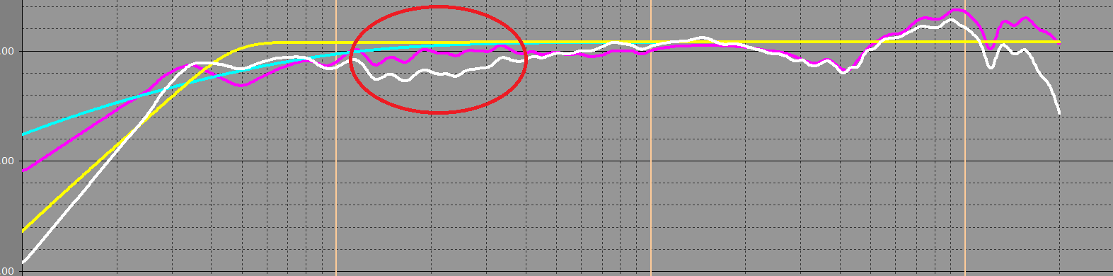

Note: Trying to simulate bass response in woofers with accuracy is hard without measured data to truly see what is going on. However I believe your biggest problem is going to be in the ~ 100Hz to 400Hz area as shown. This is because you have baffle step loss (perfectly normal) with a woofer in a bookshelf sized enclosure / baffle.

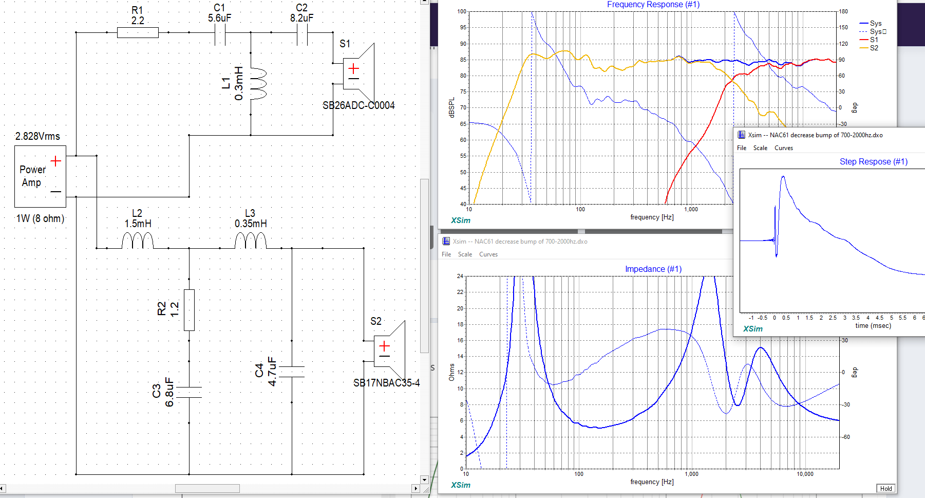

Thank you so much Mr. Dave. Now I can revised my crossover and 700-2000hz now is less bump.
Revise crossover file with help of .FRD .ZMA from Mr. Dave is here

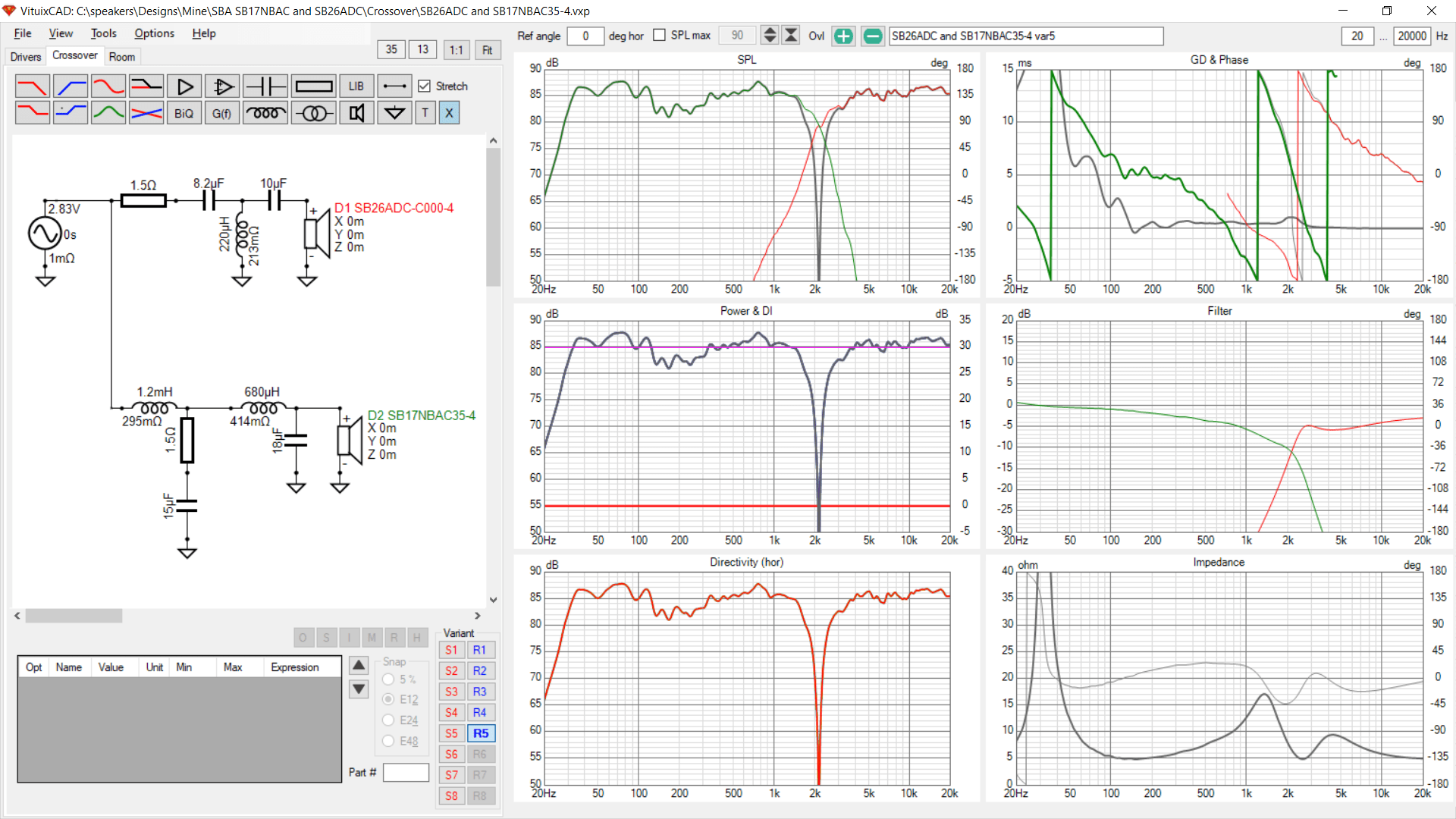

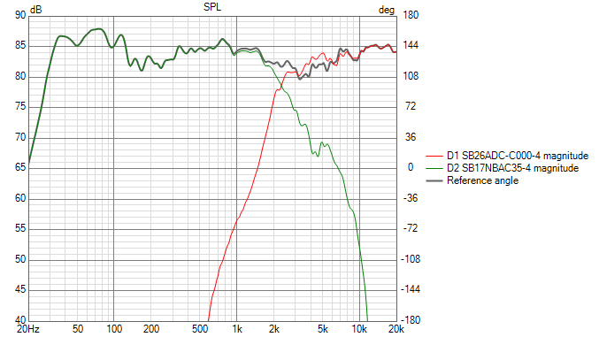

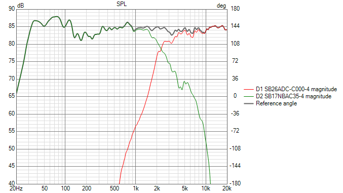

Here's my revision of your crossover. All I have done is change parts values. Note: I have had to invert the tweeter polarity to get an inphase response (that is not a mistake):
The following image is with both drivers wired with the same polarity (showing a LR style crossover with a symmetrical reverse null at the XO point):
PS: I have aimed for ~ 85dB sensitivity (allowing for ~5 dB baffle step losses). You may need less compensation if you are planning to place these against a wall or in a book shelf (although I'd advise against it with a rear facing port = boomy)

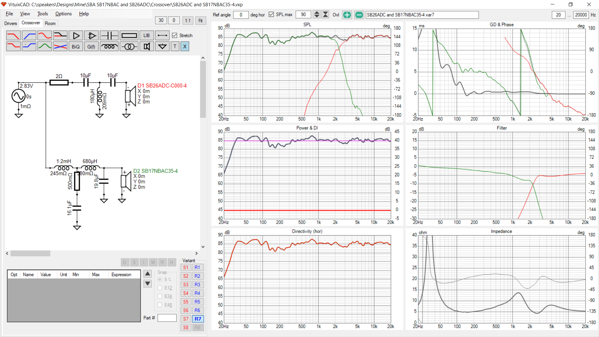

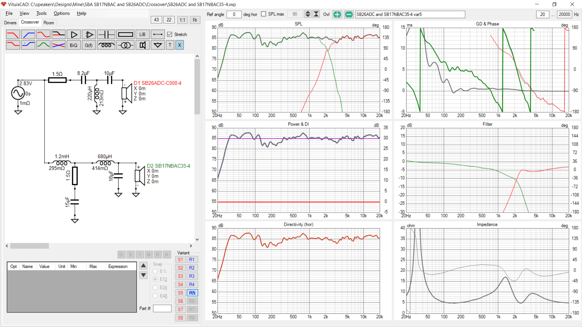

When I model your latest crossover (post #23) - without an offset, I get the same response...
However - when I enter a Z offset for the woofer (~47.5mm = 138usec) - I get the following response for your crossover.
Z in this case is not impedance Z.... this is X/Y/Z in terms of AXIS placement = spatial positioning. X = horizontal offset on the baffle. in this case, both your tweeter and woofer vertically align on the centre of the baffle, so this is 0
The Y is the distance the woofer is from the tweeter. I have already allowed for this in the baffle sim so this should be 0 too.
Next is the Z offset. This would be 0 if you were using a stepped or slanted baffle to make the woofer voice coil align on the baffle with the tweeter.
Because the woofer is "deeper" - its voicecoil is set "behind" the baffle. So we need to enter an acoustic Z offset on the woofer (only - not tweeter) to tell the crossover software how far behind the woofer is in relation to the tweeter.
Now 47.5mm may be too much. I think I only used about 28mm on one of my other designs with a 5" driver. I'll need to check this.
In anycase you need to use some sort of Z offset - 30mm would get you in the ballpark

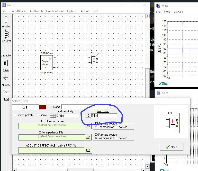

Adding ofset of 29mm (1.14") to woofer parameter, is it "mod delay" in woofer parameter to in put 1.14" am I correct?
add +29mm (1.14") mod delay and revised many parts in crossover get better result. Thank you very much Mr. Dave.

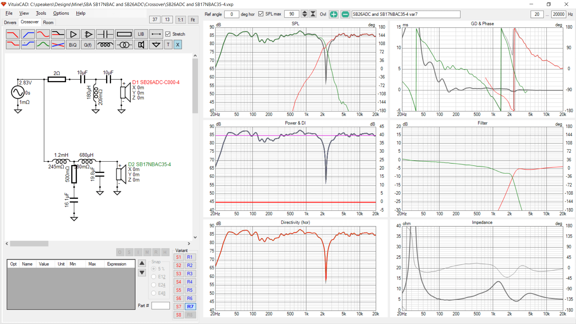

Ok, here's my attempt using the same crossover scheme. Round values to the nearest available for purchase (within 10% should be ok but simulate to check)
This assumes a flat baffle as per your original cabinet drawing and 29mm woofer Z offset (so you can match this in XSim)
Note tweeter is wired in reverse (opposite) polarity to the woofer:
Here is the reverse null:
I have gone for a steeper slope on the SB17NBAC to avoid the primary breakup at 9Khz which will result in a 3rd order harmonic distortion peak at 3KHz.
i.e. you want to notch or use a steep slope to reduce the impact of the breakup.
