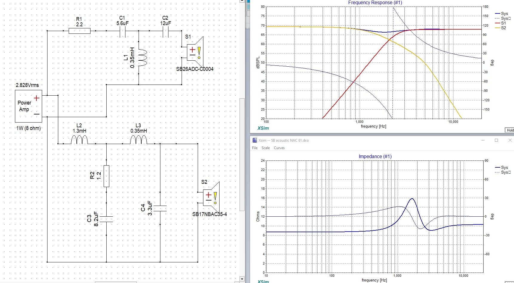

SBAcoustics NAC-61 SB17NBAC35-4 and SB26ADC000-4 .FRD .ZMA sharing

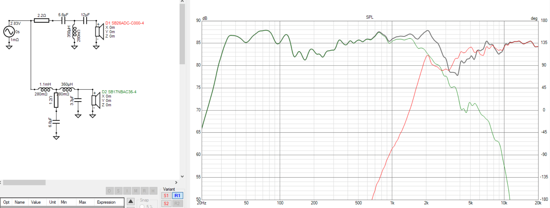

anyone whom made NAC-61 can you share .frd .zma of SB17NBAC35-4 and SB26ADC000-4 please.
I try to simultation without .frd and .zma but it might not correct.

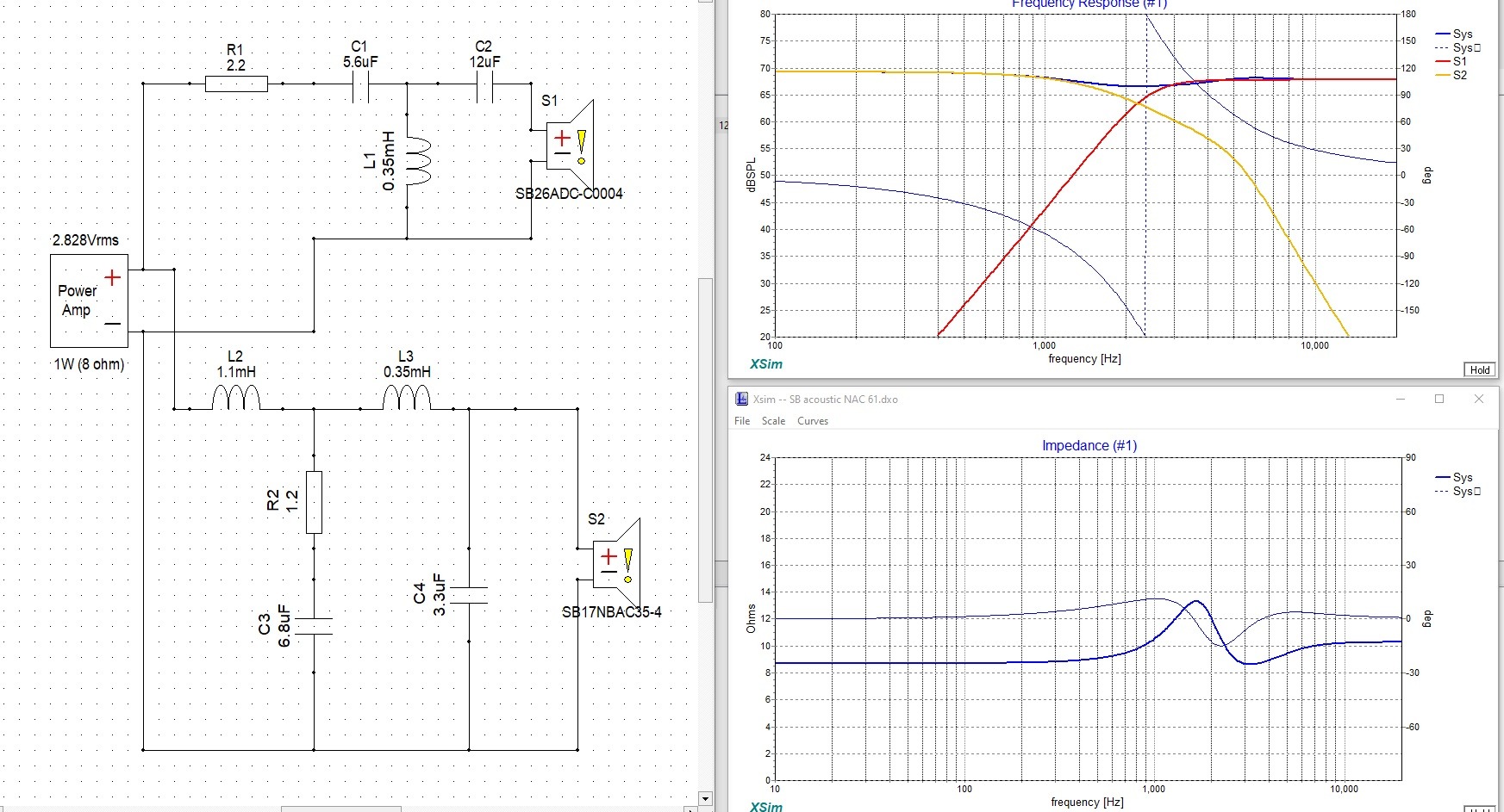

Sorry I cannot help with the data you require as I haven't built the design.

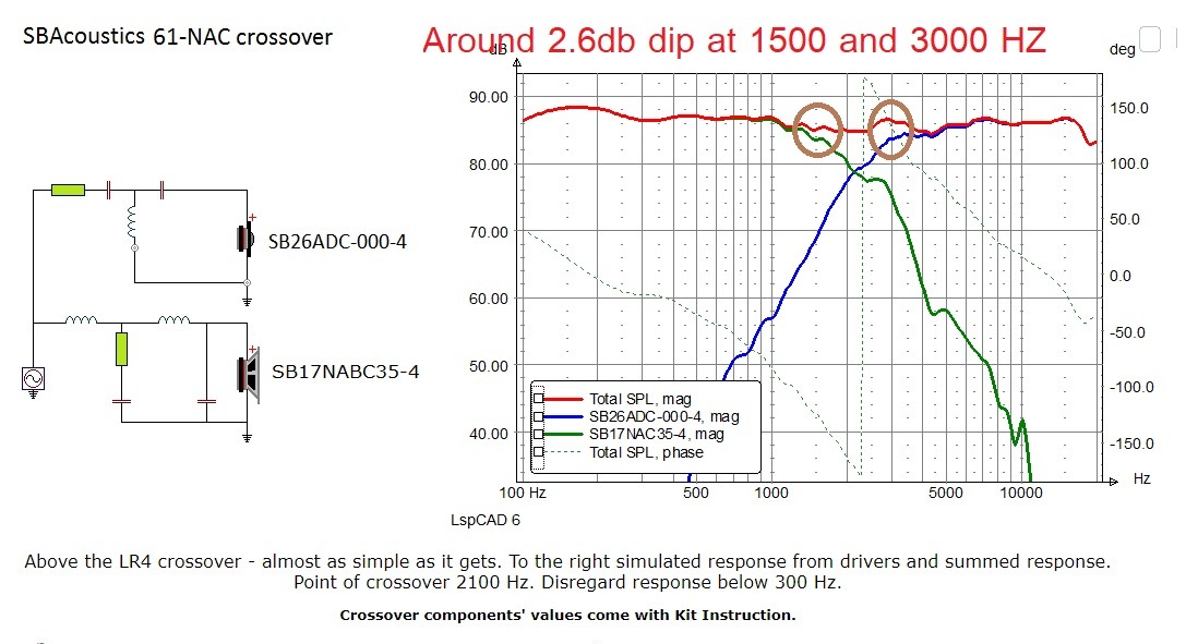

Purely as an observation the Xovers look reasonable for 4 ohms impedance.
I guess you are talking about the Troels Gravesen SB NAC61 design, if you look at his web page for this design he has the bass down by 35 dB re the the normal response by 5Khz. maybe you could teak that?
For the tweeter, you seem to have the roll of to 1KHz correct, but you haven't achieved the knee where the attenuation rate changes at 2KHz.
When you build these can you take measurements as that will help you refine the crossover and frequency response?
Good luck with the build.
Reactions: 1 user
Are you using "ideal / perfect / dummy" FRD and ZMA curves? or have the actual curves been overly smoothed. your frequency response should have ripples and bumps / dips in it if "Real world"
If you let me know your baffle dimensions and driver placements on the baffle, I can provide data.
Edit - I see your impedance is 8 ohms, yet you are using 4 ohm drivers, therefore dummy ZMA?
Reactions: 1 user
Due to no .FRD .zma the impedance show in picture is 8R. If input ,frd .zma the impedance will be 4R.

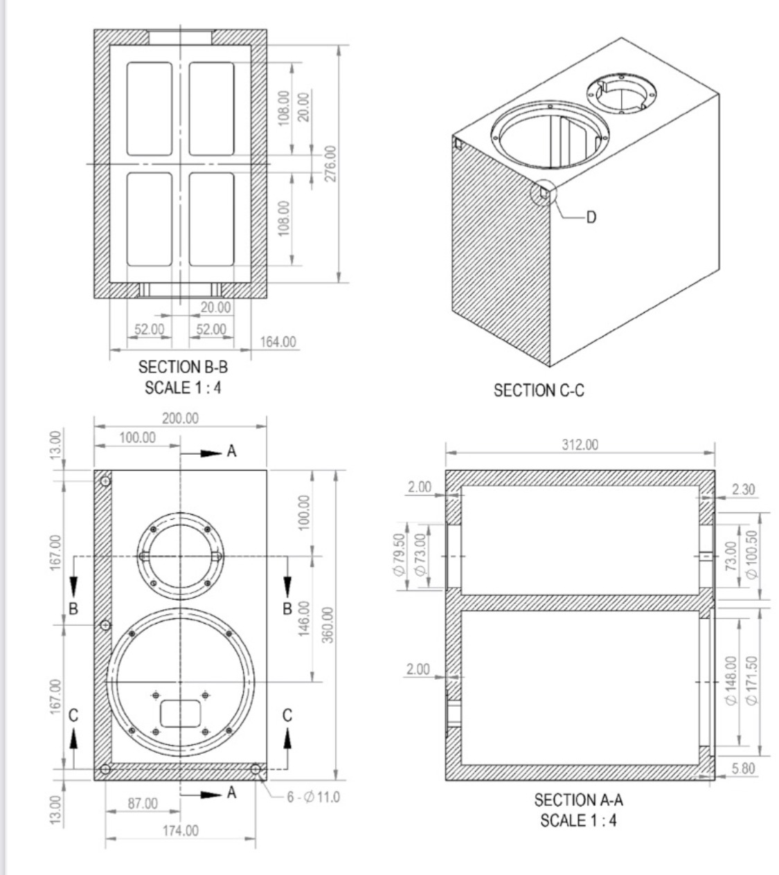

The cabinet is 14.5liters Fb is 39hz F3 is 47.2Hz
I saw NAC 61 cross at 2100Hz LR4 then i try to guess all L R C value.
If anyone can share .frd .zma i think i can correct the crossover.
Thank you

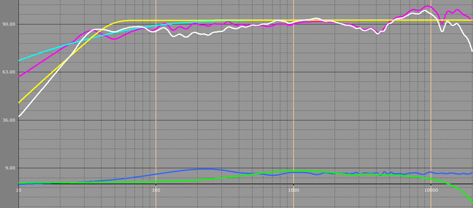

Here is why I want to know your baffle dimensions and driver placement.
The blue curve is what the manufacturer provides for the SB17NBAC. The green is what happens with baffle step and edge diffraction when you place it in on a smaller baffle than the manufacturer measures on. You want to model your crossover using the green curve, and your curve will be different than the green curve shown, because your baffle will be a different size but also because your SB17NBAC is in a ported enclosure (the green curve shown is from a sealed box)
Reactions: 1 users
I'll upload files soon, but want to post a few images so you can understand what is happening:
The White line is your target SB26ADC response in your cabinet.
The pink line is the original SB Acoustics manufacturer response on an IEC baffle.
The blue response is the IEC baffle
the green response is the baffle step and diffraction of your cabinet.
When we take pink - minus blue and add green - then you get your white (target) response).
I'll post the SB17NBAC next, then FRD/ZMA that you want
Reactions: 1 user

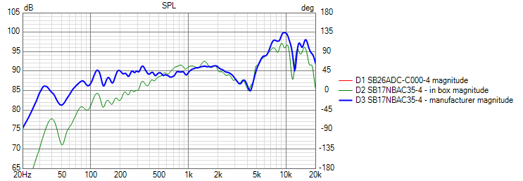

Here's your SB17NBAC35-4 response:
The WHITE is your target response.
the CYAN (light blue) is the infinite baffle "box response" that SB Acoustics bases their woofer frequency extension on
The PINK is the SB Acoustics factory measurement
The YELLOW is your predicted vented box response
The BLUE is the IEC baffle response for 6" driver measurements
The GREEN is your in box woofer response, with MIC on tweeter axis (at nominal 1m design distance).
Reactions: 1 user
Oh !! This is superb simulation software + expert Mr. Dave. I am so gratitude to you for spending time simulstion for me. Due to my humble knowledge, could I please ask for more to revised my crossover to make it more linear.

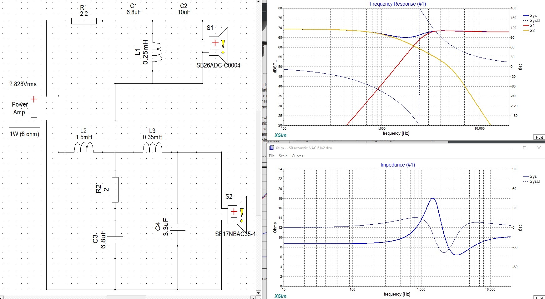

I hope you can spare your time revise crossover schematic. I will attach crossover file in this thread.
From graph range 700-2000 is too high need to be adjust to make vocal less forward b/c I sit near speakers in small bedroom 4x3meters

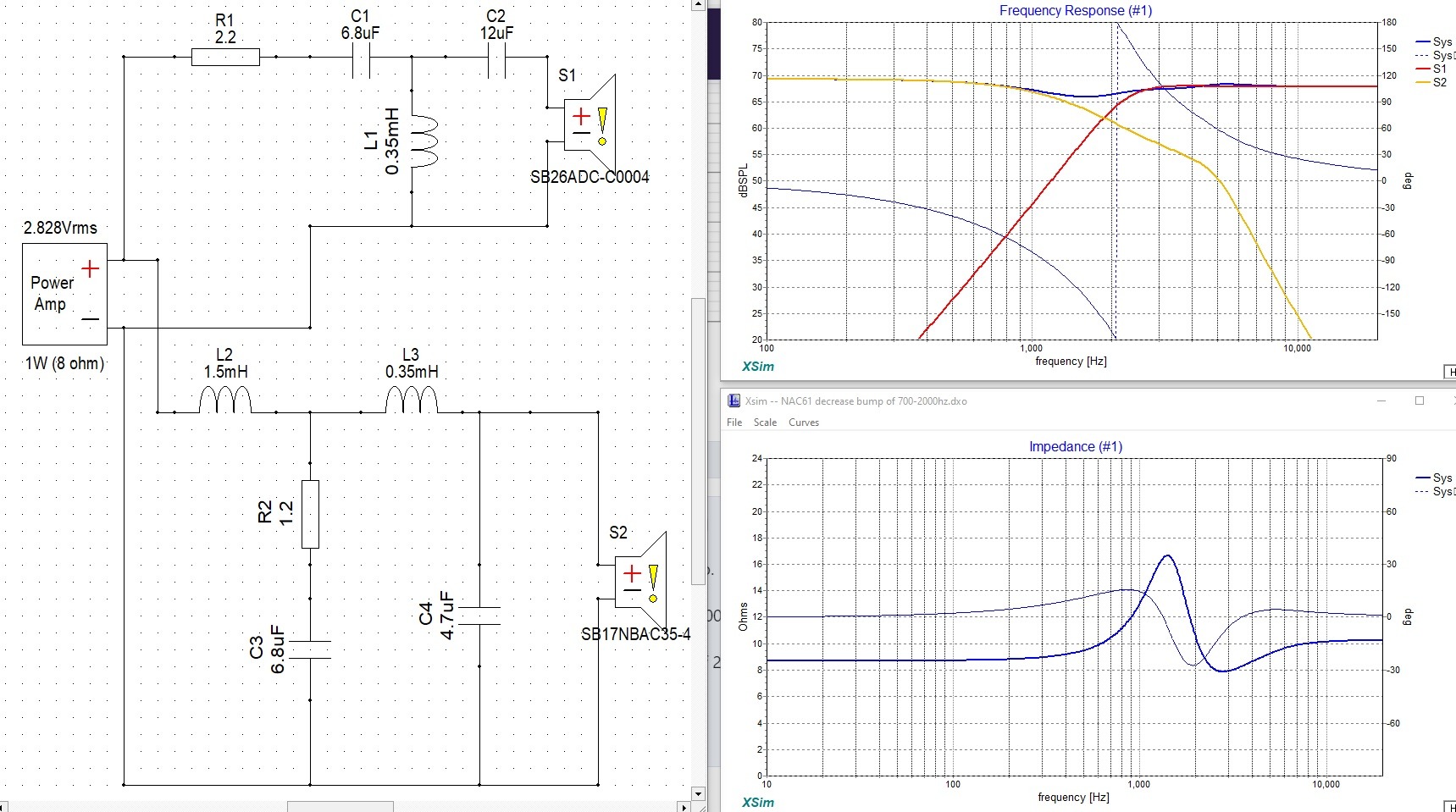

How to decrease high bump between 600- 2200 hz about 3db. for the decrease frequency in 3000 - 4000 hz I will adjust with EQ of Jriver Media player.
I think revised crossover can lower the bump of range 600-2200hz to be better. I try to simulate and need more time. Now I just post my revised file
Sadly the crossover point drop quite low to 1900Hz instead of 2100Hz as photo.
.dbo file here
