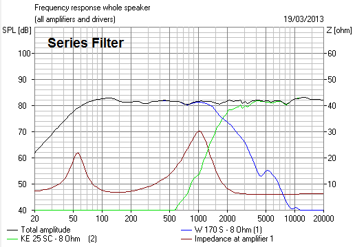

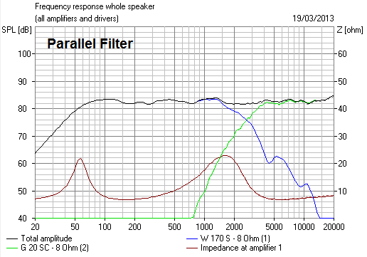

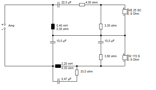

What I have found about your filter, and it is one of the best series filters I have seen, is that it works best on a flat baffle, not time aligned. This is unusual. I find it hard to believe you are doing this intuitively, but hey ho. 🙂
Here's the wise words of Mr. Lynn Olson:
See, you're always playing between the tweeter Fs resonance and the first significant breakup node of the woofer. I look at a woofer like this SEAS ER18RNX with glee:
H1456-08 ER18RNX
Notch around 4.8kHz and job done really. 😎
I think that 8" SB woofer is MUCH harder, but you've done OK with it, skipping the notch.
Here's your filter with an easier 6" Visaton W170S unit, and my parallel version. FWIW, the expensive Visaton KE25SC is a tweeter designed for low crossover, The G20SC is more conventional. Phase is exemplary between 1kHz and 10kHz with both setups. Truthfully, I can't see much in it between the two filters.

no problem I will put it up once my stuff arrives as I did not write it down and I have to check the crossover to remind myself.
but from memory I took the 22uf in series with the tweeter out and left the lPad in place.
the woofer inducter went from a 2.2 to a 2.7mh
the capacitor c2 went from 10 uf to 18uf and I removed the zobel completely and added a 22uf capacitor where the zobel was.
alittle lower crossover for the tweeter but I have had no issues with it so far with no distortion noticeable.
give that a go and see how you go.

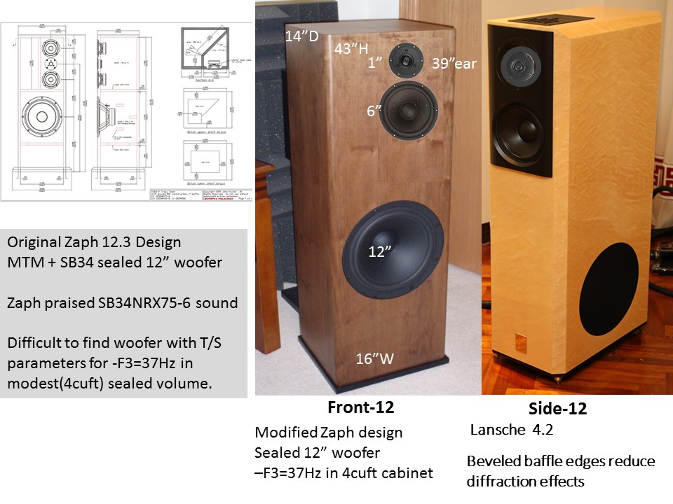

For your sealed box goal...
In a sealed 1cuft volume the 8" SB23NRXS45-4 used in this 2-way thread has -F3=65Hz.
All sealed 3-way uses the 12" SB34NRX75-6 with -F3=37Hz in 4cuft, the poly cone SB17MFC35-8 in sealed 0.5cuft with -F3=70Hz, and your SB26STC-04. Zaph used the SB34 mounted on a front baffle, but a side baffle mount is attractive. Why build a speaker stand when you can add a woofer?
Any interest?
