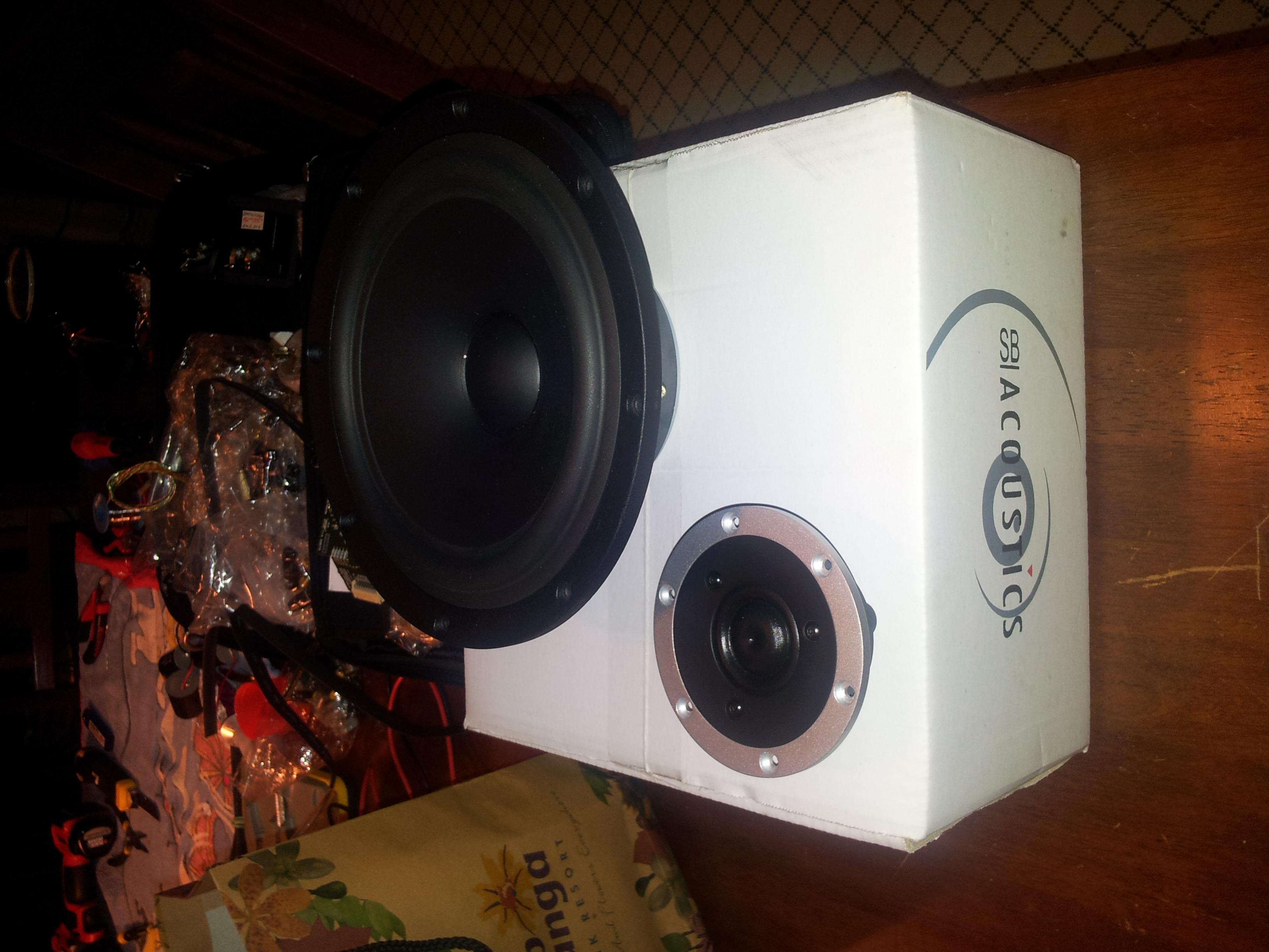

SB ACOUSTICS TW29R & SB23NRXS4
S7,

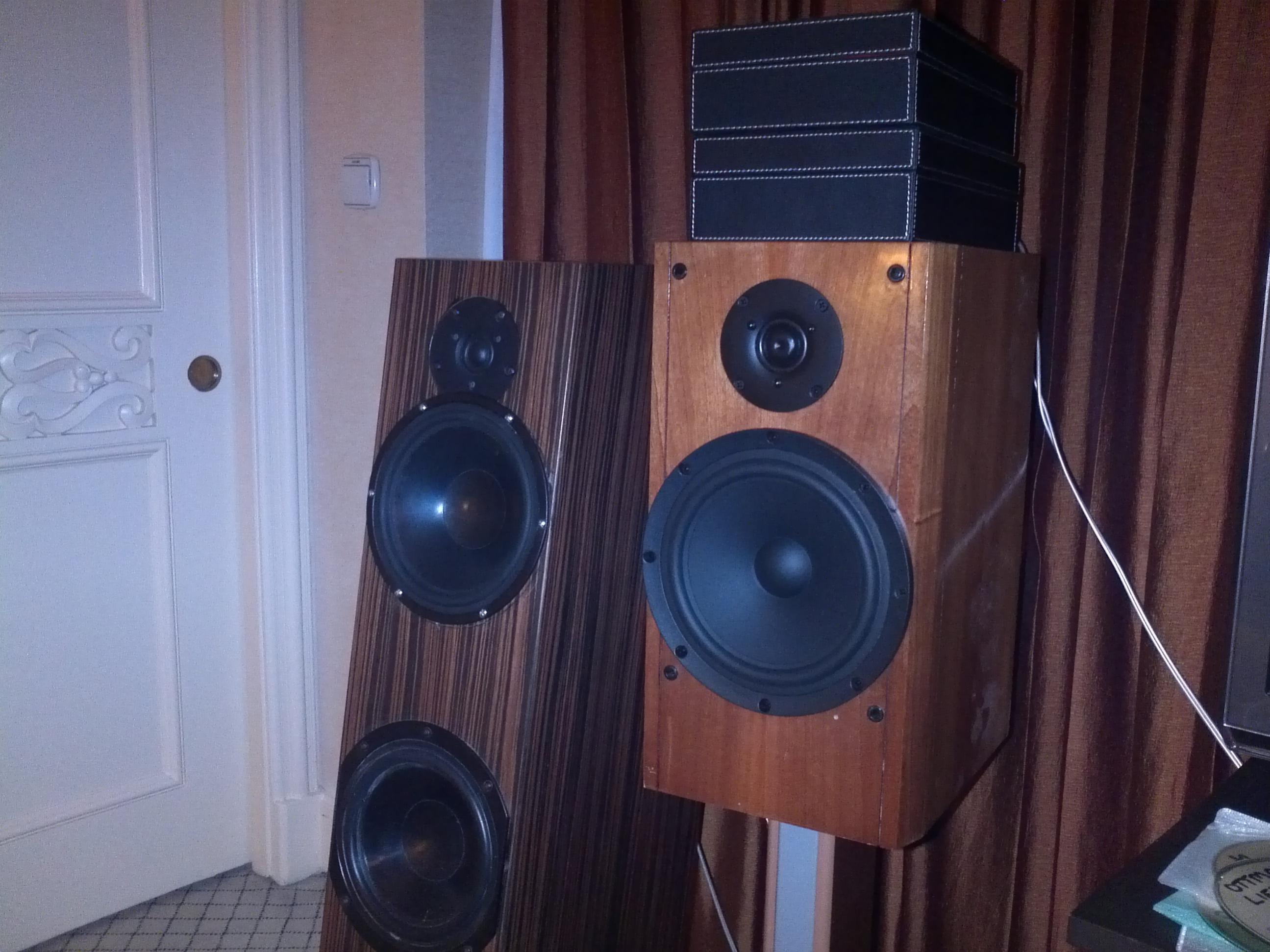

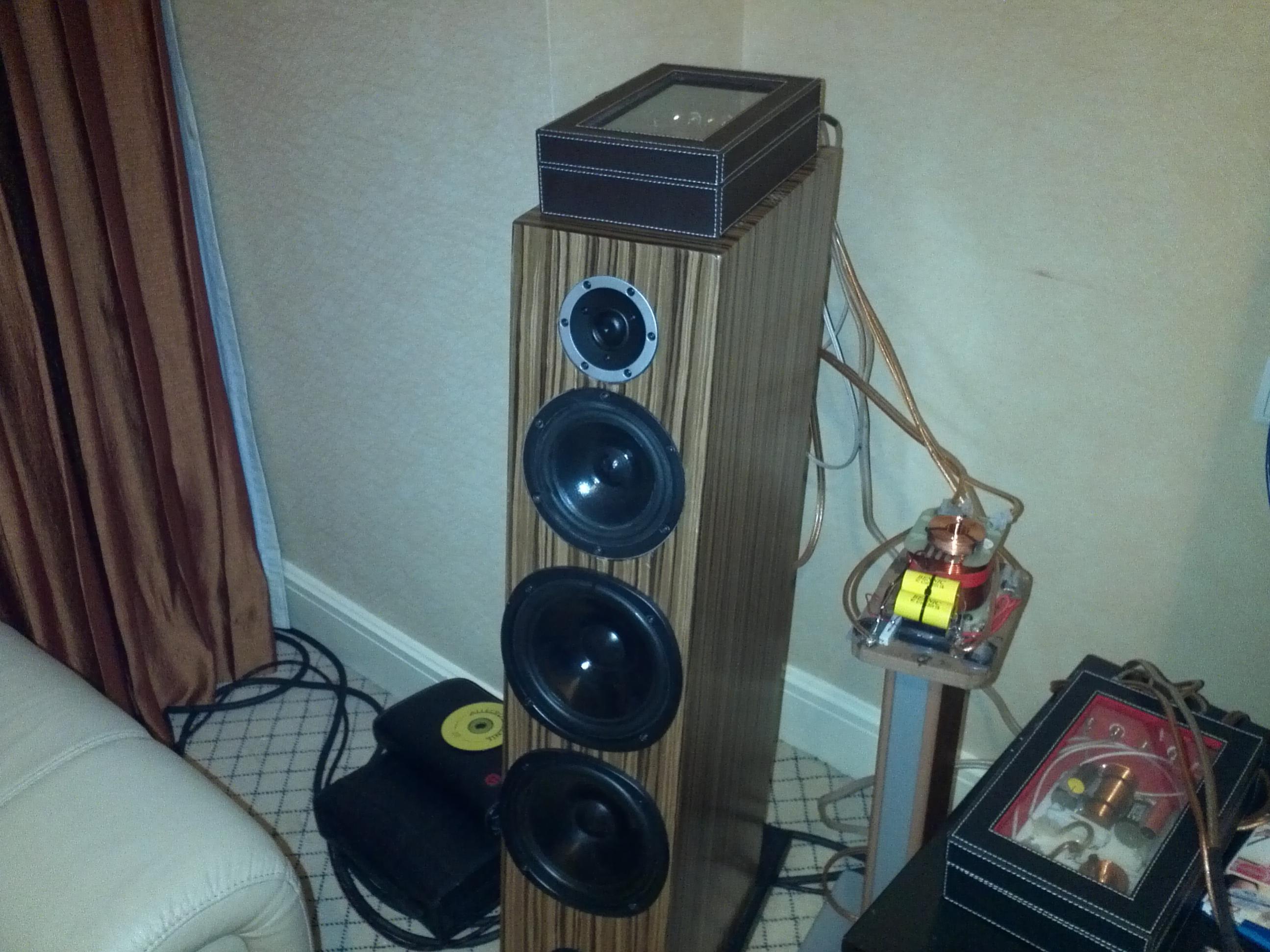

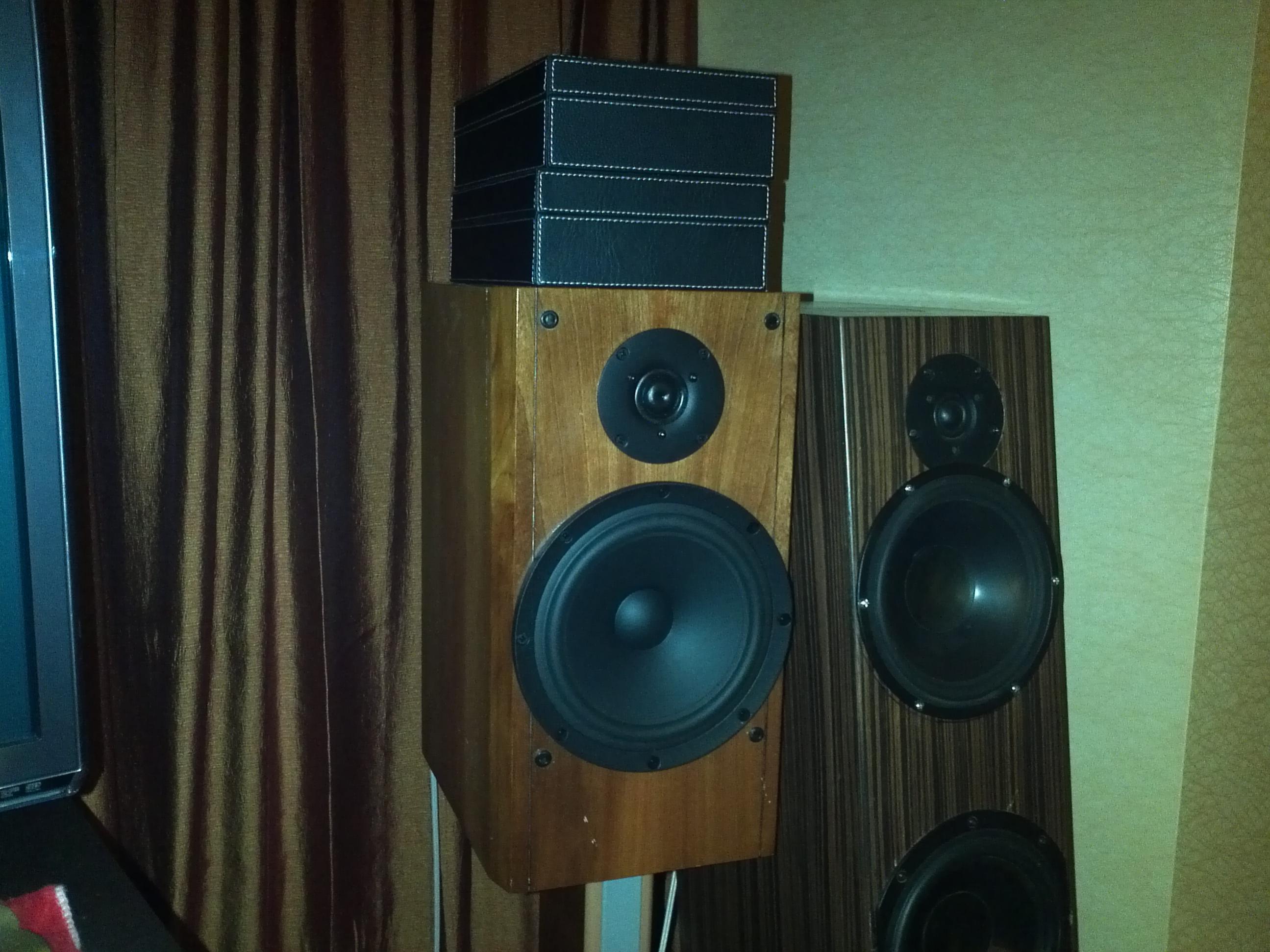

For now they are the best I can get them but that's not to say they won't get better after some constant massaging🙂 .
Itchy fingers never stop. The floor Sanders are now sounding the best they have since I built them in 2006.Constant trial and error adjustments , plus a bloody great tweeter have them now at their best I have heard from them. I have been a bit radical with my designs but the ride has been worth the enjoyment I have gotten from it all.
Ahh the fun and challenge of DIY speakers has been a trip, and hopefully will continue to be so.

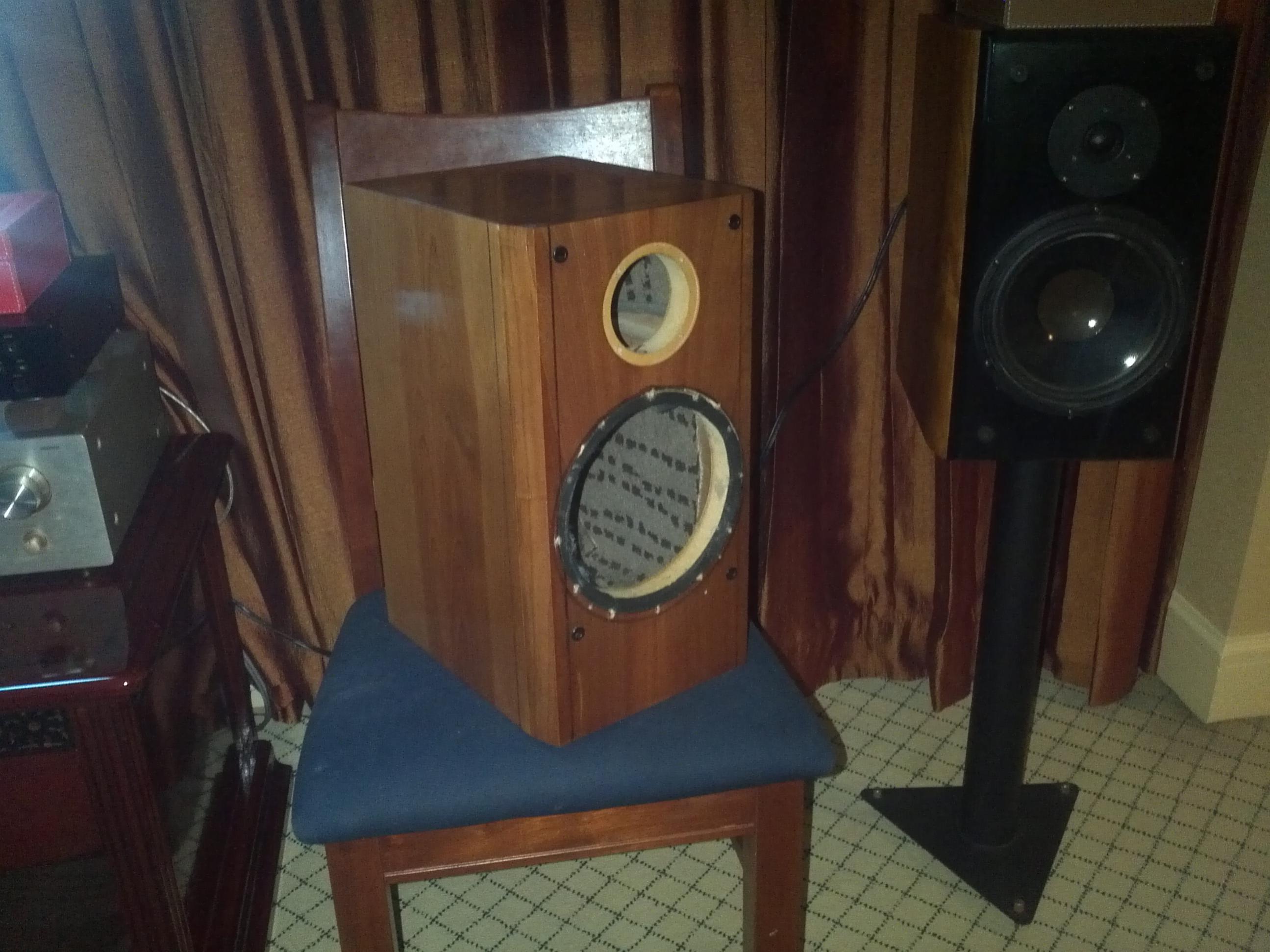

I would and will eventually put them in a 40 to 50 litre stand mount. but I am enjoying the sound of them as they are son no great rush to build a new box.
I have just moved back to Australia after 13 years in Asia living in Hotel rooms, so once settled and all my belongings arrive back in OZ then I can start to really take this Hobby seriously and build a few more to add to the collection.

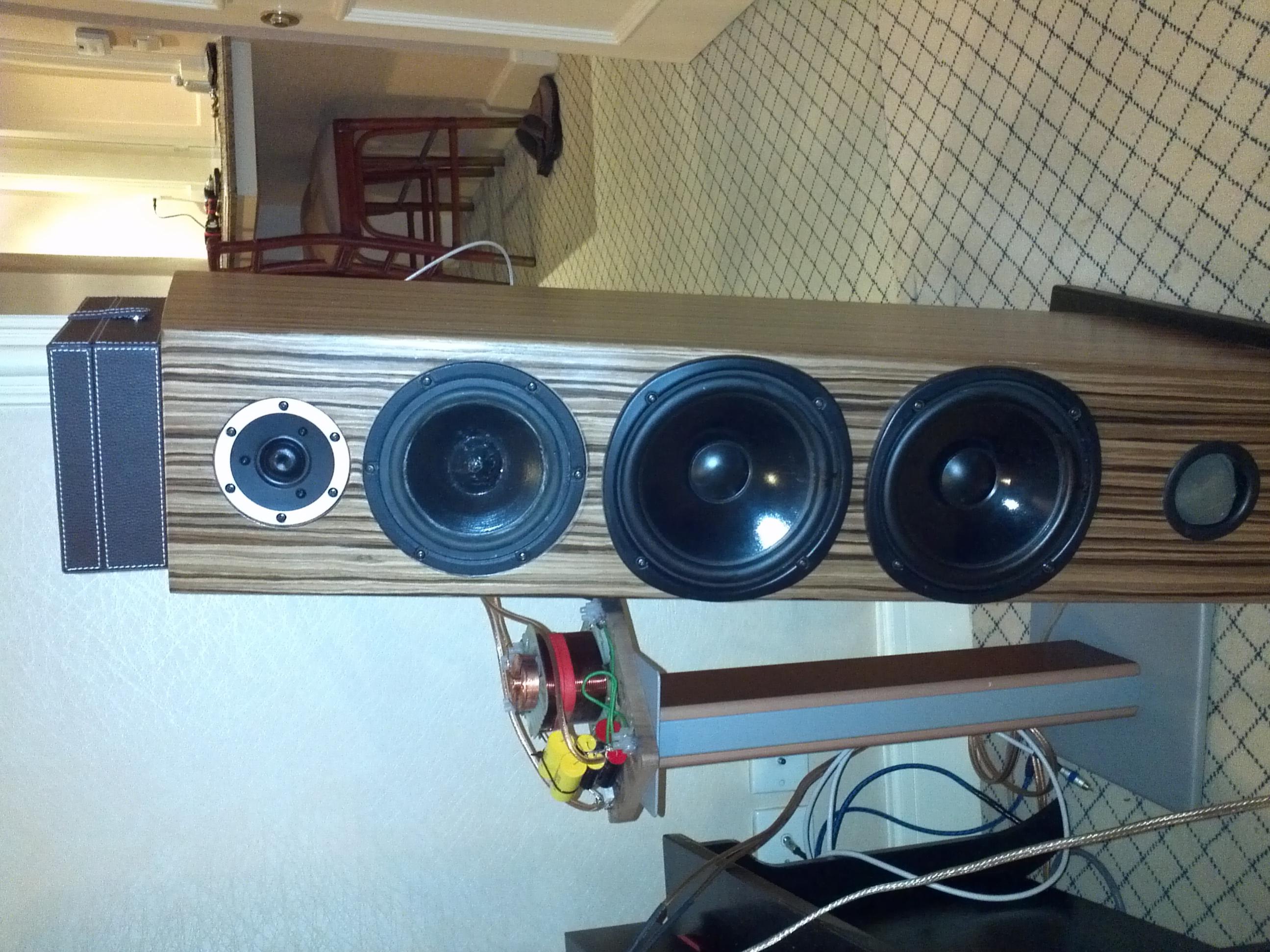

By the way I have changed the crossover quite a bit so if you want to try that one as well let me know. I will post a picture.
regards
Jonathan AKA Chef.
SB,
no problem I will put it up once my stuff arrives as I did not write it down and I have to check the crossover to remind myself.
but from memory I took the 22uf in series with the tweeter out and left the lPad in place.
the woofer inducter went from a 2.2 to a 2.7mh
the capacitor c2 went from 10 uf to 18uf and I removed the zobel completely and added a 22uf capacitor where the zobel was.
alittle lower crossover for the tweeter but I have had no issues with it so far with no distortion noticeable.
give that a go and see how you go.

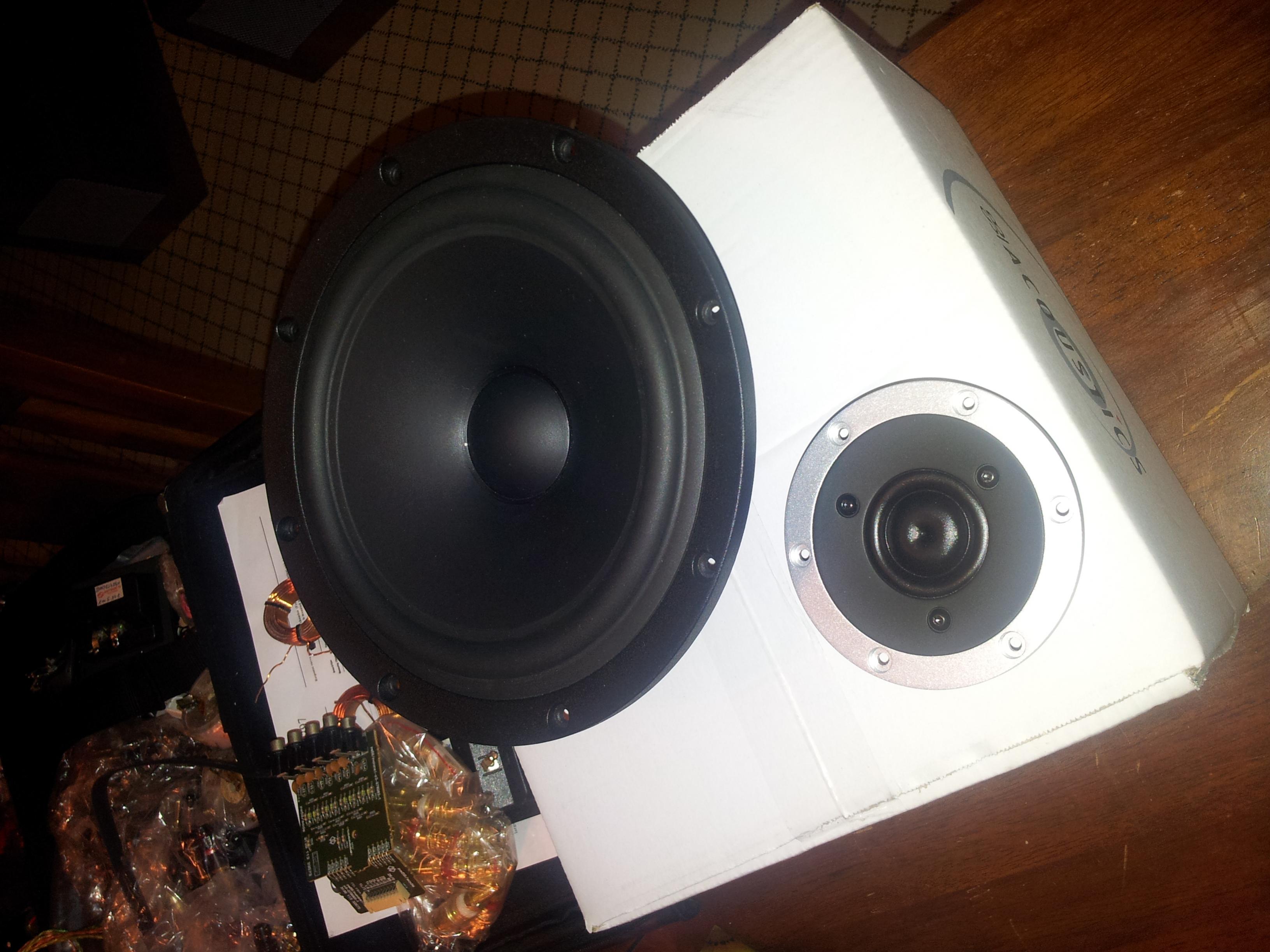

I got impatient and installed the SB Acoustic Satori tw29R into my floor Standers replacing the Vifa XT25.
On initial listening tests without crossover mods they are much much better than the XT25.
Wow the detail is amazing. The XT25 are 1/4 the price of these Satori's but I think it was worth the money.
