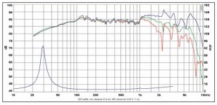

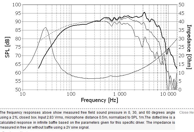

I throw in the new SEAS 8" polycone for comparison along with a 6" SB Acoustics woofer.
A 1.7kHz crossover is VERY low for most tweeters. You're gonna get some cone breakup or tweeter Fs IM distortion for sure. 6" woofer is much easier to deal with around 5kHz cone breakup. But I look forward to seeing your schematic. 🙂

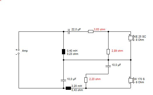

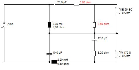

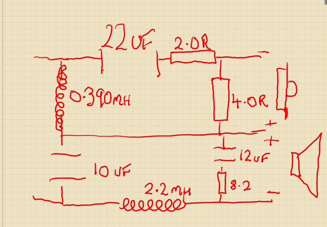

]Dear fellow ear tinglers,
I have got to a point with the crossover where I am relatively happy as a base for future tweaking. Basically It was tuned by ear and many sleepless nights on how to get it to this point. I have attached the hand drawn schematic of the crossover if anyone wants to simulate it for me and tell me where I can improve on it technically.😀
This may sound a little cowboyish but I tried closed box, vented box and I have now chosen to fill the cabinets with polyfill and actually remove the port tube and leave the hole unsealed. the poly fill covers the remaining hole, this gave me the best deeper bass and it sort of recreates a variovent.😕
The hand drawn schematic was done on a galaxy note, so please all you fancy pants with the computer generated programs do not drag me over the coals for the primitive sketch.
So to recap the box is 26lts. series crossover, no port tube nor sealed.
Hope you like it and I hope someone is interested enough to have a go of these superb drivers, you will not regret it.
thanks
Jonathan

sorry David, I should have been more elaborate.
the + input issue top left corner between the .390 inductor and 22 if capacitor
the - output to amp is bottom left corner between the 10uf capacitor and the 2.2mh inductor

Incredibly impressive piece of tuning by ear, chefsinc! Series too. 😎
I just ran this past Boxsim with some vaguely similar drivers and got a good result by twiddling the resistors on the treble section. Phase alignment was good between 1kHz and 5kHz too. The 22uF can be changed to 15uF with little impact. 😀
Really can't comment on polarity here, since it depends on the depth of the woofer, and your breakup peak will be at about 3.5kHz rather than 5kHz, but you have the potential for a good result there, IMO. Nice work. You are gifted.

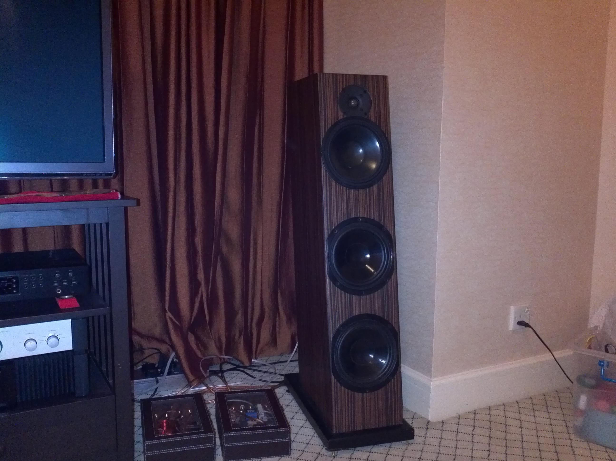

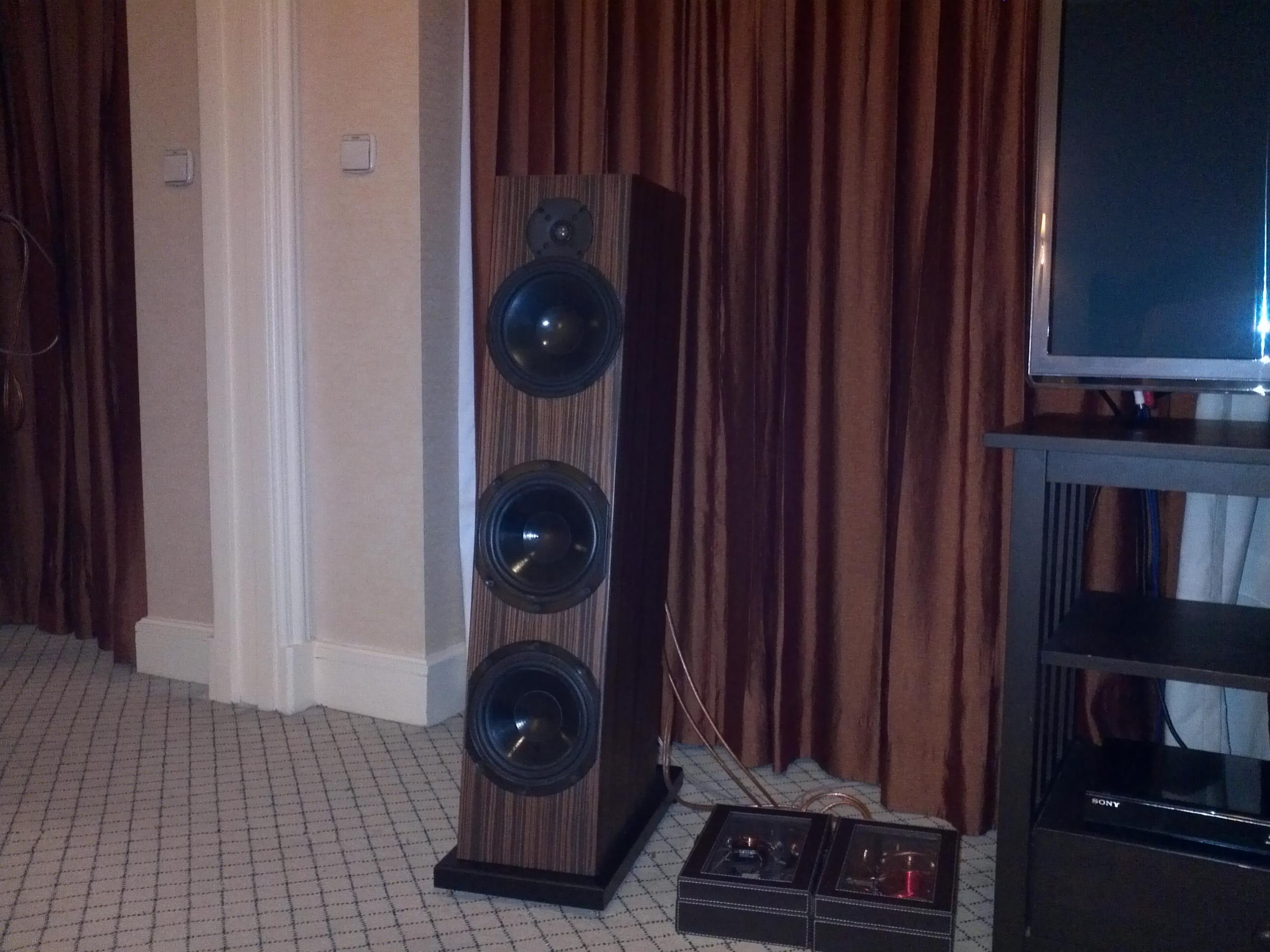

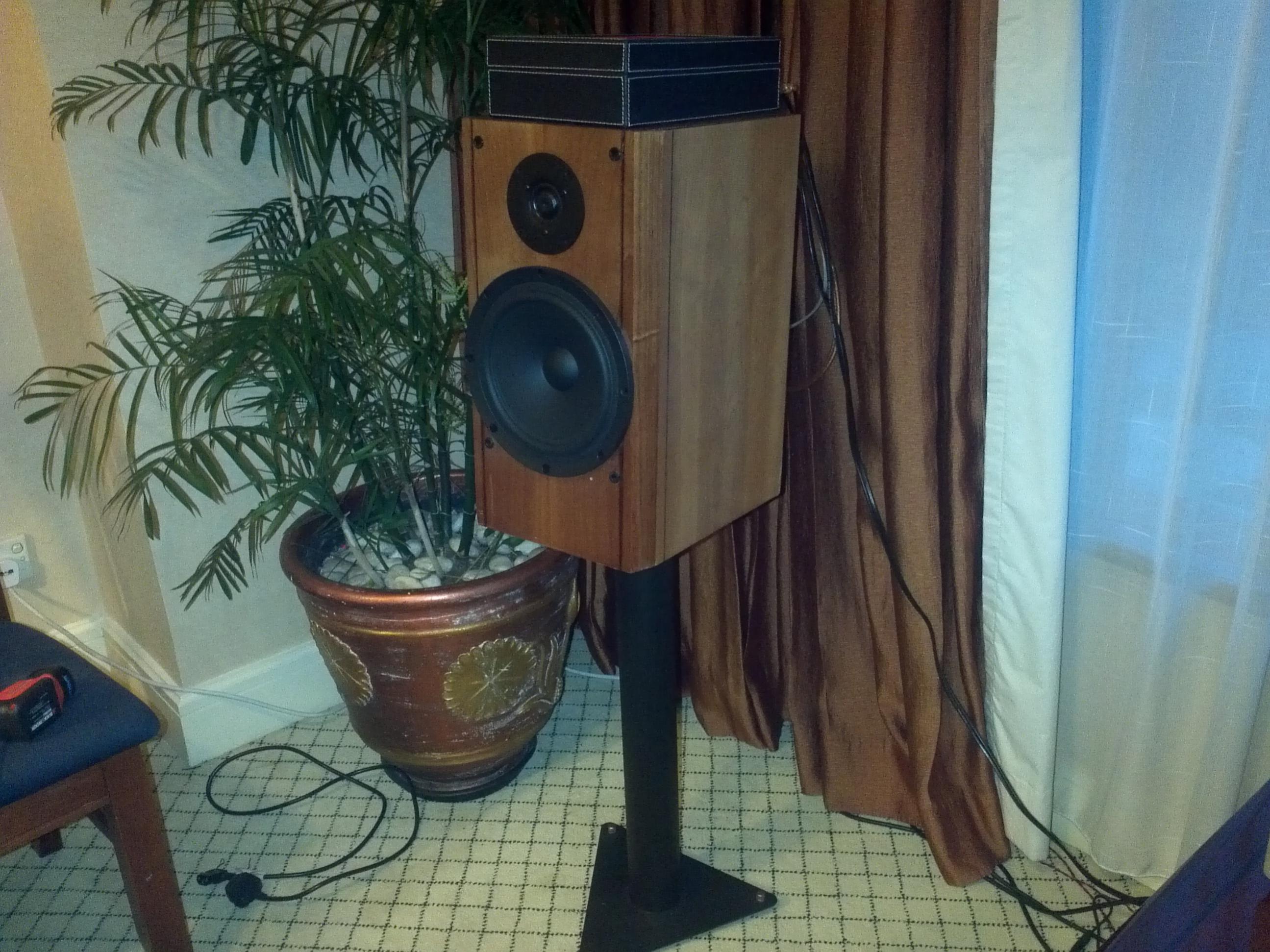

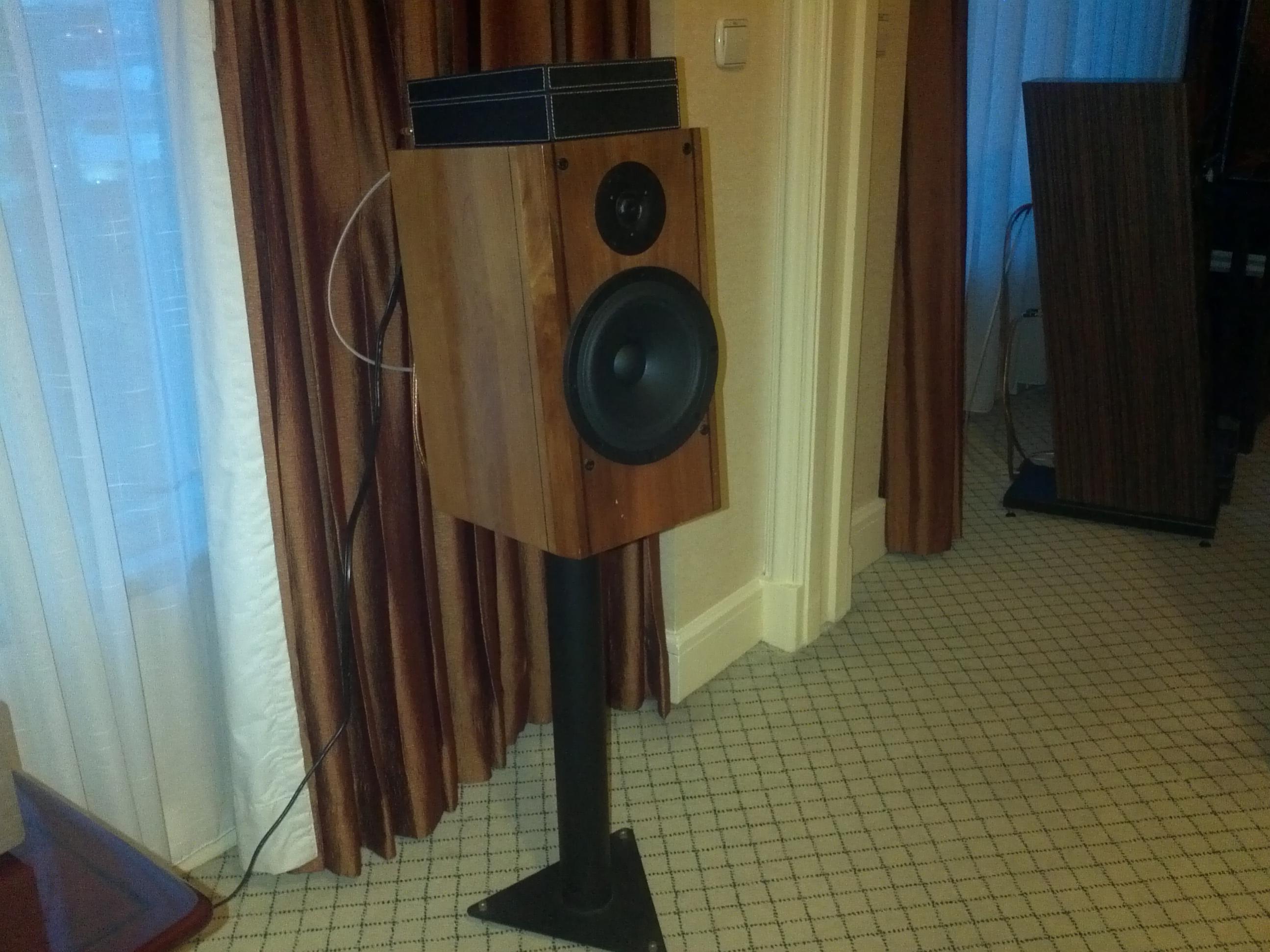

The Finished Batavia's.
I am really happy with these guys. superb drivers. Amazing midrange , sweet treble and bass is fantastic. Tight dry without the boominess you would expect from a no port, unsealed design. I took a risk with this alignment but it has paid off with the huge smile on my dial.🙂🙂🙂🙂🙂
next project better stands for these babies.
cheers all for your input.

I was playing with values a bit more this morning. It does seem to prefer drivers in phase on a flattish baffle.
Seems the 8.2 ohm resistor on the Woofer "Zobel" controls rolloff. Making it a smaller 3.3 ohms gives you about 6dB less cone breakup and deeper rolloff. Going lower than 3.3 ohms starts to worsen phase alignment and creates a midrange bump on the woofer as you might expect. 10 or 12uF here makes little difference.
Changing the 0.39mH to 0.3mH (along with 22uF going to 15uF) raises the crossover point a tidge nearer 2kHz and lowers the level at which the tweeter Fs resonance occurs by about 4dB.
A very nice circuit. Hope those comments help you get a feel for what any changes achieve, and I'm not even suggesting anything needs changing. Of course that analysis is not exact, because I used different drivers, but the circuit seems to fall in a nice point of stability, where nothing is too critical on values. One of the better threads here, Jonathan. I learned something. Thankyou. 😎

Well, if you seriously wanted to raise the crossover point, you'd change the 10uF caps to 6.8uF as well. I'm not sure whether you want to do that with such good tweeters and such a big woofer. 🙂
But the 8.2R replaced by 3.3R seems a good and simple thing to try. 🙂

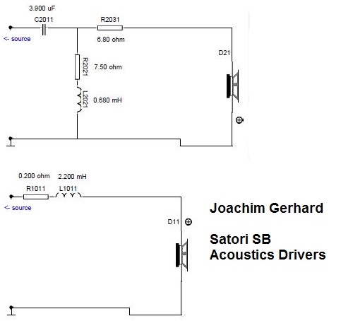

FWIW, here's Joachim Gerhard's current design for his Satori project, which uses a different woofer. He's always interesting.
http://www.diyaudio.com/forums/vendors-bazaar/220330-sb-acoustics-satori-monitor.html
My design is an acoustic all pass with 12dB octave.
That requires to turn the absolute phase on the tweeter.
I use a rather high value resistor before the tweeter and not the more common voltage divider. That way the impedance in the treble is high and i can use a rather small cap before the tweeter. That safes cost or you could invest in a better quality cap.
I got great results with the new Mundorf EVO.

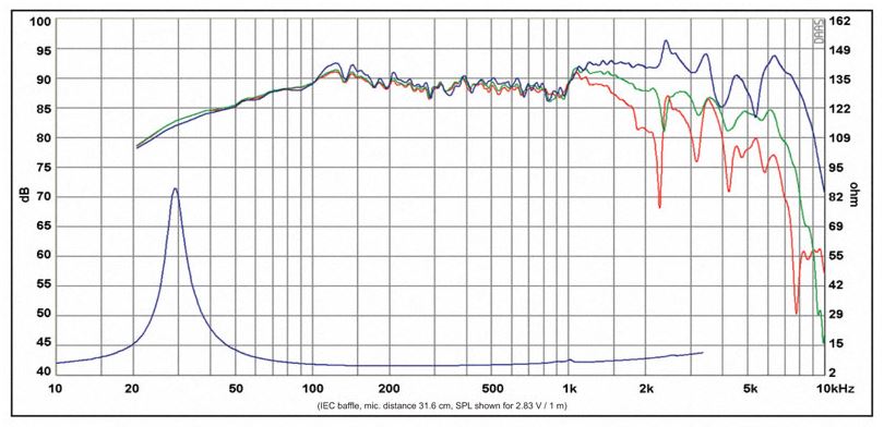

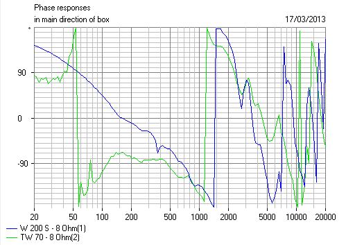

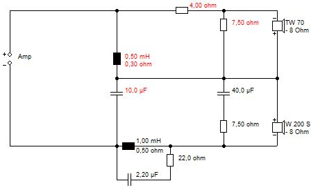

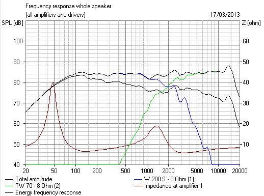

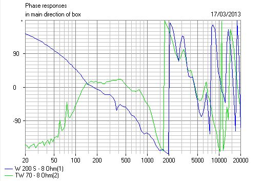

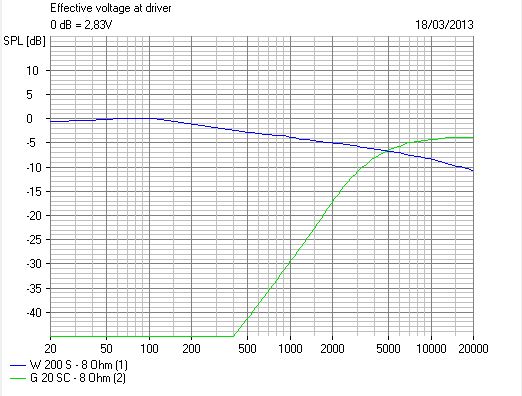

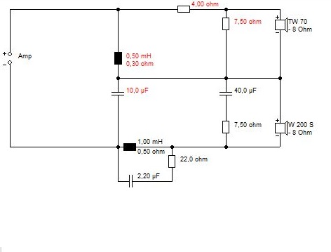

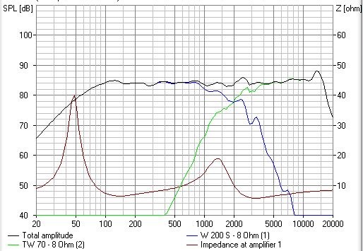

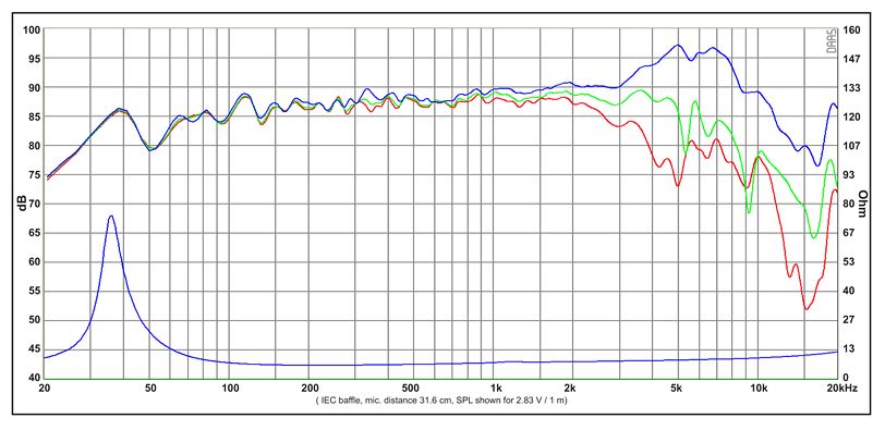

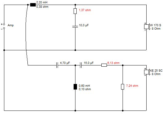

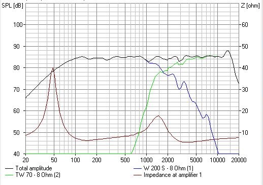

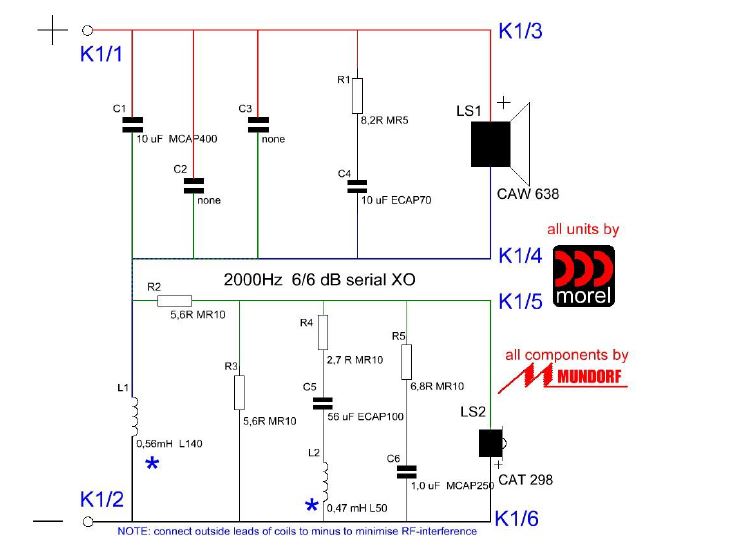

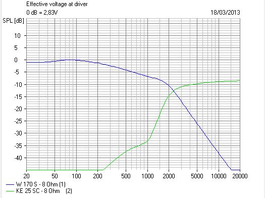

I have a passing interest in the 8" plus 1" idea after buying these golden oldies, Monitor Audio R300/MD :
Out of the box they came with a single woofer coil and a second order tweeter, and I added the Zobel:
The fact is that typical 3.5kHz 8" cone resonance makes anything but a low 2kHz crossover almost impossible unless you can accept some cone-breakup on a low order bass filter. Which makes BIG demands on the tweeter, which must also be EFFICIENT so you can use a tweeter attenuator with a series filter.

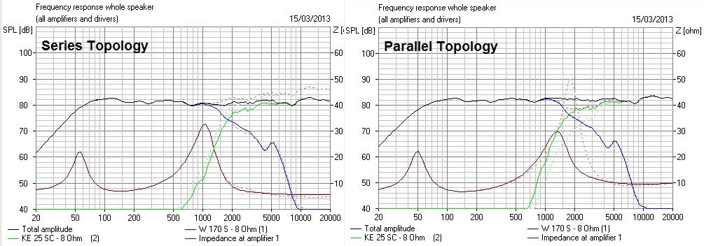

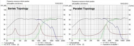

I found a 4 ohm woofer was easier to do, but here's some modelling of series and parallel topologies with the high-inductance 8" Visaton W200S. Amazingly, the bass section is pretty damn similar. Notches (here, a tank @ 3.5kHz) can be incorporated in series filters as easily as parallel. The 22uF optional tweeter capacitor turns out to just do some DC blocking. It's not strictly required.
Lastly that decent Eltim design for 6" Morel polycones around 2kHz. Hope you get the idea. 🙂
I just noticed that the phase for the series (3) is a LOT poorer than for the Parallel (6). 😕
I forgot to mention something Joachim Gerhard knows well. These series circuits work best TIME-ALIGNED. Swap the tweeter phase and set it back level with the woofer:
Job done. Much better. 😀

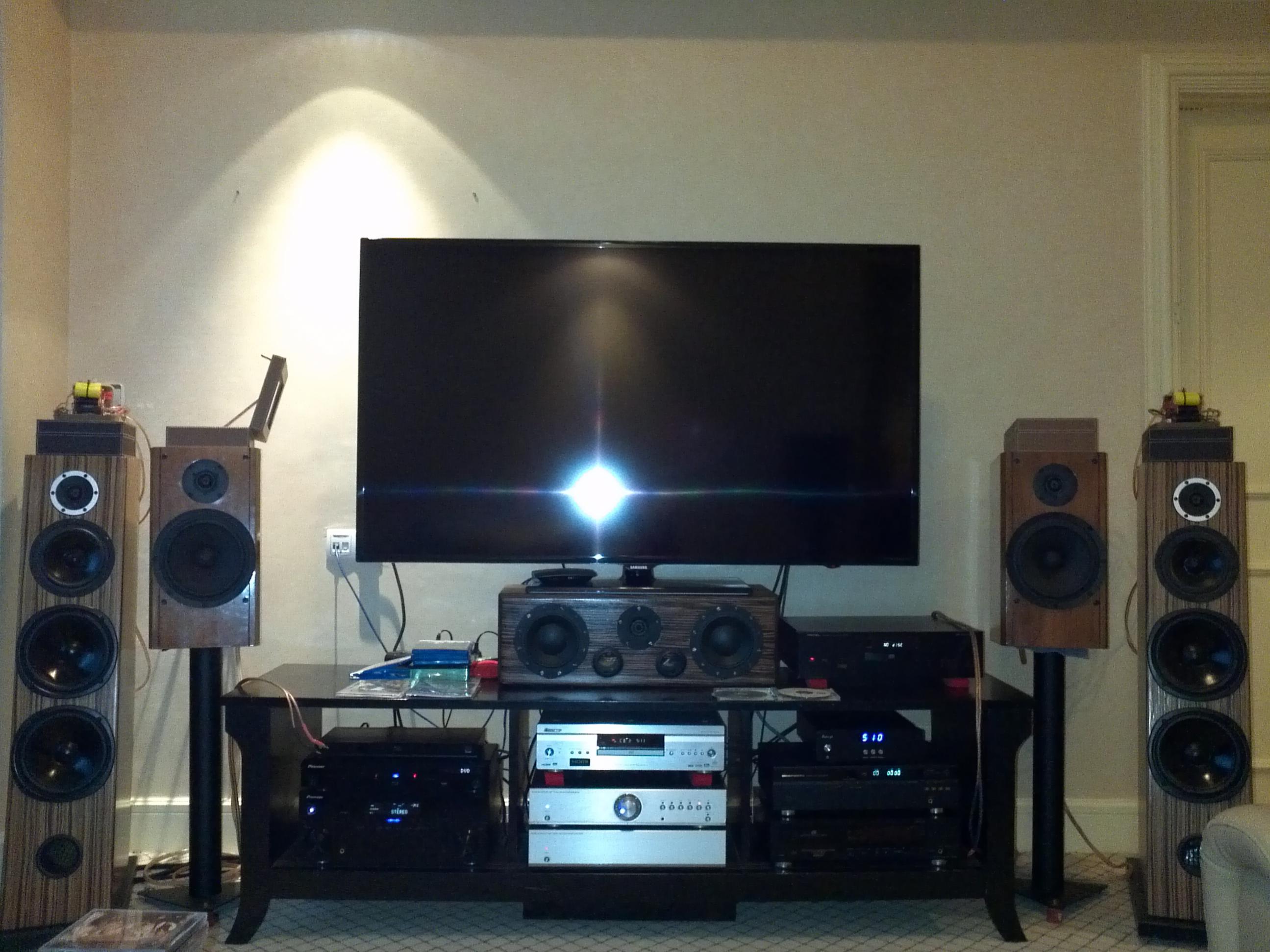

S7.
yes I did sort of work that out after some days listening.
I have reverted to positive polarity on the tweeter and tilted the boxes back about 7 Degrees.
sounds much better and sound stage is more defined.
those monitor audio's are beauties, I think they use a focal woofer.
I am really happy with the way they sound now.
I didn't lower the crossover point as per the woofer breakup, but I did change the resistor from 8.2 to 3.9r and it seems to changed the sound slightly for the better.
