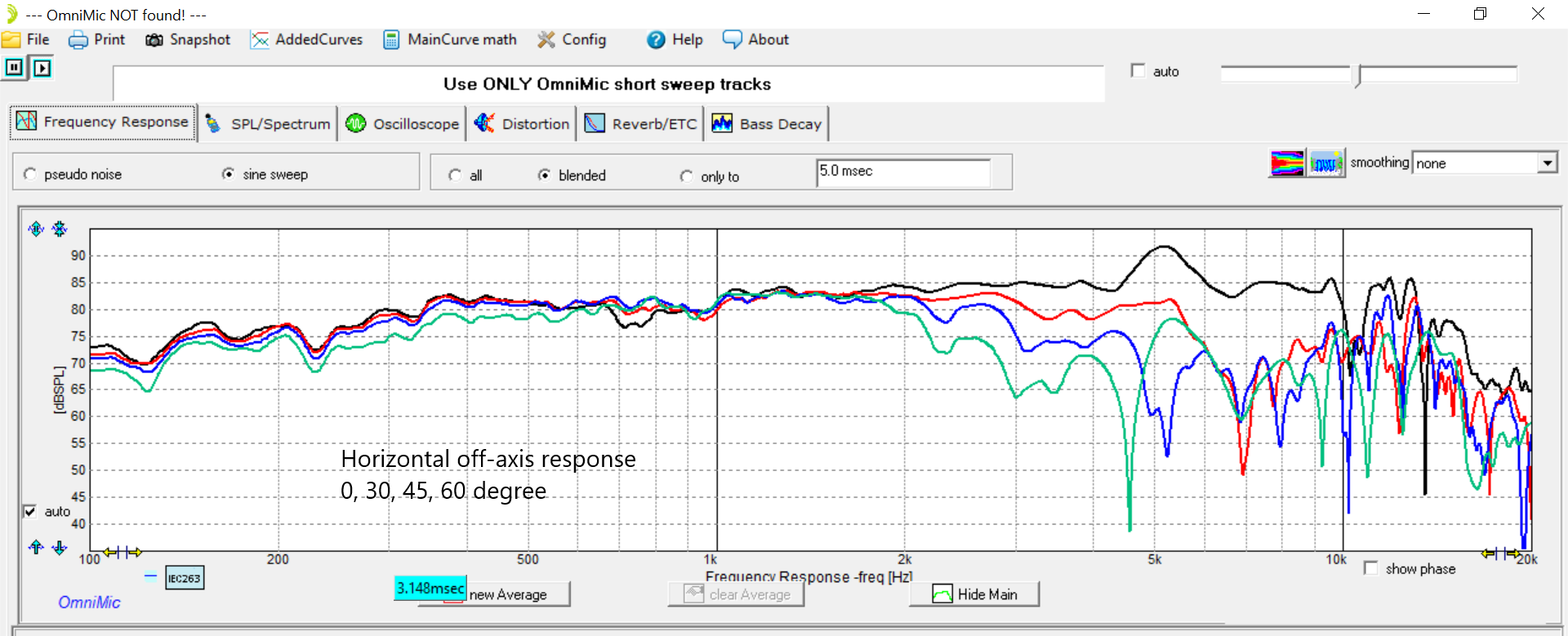

The XO for the ETON 3” and BlieSMa t25b-6 is roughly a LR6 at 1900hz. The speaker is a WIP so keep that in mind. I am also a newb. 😛
Measurement at 1 meter
VCAD sim based on real measurements (hificompass/audioexcite/hifi.de) and baffle sim:
A early eyeballed off-axis. The tweeter is not flush and I hope some of this cleans up:

Very good! Off axis and beaming are way over rated to me anyway. Listening tests mean way more to me than any measurement; regardless of equipment or software used. Many people will argue this point forever; I really don't care. I know what real musical instruments and singing voices are supposed sound like; it's THAT SIMPLE REALLY!
@Headshake
Yet - showing off curves, that looks like pretty good off-axis measurements 😎

So my point stands pretty solid. If FR - both on and off axis is rather smooth and even. Then it mostly sounds good - apparently according to most people... no matter if they buy finished products or build themselves 😉

Thanks! It came at the cost of max spl's. Hifijim's tweeter is the size of my mid! His textreme speaker had to be gimped like -6 db to match mine.
