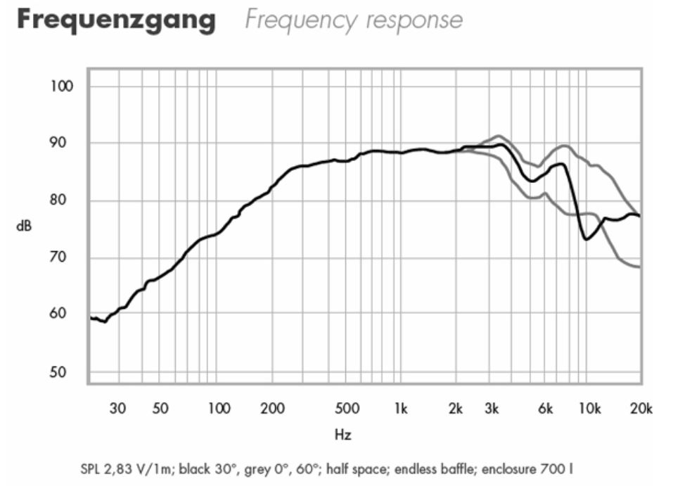

I recently listened to another DIY'er setup, he is also using Hypex fusion amps for active crossovers.
He has the Eton 3 inch driver. Eton 3-212/C8/25 HEX Bass-Midrange This one I believe.
I was impressed with the sound of this driver. You might consider it...
I actually had considered that very driver. Do you know what the band pass settings are exactly? Freq. and slope? BW, BE, LR or custom???
Interesting 3" driver. Where were the crossover points/slopes? The driver's FR does not seem all that smooth above 3.5kHz or so.
He crossed at about 330 Hz to a 10 inch driver, Seas L26ROY. He crossed at 2.7 kHz (I think?) to a bliesma T25B 25mm berylium dome.
