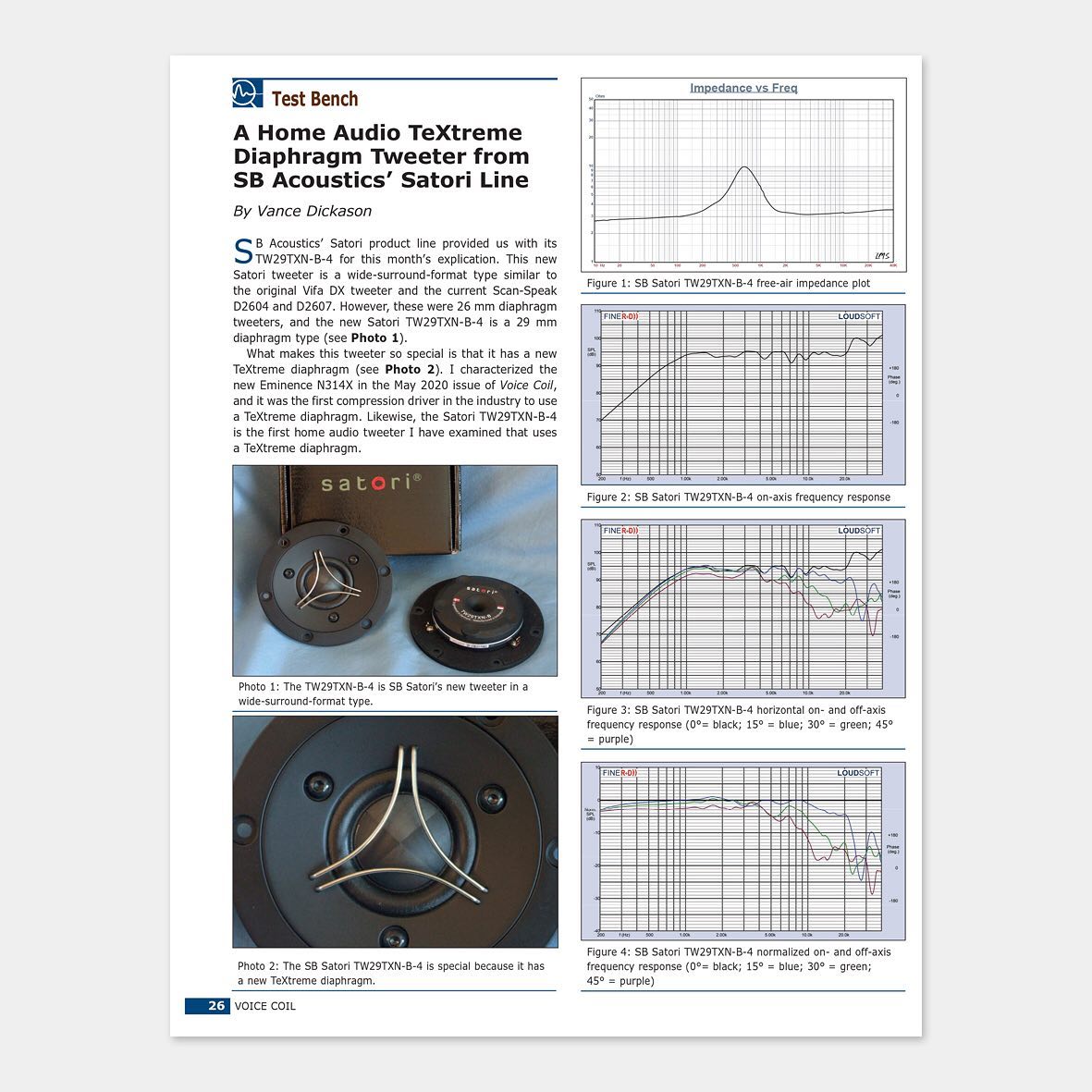

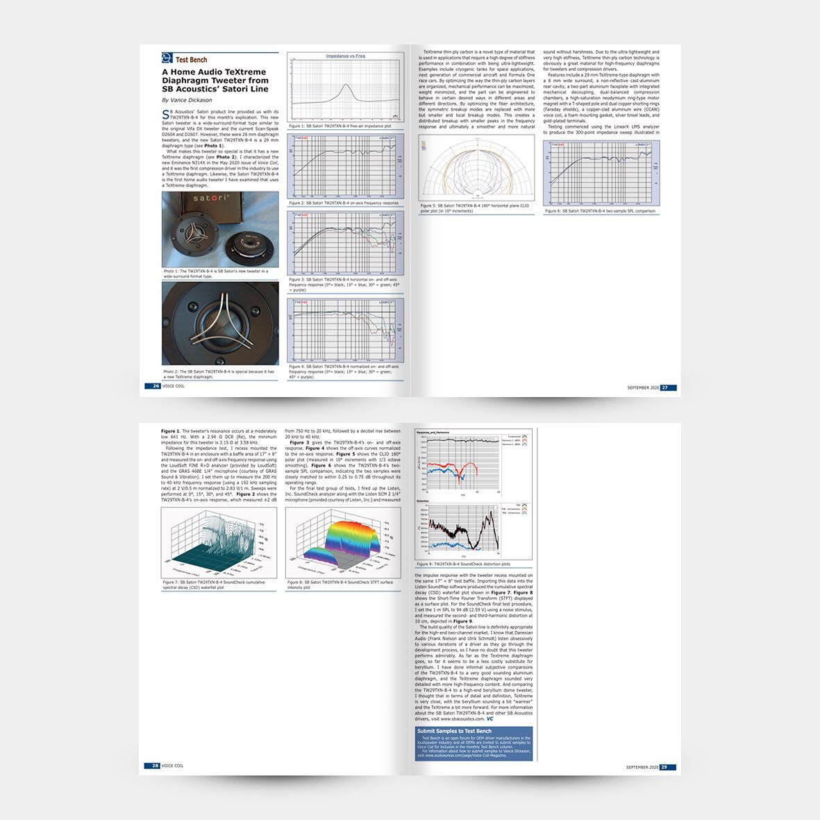

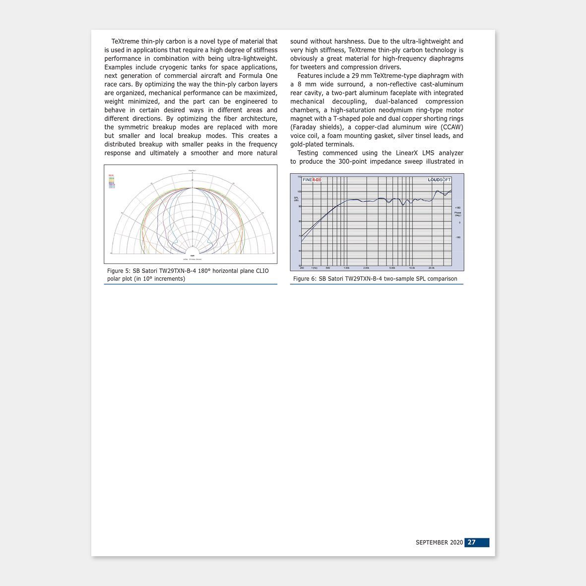

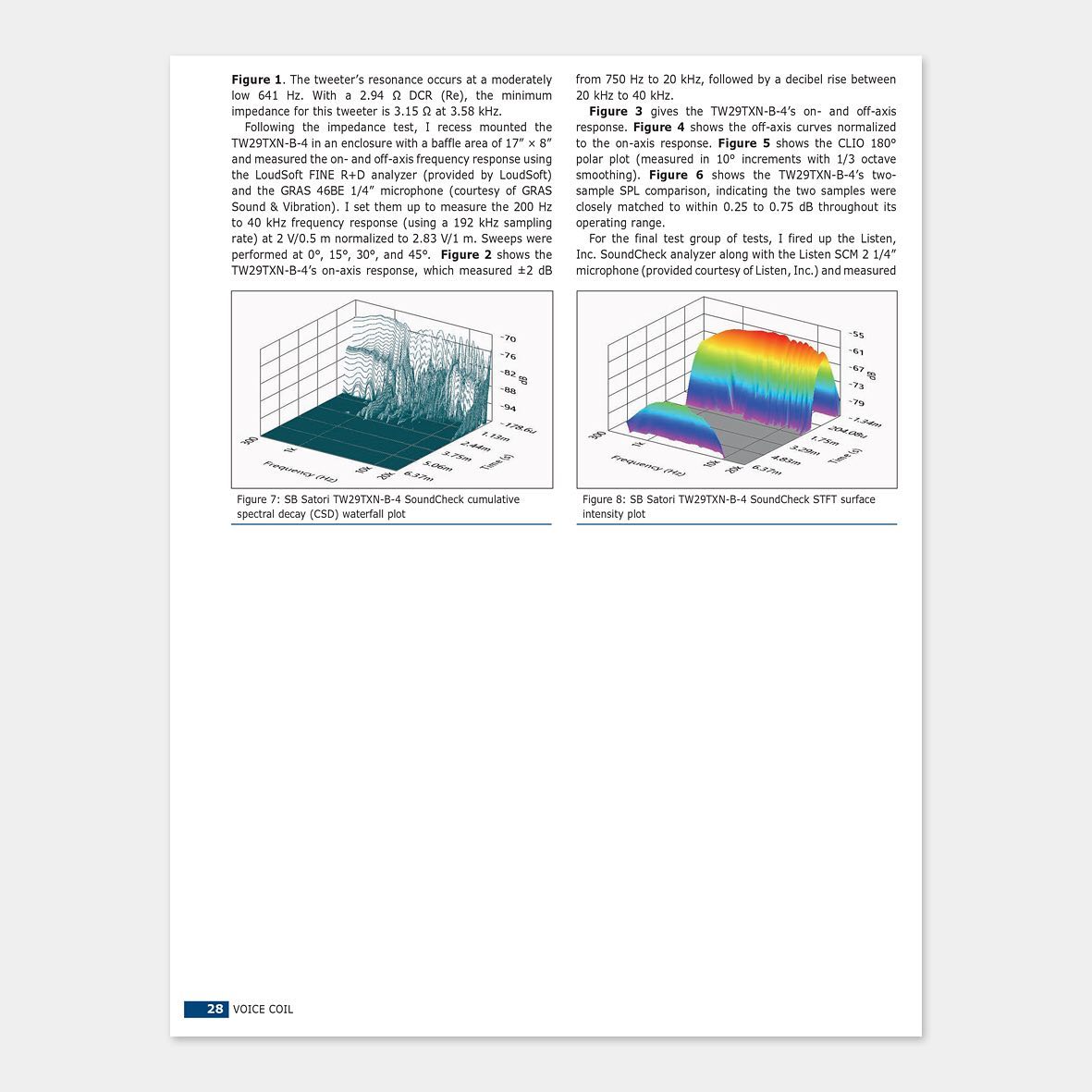

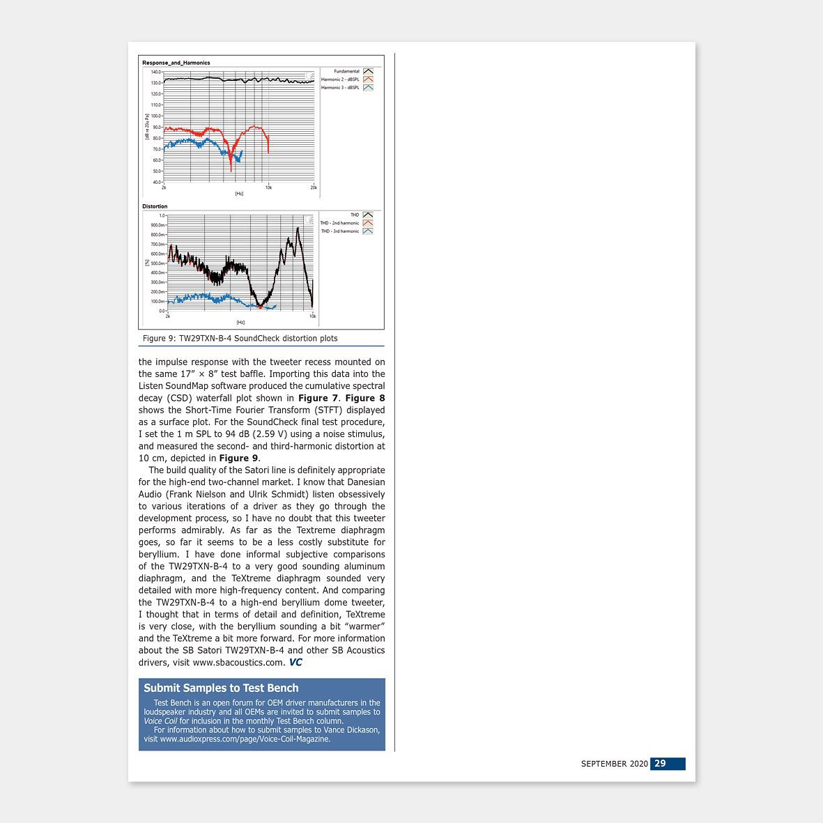

Voice Coil September Issue.
Test of the TeXtreme tweeter
71/2” SATORI MW19TX-8 / TeXtreme – Sbacoustics
