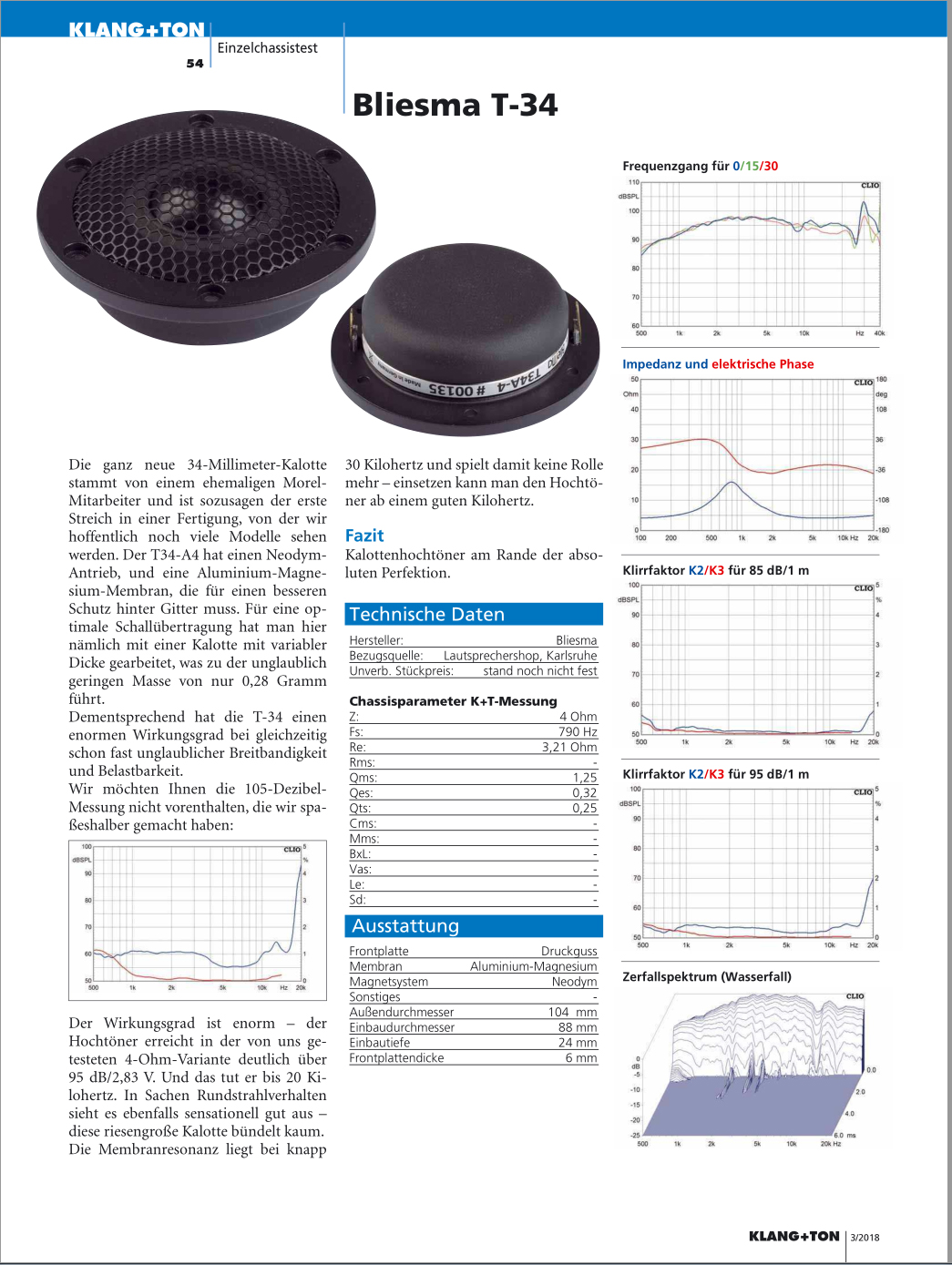

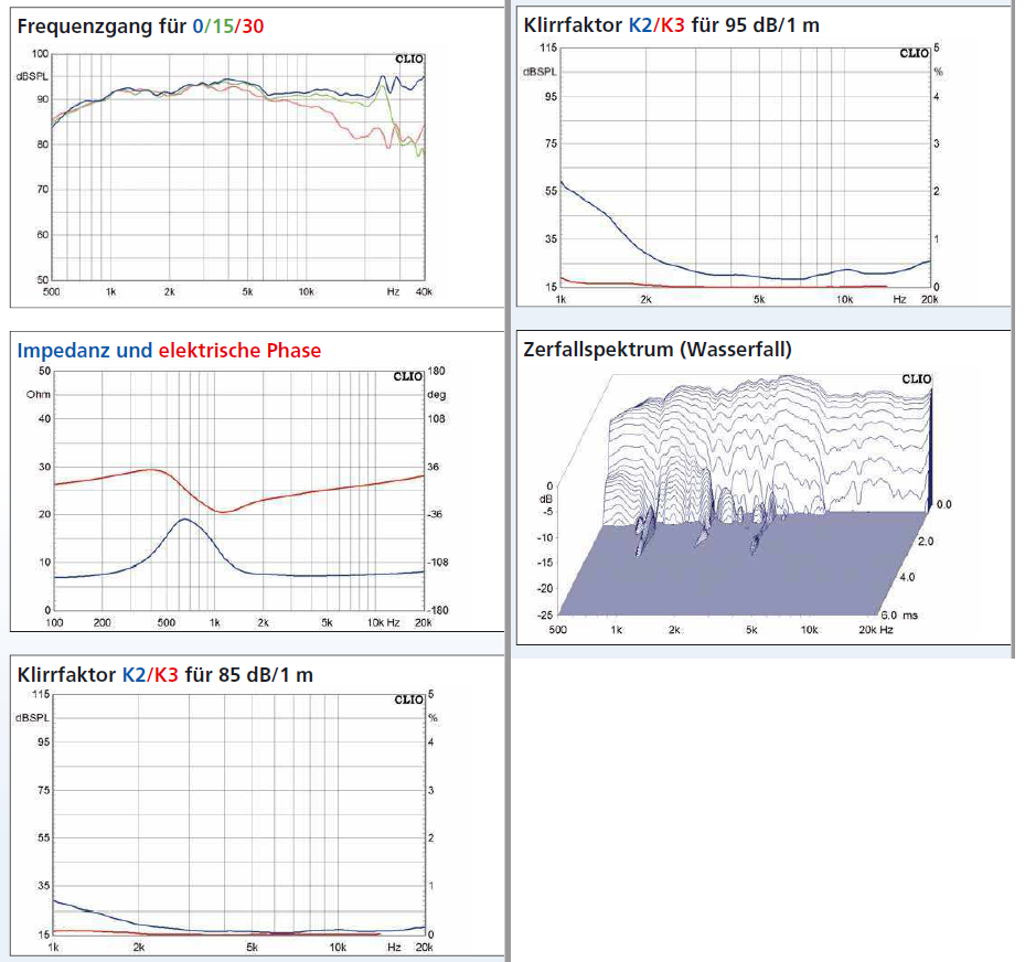

Do you have a link to K&T tests of the Bliesma?

Here is the Hificompass test of the T34.
BlieSMa T34B-4 | HiFiCompass
